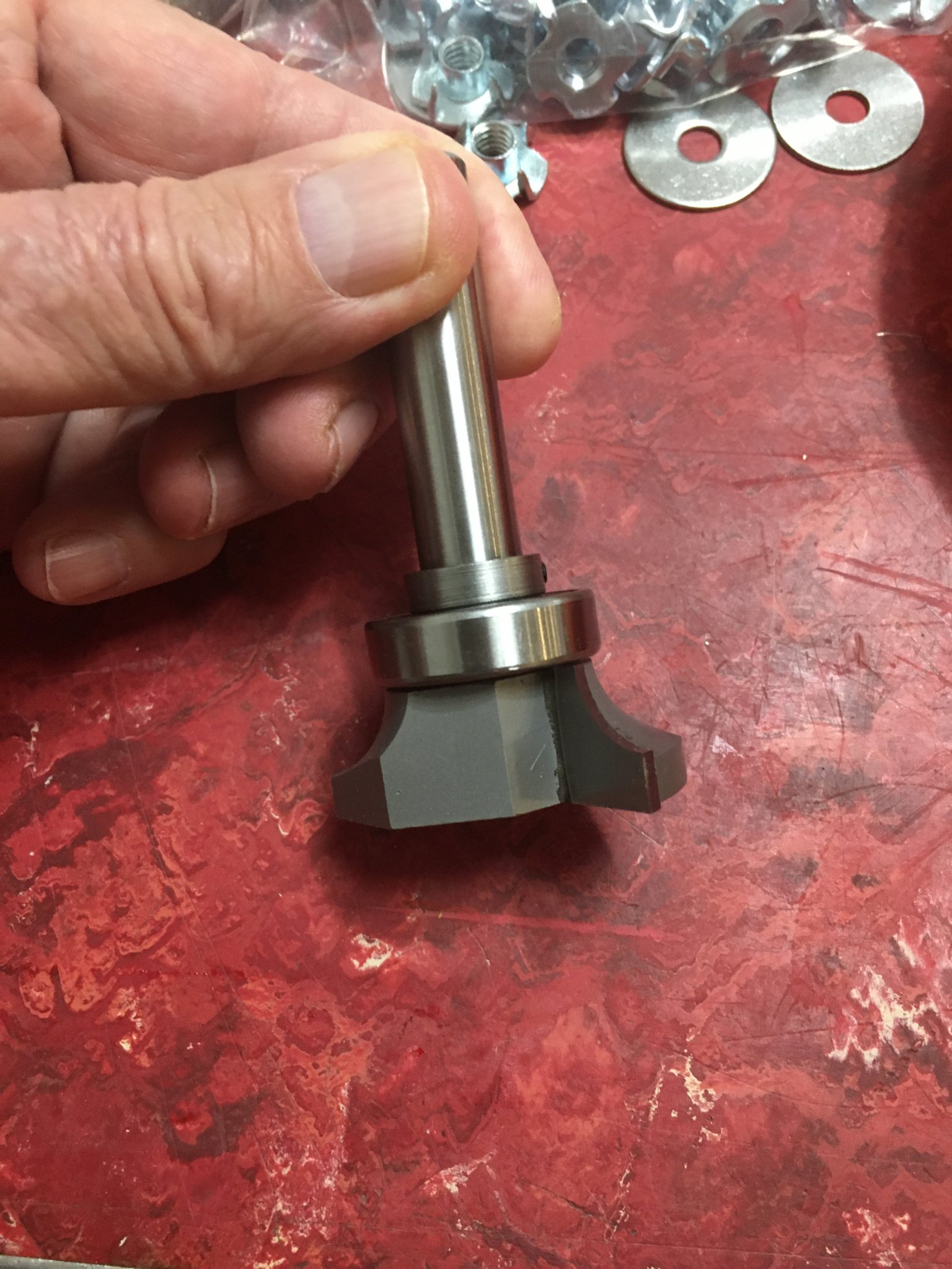

Thanks Dave for the reminder. A couple of things:
1- I think for the two woofers the round under will be fine.
2- For the A10p definitely a 45° chamfer is preferred. That is what we would have had if the inner baffle had not been assembled incorrectly. Since these are assembled our options are extremely limited. We have to do this from the outside of an assembled cabinet.
3- I have been able to locate a so called "Round Under" router bit that will work in a freehand router (not on a table router). https://www.freudtools.com/explore/router-cnc/solid-surface/under-rounding-for-bull-nose
4. I have not been able to find a under bevel or chamfer type bit. It is an inverted bit with the bearing on the other side. If you know of where I can obtain such an item please let me know.
5. So my only other option is to rasp it out by hand or live with the round-under 3/8" that I have.

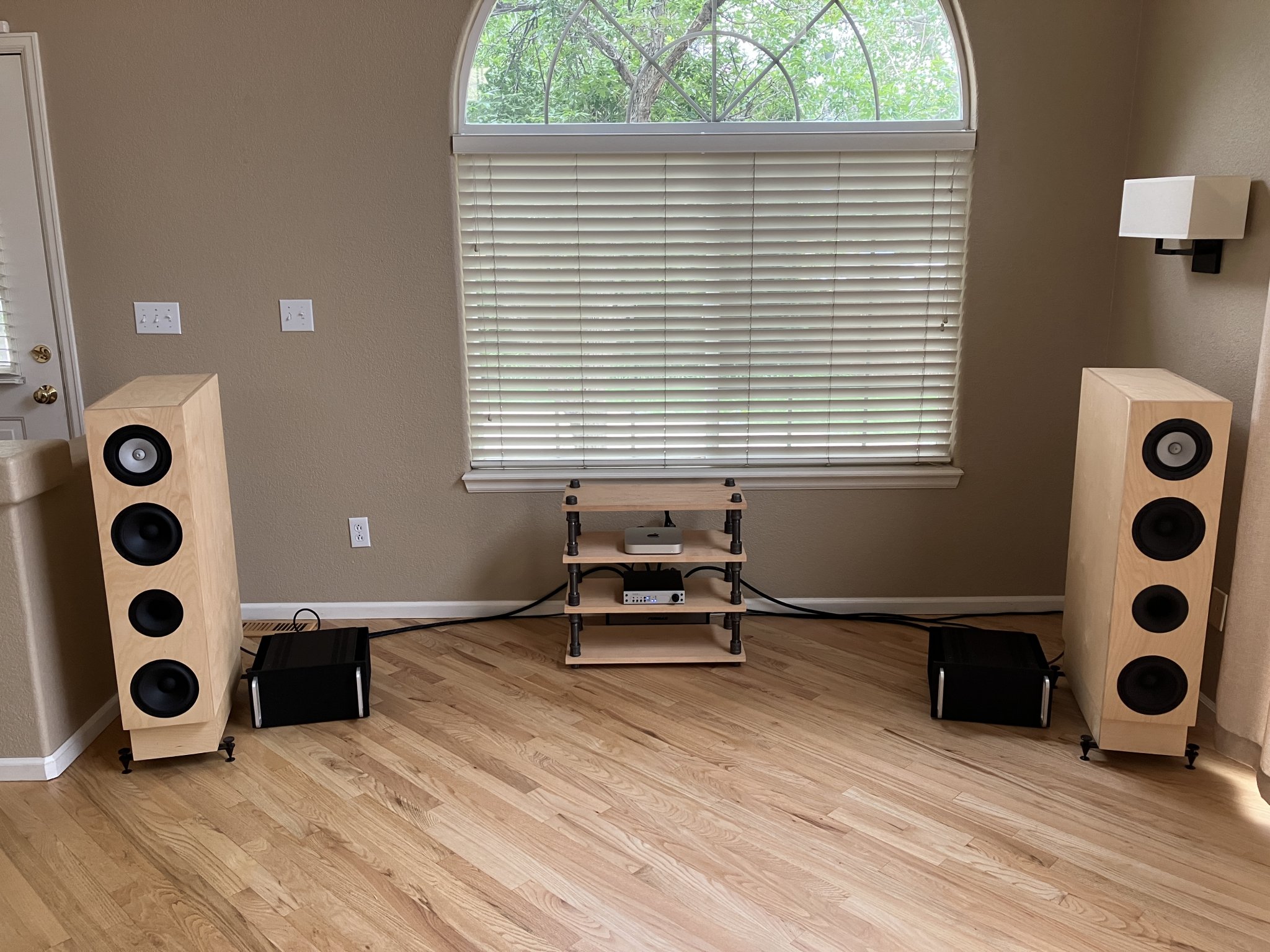

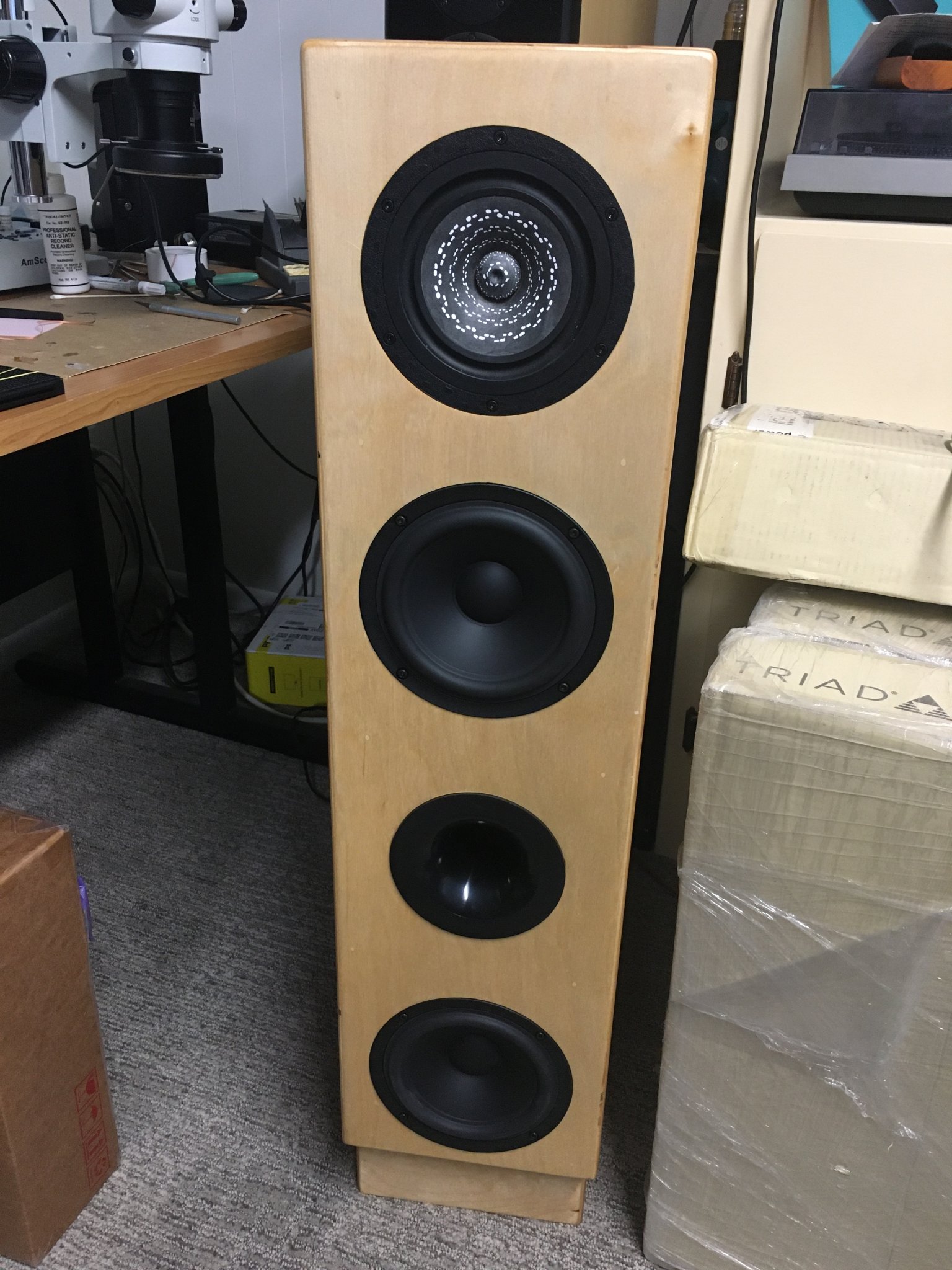

Well at long last, they are playing here in my office. This is the first time I have heard A10p drivers, and I am very pleased with how they sound for sure. They are the match of my other system and perhaps a little better, time will tell. When fed good material they are just beautiful to listen to. So dynamic and clean. Of course thanks to Dave Planet10 for the EnABLed A10p drivers..
I know the bass isn't quite right but breaking in and some tweaking will help for sure. I wonder if the balance is off just a bit because I have the newer version of the SB woofers that are a bit less sensitive. Also the bass doesn't go down quite a low as I had hoped, but frankly they sound terrific and actually better than I expected. Of course i am driving them right now with my own DAC design (From my full time work) into the Benchmark ABH2 amp. I think I can definitely live with them.
I am feeding them right now at 96K 24 bit playback from my work product (bit accurate) playing the "World's Greatest Audiophile Vocal Recordings" from Chesky and downloaded it from HDTracks as 96K flac and the Halcyons are handling it all very, very well. The lowest note of the bass on Spanish Harlem is a bit weak perhaps that can be solved eventually. Break-in, room placement, stuffing etc. I have high hoped we will get there.
I ordered my first parts in August of 2020 from Madisound, and the flat pack from Big Wood Studio in July of the same year. The A10p from Dave Planet10 were first in May of 2020. It has been a long road, interrupted by illness, COVID, family issues, and just too much full-time work. But at last they are playing.
I can recommend for sure.

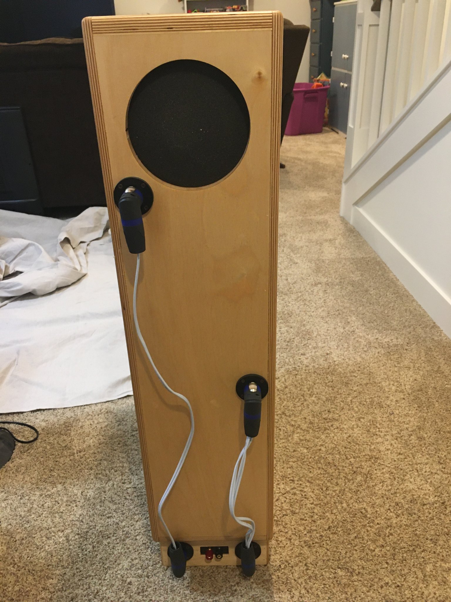

Here are two photos of the left channel speaker. This is not their permanent home, but temporary to do first listening. You will note that I used Speakon connectors to connect the drivers to the crossover. It isn't too handsome, but it works. I divided it up in a way that I could use external crossover/amp. These are not furniture speakers but functional so they don't look too fancy, but they work and that is what I wanted.
I have also checked all drivers with my polarity checker in the AudioTools from Studio Six Digital and they are all positive polarity first time.
Back to work!
Back to work!
I am quite surprised at how much the bass has changed in the first 5 or 6 hours of listening. It isn't just my ears getting used to them. The low extension is getting better by the hour.
I think that the A10p is probably a little too loud for the newer SB woofers. I will let it breaking a bit more but that is my current feeling. Curt said they the output level will be down a little and I think it really is. I know this was discussed earlier in this long thread, but that is tonight's conclusion.
I did a quick and dirty RTA on it yesterday with pink noise and it looks like a shelf above the crossover frequency. That isn't accurate enough to go by but is one data point.
-david BTW
-david BTW
