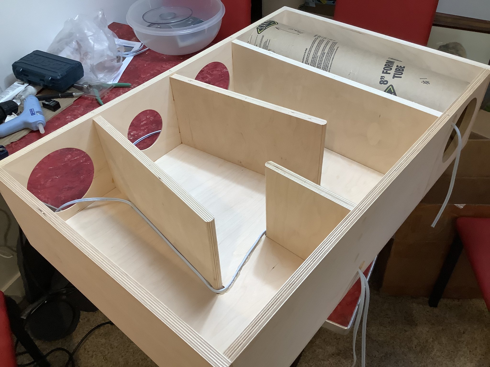

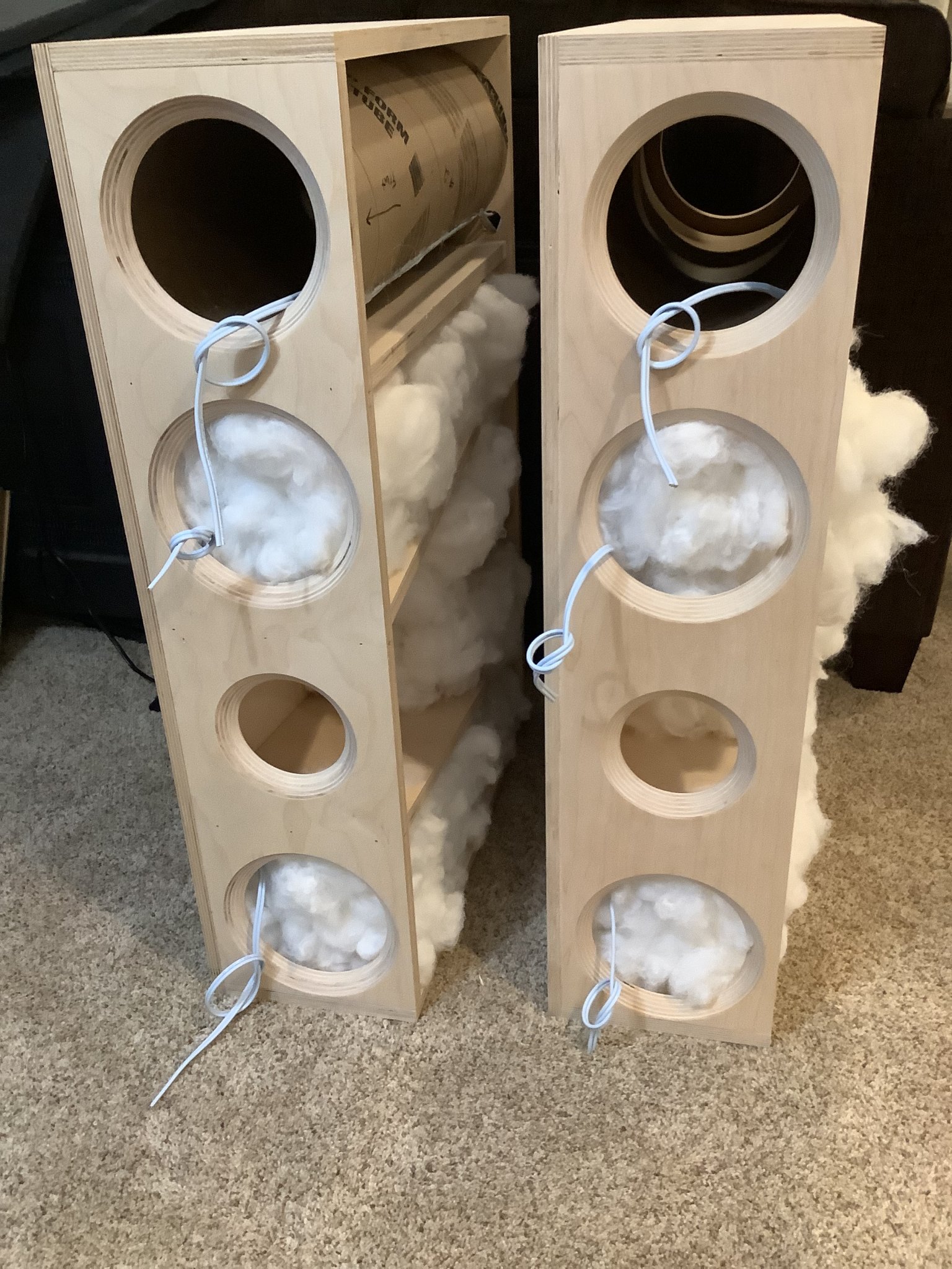

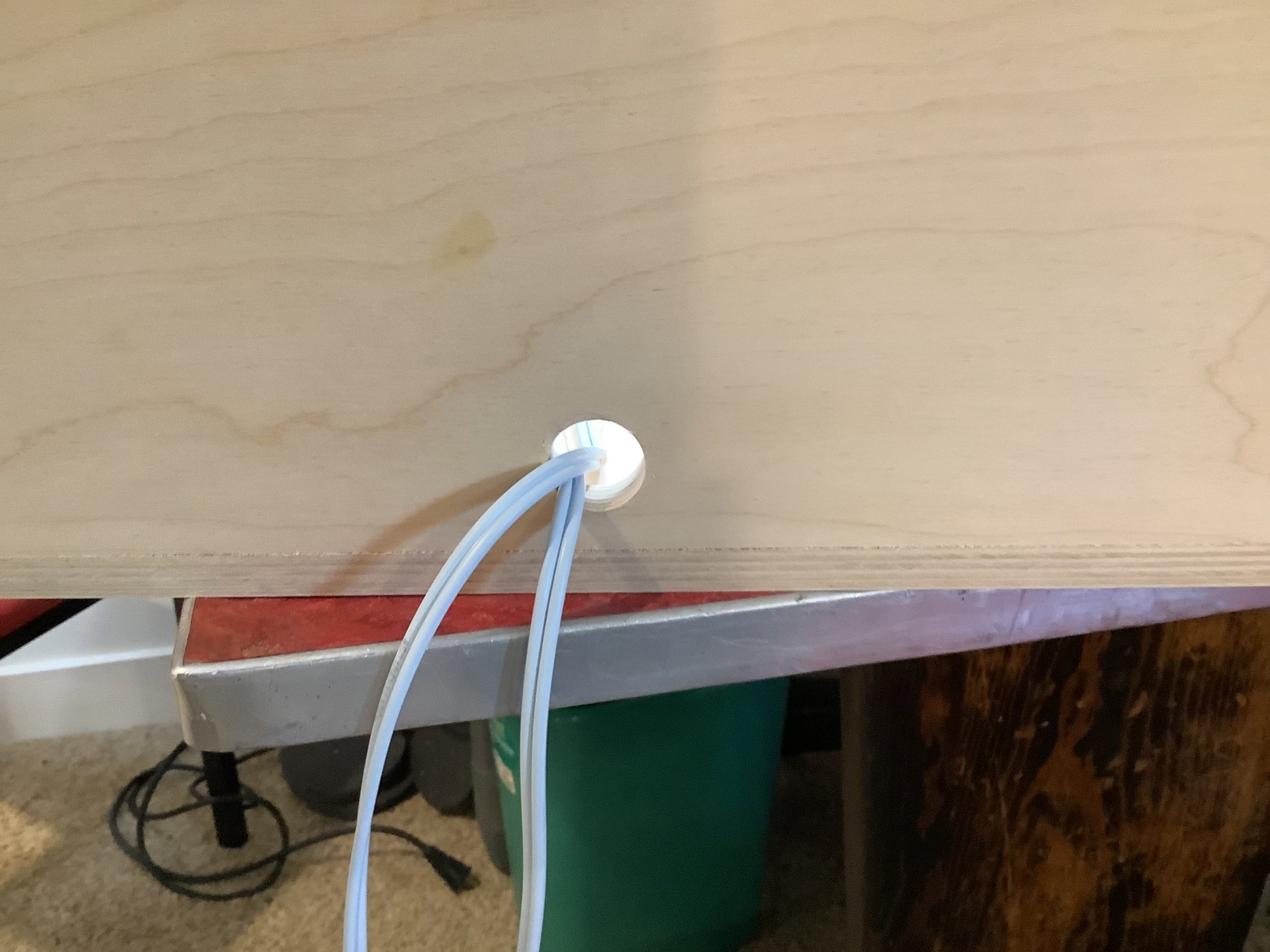

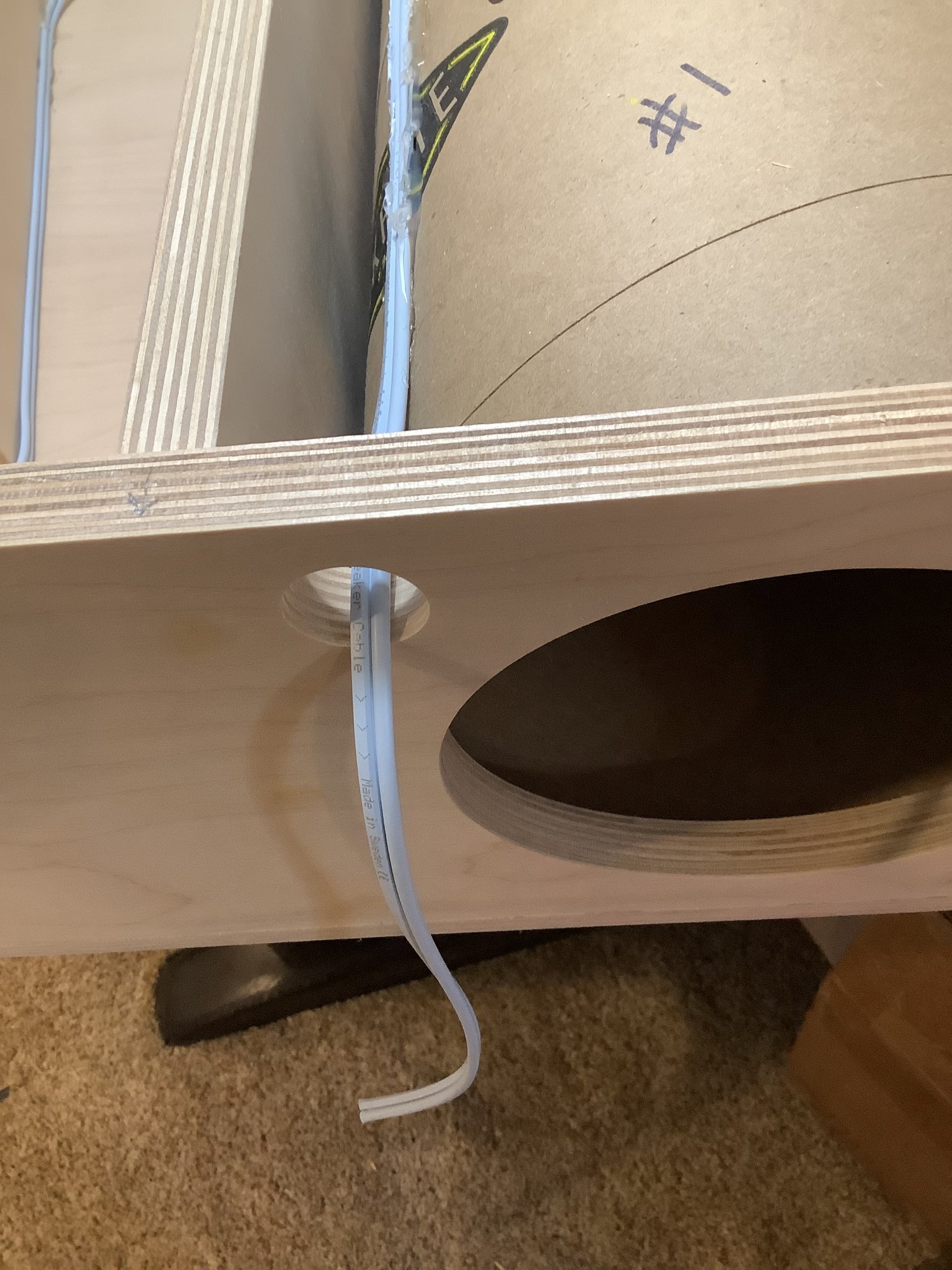

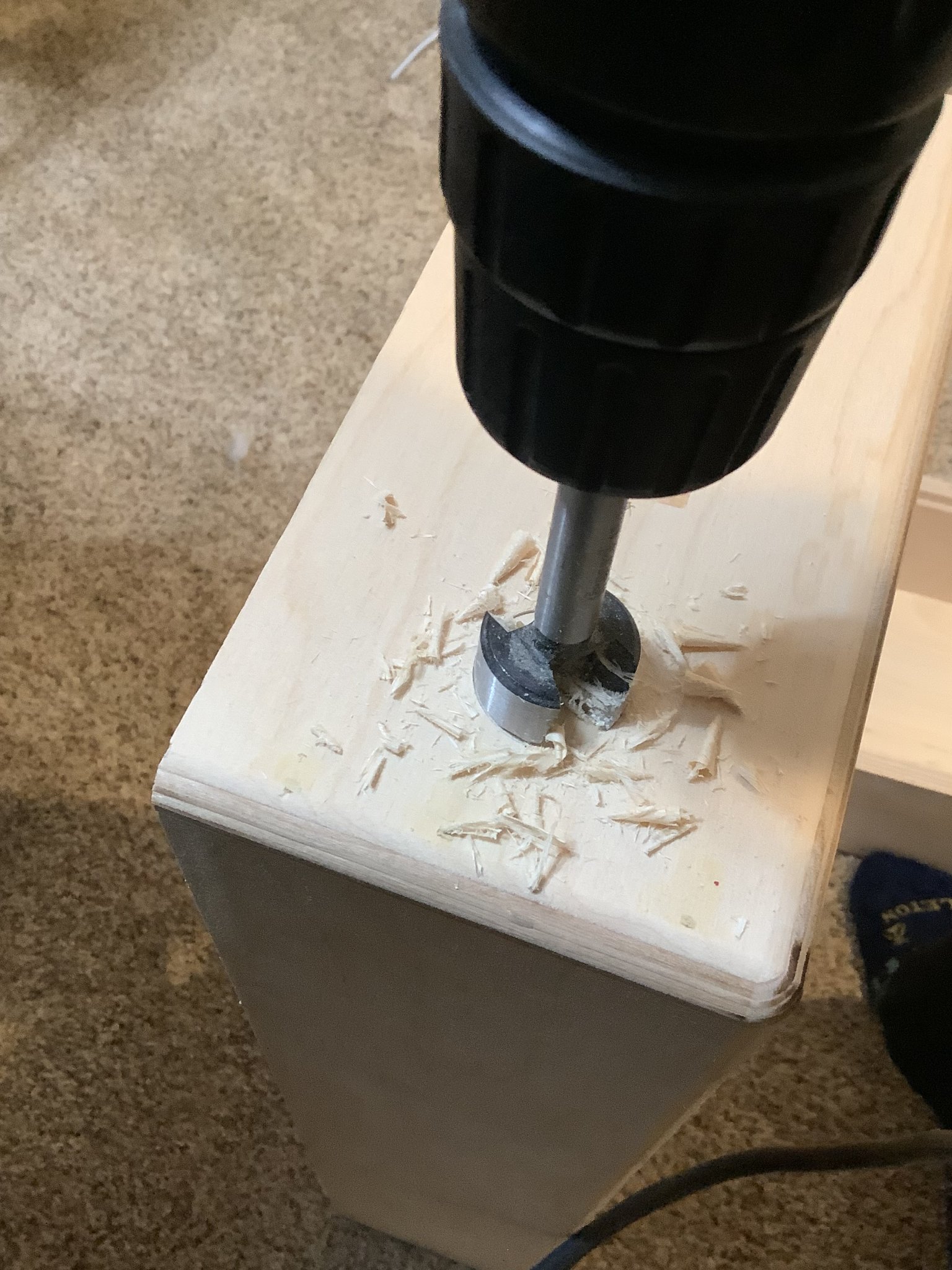

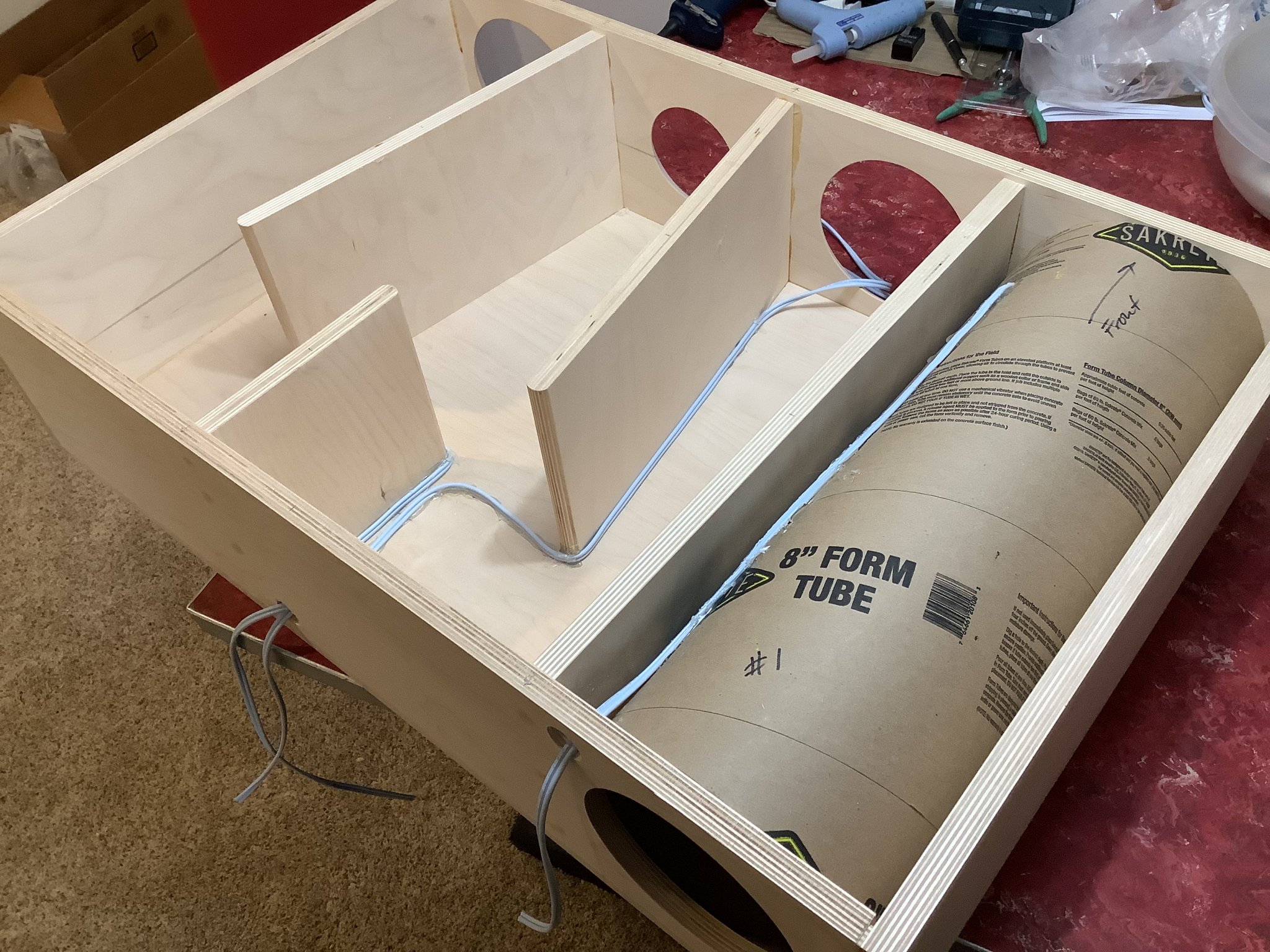

I decided to put in speakon connectors for a separate feed to the woofers, and the A10p. I drilled 1" holes into the back and then installed wires inside the cabinets. I also put in the sonotubes after fitting the 1" foam and made the 5-6" plug out of multiple circles of the 1" foam. After talking with my woodworker, we decided to put the acousta-stuf in before glue on the sides and front baffle. Wiring up the crossovers it today's challenge while I wait for the final cabinets. Finally!!! I am making some progress on these. What a year 2021 was!

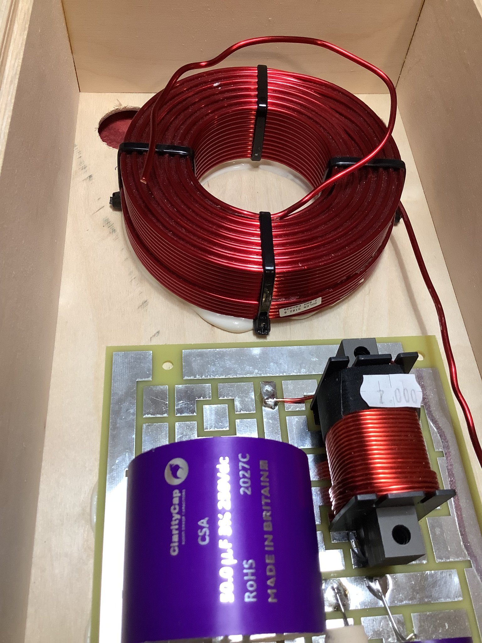

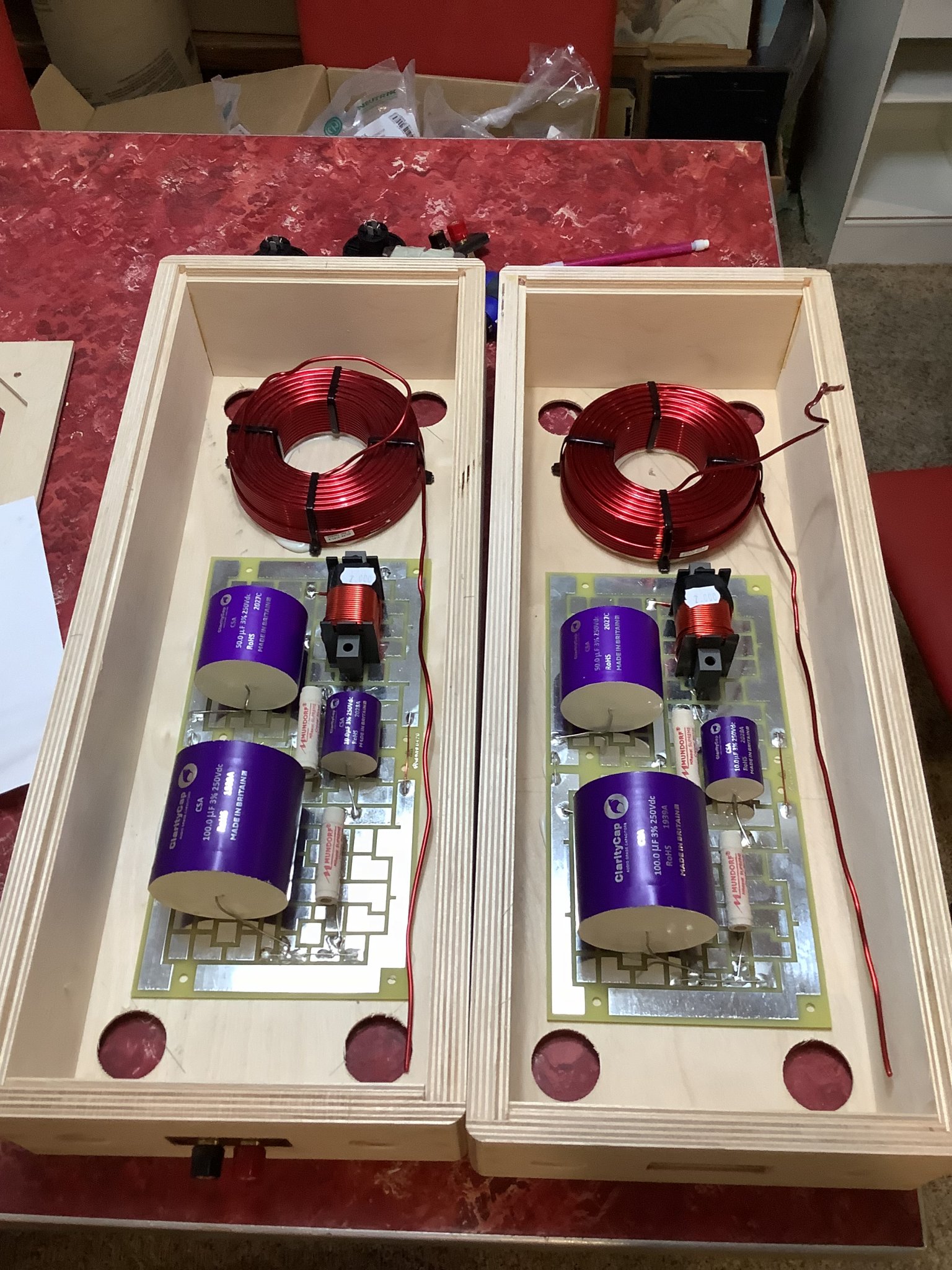

Holes in bases for speak-on connectors going in. The crossover board and my huge and too expensive air-core inductors all mounted on bottom plate of the base and ready for final wiring.
First time i have noticed: seems strange that the sealed sonoTube is in its own sealed enclosure.

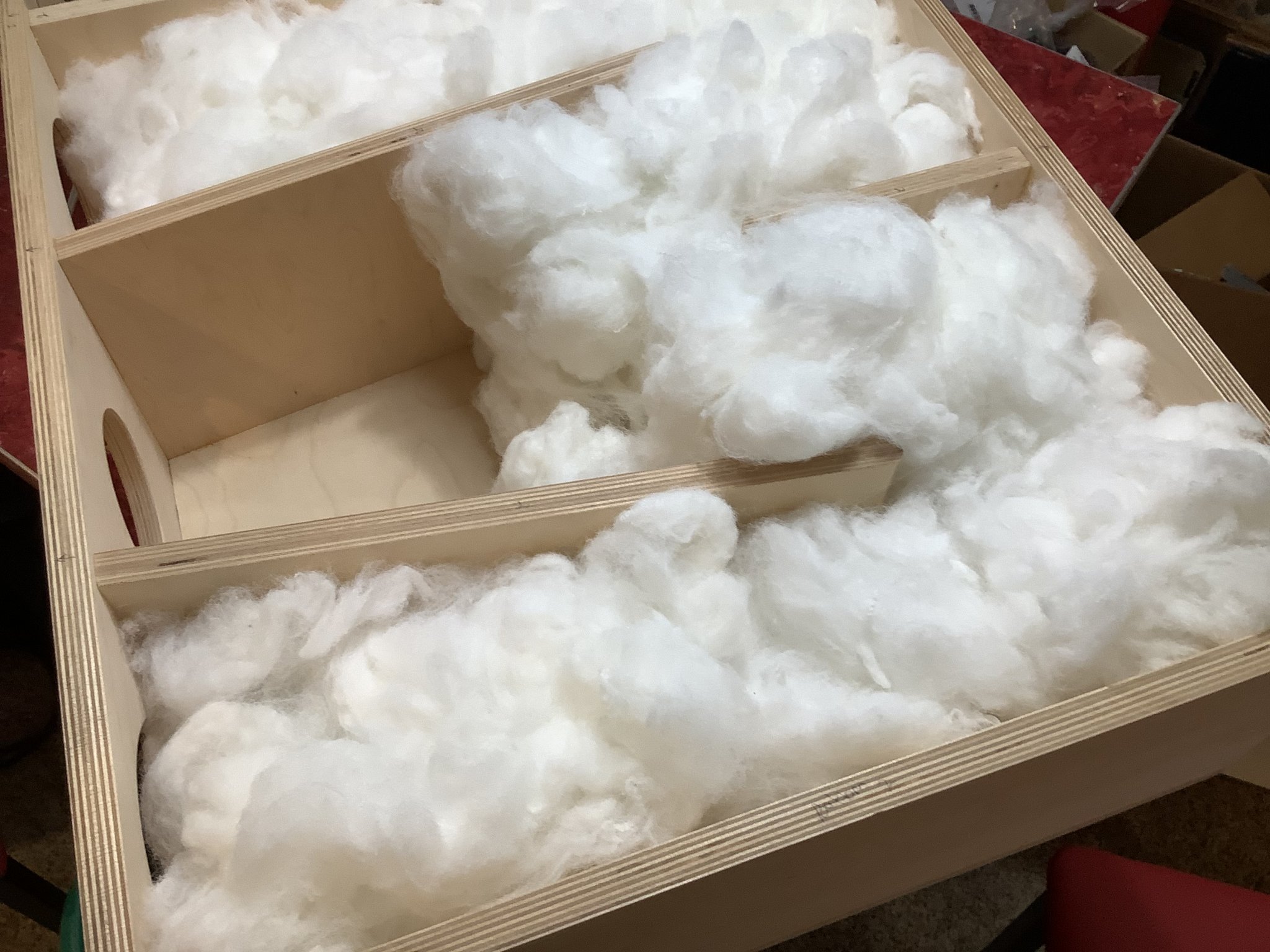

And dave, all your acoustaStuff needs to come out and get properly teased, doesn’t look like you are even close to enuff teasing.With that amount it will take hours to do.

Hi Dave. I did spend hours (Several) teasing the acousta-stuff. But I will check it again. If it doesn't look right to you then thanks!
wolf_teeth. To get the same DCR for the air core inductor as the sledgehammer inductor that came with the crossover board it took 10 AWG wire!
There should be no lumps, it should be very consistent density.
Re Wolf’s comment, i would use much skinnier solid core wire on the A10p. I suggest trying a pair of 24g solid strands pulled from a CAT5/6 cable.

24g solid for the coil, or wiring it up? I never use less than 16AWG for internal wiring, no matter the coils used.
Wolf+teeth: So, I didn't want to use an iron core inductor at all. I will unwire it from the crossover for sure and only use the air core. I didn't want the hysterisis distortion of the iron core. Some may disagree but that was my thinking. The wire you see inside the cabinet is what came with the madisound kit.

Of course it does, as I've done several SXO designs, but going to 24AWG wire is awfully thin. I'd at least use CAT5 evenly split with more conductors than single strands of 24.
davetw, now I understand your methods, and I think your wiring is fine. Of note though, hysteresis distortion is at very high power levels that you'll likely never reach in speakers. For this reason iron cores are okay.
Ferrite or Permite cored coils are however not recommended in this approach, as they saturate very early, and earlier than previously thought considering some recent testing by fellow builders. That said, both of these can impart a midbass 'slam' to the bass region. In my own testing, this is easily accepted by most listeners, but incorrect tonally.
I think your air cores will yield less peaking in the bass, and sound more natural. I would encourage you to try both and make your own conclusions.
