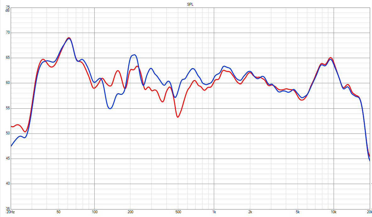

Swapped the polarity on the MarkAudios. The peaky dip at 500 Hz went away but then got some changes between 125-250Hz. Probably need to pull everything and verify the wiring against the schematic. Learning to work with serial xovers as they present differently than the parallel I'm used to.
There must be a way of knowing for sure whether you have the polarity correct. Does the battery test work in this situation?
6sX7, something changed since your measurement yesterday and there are too many differences to trust a comparison. See if you can take the two measurements one after the other.
I attempted a AA battery test when I first wired them up but couldn't discern movement. Reasoning that even with the resistor in parallel with the cap to the Alpair, it wasn't seeing enough DC voltage to really move so I gave up and just used the continuity checker on a DMM to make sure the right xover pads were wired to the right driver tabs. With alanhuth's inquiry I got over my apprehension and grabbed a 9V battery. The woofers definitely hit their limits but I did get enough movement in the Alpairs to find out they are now wired out of phase with the woofers. I had it wired correctly to begin with.

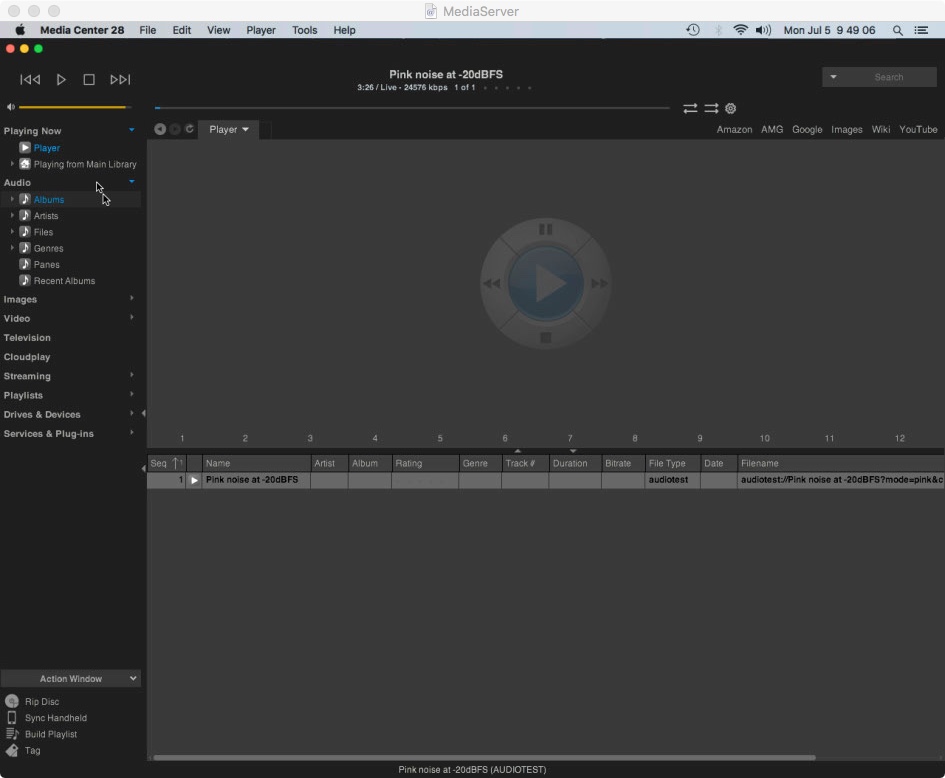

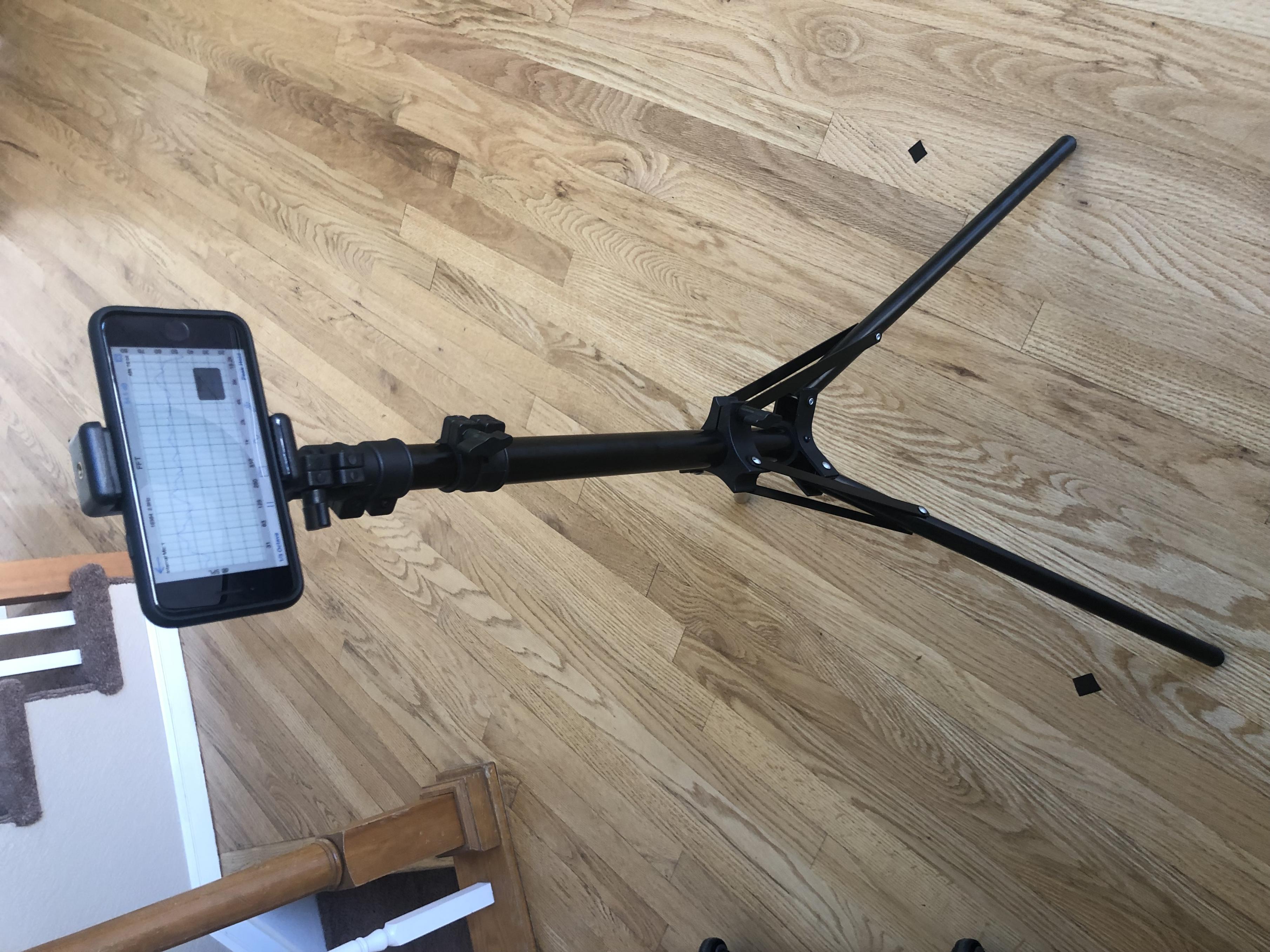

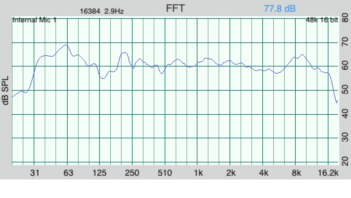

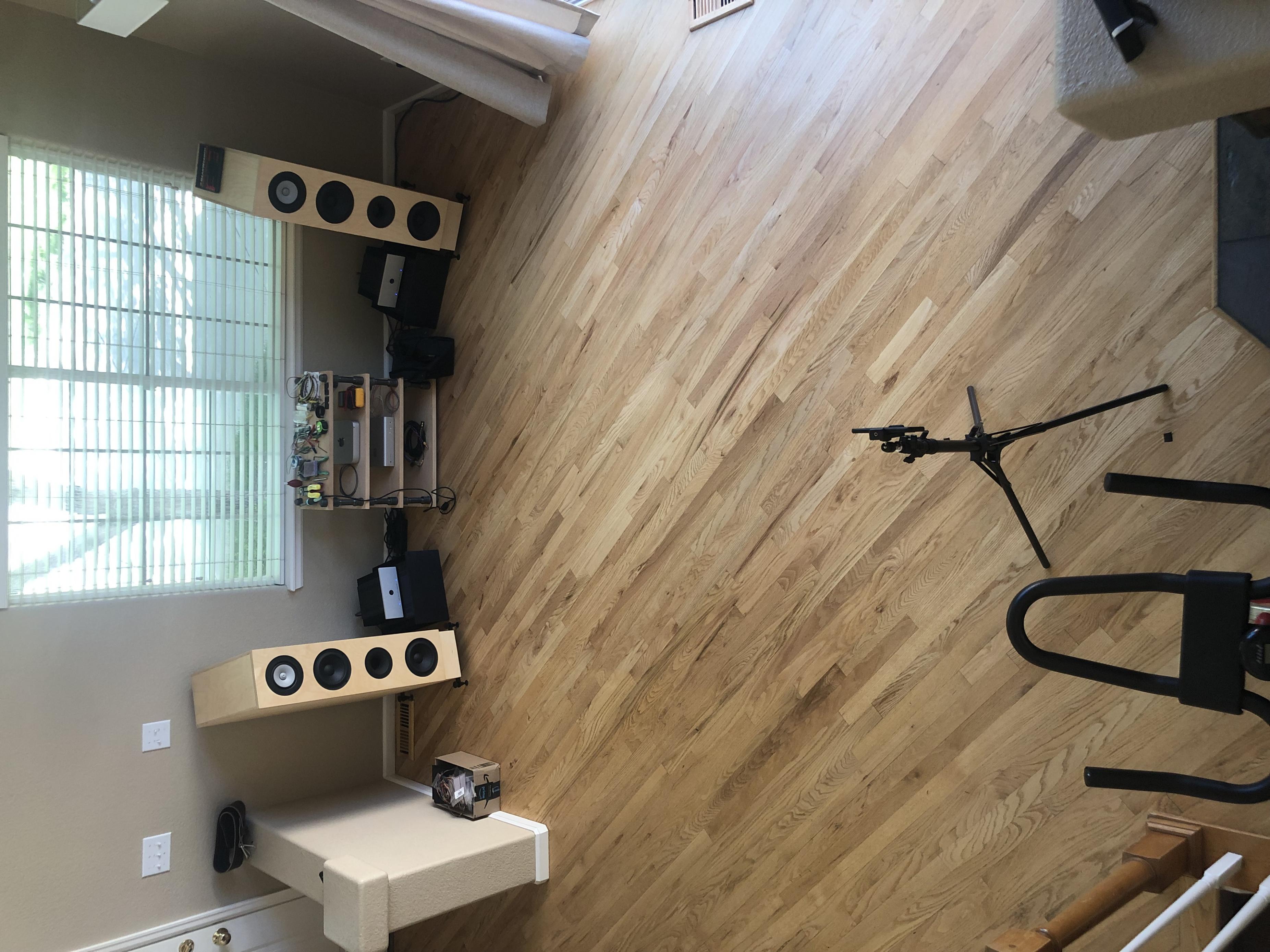

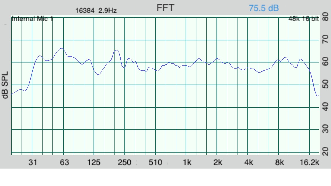

Got a more rigourous test setup done this morning. iPhone 8 running AudioTools set at the listening position (114" slant range from speakers) using internal mic pointed at the stereo rack at ear height (36"). The FFT function of Audiotools was used with peak hold and 1/3 octave smooving. JRiver's MediaCenter generated the pink noise. Pictures of setup attached. Frequency response plots to follow.

I'm still learning the tool and found out I only captured as a screen shot instead of ASCII data. Stuff has progressed so much since I last was deeply involved with the hobby. Pop's is sending me an o-scope and I'm excited about getting a reference mic.

Are you measuring the pair or one tower?
How about moving one to the middle of the room, placed on a stand, and facing a corner, then measure it alone.
Measuring the pair in situ together is a wash.

Unsure what you mean by "placed on a stand" but my next step is to do the rest. Planning to do some nearfield, single speaker measurements later in the week. Need to read up on protocols as I have forgotten much.
If by "placed on a stand" is meant to elevate the woofers to reduce floor coupling, any suggestions on how high and if it'd be better to orient on the side?
the idea is to maximize the distance to any solid surface. The longer that is the lower you can accurately measure.
