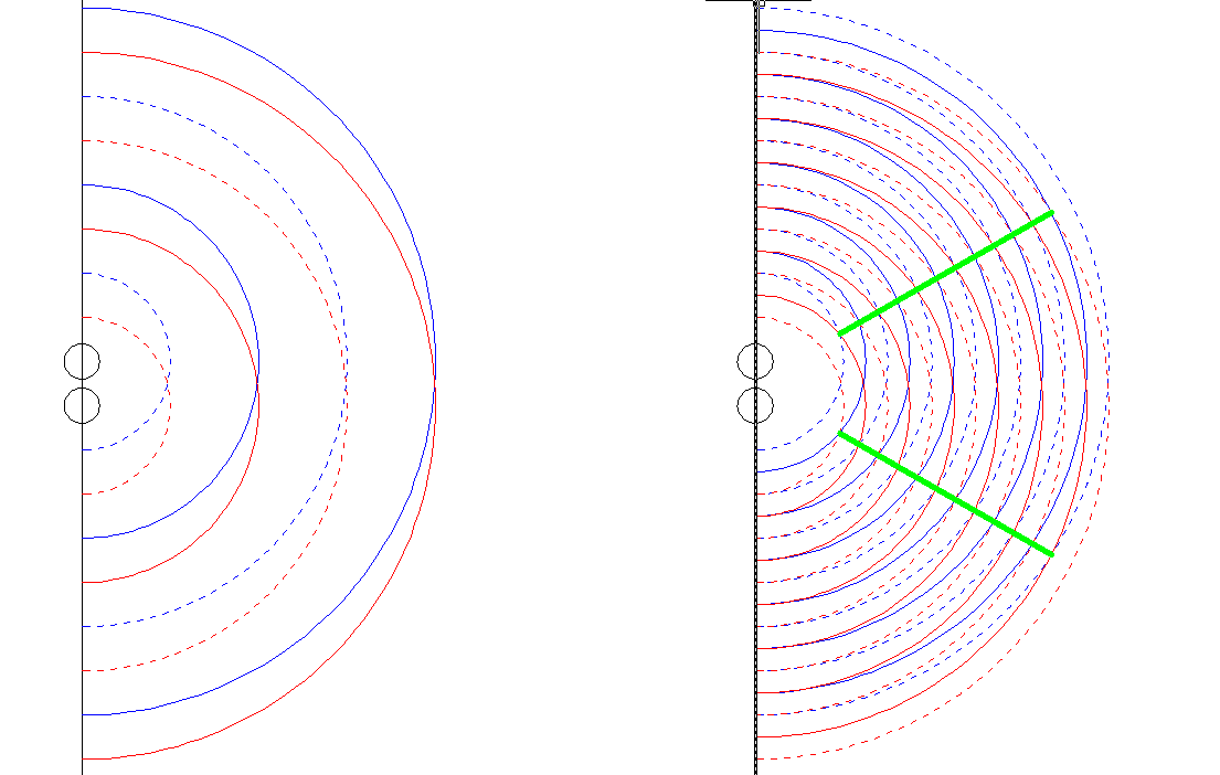

Quarter wavelength spacing is one of the tools used in the process of maintaining controlled directivity, or constant directivity. Using quarter wavelength spacing isn't the only way to pay sufficient attention to this issue. It recognises one of the fundamental concerns with a crossover, and that is the fact that the drivers are not coincident.
I've drawn two situations (attached). The first shows a spacing and frequency which is at a quarter wavelength. Wave polarity is show in dotted/solid lines and these do not completely overlap over the 180 degree vertical span. Compare to the second image with wavelength spacing where you can see cancellations.

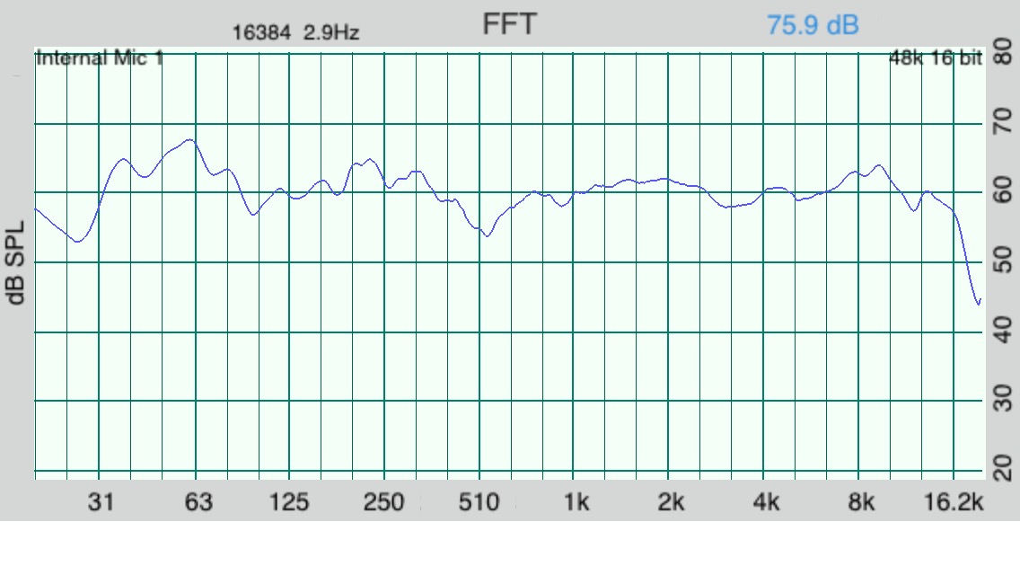

A friend pointed me to a iPhone app audio analysis toolset called AudioTools. I've been meaning to play with it and finally sat down and did some in-room pink noise measurements. The caveats: 1.) it is been a long time since I did any measurement let alone a review of the theory of measurements; 2.) I have no idea how well calibrated the mic is for the software but I was assured it is decent enough.
Given that, attached is the FFT of in-room measured pink noise at the listening position using peak hold w/ 1/3 octave smoothing. I was pleasantly surprised by the overall response except the dip around 510Hz has me curious if I have the MarkAudio drivers hooked up backwards. I would expect the null to be deeper if it were the case. Also, I physically traced the wires and thought it was good but always had doubt in my brain.
Tomorrow, I'll swap the polarity and remeasure to see but in the meantime, thoughts on the driver phase? On overall performance?

Pretty good. You can see the “vintage” top end.
Your ceilings greater than 8’?

Using the iPhone mic. My audiophile friend said it was good enough until I felt like I wanted to invest in a reference mic.
The ceiling is greater than 8', vaulted with a slope to the upper floor. What tells you that in graph? ( I know there is a correlation but my RAM seems to be more random and less accessible these days).
And, yes, I can see the "vintage" roll-off but these 48 year old ears don't hear it. 😉 The top end sounds just as sparkly as the previous Dynaudios I had.
8’ ceilings typically create a 75-85 Hz peak, yours is lower, and one can se ethe slope og the ceiling in the breadth of the peaky bit.
That charachteristic is loved by many, there but not in your face.
