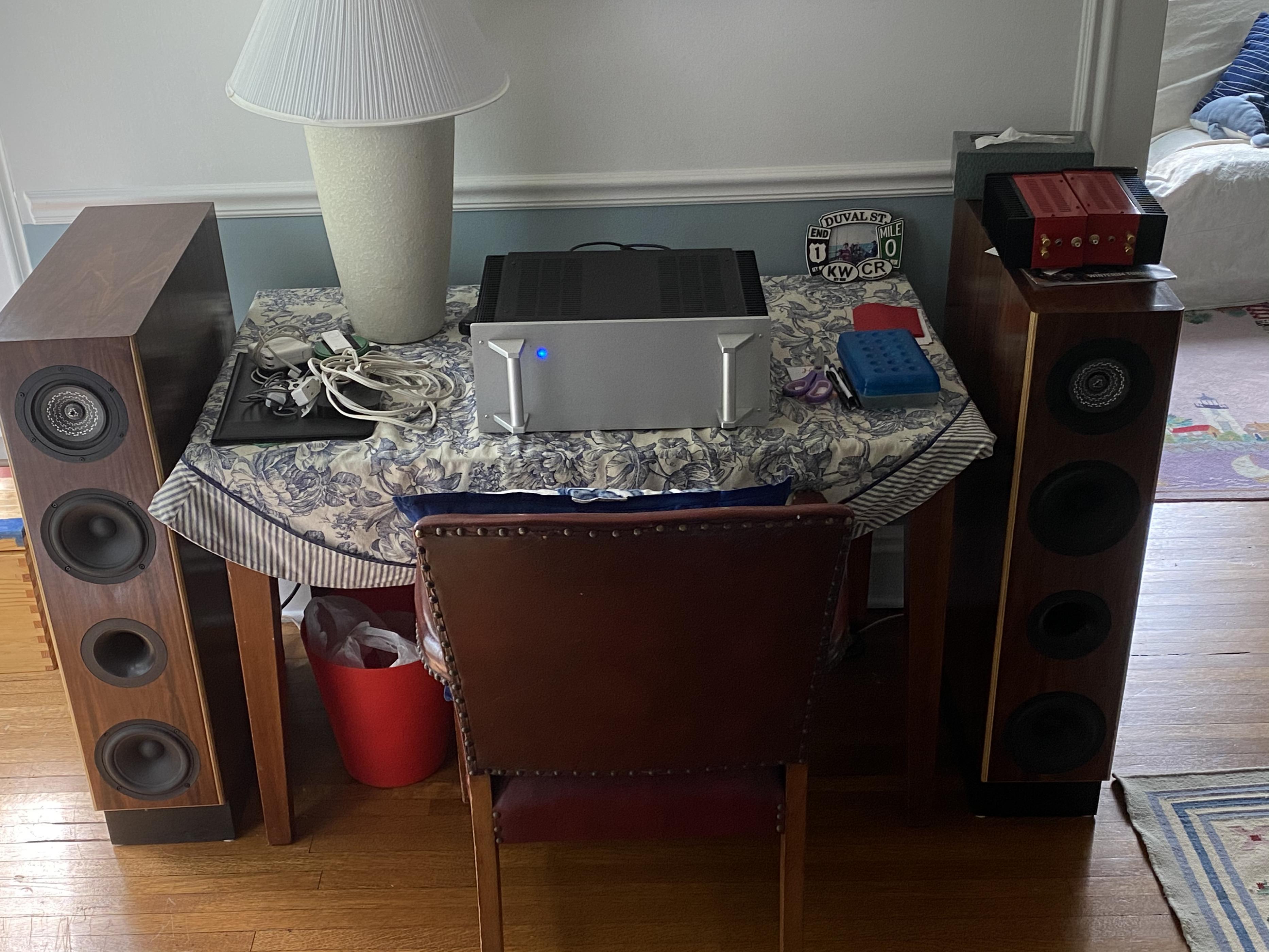

6sX7: Have you seen the 4U chassis in person? That is what my Aleph J is in (see picture above). Notice the comparison to the two ACAs. My point is that the thing is quite large. A couple of them is a lot of floor or shelf space.
