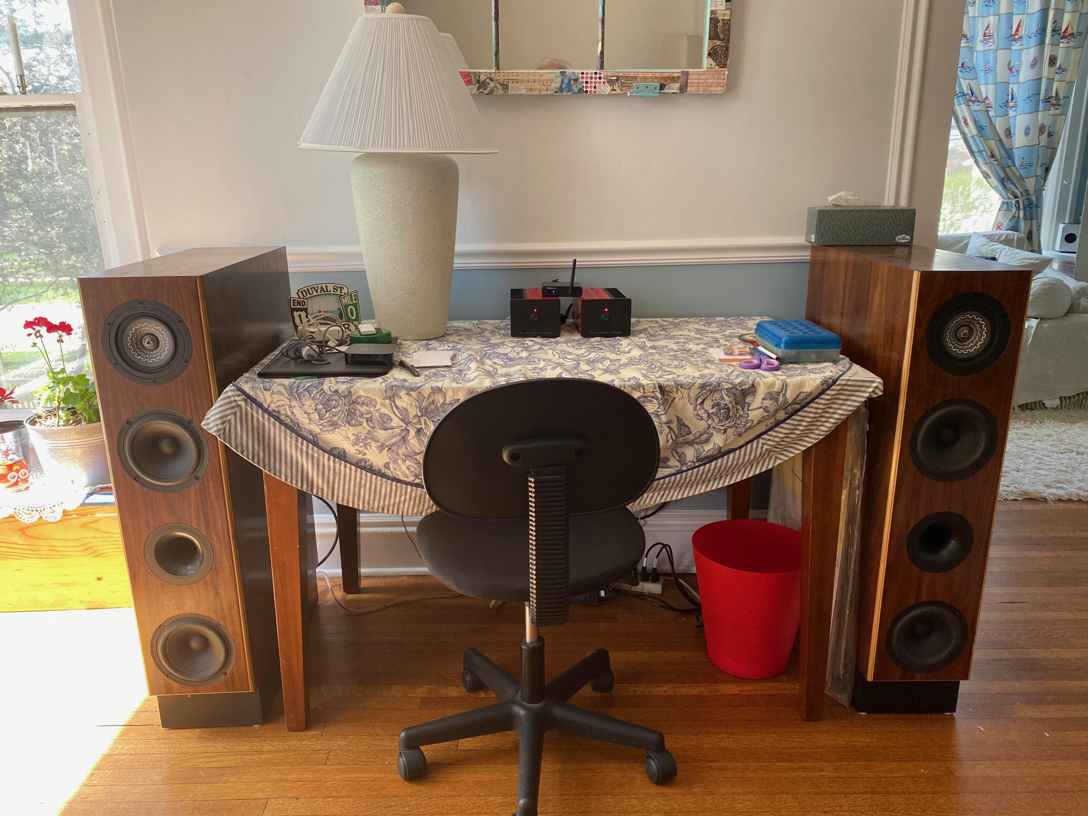

As requested, I tried the Halcyons with the ACA. The sound was good, but not much bass and while the volume was loud enough to be uncomfortable, it was not really "big" as they sound with more powerful amplifiers. 88dB spec seems about right. I ran it off a little bluetooth device from the phone, so no comment on fidelity, but I know it puts out about the same amount of voltage as the DAC in the main system, where the speakers usually play.
I have a decent class D - Purifi (400 watts) and a VTA (Dynaco) ST-120 tube amp (60 watts) and both sound great with the Halcyons, but the ST-120 has the edge. Both go louder than I would ever want to listen, and both have plenty of bass, but the VTA has the tube thing.
I have not really experimented with preamps other than a Schiit Valhalla, which introduced so much hum I had to take it out. Not sure what's going on there because I've run it in other setups with no hum at all.
Any preamp suggestions appreciated.

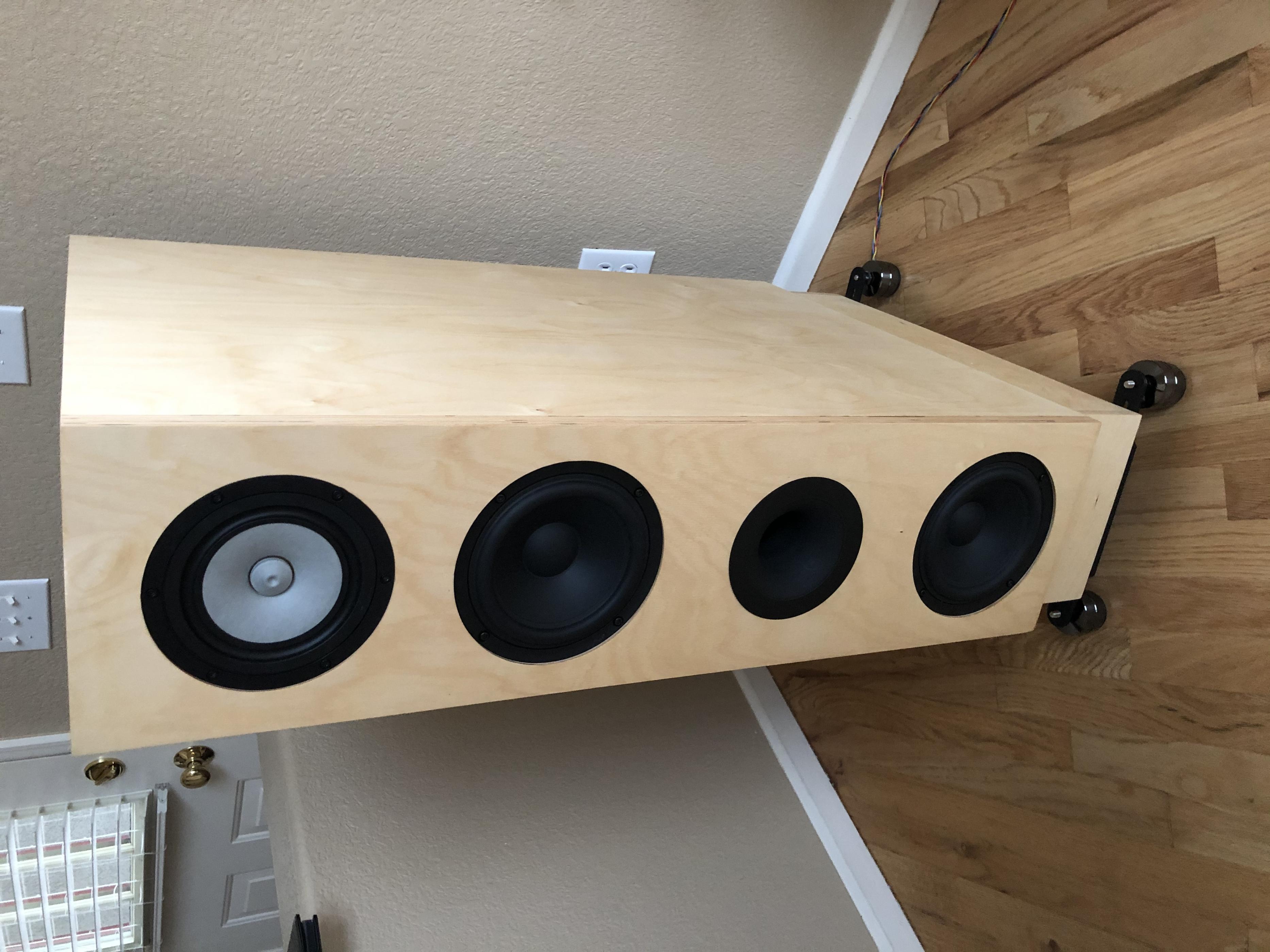

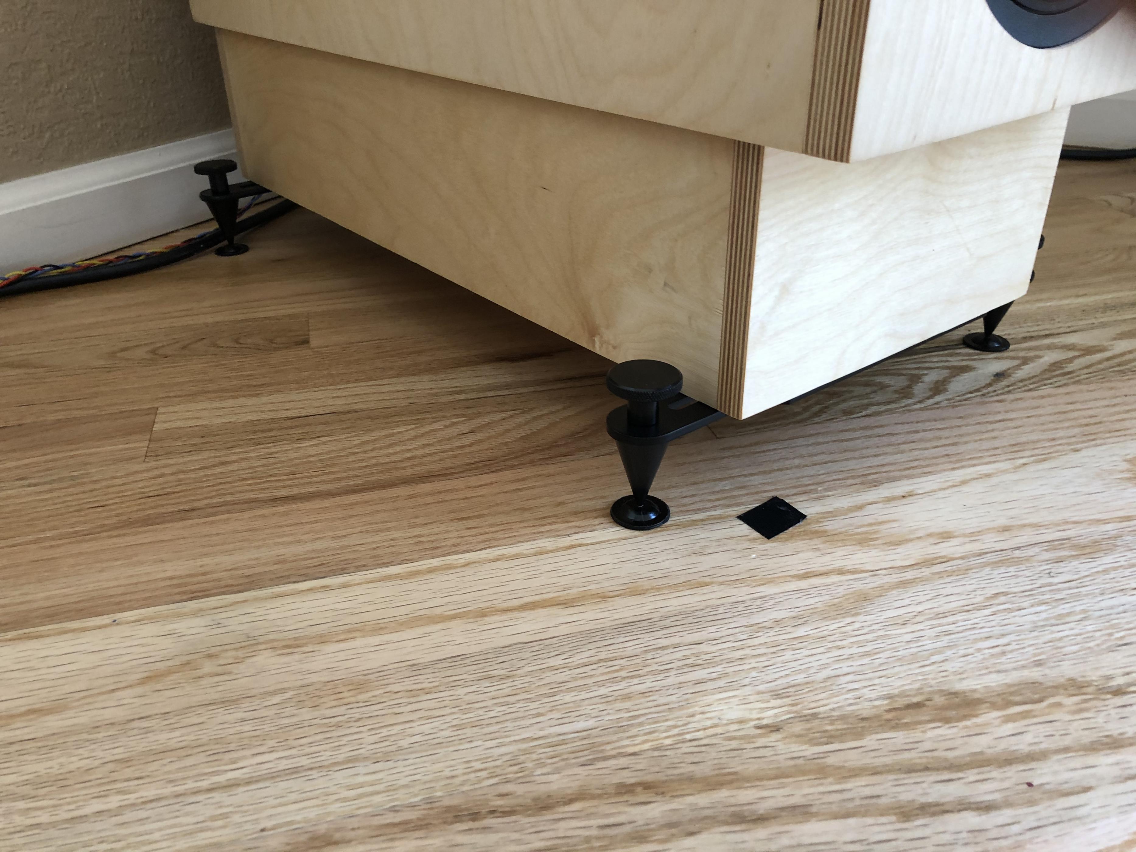

Sent the fancy feet back. Mounted the cone foot kit I got from parts express. $100 later, happy with how they bolted up and anchor the speakers in place. Haven't done any critical listening as I still have to aim them (in both planes) but string bass has a more distinct attack with a woodier sound. Not sure if I need to add anymore stuffing now.
Starting to plan out more of the next Nelson Pass designed amp to build.
-tom

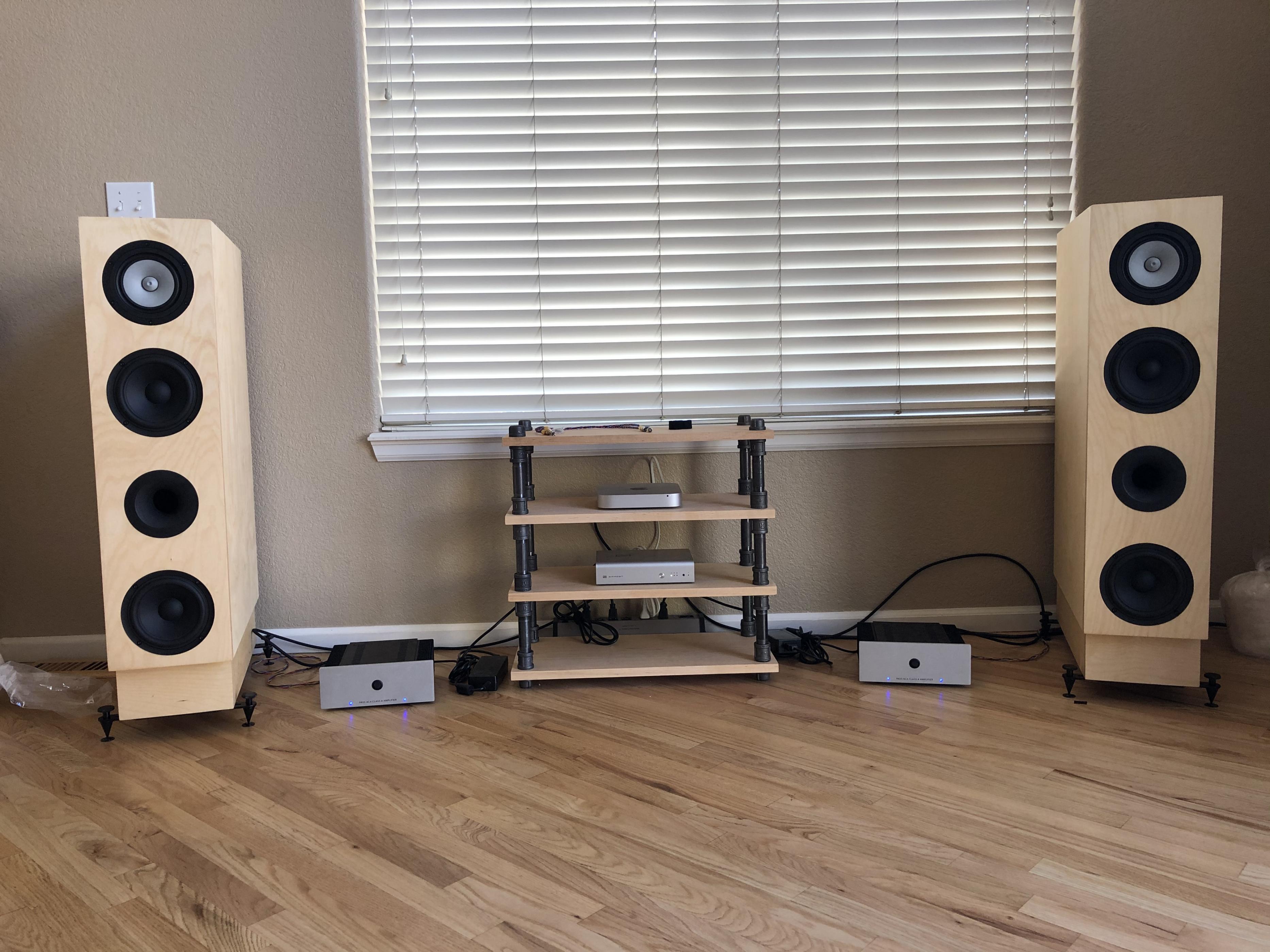

Alrighty, had some fun yesterday and this morning. Got the feet installed. Found the bass to tighten up. Did some measurements and some quick trig calculations and got the Alpairs pointed at my ears. My awesome GF took some time to measure my ear height in the listening chair. (ever since she loaded JRiver remote on her phone, I've found her "reading" in the listening chair quite a bit.) Raised the back end of the speaker 1/4" and there is a bit more shimmer to cymbals, sounding a bit more detailed in the upper frequencies. This morning, hooked up the ACAs in balanced mono. They seem to be playing well with the Halcyons as I still have nice bass with some good slam. There is a bit more spookiness, I'm assuming due to some of the noise floor dropping with CMR that balanced gives. There seems to be more space and a greater sense of floaty.
