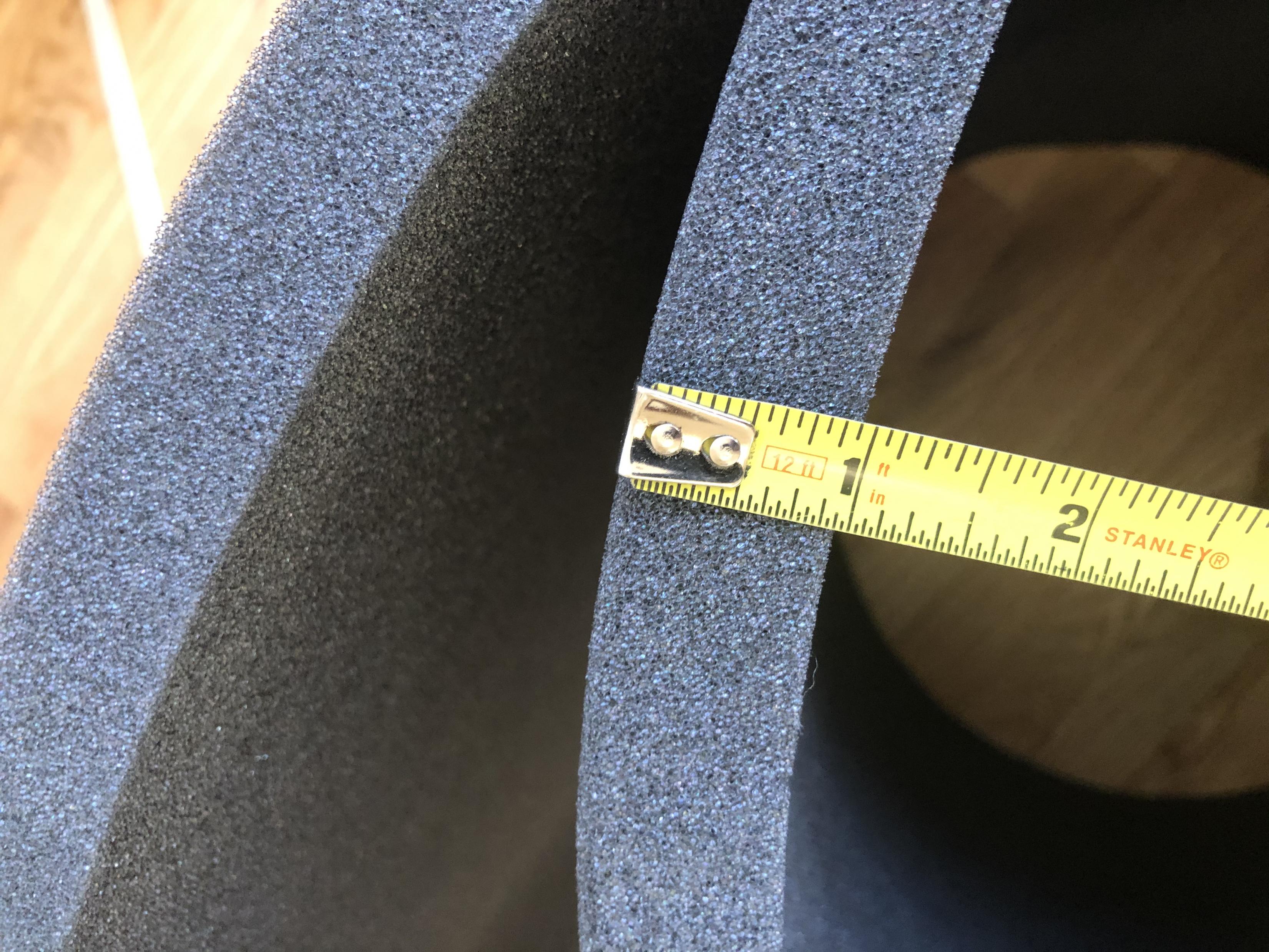

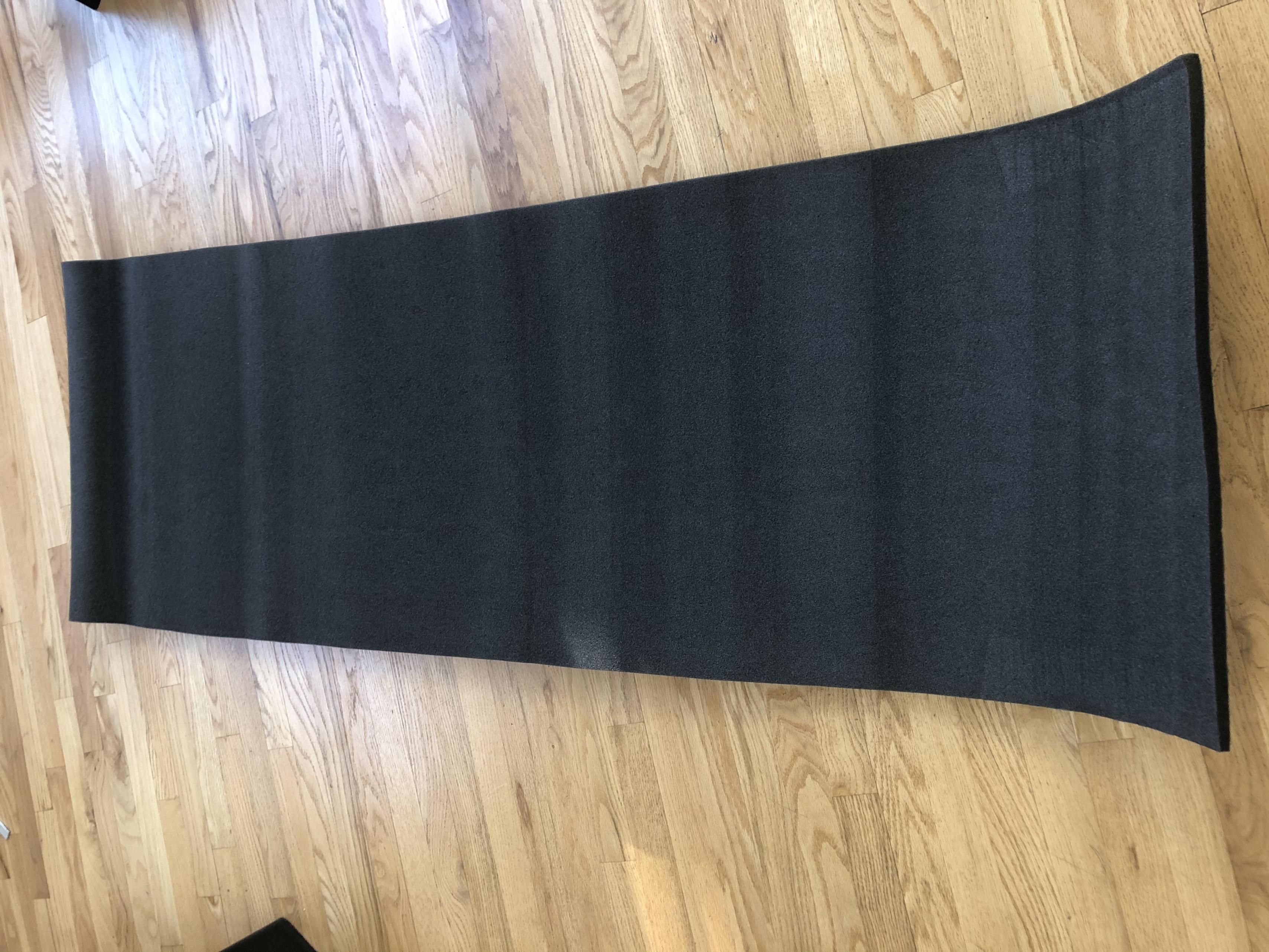

Just stuffed the rest of the fill in for a total of 2.5 lb per cabinet, 1.25 lb behind each woofer. Might be packed too tight. It flows out to the end of the middle shelf. Easy enough to pull back out and refill. Critical listening later tonight but enjoying just having it on.
Definitely tightened it up but there is still authority there. Next up is a feet solution that will pay off if it further tightens the already solid imaging.

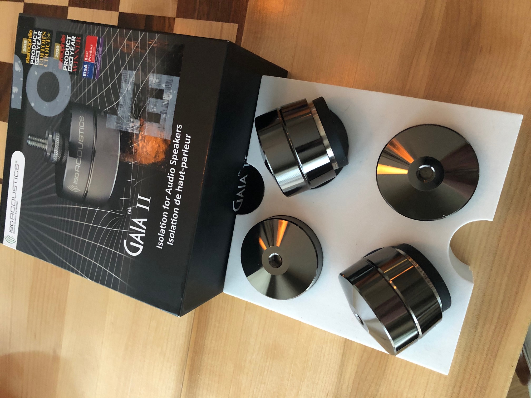

Hoping to get the feet test mounted this weekend. In the meantime, I'm already thinking of more power. Maybe an F5 is in the works. Dunno but I think I'm hitting the limits on those cute little ACAs.

In the meantime, I'm working on mounting those fancy IsoAcoustic feet and upgrading the speaker cables to see what that gets me. Yes, neverending...
