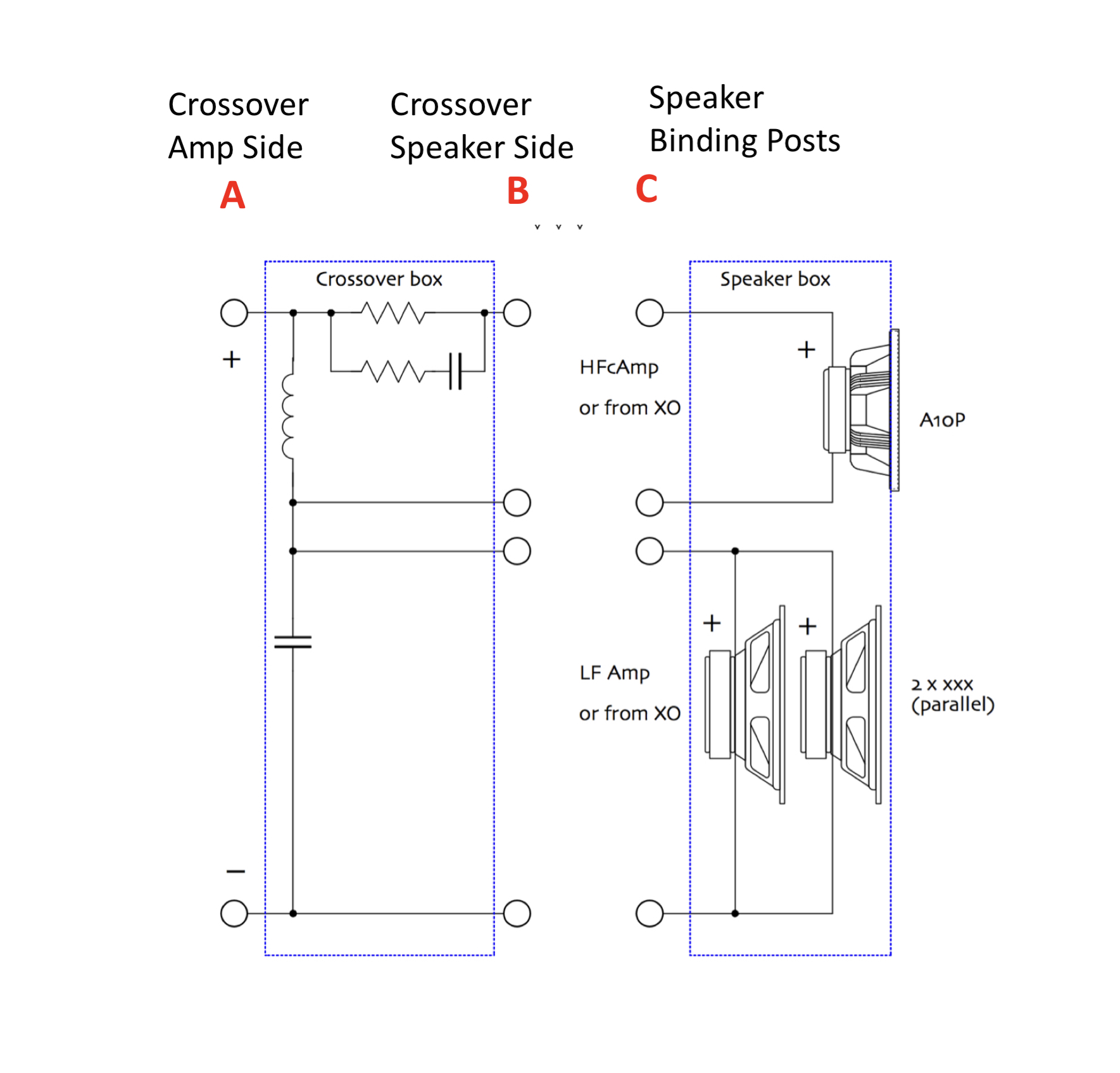

I have also decided to put connectors on the crossover and cabinet so I can directly drive the drivers if I want to experiment with a different crossover or active on at least.

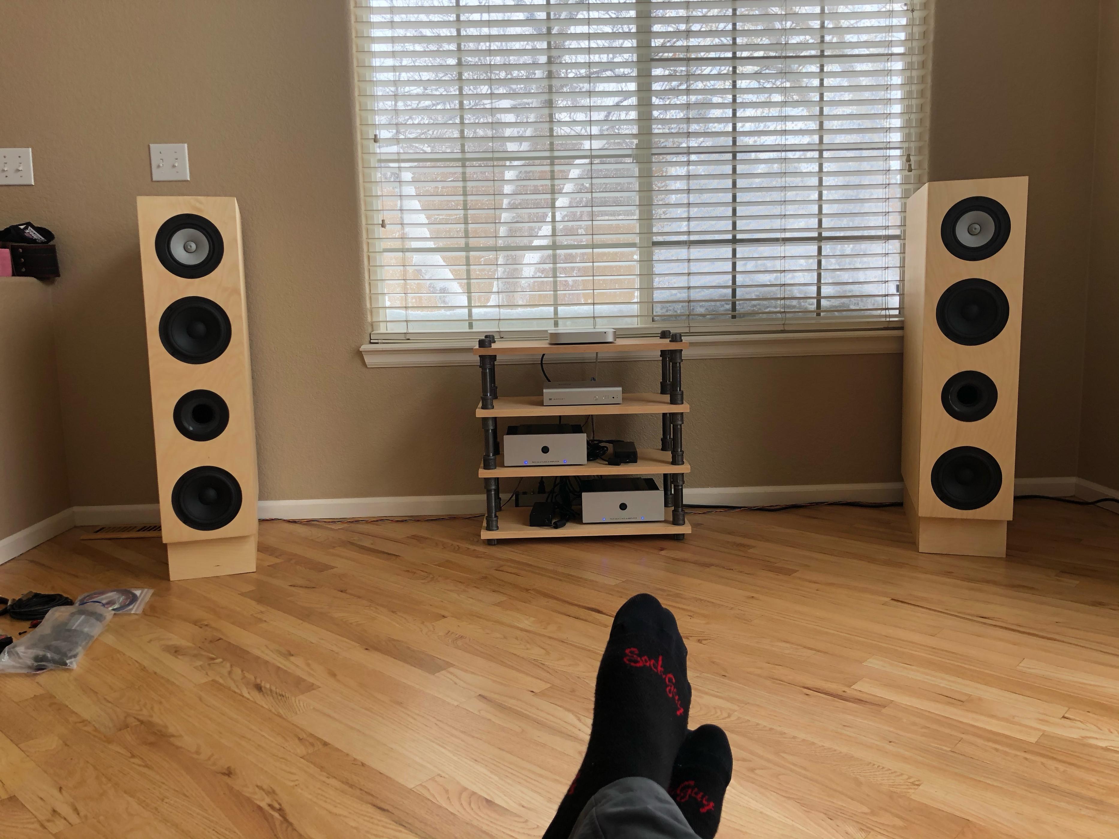

Some further notes after listening all day yesterday:
1. the level of detail is amazing. I was not expecting this even with looking at the frequency response. The use of "Halcyon" and Curt Campbell's write up had me recalling some of the whizzer cone systems I played with as a kid, sounding "whole" but missing that "air" in the top end.
2. I found they do best pointed at the ears. Stereo image becomes very solid once toed in appropriately. I have no acoustic treatments and bare wood floors so results may vary.
3. No contest with the Dynaudios, not even in the imaging nor the top end. I don't think I ever learned to set the Dynaudios up and probably had them on too high of stands. The Halcyon's have an amazing level of detail, air and authority, definitely effortless compared to the Dynaudios and make the room disappear even with eyes open.
4. I changed too many things but had to. The Dynaudios are powered so stand-alone amplification needed to be added. The ACAs provide enough volume to keep me happy but did manage to make the system sound "hard" when I increased the SW gain to see how loud they'd go. No ability to hear how other amplification would sound currently. After experiencing a single ACA in stereo mode Sat night, I went straight to parallel mono on Sunday. The bass tightened up nicely but the E-string on bass guitars is sticking out. Not sure if it is the room interaction or the stuffing. The stuffing is an easy experiment that I'll try later this week.

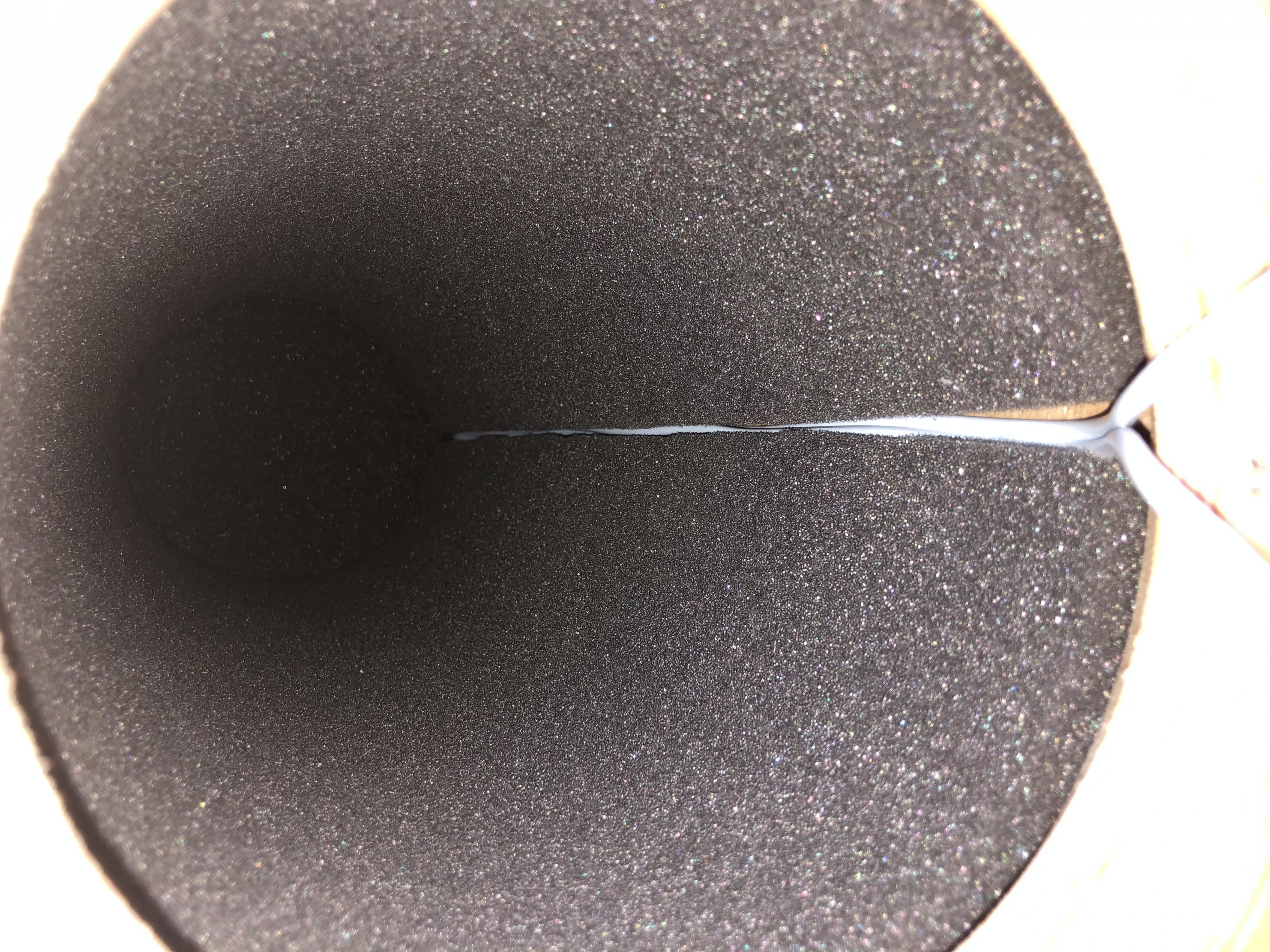

5. I got something to burp yesterday. Not sure if it was port noise or over-excursion. Going to stuff the rest of the stuffing in there and give it another listen.
6. The shine on the ports drove me nuts. I know you want smoothness to attempt to keep things laminar but with the sharp edge on the intake side, I didn't think it mattered that much. Took some 220 grit sandpaper to the ports. Once the weather warms up, will hit them with some flat black rattle can. They are simply pressed in so easy enough to remove to paint and add stuffing.

9. Madisound was not generous on the foam (as previously noted by Alan). The sheet they provide was not the specified 1" and I had enough to line the tube with a channel for the hookup wire and a 1" thick circular plug in the back of the tube. I've ordered 1" foam from Amazon (probably the same seller as Alan bought from) but currently running with the Madisound provided foam. Will do my best to provide a comparison once redone but I'm very impressed with the sound as it is.

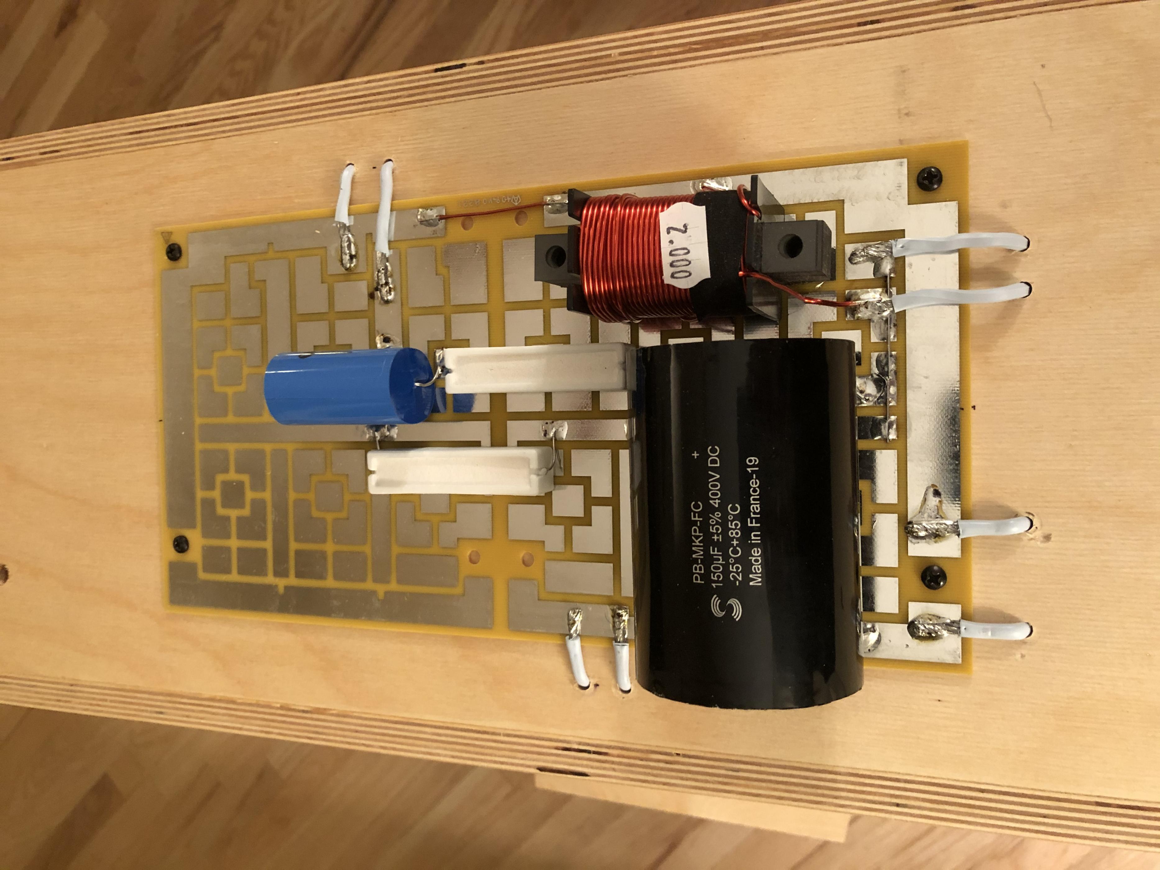

10. I bolted the crossover board to the bottom of the main cabinet and drilled holes for the hookup wire (see picture). I ran the wire from the bi-amp cup for input and didn't even bother with the pedestal cup. I'd do without the pedestal cup cutout if I did it again. Somewhere here, I'll make a cover. I don't have the ease of switching like Alan has but given a soldering iron and some time, I can switch over to an active x-over.
11. I chose the least expensive x-over build w/o electrolytics. Very happy with the result. The plan is to upgrade in the future and listen for the changes. However, with the regular sandcast resistors and Solen cap, these sound phenomenal. Not at all let down with the choice to save a couple bucks.
12. Given the wood floors the speakers sit on, I've found they slide with the slightest pressure. Working on a feet solution with the IsoAcoustics Gaia feet. Will provide a write-up once done. Them damn things are expensive but I liked the results on my Dynaudios.
13. It didn't seem much break-in was needed. I had bought the Alpairs awhile ago as they were going to be the start of a design but then I found Curt Campbell's design. I had run them on the ACAs sans baffles a few months ago when I got the ACAs done to verify working condition. Other than that, the Halcyons sounded authoritative, articulate and detailed on the first hookup. (So, yeah, as I bought the kit, I've got an extra pair of Alpairs sitting around. A nice problem to have.)
All-in-all, very happy and back to enjoying stereo playback like I've experienced with some of my better systems in the past. Thanks for an excellent and fun design Mr. Campbell! Thanks to Bob of Big Wood Studio for the flat pack. And to Alan for the impetus in taking the plunge.
