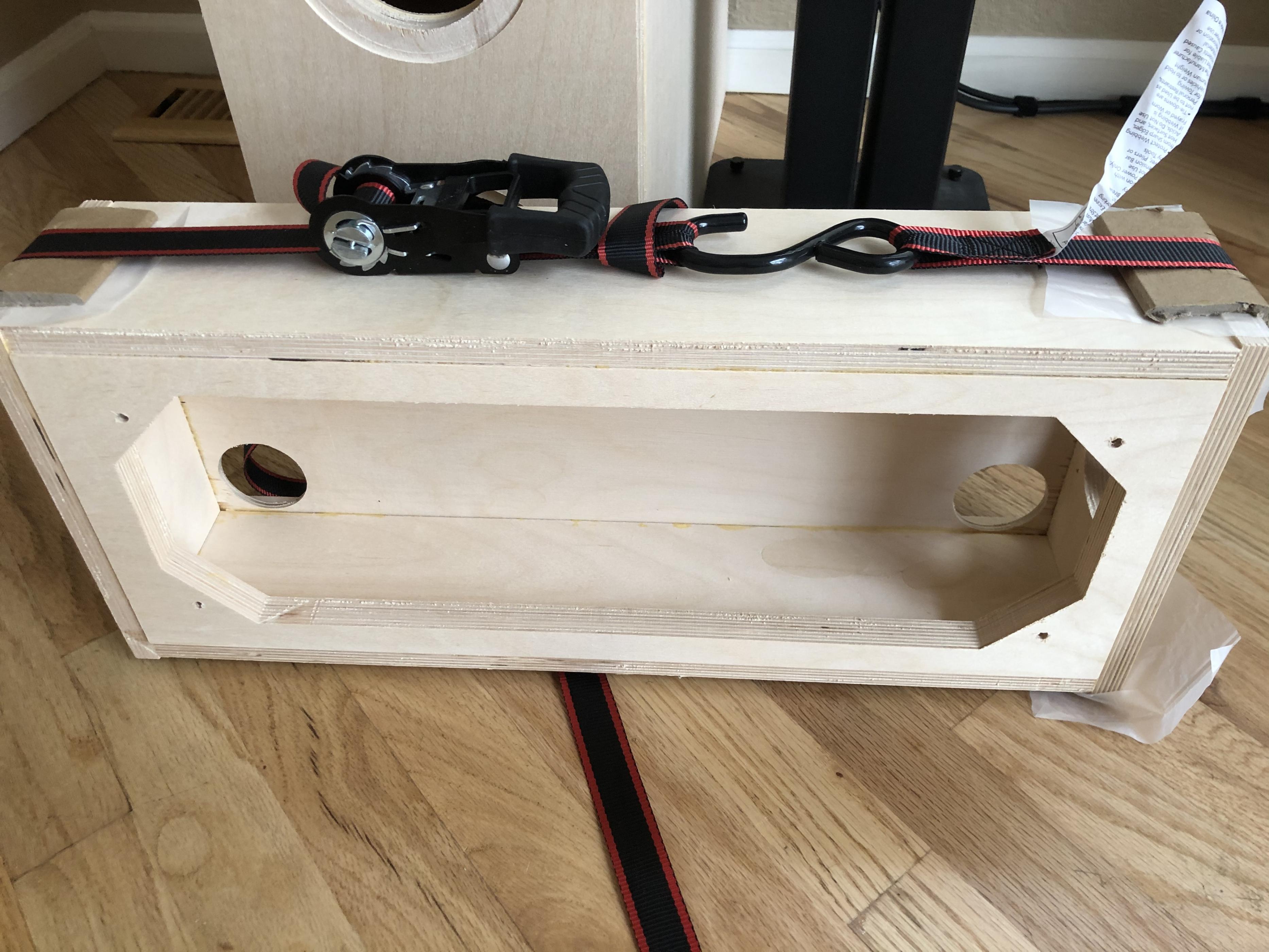

Almost glued up. Finally picked up the right size sonotube. Picked up the smallest I could find assuming it was the right size and got it home to find out it was the next size up from the smallest. Finally got back yesterday with a tape measure.
My glue job is not a good as I wanted it to be but best I could do with the tooling I had at hand. If I was a bit more stationary, I'd have quite the nice wood shop.

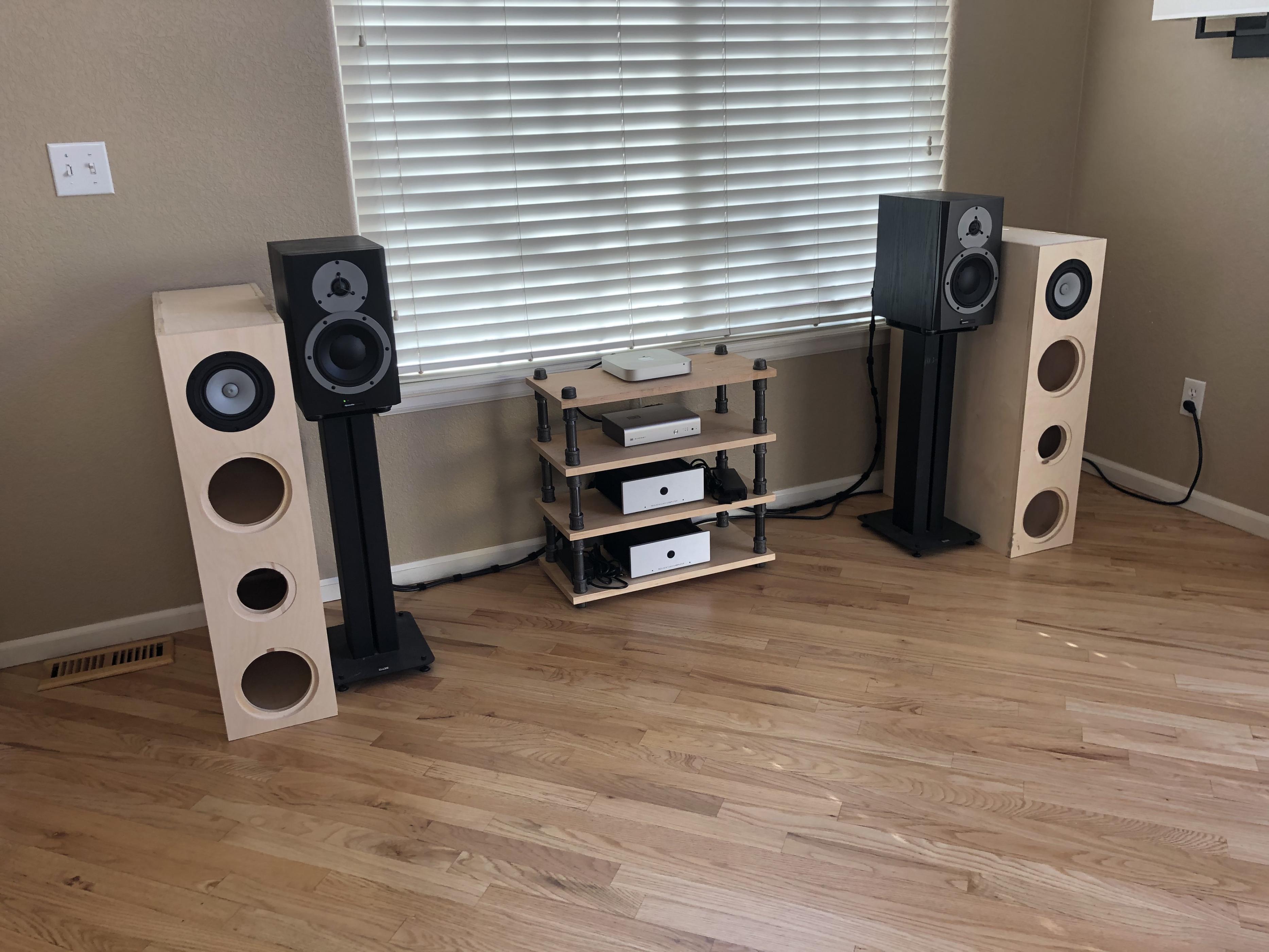

So, yeah, hoping to get the side panel glued on each cabinet this weekend. Then it is waiting for the kit to arrive.
Pair of Dynaudio BM6A MkII, powered studio monitors. They've been great for a small system. Going to be interesting to see how they compare.
I purchased a cabinet flat pack from Bob of Big Wood Studio. Made things much easier. They glued up pretty good given I used ratchet straps for clamping. Some minor sanding and they should be good.

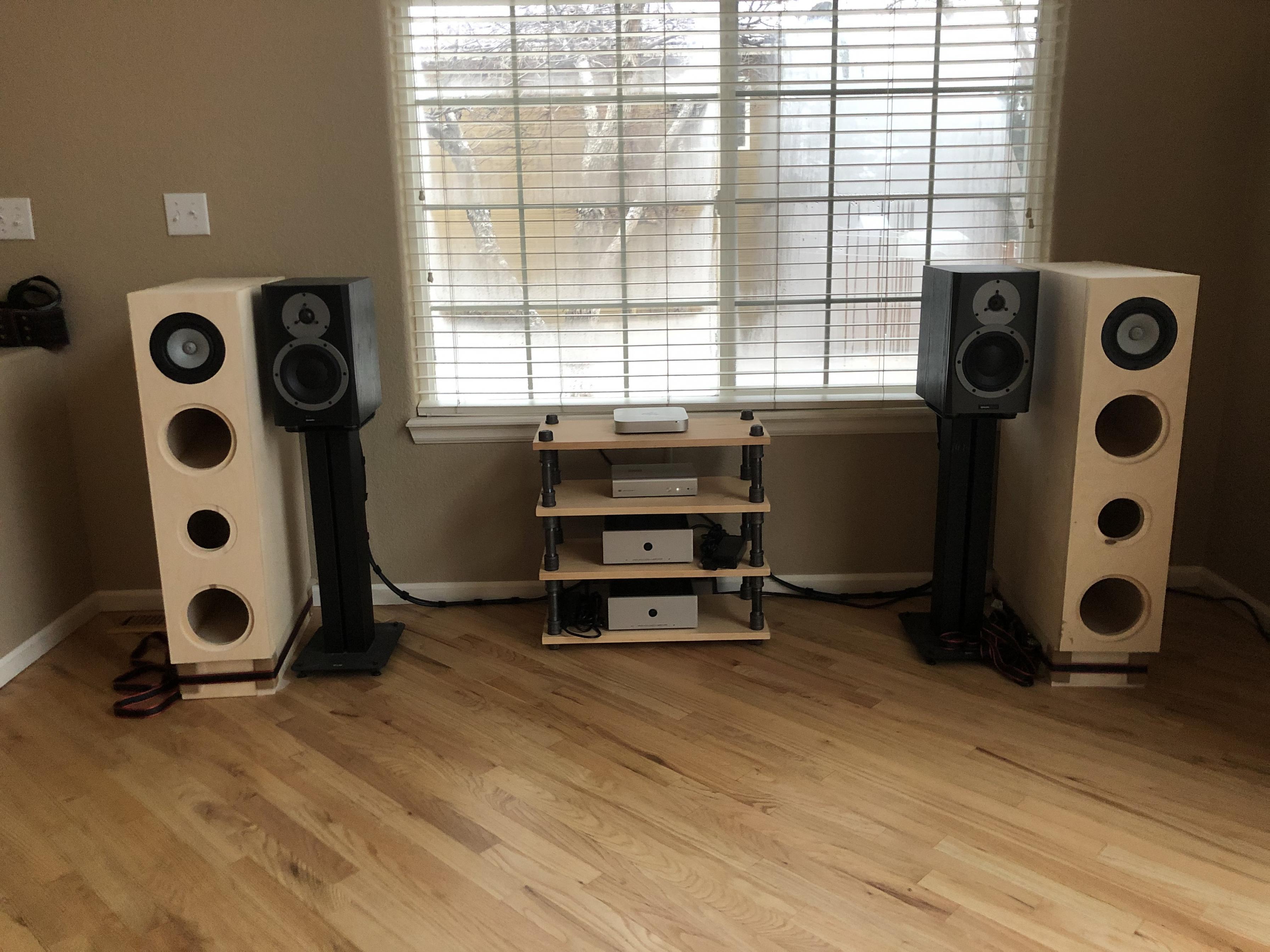

Got the pedestals glued up. Using ratchet straps for clamps has proved pretty capable. Same height and width as my current setup but definitely more imposing. Need to run by Ace to pick up some bolts to get the main cabinets mounted to the pedestals.
