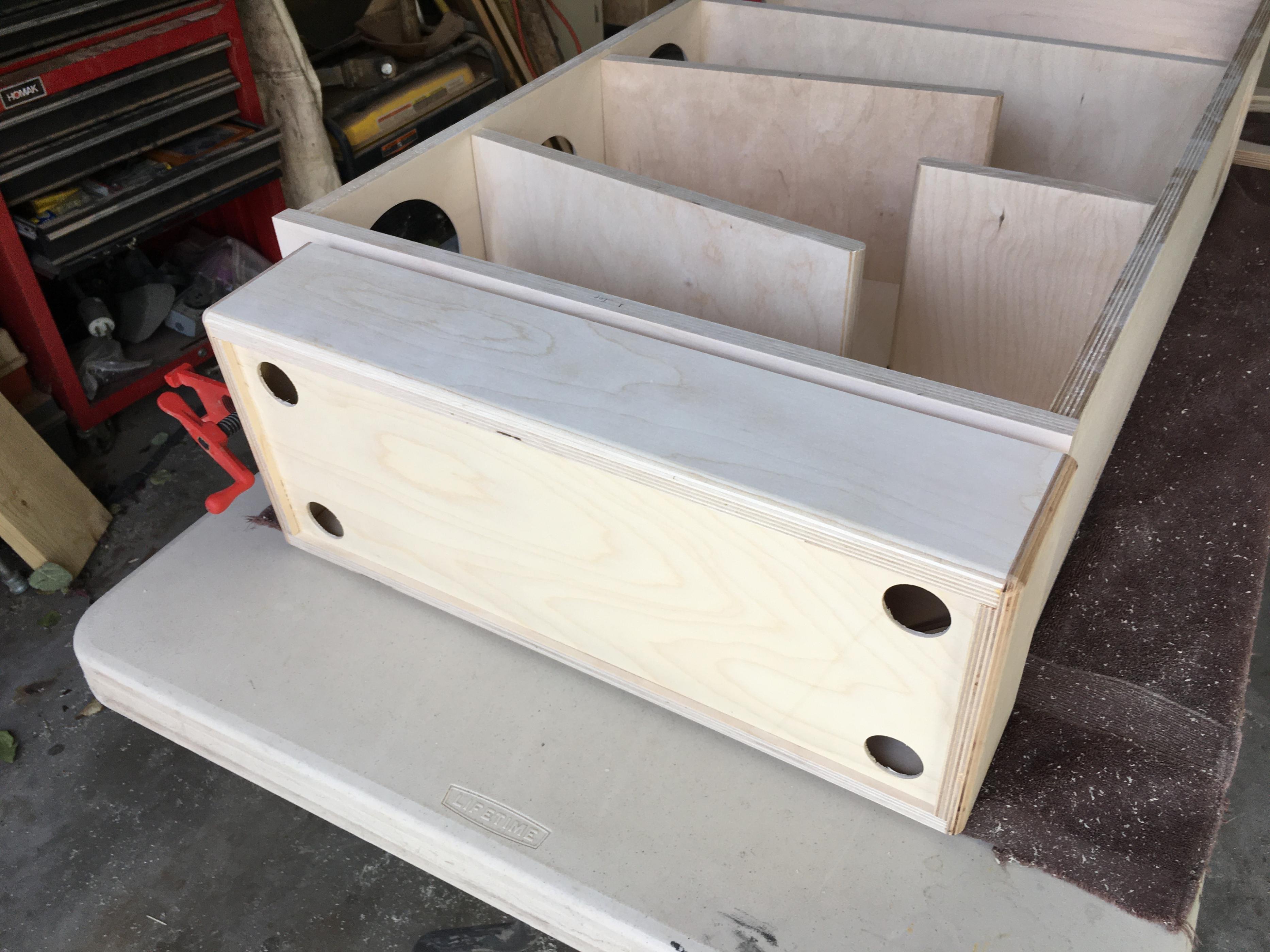

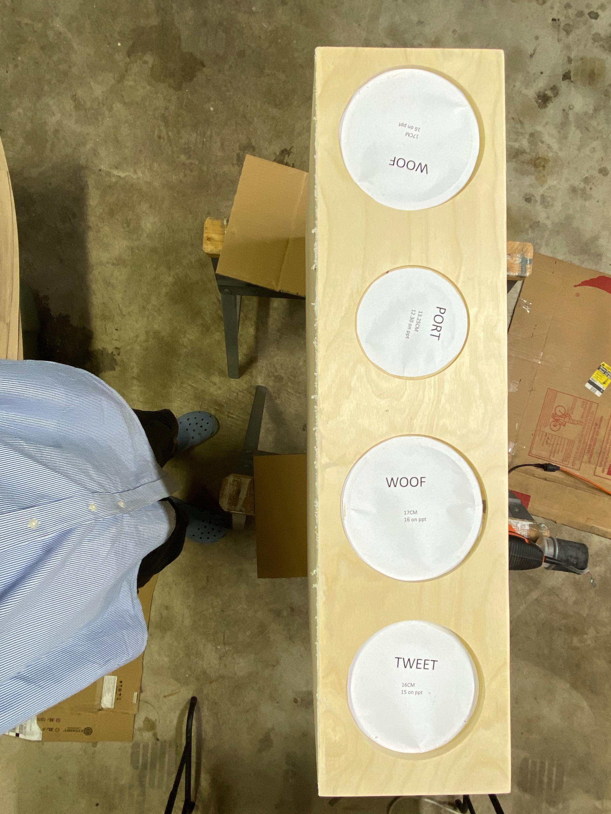

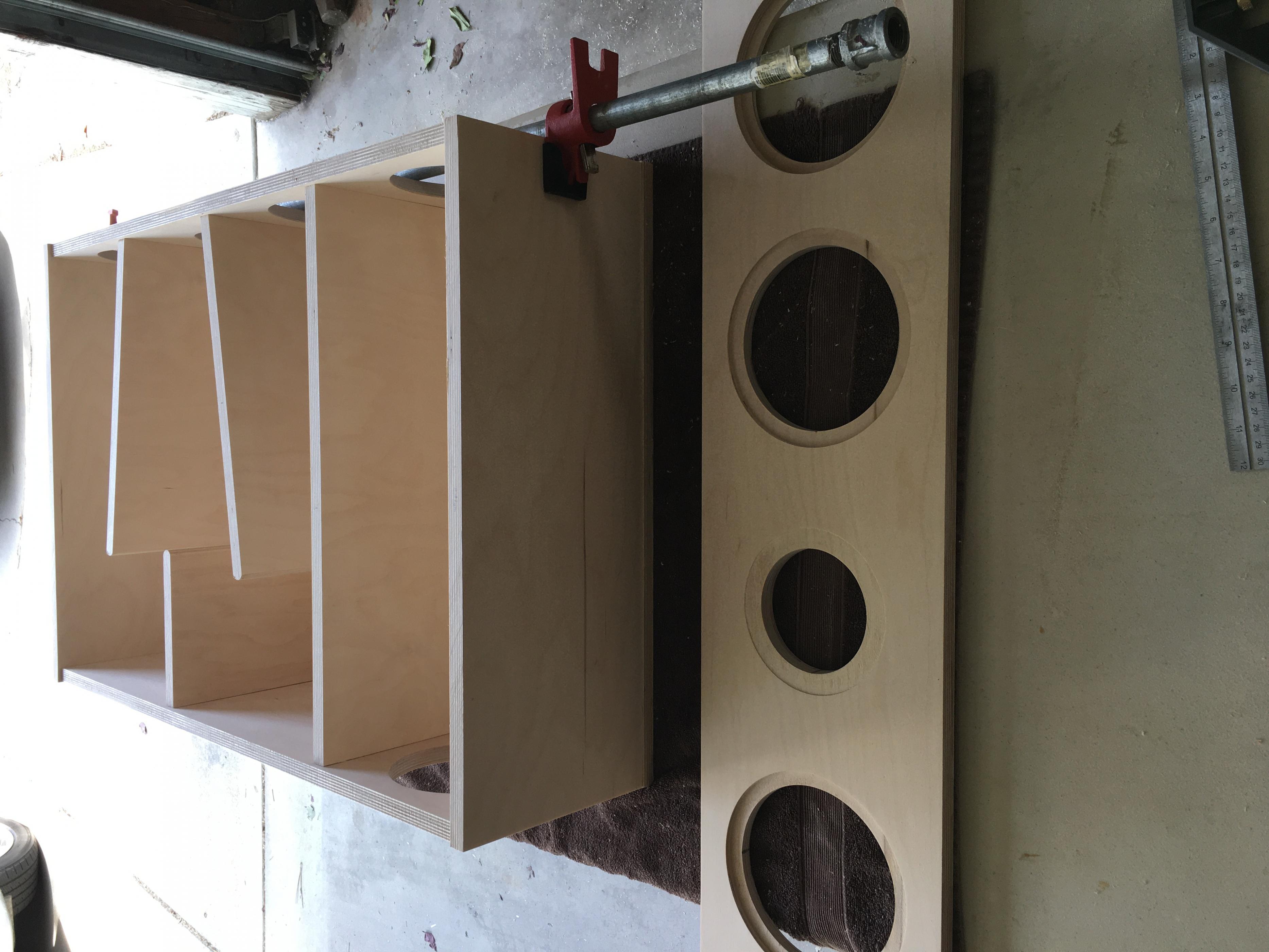

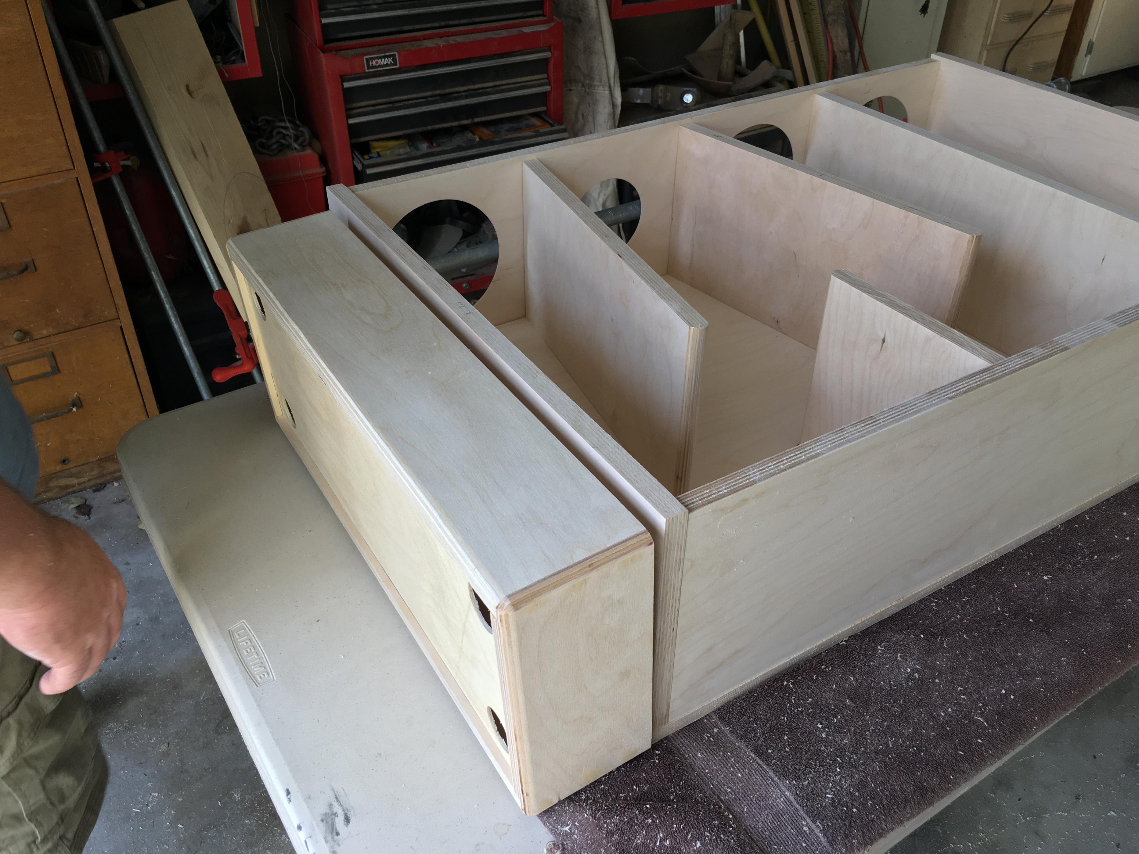

Halcyon Dry Fitting sanding and planning
Last Saturday my neighbor woodworker and I did a dry fit on one Halcyon cabinet. My neighbor spent a lot of time sanding and smoothing all the pieces and especially the tapered backside of the drivers which he hand-sanded to be super smooth.
I will probably seal them with titebond as George Short recommended when I built my North Creek Kitty Kat bookshelves.
He also rounded off the edges of the TL baffles to smooth out that transition and generally went over all the pieces. All parts fit very well except the back which is a tiny bit short, but easily fixed.
We also built up the one base that bobbrener designed and provided as part of the flat-pack.
The next step is to build up the two crossovers in the bases and figure out a connector between the base and speaker proper so the base can be removed for crossover experiments. Then the routing of the internal wiring is next before we start gluing up.
It is finally underway!

Btw, regarding gluing the box and assembly, I like to glue the pieces on to one side and make it like an open "tray". After that I line the inside as required, do the internal wiring, put in the poly-fill and place the XO inside the cab (if required). Once all of that is completed and I am satisfied, I glue on the other side.
I am sure you guys know what you're doing, just sharing my experiences. 🙂
