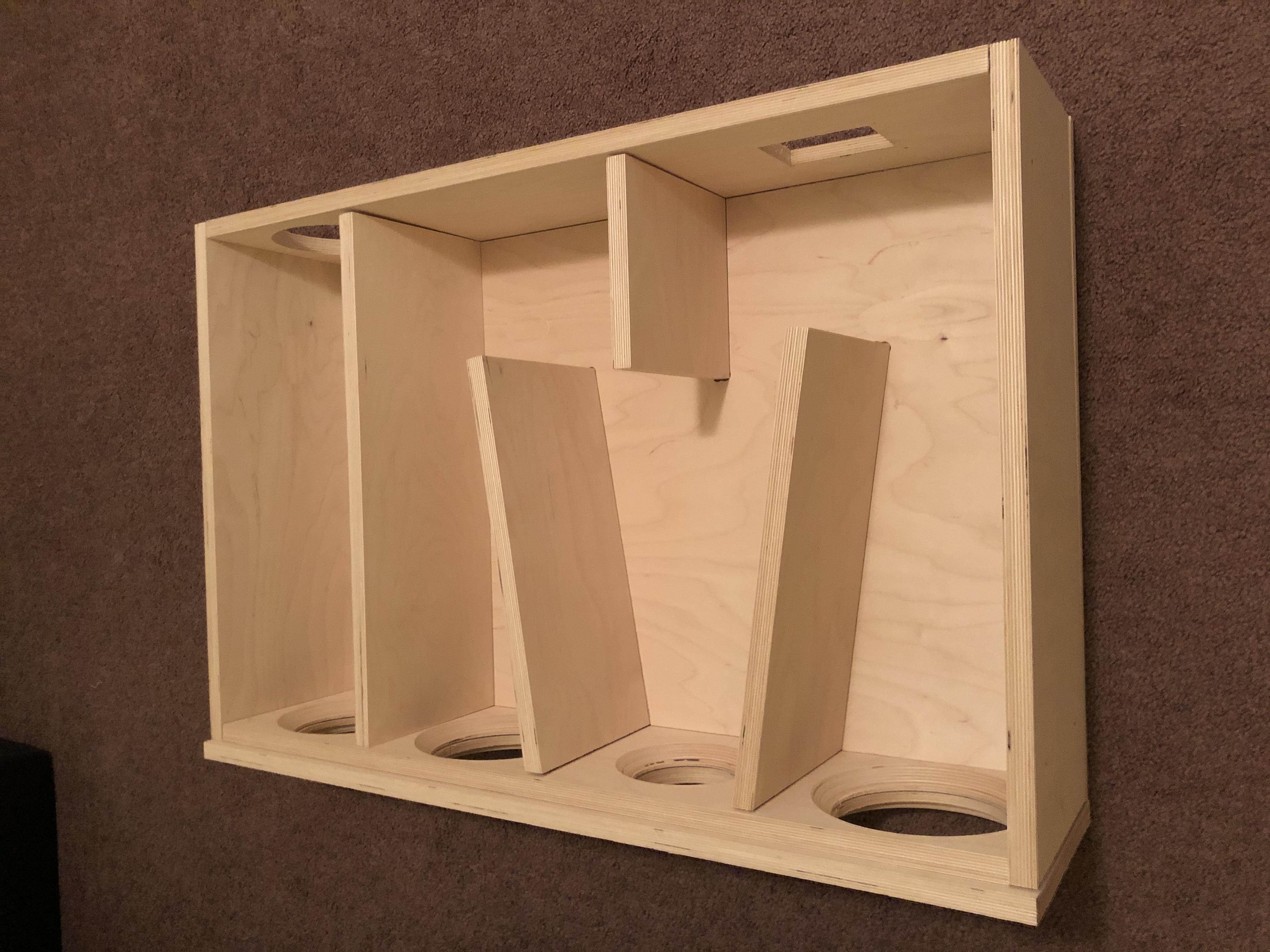

We are ready to install the sonotubes and other interior parts before putting on the sides. Where did you obtain the sonotubes that are the smallest of the 8" diameter size. I am going to try a concrete tool and form supply place here in SLC, but I curious where other builders were able to locate.
It is a little tough during COVID-19 to go to a lot of stores to find the smallest diameter which is 7.5" x 7.5" as in the instructions.

I got. mine at Home Depot. You need to go through the inventory they have with a tape measure and find the one with the right diameter. I ended up with ones that were just a little large for the “box” and they were compressed to fit. Curt said that’s ok.

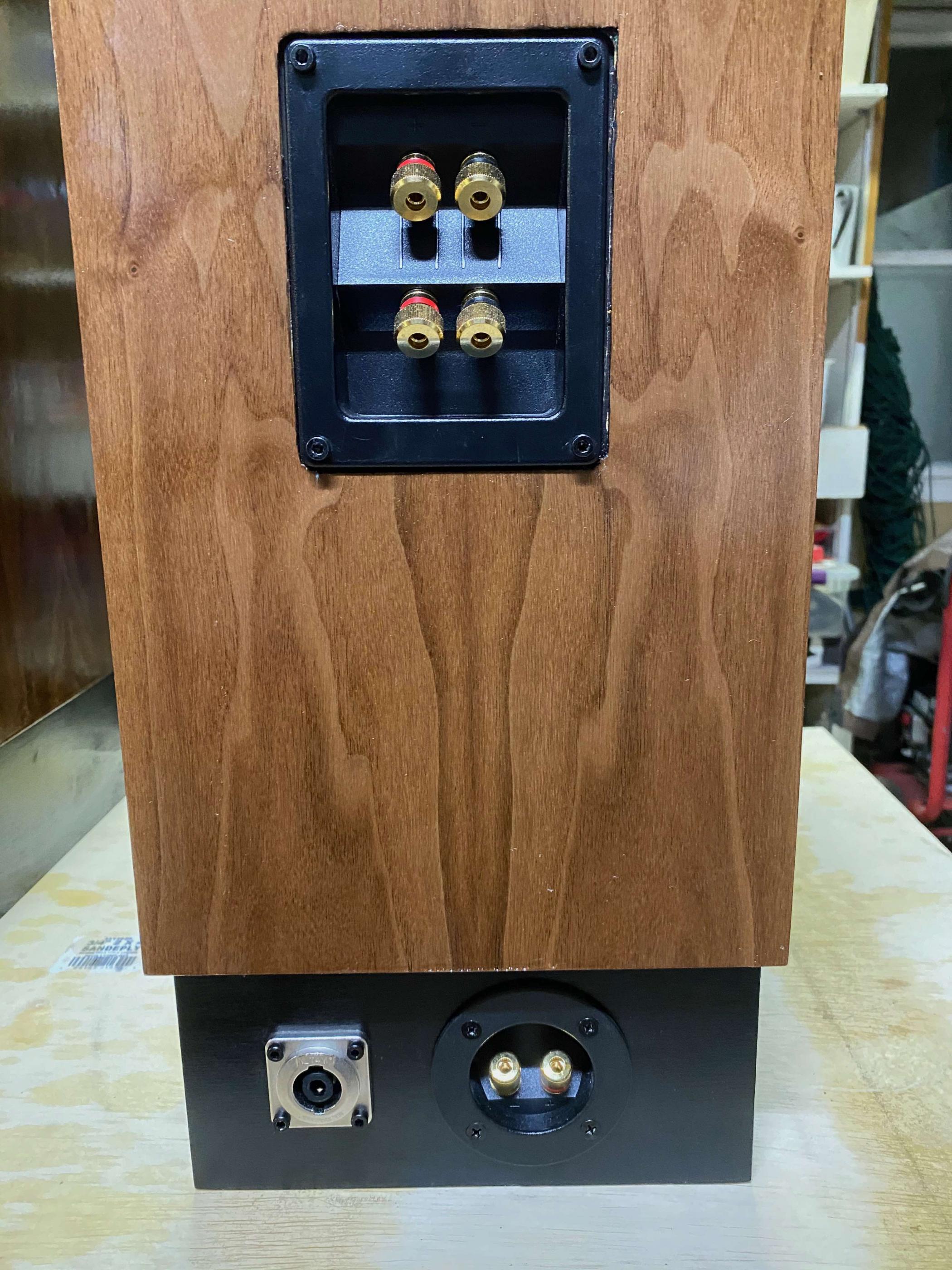

This week we did a dry fit of all drivers on our front baffle. They all look good with just a small adjustment for the bass port. The next thing is to build the crossovers into the base unit.

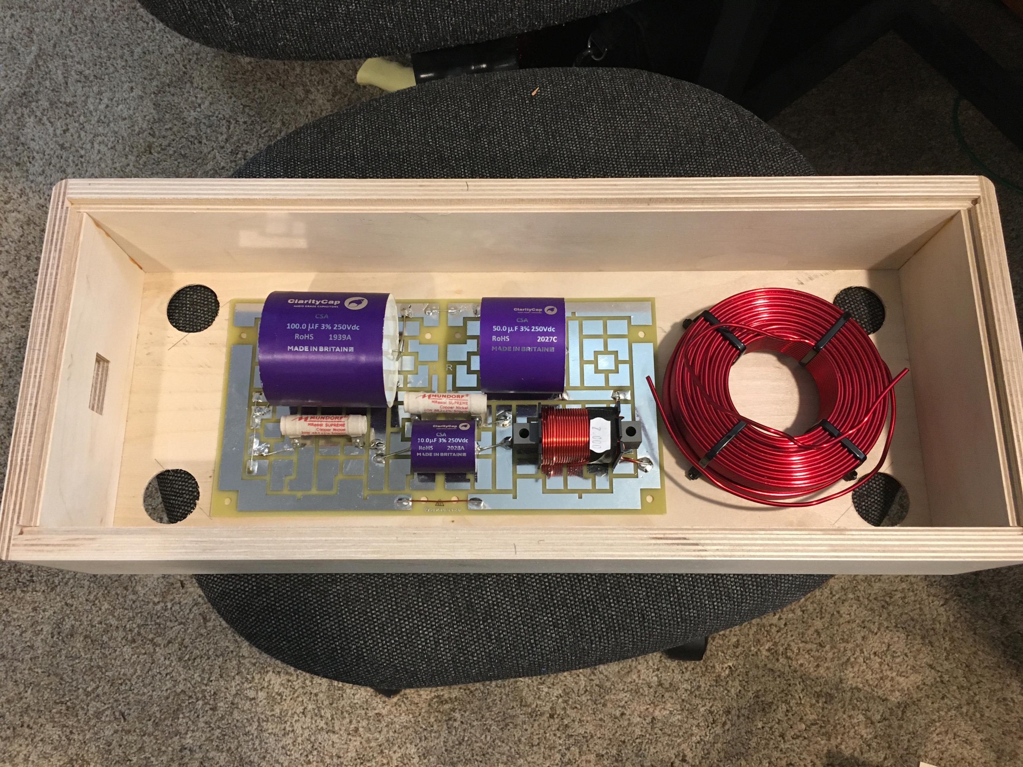

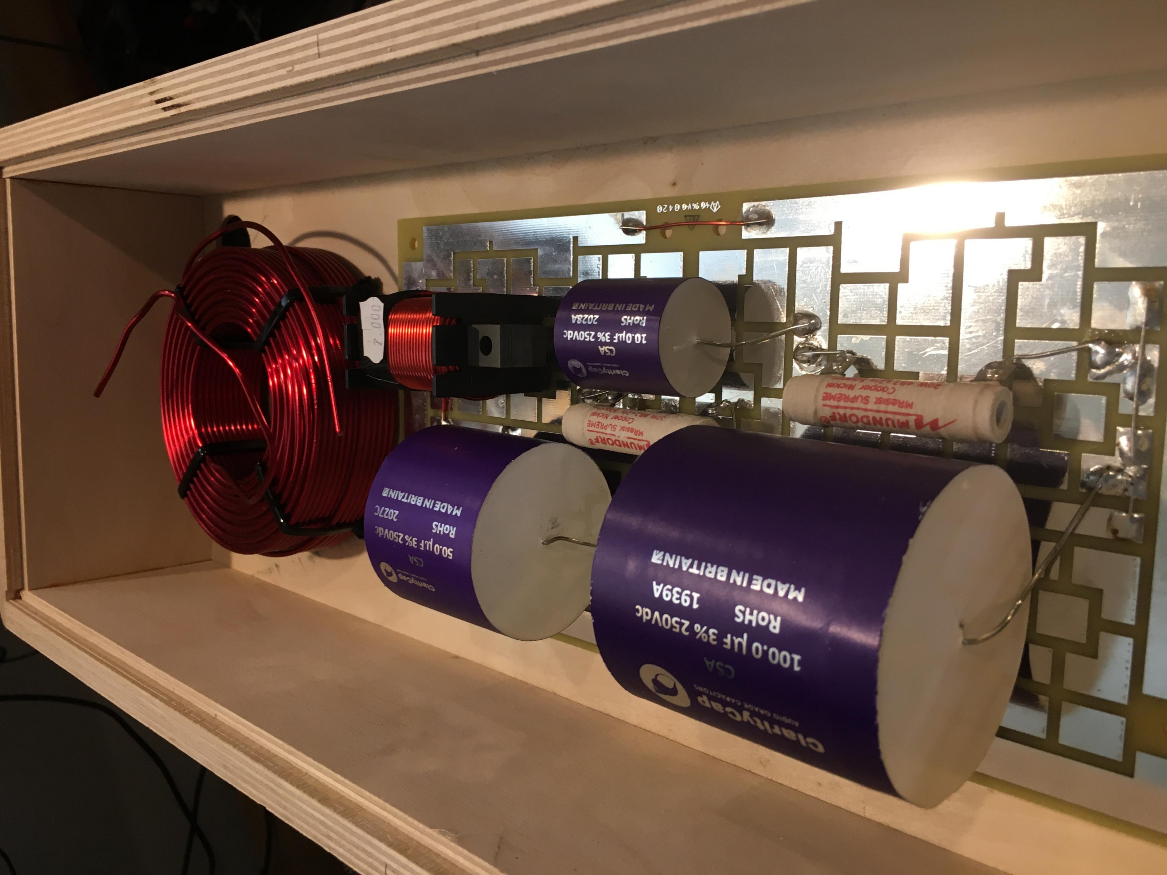

I upgraded the crossover components to much larger clarity caps, and decided to supply an air-core inductor for the Madisound sledgehammer inductor.
I have laid them out in the base cabinet as now it is time to wire it all up and prepare to put the other side on the main. So fully assembling the crossovers and putting in the wiring are the next steps.

Looks like a nice layout David! I predict you will enjoy the clarity caps.
-One thought: Make sure the DCR of the air core inductor is close to the DCR of the Sledgehammer inductor it replaces. An increase of a few tenths of a ohm can make a significant difference in the output of the woofers. Conceivably far more audible than any possibility of hysteresis induced distortion from the laminated core.
C
Hello, Before i even ordered the inductor I got the specs of the sledgehammer. Steel Laminate 2.0 mH 15 AWG Inductors This inductor has a DCR of 0.156 ohms.
The Solen 10 AWG inductors I obtained also (At quite a cost actually) is specified at 0.15 ohms. I will also be careful to wire up this crossover to minimize any wiring problems that might cause any problems.
Thanks for the heads up but I did consider it.
I presumed you had David, but it never hurts to mention, as DCR can be easily overlooked by less experienced builders when sourcing parts.
As previously noted, a slightly oversized fit for the sonotub is fine as the deformation will not significantly alter the reduction in standing waves in the lateral axis. The snug fit also will help eliminate potential buzzing between the tube and the enclosure.

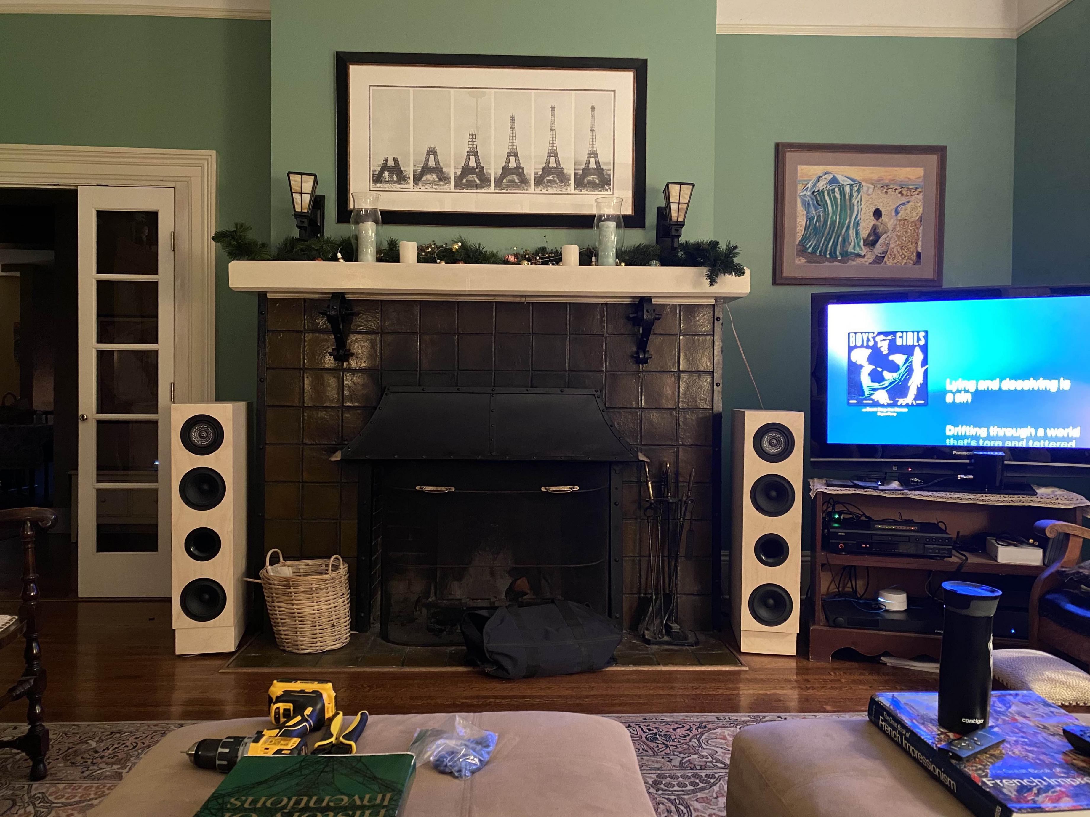

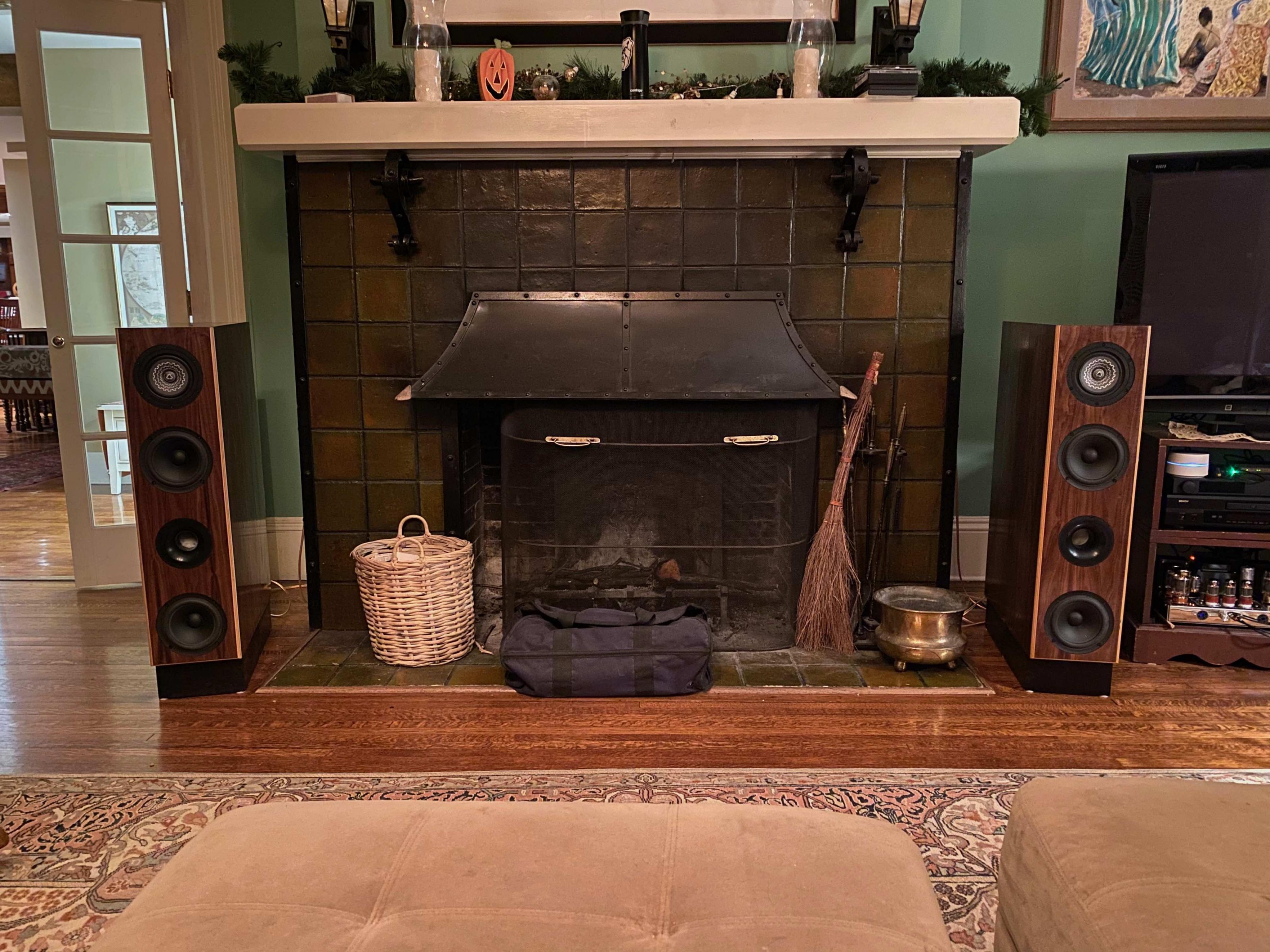

I used tung oil, but I think I put it on too thick as it’s still a little sticky. Bob suggested I wipe it off with mineral spirits and re-apply very thin coats.
On a separate note, Curt says that the small round over I chose (by accident) is probably not a serious problem for me as a non-audiophile because diffraction effects modeling shows that for real consequential results, the round over should really be closer to 3 inches. So while my 1/2 inch round is far from ideal, it’s not the end of the world.
A couple details

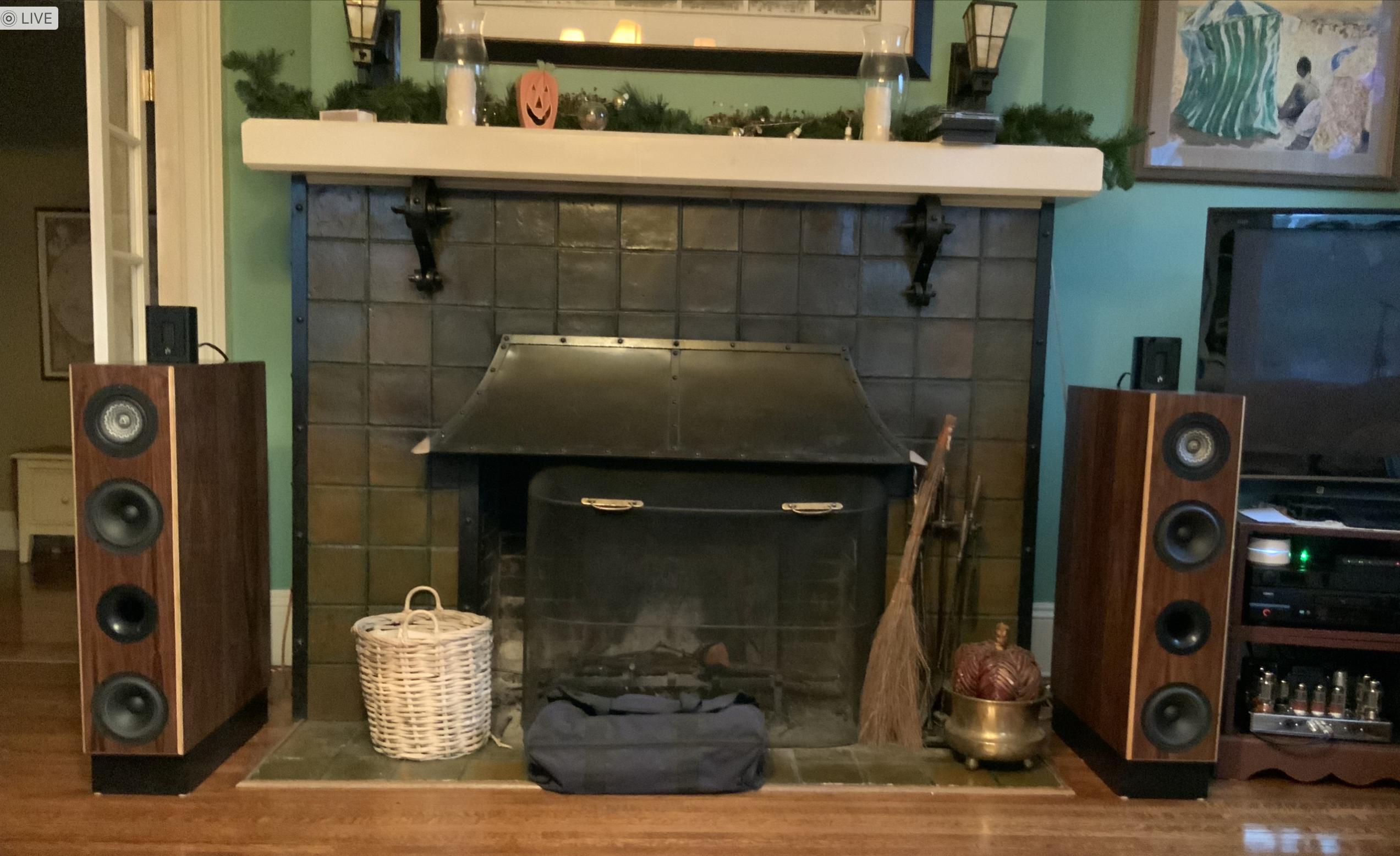

Being able to see the white stuffing through the port was bugging me, so I took the port off, and dusted the inside with flat black spray can. Not sure if that damaged the effectiveness of the stuffing, but it looks better. It’s not how you feel, it’s how you look.
The port itself was very glossy, shiny plastic, which I thought looked a little out of place, so I sanded it down a little to take off the sheen. You can’t really tell from the picture, but in the flesh it blends better with the flat black speakers and base.
The super tweeters are just sitting there. Not connected.

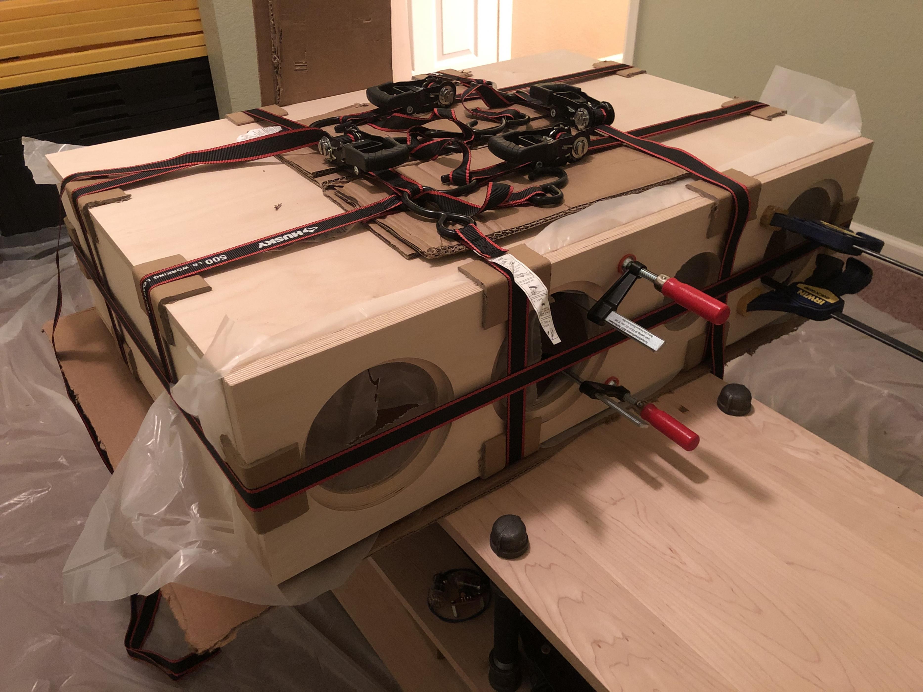

I had been eyeing the Halcyon as I've been looking to experience the full-range driver phenomenon again. I'd made electrostats and magnetic planars before but never played with a regular cone full range. After finding this thread, I took the plunge and started the process. Ordered the flat pack from Bob at Big Wood Studio. It showed up today. I'll be ordering the driver kit from Madisound next month and start the process of gluing the cabinets up. Thanks, Alan, for sharing and making the decision easier.
