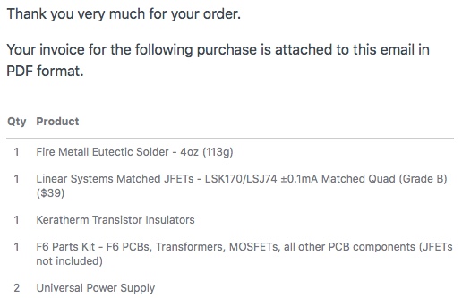

The refund for the fancy feet hit my paypal. I'm looking to order parts Sunday night as the refund is more than enough to cover boards and components for both the signal and PSU and possibly the power xformer.

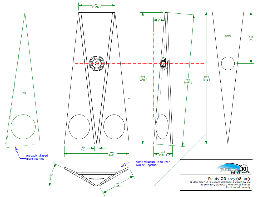

I have not been overly impressed with OBs but i have one more in me… tentatively A0p + 4 x 10” per side.
Illustration from before i figured out where to put the 2 extra woofers (slot load them Pass style — something i conceived of before Nelson’s SLOB article).
