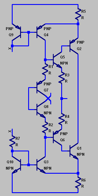

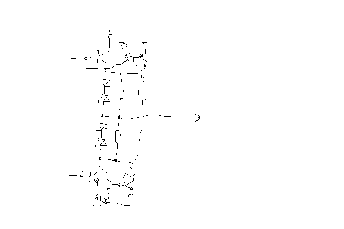

I have no access to LTSpice at the moment, so I don't know exactly what circuits have already been proposed, but what about the attachment? It is just a rough idea, I haven't tried to dimension, build or simulate it.
It's basically a class-(A)B control loop, but depending on how you dimension it, you can make it kick in only when cross conduction gets too high because of high frequencies if you like. The idea is that when only one side of the output stage conducts, the voltage across two Schottky diodes should be too small to make the rightmost transistors conduct. When the other side also conducts, the voltage can become large enough to turn on the rightmost transistors and the current mirrors, which will then turn reduce current through both halves of the output stage.

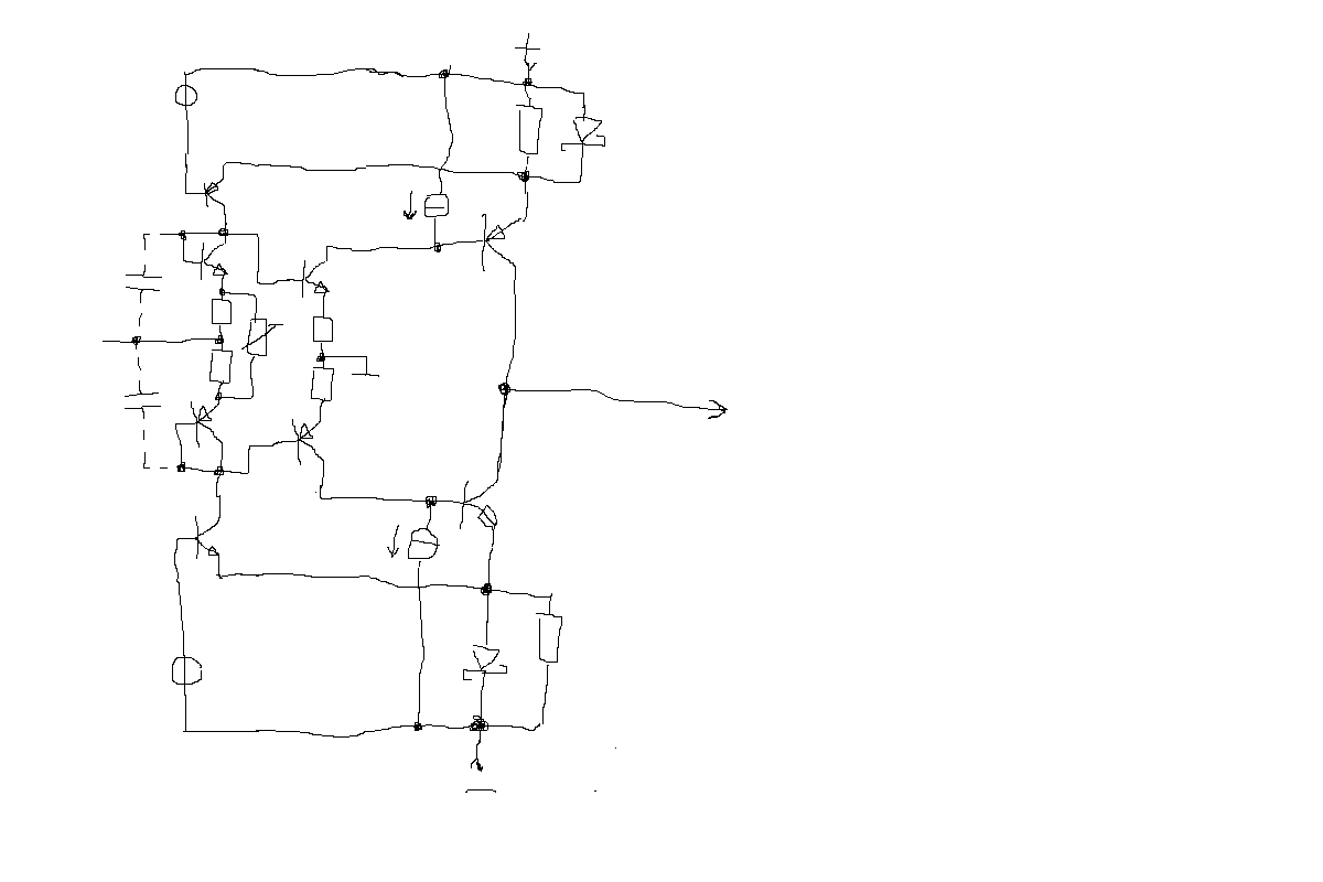

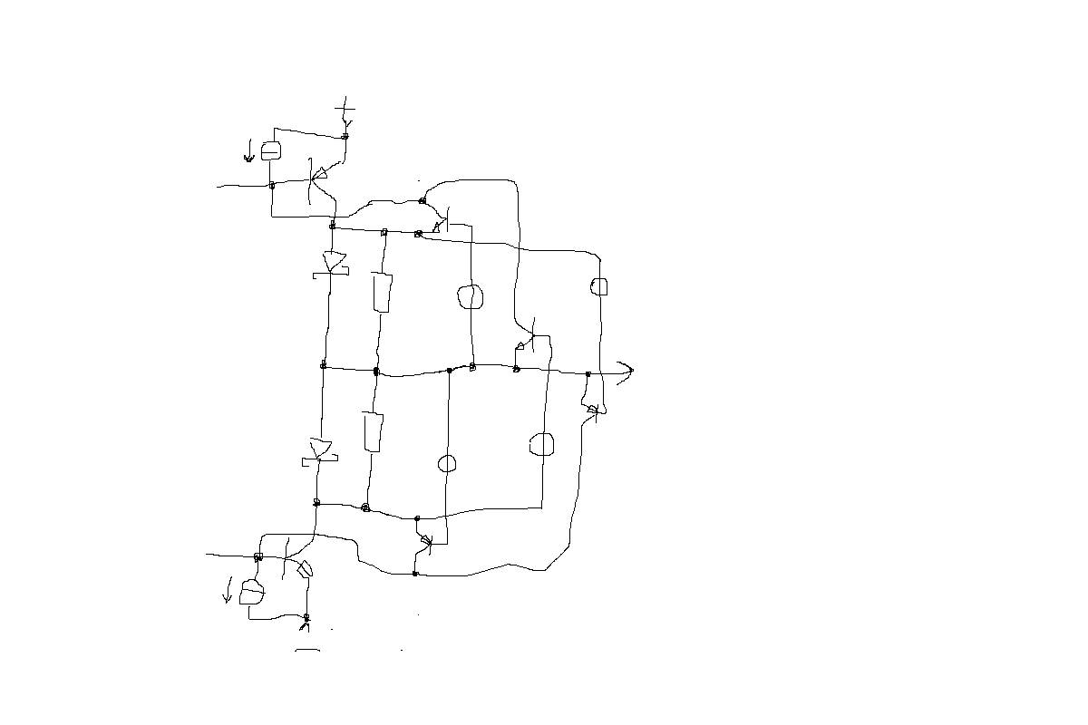

This is another untested wild idea. The transistors on the left are the output stage transistors, the resistors are small-valued current sensing resistors and the Schottky diodes are only there to limit the voltage drop across the resistors when the current is very high.
When the current through either side of the output stage gets too small, the current through one of the extra NPNs and one of the extra PNPs will increase and this will increase the current through both output devices. The opposite happens when the current through both sides gets too large.
By using transistor arrays for the extra transistors and their voltage sources (these can be implemented as diode-connected transistors with a small resistor in series, fed by a current source), the sense voltages in the crossover region can be kept as small as a couple of kT/q. The transfer from one side to the other then becomes quite smooth.
I think many aided-switching ideas fall into the trap of trying to fix a crossover blip by adding more parts that are switching. You end up getting a drive current that is not proportional to output current and contains all the currents of the transistors switching on and off. Even if you do succeed in improving switching of the output transistors, the frontend has to deal with all the new switching harmonics and somehow come out on top.
Your first schematic may not suffer from this since the correction current flows from rail to rail without modifying the current gain of the output stage. But you still must use switching drivers, because the output transistor base nodes have no way of dealing with reverse current.
I tried your second schematic in simulation without the two rightmost transistors and it did work, provided the drivers still did the switching. But you still have 2 extra transistors switching on and off.
Your third schematic looks worth a try, but I think it would be best to change the input transistors to look like the driver part of a diamond buffer. That way you get more current gain to suppress the extra switching harmonics.

That's why I like class-(A)B bias loops with a smoothly working non-linear network rather than an abruptly working non-linear network. I think the first of the three circuits is the worst in this sense. The other two can work quite smoothly when you design for a DC bias voltage of only a few kT/q across the resistors.
Thank you for trying it! With the two rightmost transistors included, the impact on the distortion should be smaller because they compensate for the distortion of the two transistors to the left of the rightmost transistors - or at least that's the oversimplified first-order theory.

Your first circuit could possibly be improved by using Edmond Stuart's autobias error amp here.
Optoisolator U1 appears to be for under bias so it's not needed for our purposes. Instead connect U1 diode in series with U2 and then the transistors can be used to remove base charge. This would not discriminate between the power transistor that is on and the one that needs to turn off faster but probably that may not matter much. Probably, the extra circuitry needed to discriminate between the two output transistors may not be worth the effort.
Ian Hegglun
Actually I think it is better to draw current from both bases, as this cancels the injected distortion to some extent.
The speed of the optocouplers might be an issue, I'm not sure what that will do to loop stability. In Edmond Stuart's version it doesn't matter because he makes the loop very slow with capacitor C3.
