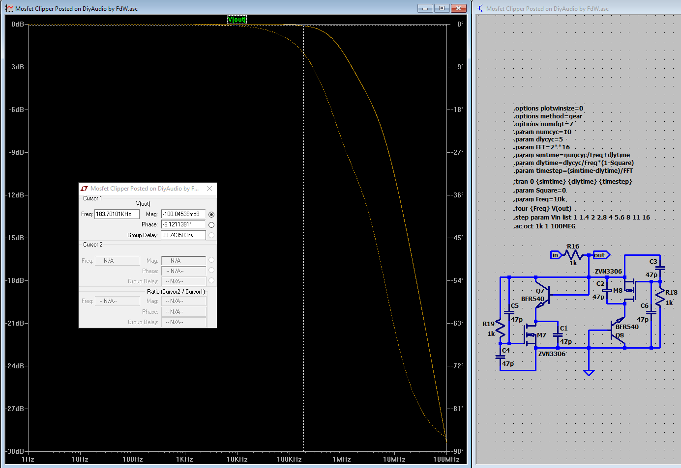

...(near) -200dB @ 1.4V input
Hi Frans
This seems suspiciously excellent.
I have seen other suspiciously excellent simulations that were unrealistic because of the use of the NMOS/PMOS Spice model.
I notice you use it too but unfortunately it does not model capacitance modulation correctly, the VDMOS model would probably be far more accurate.
There is a thread on this in the software and tools forum.
Best wishes
David
Hi Frans
Best wishes
David
I know 🙂 but who cares, the thing is build and functions, sound wise it is real good, the fact is @ -3dB it being -140 or -200dB does not make a differences. What the simulation shows is a [extremely] viable and simple clipper, with [almost] no effect on the signal (as long as it not operates) because it is a shunt. In practical implementation I have lowered the series resistor to 220 Ohm, this will improve the 'responsiveness' of the clipper and lowers any possible distortion introduced by the clipper, but it will form a larger load (when clipping) on the source.
In addition to the above; most of the nasty's (if any, and when any) are hidden behind the transdiodes formed by the BFR540's.
When I add (worst than) worst case capacitors to the schema, 47p Cgs, 47p Cdg and 47p Cds, and then run a frequency analysis, it shows the -100mdB at 185kHz any nasty's produced by the MosFet and conveyed through these capacities must IMHO be of no real interest.
The model is surely not complete, and it would be interesting to see this simulation done with better models (but I do not have them, and I can not [am not able to 🙂] make them). But all documentation on MosFet behavior seem to tell me that there wil be no real ugly problems.
Using a smaller series resistor(R16 1k in the simulation) will lower the influence of the capacitive behavior of the circuit, mostly by lowering the source resistance, and drive the MosFet [even] more in saturation, this should not have a negative influence [I do think it will be positive] on the clipper (Analog Design Essentials page 17/18 0131/0132 etc)
In real life, I (and other listeners) have not been able to hear the clipper being engaged and/or disengaged while playing at loud [but non clipping] levels (but that is subjective 🙂)

Running the sim with this model
*VDMOS with subthreshold (c) Ian Hegglun Aug 2015
.model IRF640-75C VDMOS (Rg=5 Vto={4.30-6m*50} Lambda=3m
+ Rs={35m*(1+3.5m*50)} Kp={13.0/(1+8.8m*50)}
+ Ksubthres={0.23*(1+4m*50)} Mtriode={0.35} Rd={0.1*(1+5m*50)}
+ Cgdmax=2600p Cgdmin=10p a=0.35 Cgs=1250p Cjo=3000p
+ m=0.75 VJ=5 IS=1n N=1.3 Rb=0.01 )
gives about -65dB(THD) but it is not fair to compare a small signal MosFet with this power device.
Concluding, I have no good model(s) and/or idea(s) to improve the sim

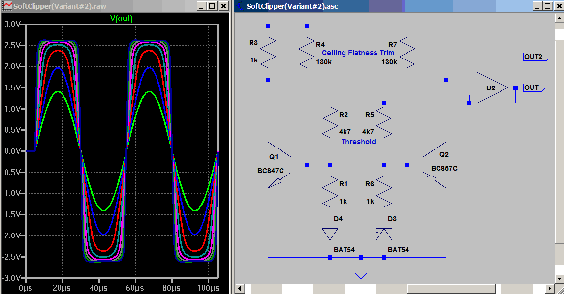

Yet another soft-clipper idea I came up with just yesterday. THD@20kHz 3dB below visible clipping isn't super low (still good enough for my needs) but my goals were different: low cost standard parts, adjustable "hard" ceiling but still with round edges, and a 5% ceiling accuracy without selection or trimming and from 20°C to 70°C ambient.
Not built yet so I don't know how close I'll actually get.

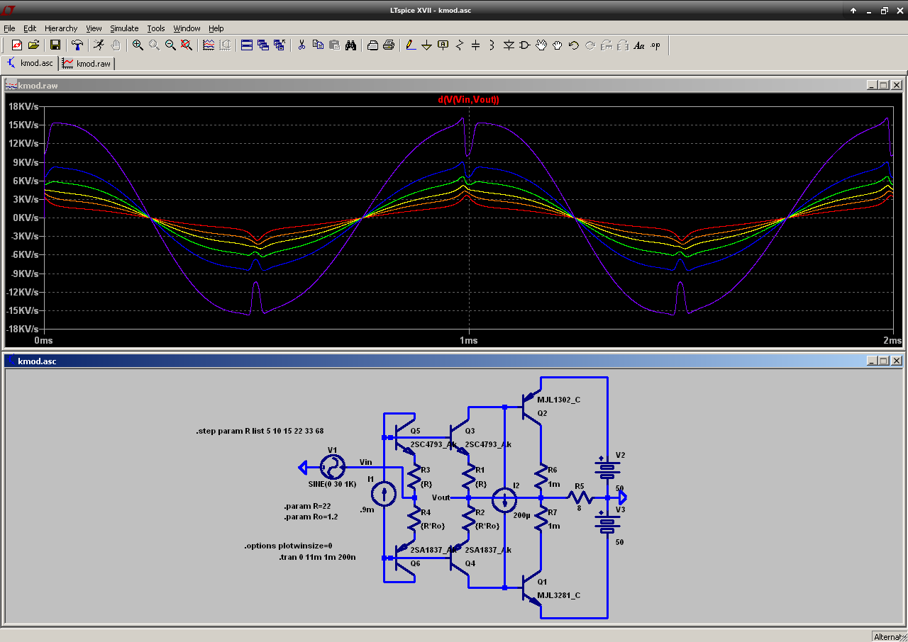

I'm sure this will be clear as mud, but here it goes.
In an op-amp, the input stage drives the rest of the amp. Any distortion in the required drive current shows up as distortion at the output. Whether your output BJTs are driven by collectors or emitters, the base drive current they require is exactly the same for a given output, same harmonics and everything. And unless you have something parasitically shunting the voltage follower stages (Miller compensation, Early effect, bootstrap), converting output drive voltage into VAS current harmonics, then the drive current which the LTP must supply also contains no difference in harmonics. And so no difference in distortion at the output of the amp, assuming that the feedback point is at the output and not shared with other points (VAS to feedback miller cap for example).
Also think of it this way. An emitter follower or source follower output stage cannot be current-driven at audio frequencies, if it is in a feedback loop. If you think otherwise, use an AC current source to inject current into the OPS base nodes and see what the actual impedance is there at audio frequencies. It will be extremely low unless your have a weak feedback loop. This is because any current going in or out of the OPS bases is treated as an error signal and removed by the preceeding stages as they are driven by the input stage, so that it doesn't change the output voltage from where the input stage is told it should be.
That is not a refutation of Ian's work. But I think "collector driven output transistors" would be less onerous as a working description of the ideas here. This is for the same reason I think "emitter feedback" would be much more sober a term than "current feedback".
There is a sort of infectious mathematical idealism that leads to the black-and-white thinking of current drive vs voltage drive, current sources vs voltage sources, etc. Well, transistors are 3-or-more terminal devices and the currents and voltages between those pins have mixed relationships. That is why Satan invented S-parameters, as a way to analyze them all in the most brutal, clinical, and impenetrable way.
Anyway, I just realized Ian never made any claims about reducing crossover distortion. So my comments are really moot. Let what follows be a refutation in case anyone else thinks so.
With collector-driven BJT outputs, the advantage Ian seems to be using is to drive the bases independently. Otherwise you always get the same crossover shape caused by exponential (Vbe) transfer curves in anti-parallel. This can be done with emitter-drive as well, but collector-drive has the advantage of simplicity and that the distorted Vbe waveforms are not carried any further into preceeding stages as they would be with emitter drive.
The new arrangement makes the crossover distortion harder to probe, but that doesn't mean it isn't still there. Add the Vbe waveforms of the BJT outputs and there it will be. Independent collector driven output BJTs will not have the exact same transverse (collector-to-collector) current waveform, but there is nothing here that will explicitly quarantine or remove the Vbe waveforms any more than the Early voltage of the drivers will allow.
But let's say that the collectors driving the output BJTs have infinite Early voltage. Look at Figure 3 in Ian's article, assuming Hfe=100 for the transistors. Roughly, Ib(Q4)=Ie(Q4)/100. Ic(Q1)=Ib(Q4), so Ic(Q4)=Ic(Q1)*100. For all intents and purposes, Q1 and Q4 are the same transistor. And this transistor has an emitter resistor - R1. In fact, Q1 and Q2 look a lot like a standard EF output stage. If we make R1 and R2 22R, then the whole arrangement behaves like a standard EF output stage with 0.22R resistors, with the exception that the input is referenced to ground and the output current has been moved to a separate node. Thermal behavior is different of course, but there is nothing here that actually has the ability to change the crossover function.
For visual appeal, I've attached an image of a simulation I did with a similar output stage, sweeping the driver emitter resistor value. The lower drivers have higher emitter resistors to account for the PNP output having extra gain.
