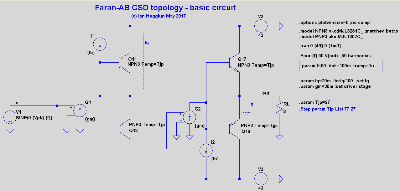

To help see the principle clearly, what I call "Faran-AB", of paralleling two Faran-B stages and biasing one with sinking current and the other with sourcing current, I have a simplified output stage (which you can run) see attached.

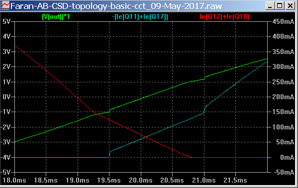

There's also a weighted THD file in the zip. It is useful because the THD readings are misleading. For example full output swing 100W/8R at 50Hz gives 2.4% THD (this is open loop) and wTHD is 50%. Reduce the power to 1W and THD is still 2.4%! But the wTHD is now 300%! -- so we have zero correlation of THD to wTHD in this case. If you look at the FFT plot of V(out) you can see why; the high order harmonics generated. A lot of nfb is still needed to make this OPS Hi-Fi -- just like most transistor amps.
But the advantage of Faran-AB is below a certain power you get low distortion once you get into the -A region. With 70mA bias this starts from 1W which is where music happens to be most of the time.
The other advantages are no need for an idle current trimpot plus no thermal instability in the power transistors and no need for power emitter resistors for paralleling. These have been top on the wish-list since transistor amps were first produced. A pity it has taken so long to find a way to do it.
And it is relatively simple and easy to implement as demonstrated in my previous post circuit for an amplifier.

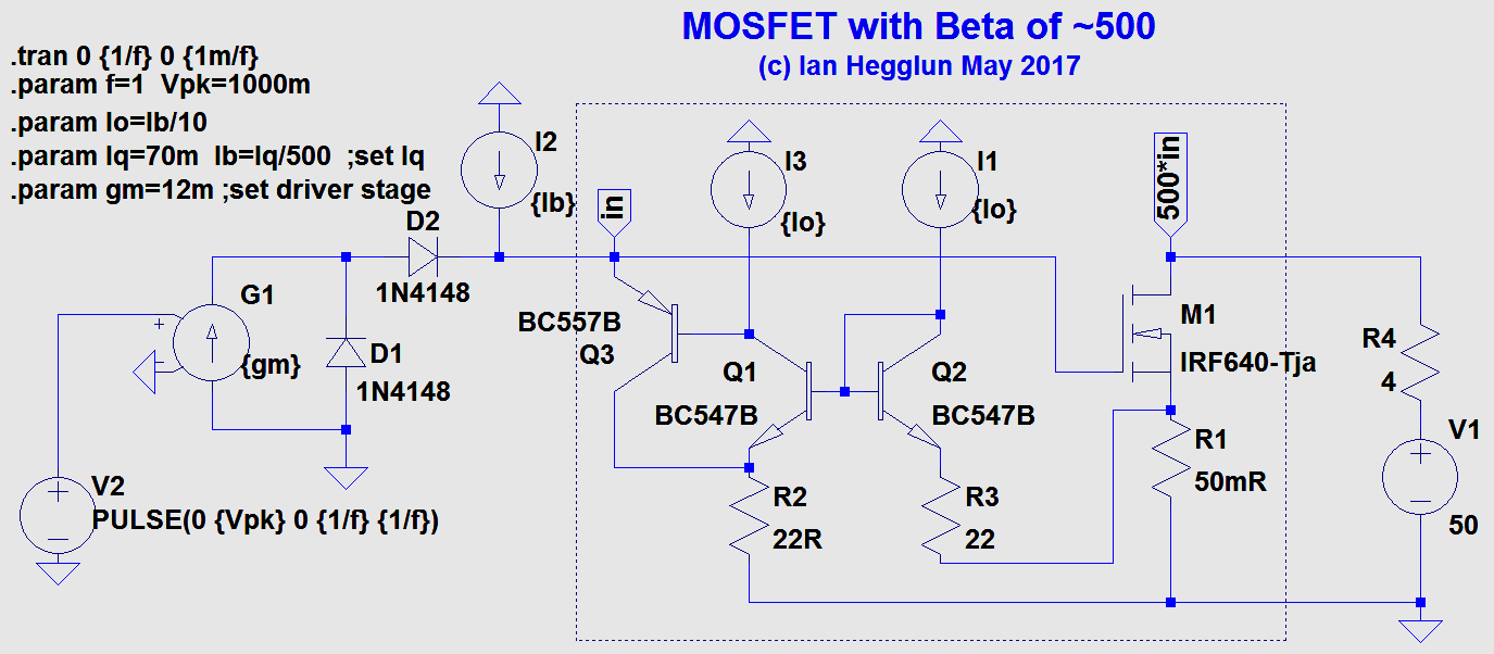

I'd like to extend Faran-AB to MOSFET's. Obviously we can't use current drive directly into the gates of MOSFET's, but if we add a current mirror to each MOSFET we can give it a 'Beta' (Hfe). See attached mirror circuit.
This could overcome the Spirito thermal instability problem (that occurs in linear mode) that makes most modern power MOSFET's unsuitable for audio amplifiers.
I'll try some simulations when I get a free day.
As far as I know, the Spirito stability factor applies to the way a given total current is distributed within the power MOSFET. You can fix the total current by good circuit design, but if due to local heating and operating at a low gate overdrive voltage eventually all current passes through a very small spot on the MOSFET, it will still be damaged.
Actually this is the very same phenomenon as thermal second breakdown in bipolar power transistors. When power MOSFETs first appeared on the market, the lack of second breakdown was their main selling point. Later the manufacturers started optimising their MOSFETs for extremely low on resistance and brought back the thermal stability problems in the process. High voltage MOSFETs are often still usable in saturation, especially when used at a much lower voltage than specified.
By the way, what power MOSFET designers call linear mode is precisely the region of operation that analogue integrated circuit designers do not call linear mode, but saturation: VDS >= VGS - Vth.
Some comments on your schematic there.
At 5A output of the MOSFET, the mirror will draw about 12mA. Re would be about 2.25R. This means a mirror draw of about 240uA for an idle bias of 100mA. At idle Re increases to 112R, much higher than your 22R degeneration. A 5x rise.
So I guess I1 will need to be not much under 10mA if you want the mirror to be relatively linear. Otherwise, the gain of the current mirror will rise at low currents, which I think would be bad for crossover.
Improved current mirror
...At idle Re increases to 112R, much higher than your 22R degeneration. A 5x rise.
Thanks keantoken. You are right. The Re of Q1 varies with Iin so it is a nonlinear mirror. Adding a PNP transistor to buffer Q1 and biasing Q1 with a constant current (same as Io) makes the effective Beta (Id/Iin) fairly linear.
See attached jig and plot. It is also very insensitive to Tj of the MOSFET at low currents. The jig is attached to check the temp co's.

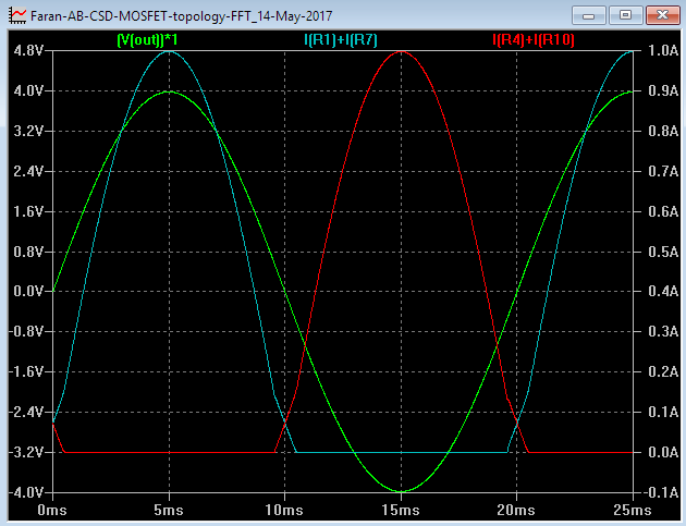

I have added drivers like the demo in post #120 and then an input stage. See attached circuit in 'Faran-AB-CSD-MOSFET-topology-FFT.zip'.
The crossover region is shown in the attached plot at 1W. Comparing the Faran-AB MOSFET version with the Bipolar version with the same input and driver stages and same idle current the weighted THD was about 1/5th at 1W 50Hz, eg 0.1% with MOSFET's (0.003% unweighted THD). This may be due to the 5 times higher Beta of the MOSFET's of 500.
Note this is with the gates of M1 and M2 shorted, likewise M3 and M4 gates shorted; no bias voltage generators are used. This the Faran-AB idea working with MOSFET's. There's no need for bias adjustment trimpot and the temperature sensitivity of the power MOSFET's is virtually zero. And small value source resistors are used.
Thermal instability problems of modern power MOSFET's is no removed since hot spots can form even if the MOSFET's drain current is controlled. MOSFET's that have a secondary breakdown like SOA plots suffer from hot-spots, but choosing higher voltage MOSFET's than needed for the rail-rail voltage helps to stay out of the secondary breakdown like region.
With a Faran-AB topology more power MOSFET's can be added in parallel without careful selection of threshold voltages by adding more mirror loops.
These simulations show a Hi-Fi Faran-AB amplifier is feasible. But no bench tests to report at this stage. These ideas can be used by anyone. First in first served. Let us know how you get on.
