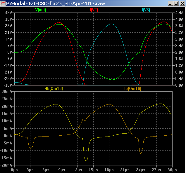

An improved charge pull-out circuit for the Linear Audio CSD amp
...I have just done bench tests on an improved charge pull-out circuit on my Linear Audio CSD that is simple and keeps the no load idle current down to acceptable levels. I hope to post a circuit update soon.
Hi All,
Attached is the promised improved charge pull-out circuit mods for the Linear Audio CSD amp that I bench tested. Only one of the two output pair are shown for clarity.
The added components are in the 3 dotted areas. Cc is a coupling capacitor that sends a reverse voltage to the opposite side when one side turns on - let's say QM16 is turning on then QM13 gets a lift in the voltage to Q1's base, thereby causing Q1 to discharge QM13's base charge. C5 across D5 slows Q1 for stability.
BTW Cc can be fairly small, only 1nF to 10nF, because Cc feeds the high resistance R7 (notice D5 is reverse biased when Q1 conducts).
A simulation plot at 50kHz into 8 ohms is attached. Ib(Qm13) shows 17mA peak negative base current flows via Q1 over about 2us. The rail current I(V2) shows there is not much cross-conduction (where the current plots cross).
For my bench tests I used the values shown and the idle current increased from 80mA to 120mA with no load and full swing square wave up to 130kHz (the limit of my oscillator). This is what I have been looking for. Simple and effective and no extra rail voltages.
I hope to do some THD tests. When I am happy all's well with this idea I'll post the full simulation circuit.

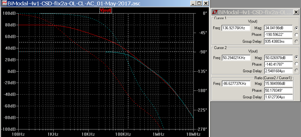

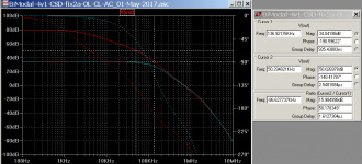

...So what is the closed loop gain at 180 degrees phase? My reading of the graph is that it is greater than 0 dB.
Yes, well spotted. I noticed that before I sent it. Not sure why it still runs in .trans without oscillating even though the phase margin says it should oscillate!?
A mystery. Other members may have some answers.
Whatever it is, it's a reminder that SPICE has surprises now and then.
One possibility is the input stage MOSFET models drain conductance and capacitance model gives different GBW in .op (for AC operating point) and .trans (large signal operation).
BTW The values for the compensation components in the simulation are close (+/-20%) to the values for my bench test but the models are not matched to the actual semiconductors of my bench version (maybe +/-30%). But still, this cannot explain why my negative phase margin in AC analysis doesn't oscillate in my .trans simulations.
I haven't looked at the plot, but in general, feedback systems can be stable with a phase shift greater than 180 degrees at a frequency where the loop gain is greater than unity, just as long as the phase returns to a safe value before the loop gain becomes 1. They call that conditional stability. See the Nyquist stability criterion.
...A mystery. Other members may have some answers....
I haven't looked at the plot... They call that conditional stability. See the Nyquist stability criterion.
The phase in Ian's plots looks to fall montonically so conditional stability is not the explanation in this case.
Ian, I don't understand exactly what you have plotted but it looks like you have not correctly included internal loops.
This is a common difficulty, if you use a Tian probe then you can show us exactly where the loop gain is calculated.
Best wishes
David

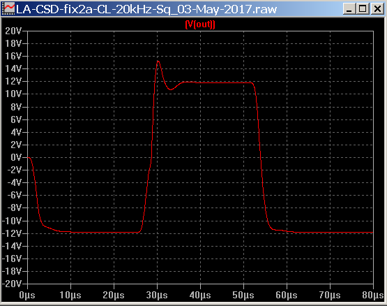

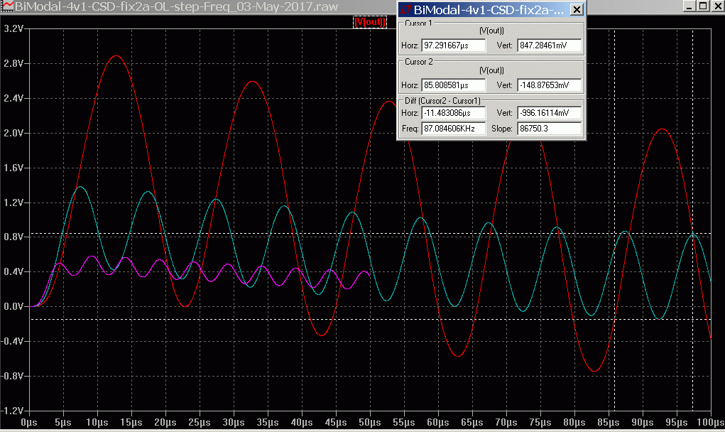

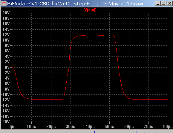

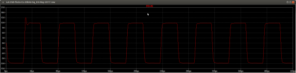

It might be interesting to see the output waveform with a 20 kHz square wave input.
The 20kHz squarewave response is attached (first one). Same circuit as the previous gain/phase plots.
The second plot is with no phase advance capacitor (C13) 56pF across the feedback resistor. I thought that may be stopping oscillation by providing some phase advance but without it we get ringing but not steady state oscillation.
The third plot is where the input frequency is stepped 50kHz, 100kHz and 200kHz in open loop with 5mV peak input. From this the gain at each frequency can be calculated and compared to the previous AC gain/phase values.
I calculated 40.2dB at 100kHz and 26.6dB at 200kHz for the .trans run. The AC gain/phase plots show 40.0dB and 26.1dB respectively which are very close.
Also the .trans phases at 100kHz and 200kHz were 172 deg at 100kHz and 205 deg at 200kHz. The AC gain/phase plots show 174.6 deg and 205 deg respectively which are also very close. These were measured by plotting d(V(out)) to find the zero cross (now at the peaks) for the 9th cycle.
So it appears the .trans simulations correspond to what the .AC simulations show on the gain/phase plots. Which means there must be some other reason why it doesn't oscillate. And it doesn't appear to be the phase advance capacitor because without it there's still no oscillation.
It's still a mystery; more a curiosity, why is it so?
I'll place a zip file 'BiModal-4v1-CSD-fix2a-sims_03-May-2017.zip' on myDrive (link in signature) in the diyAudio directory. You can generate the same plots as my ones here. These circuits have the improved charge pull-out mods.
A question?
I don't have the complete circuit here yet but the square wave response plots are a bit unusual in that they are asymmetrical. On the second plot why is there ringing only on one voltage transition?
Perhaps there is some sort of asymmetry on the CMOS gates?
From what I remember your circuit is basically symmetrical. The square wave input is symmetrical about 0 vdc. You have tried running the simulation longer to eliminate any startup transients?
OK I have the simulation file and will do some investigations tomorrow.

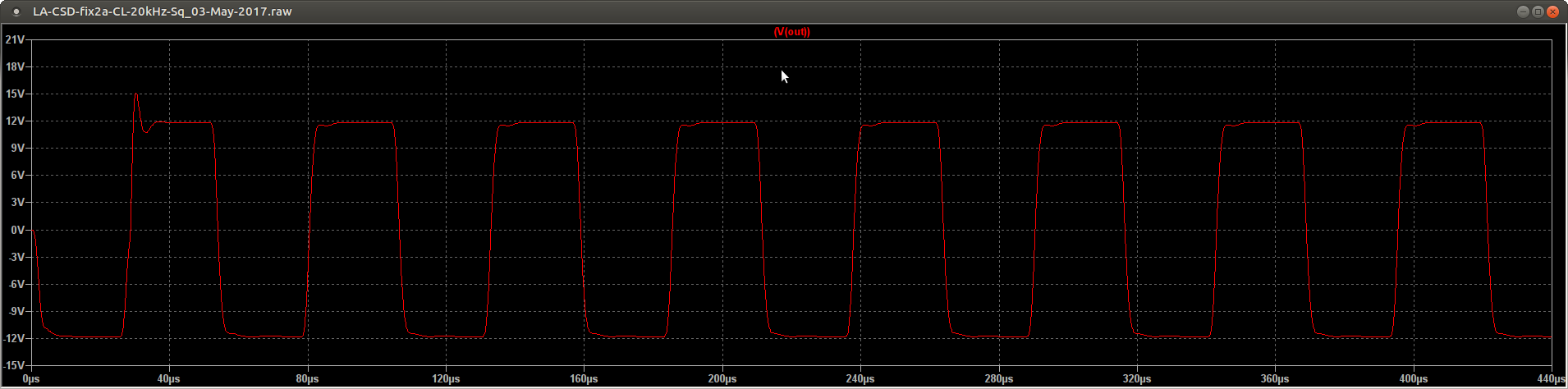

Some results
With C13 removed the ringing you plotted is transient. If you extend the simulation duration it disappears. ie
Modify the voltage source to something vaguely like:
PWL REPEAT FOREVER(0m 0 {tramp/2} {-Vpk} {tramp/2+0.5/f} {-Vpk} {3*tramp/2+0.5/f} {+Vpk} {3*tramp/2+1/f} {+Vpk} {5*tramp/2+1/f} {-Vpk}) ENDREPEAT
and extend the simulation time.
Then you will get a plot as shown in the attached file. Looks like it is going to drop below freezing tonight here in Melb.

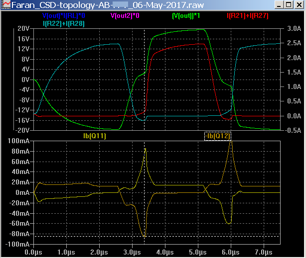

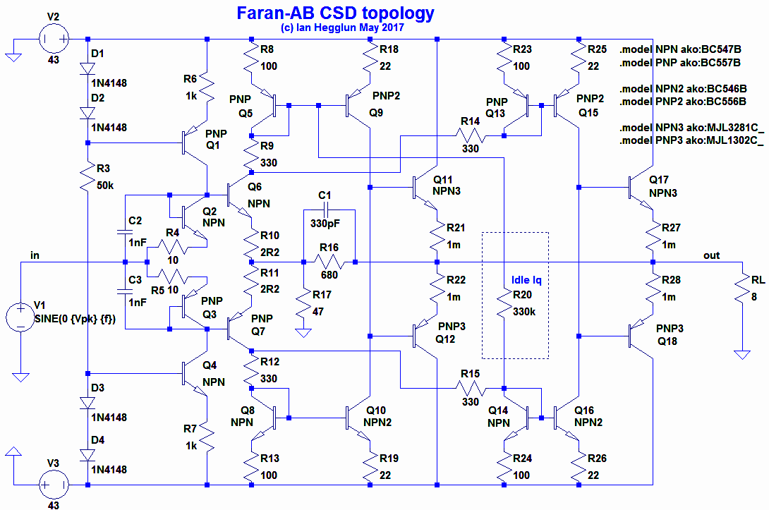

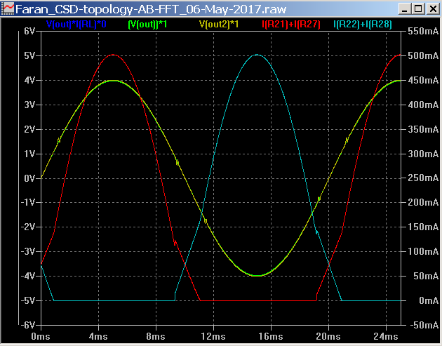

Faran mods for Class-AB
...There may be some mods that could get the wTHD lower. Any suggestions? Also mods for standard dual-rail operation.
Hi All,
Adding a second parallel Class-B stage (bases shorted) allows source idle current in one Class-B stage and sink idle current in the second Class-B stage. This creates a composite output stage that behaves like Class-AB while retaining shorted bases in each stage. See that attached circuit.
As mentioned in previous posts, shorted bases allows fast charge pull-out without cross conduction. See the attached simulation at 200kHz. The idle current is 70mA. The third plot shows the crossover region at 50Hz and 1W/8R. The weighted THD can be reduced to 0.5% (which is below the audible threshold) with an input stage with 40dB of nfb (the unweighted THD is then 0.003% at 1W).
This Faran-AB approach allows the distortion at low power to fall off below 1W with 70mA of idle current. Without this modification the Faran-B approach gives increasing distortion below 1W which is unacceptable for Hi-Fi amps. So now Faran-AB approach can be used for Hi-Fi.
And I should mention the output stage linearity is not affected by temperature changes in the power transistors, and there's no need for a bias current trimpot.
The circuit as shown is not buildable as is since different HV driver transistors are required for a 100W amp. But it wouldn't take much more work to finalise it and build one. It probably needs a new thread. Anyone interested in taking it up? I have enough to do already.
I will place the simulation file on myDrive (link in sig line) in the diyAudio folder that generated the plots shown here.
Ian Hegglun
