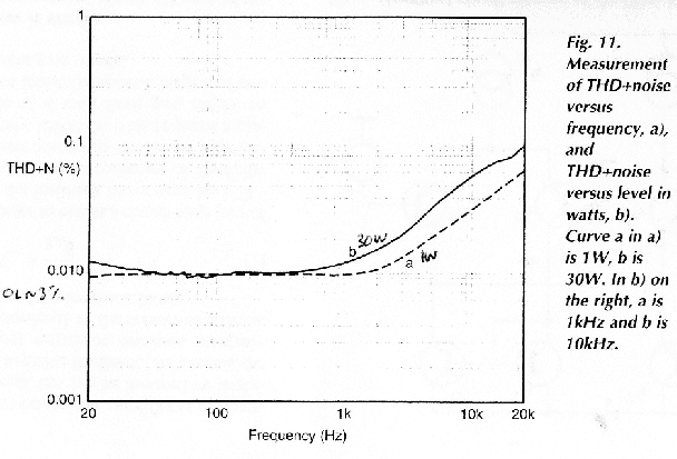

This thread is to hopefully find ways to reduce distortion due to high frequency cross-conduction in current source driven power transistor Class-AB output stages.
An example of this problem is Wim de Jagger's "New Class-B" amplifier published in Electronics World December 1999 p982–7 A NEW CLASS-AB DESIGN
This new topology creates distortion from cross-conduction in the high end of the audio range. See Wim's Figure 11 (attached or view on my Gdrive - see my member info for link). Distortion is 0.1% at 20kHz. It rises steadily from 0.01% at 1kHz. Most of this distortion is from cross-conduction which is due to transistor charge storage because no base-emitter resistors are used and the bases of the power transistors are current driven. This unconventional approach solves the seemingly unsolvable thermal problems of Class-AB biasing stability, but instead we get more distortion from cross-conduction and more waste heat from cross-conduction.

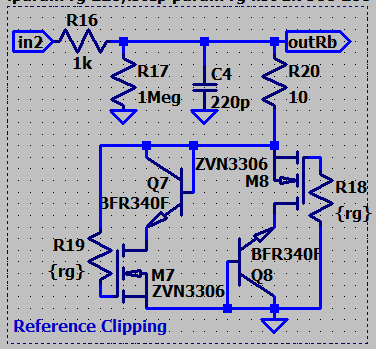

The second item of interest in your design is the way you implement soft clipping, as I am a strong belever of soft clipping I use one in my amplifier also.
The one I use is implemented with MosFet's but implemented differently, attached is a schema that I use. The MosFet's shown can be selected for exact 2VRMS or (when you do not like to discard most) in a range of 1.9...2.3VRMS (this gives about 50% keepers).

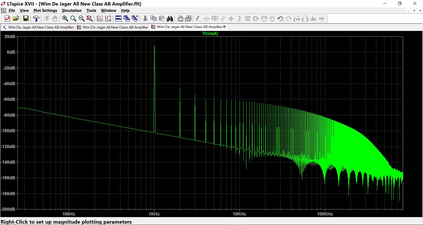

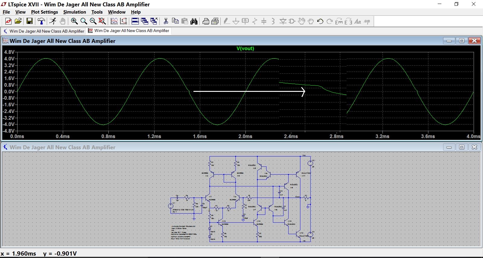

I remember Wim de Jager's article from almost 20 yrs ago and remember thinking what an unusual design it was, more reminiscent of the internal architecture of an IC than a workable power amp.
Curious, I just simulated the original and find I can not meet the original specs. In fact distortion is pretty obvious in the sim without even looking at FFT's or number crunching. It also seems very transistor (model) dependent.
I wonder if anyone ever built this design and is so what they thought of it.

This delay in switching off is what causes the cross-conduction that Ian referred to. I believe that's what he is looking to fix.

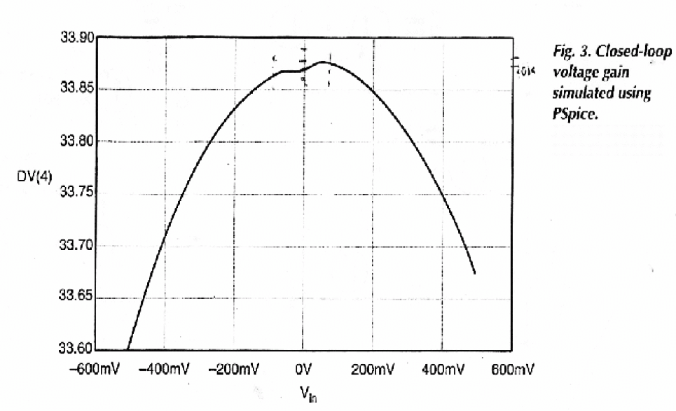

Your simulation shows up one of the weakness' of this topology -- the gain variation around the crossover region. I note you have used MJL21193/4 power transistors which are 4MHz, relatively slow compared to Wim's amp which used 2SA1095/2SC2585 which are 80MHz -- which makes a big difference in this topology, even at 1kHz.
This gain variation can be seen in Win de Jager's article Figure 3 (attached). This plot I assume is at a low frequency (1kHz or less) so cross-conduction current does not cause additional gain variations. Fig.3 variations in the crossover region are mainly from Beta differences in the driver and power transistors upper and lower halves.
The slow gain drooping is mainly from driver and power transistor Beta fall with current. Interesting, if you look at the earlier post showng Fig.11 distortion, the distortion does not increase as much with power as with frequency, showing large signal non-linearites are not the BIG problem in this topology.
And both p/n mismatch and Beta droop nonlinearities are much less significant in standard voltage drive output stages.

True the feedback can go only one way. The feedback has no way to make the transistor that is turning off to turn off faster to reduce distortion. Instead, the feedback makes the other transistor turn on more to get (close to) the right output voltage.
With current drive the charge has no where to go ... apart from getting used for continuing the base current until all the charge is dissipated by this internal current. The collector current fall off with current drive is relatively fast at first but has a long tail at the current levels used for the idle current. Even with 80MHz power transistors, like Win de Jager used the tail currents are still significant at 1kHz. Here's a quote from Win's EW article:
"The problem with power transistors driven by a current source is that there is no turn-off resistor for them. Under high frequency, high amplitude drive there will be a tendency for the effective bias current to rise dramatically.
By using HF power transistors with an fT of 80MHz, this bias current rise is reduced to 60% at 20kHz at full drive."
I'm hoping there's a way to increase the turn-off time under current drive without using 80MHz power transistors and without too much circuitary. Wim de jager would surely be interested too.

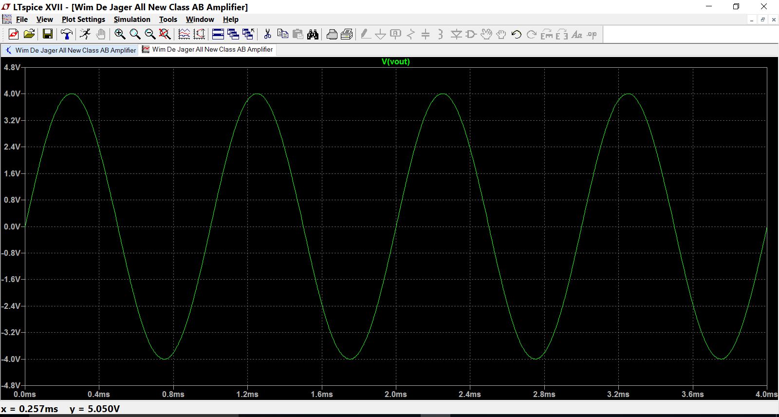

The above simulation was also using MJE243/253 drivers. Retaining the MJL21193/4 and switching to Bob C's MJE340/350 models and things look a bit better. Still 100ma bias.

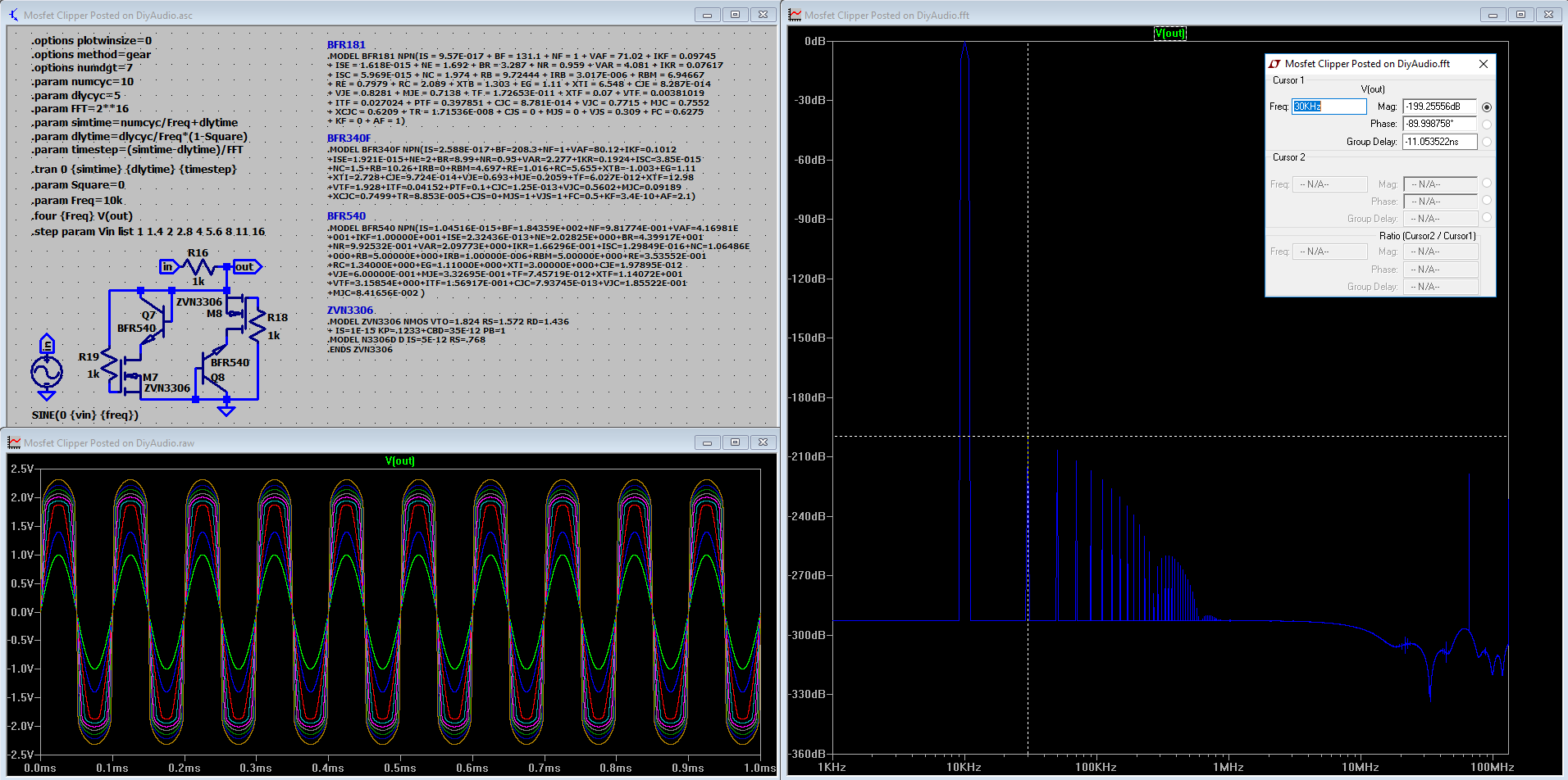

Here it is, one '.asc' sim-file and an picture showing (near) -200dB @ 1.4V input
P.s. I do select mosfets by using a 10mA current source [as in the clipper] g and s are connected to each other (creating a 'mosdiode'), the Vds is measured. As stated before most ZVN3306's will be in the [useful] range of 1.8 to 2.3V
R16 can be lowered until the current delivered by Vin conflicts the maximum Ids of the MosFet (this will not very quickly happen, not many sources will deliver currents of 200mA and above)
The output of the clipper can be connected to a shunt potentiometer for volume control, or [in a balanced world] connected between the hot and cold clipper outputs.
Be sure to match all mosfets, 2 per unbalanced and 4 per balanced signal, thus in total 4 for unbalanced stereo and 8 for balanced 🙂
