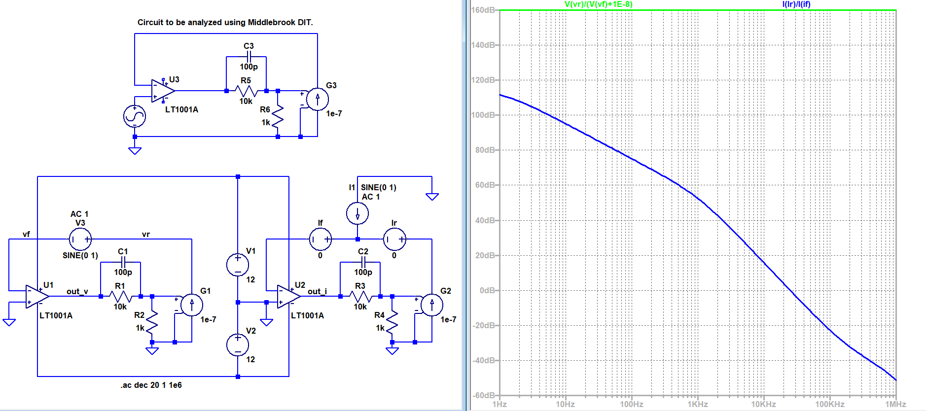

Hans, here's how Middlebrook's DIT should be applied to the circuit I posted. The circuit's input signal is zeroed. In one case, the loop is broken to insert a voltage source; in another, a current is inserted at the point where the loop was broken with the voltage source. The ratios of the reverse to the forward signal can be calculated. No other circuit components are to be added, because that would modify the circuit to be analyzed.
In the attachment, V(vf) is essentially zero. I had to add a very small number (1E-8) to it so I could display a ratio.
The voltage loop gain is essentially infinite, while the current loop gain is finite. It is clear that here, current feedback predominates.

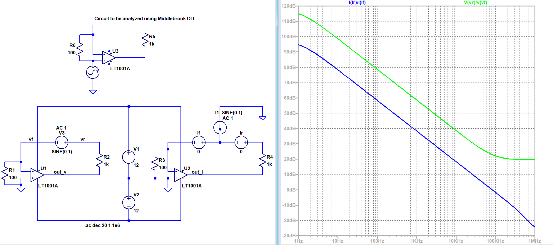

Next I went back to the circuit in which I had thought that c.f. predominated, but which your tests led me to believe I was wrong. I guess I didn't realize how you were running your tests, because the attached shows that indeed, c.f. predominates.

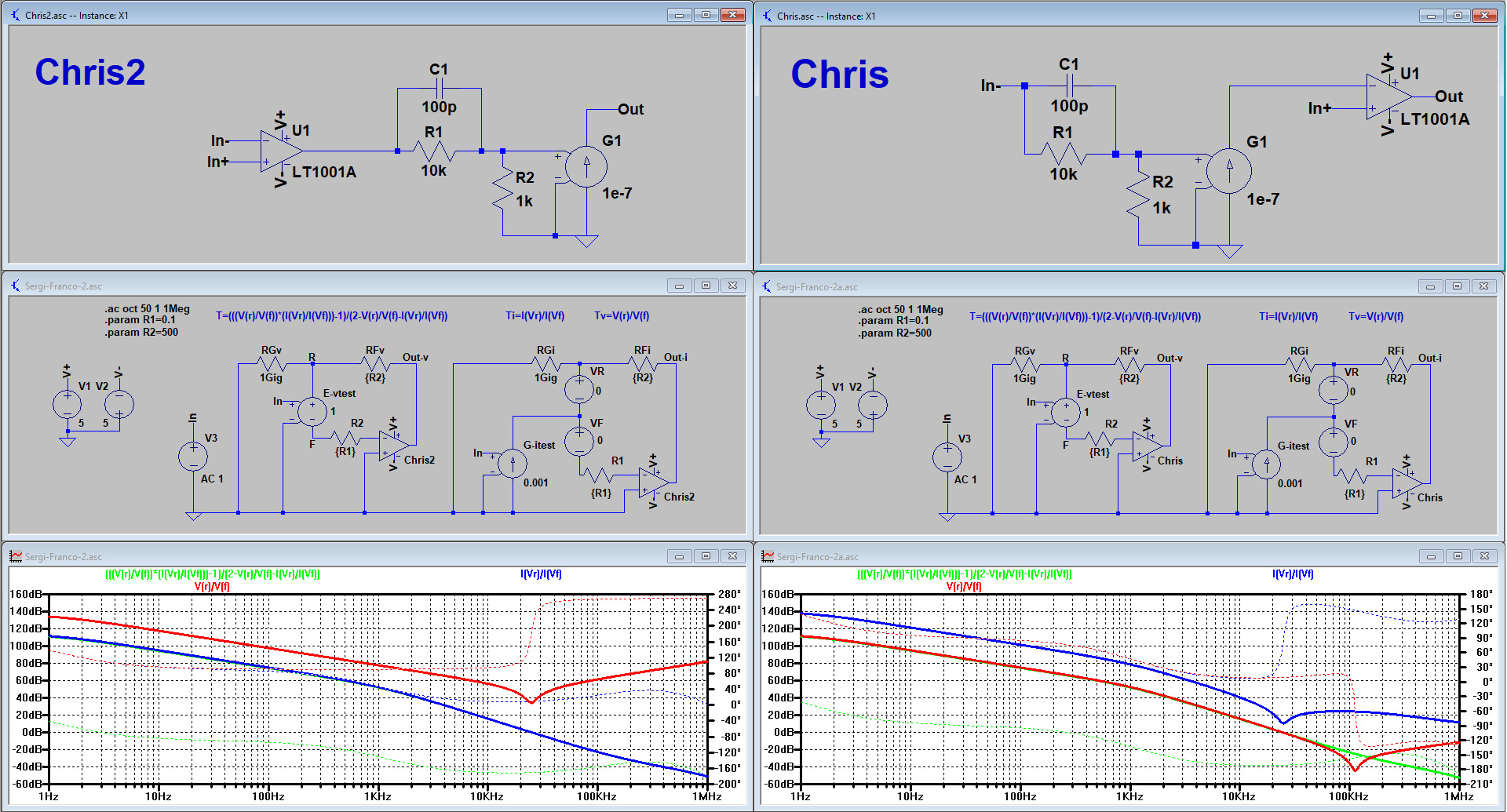

Sorry Chris,
To my opinion you are quite misinterpreting the Middelbrook DIT.
A circuit to be analysed with a DIT should have three handles, a positive and a negative input plus an output.
You have created some Alien with 4 handles. First three being the positive and the negative input plus output all directly from the LT1001.
But a fourth handle is created by using the output of the current source, in your schematic G1 and G2.
When applying a DIT, either the output of the LT1001 or the output of the current source should be serving the role as being the output.
Apart from that, you have changed the original 100K//10pF into 10K//100pF.
I made two new sims, but now both with circuits with the correct amount of 3 handles.
One with the output from the LT1001 as before, the other one with the current source as the output.
And I also changed to 10K//100pF and used a very large value of 1 Gig for Rg, because without Rg, Vr/Vf went through the roof and with a value of 100Meg and lower, the circuit already turns from a CFA into a VFA.
The value of Rf is left as before at 500 Ohm, changing this to lower values, didn't change anything.
To conclude: with a DIT test with Rg>1Gig, the one with "Chris" turned out as a VFA and the one with "Chris2" as a CFA.
With Rg<100Meg both are VFA's.
Hans
Well, that would be great news. According to this the LT1001 turns out to be a CFA !
In both cases you have connected the upper side of the 100 Ohm resistor to the minus input of the LT1001, instead of to the upper side of R4.
Changing that will give you the Middlebrook test and show that a LT1001 is a pure VFA.
Hans

Sorry Chris,
Hans
Right back at you, Hans! Let's congratulate ourselves on what appears to be a legitimate disagreement and not a misunderstanding.
My understanding of Middlebrook's DIT is as follows:
A given circuit is normally used with a signal source to excite it. We leave the source connected but set it to zero.
We choose where in the circuit we want to test loop gains: node X. For us, this will be the inverting input.
The first test is to break the loop at X and insert a voltage source to close the break. We can measure the forward and reverse voltages and take the ratio of the latter to the former.
The second test is to connect a ground-referenced current source to point X. We can measure the forward and reverse currents and take the ratio of the latter to the former.
The lesser of the two gains is associated with the more (predominant form of) feedback.
Please consider Sergio Franco's excellent article that covers this topic at https://www.edn.com/design/analog/4458753/1/In-defense-of-the-current-feedback-amplifier . In Figure 6, he shows how to test the closed loop voltage gain of a particular CFA. No surprises here - this isn't Middlebrook.
In Figure 11, he shows how to examine the types of feedback at the summing node of that very same circuit. Please take note - other than the voltage source that closes the break, and the current source added (plus the 0V sources so he has something to measure the current through) no components were added to or removed from the circuit under test. To have done so would have been to have tested a different circuit from the one whose closed loop voltage gain was tested.
Perhaps I have not convinced you. If so, can you and I dig deep into this article to find the root source of our disagreement?
