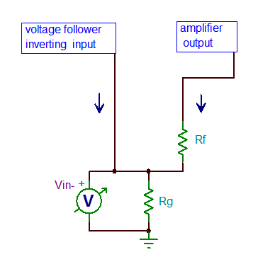

Currents, like voltages, can be positive or negative. Arrow directions mean little on a schematic unless the associated meanings are further defined, for instance by naming the arrows and relating the names with equations.
The arrows represent currents. Would you design the arrow coming from the amplifier output through Rf in the inverse direction ?
I think I recall you arguing that since the current through Rf does not flow through the CFA's in (-), this can't be current feedback.
I think I can maintain that.
If this is incorrect, please say so and disregard the rest of this post.
Correct or not, the rest of this post is worth to comment.

I’m sorry, but in the convention I and others have used extensively, the displayed arrows are ambiguous. Suppose i1 = i2 + i3. This would mean one thing if I named the arrows i1 and i2, and another if I named them i1 and -i2.
For negative feedback to occur in a non-unity closed loop gain CFA, the relative directions of the Rf and in(-) currents must be (and are) such that the former acts to diminish the latter. This also means that the Rf current cannot enter in (-). Your assertion leads inexorably to the conclusion that negative current feedback is a priori impossible in any circuit. Obviously, I reject this conclusion as unreasonable, which forces me to reject your assertion which demands it.

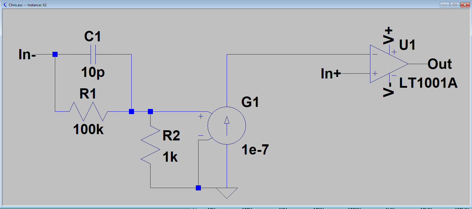

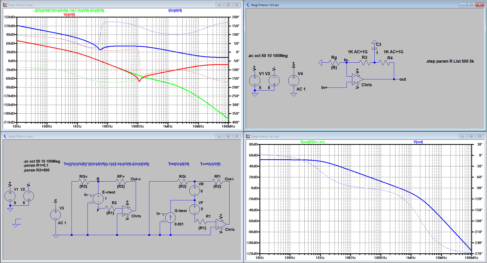

Chris,
I've put your LT1001A circuit through the DIT test and also through the test that I designed.
The DIT at the left is a bit going up and down, but for the most part the circuit is identified as a VFA.
My own test at the right is even much more conclusive in identifying the circuit as a VFA.

Chris,
Hans
Hans, you're not testing the circuit I posted with the current source driving the in (-) input.
In the circuit you tested, the impedance looking into the fb network is much lower than that looking into in (-). It is no surprise you conclude that vf predominates.
And again, I would argue that to be precise, you are testing what form of feedback predominates, not the name of the type of op amp.

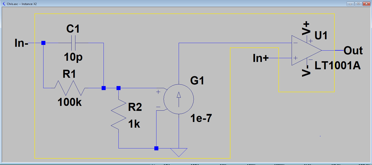

Hi Chris,
Are we having a miscommunication again ?
My one and only intention was to testing the form of feedback that predominates and not the name of the type of op amp.
Please tell me what is wrong in the set up I used, because it's the exact circuit that you presented, see below.
Hans
If the current in Rf increases, the current from in- decreases and vice versa, thanks to the voltage under the control by the emitter.

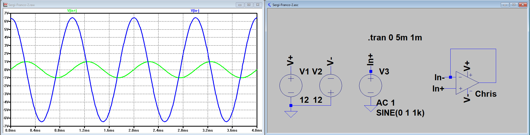

Insert a capacitor in parallel with Rf of a CFA where Rg is 50 ohm and you will see that CFA don't turn into VFA behaviour.
You're right.
By inserting a cap par. to Rf, a CFA is not turned into a VFA but (very likely) into oscillator.
To confirm my suspicion I tried this with a LT1395 with Rg=50 Ohm and Rf=350 Ohm and by placing a cap parallel to Rf I ran into oscillations.
Because Rf is in par. with Z(s), the cap will try to extend the bandwidth of the CFA which is a no no.

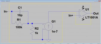

Hans, perhaps. You put the op amp I used in a circuit of your design and tested that circuit properly.
No I did not
You did not test the circuit I posted, for which I made the supposition that cf dominates.
Sorry but you are wrong, I used the whole thing including everything.
Please have another look at the circuit that I used below.
When I connected something wrong, tell me.
Hans
