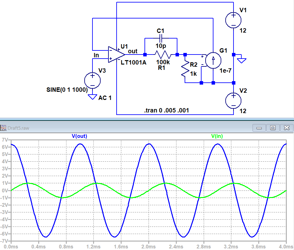

Attached please find a VFA fed back from a pure current source. Turnabout is fair play!
Yeah... you turned a VFA into a CFA.
