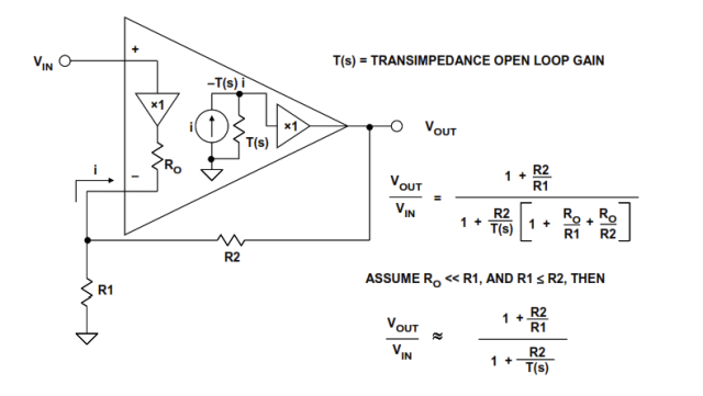

Image from Post #1112
Current Feedback Amplifiers, not only a semantic problem?
The source of this image is Analog Devices, tutorial MT-034 figure 2 or "Op amp applications" figure 1-14

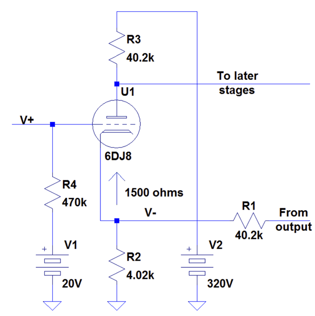

Image from Sergio Franco's article in EDN
post #1427 and #1248
the emitter is a voltage input, not a current input.
An arrow drawn by an angel ?

I'm speechless that somebody can be so persistent in his denial of facts.
All models show that V(out) = I(in-) * Z(s).
Thus whithout input current , no output voltage.
But for letting a current I(in-) flowing through the CFA's input impedance, there is no other way but to offer a certain Voltage at that point.
So the amount of volts are only used as the transport vehicle to facilitate Current I(in-).
There is no mathematical relation between output voltage and input voltage, nor is the input impedance showing up in the transfer function.
This makes the voltage to be offered at the -Input amongst others a function of the unknown and varying input impedance.
But this is not the case for the current, being directly related through V(out) = I(in-) *Z(s).
Thus a CFA is completely controlled by current I(in-), and therefore its current feedback, end of discussion.

I had Hans' reaction to forr's latest post: he was confirming that a CFA employs c.f! How could the post be interpreted otherwise, I thought? But obviously, forr thinks it confirms his beliefs.
I wonder if there is some very basic thing that is the source of this disagreement. Start with the basics, move up the chain of logic and find out where the reasonings diverge.
A few posts ago, you posted a classic control theory definition of feedback. I wonder if forr agrees with that?
I just copied very basic circuits which all the readers of this thread know.
I show three images, with arrows representing current in the following electrode of the input device and in the feedback network.
Two are towards a direction, the third one towards the other direction.
Which is the good one ?
There is necessarily an error.

To verify,
- insert a very low value resistor in the connection between the inverting input and the junction between Rf and Rg.
- measure the AC voltages (referenced to ground) at both ends of the resistor. One is higher than the other. It is up to you to draw the arrow.
