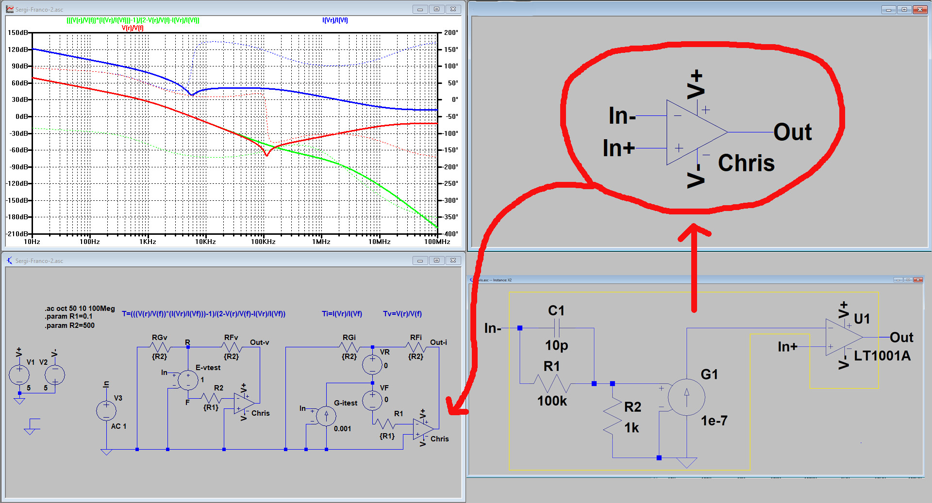

I'll do my best trying again to explain how LTSpice works.
Look at the image below.
I made a subckt and called it Chris.asc, being your design in completeness as shown in the image below at the right bottom with 5 so called Ports resp: In+, In-, V+, V- and Out.
With an Chris.asy file I made the reference to this whole subckt look just like an op amp when being inserted, again with In+, In-, V+, V- and Out.
So when calling "Chris" it looks just like any op amp, but in this case your complete subckt is inside.
This makes it much easier to insert "Chris" in my DIT test circuit, below left, where the circuits to be tested should have this op amp shape.
Now when doing a DIT with "Chris", all I have to do is to insert this self created component that looks like an op amp, but which it is not, in my DIT test model.
I hope this makes it clear what I did, and takes away your doubts that I did not use your complete circuit.
Hans

And here are Chris.asc and Chris.asy in a zip file.
Unzip them, put them in your LTSpice directory and use them by clicking on TOP DIRECTORY and select Chris to insert him in your schematic.
Hans

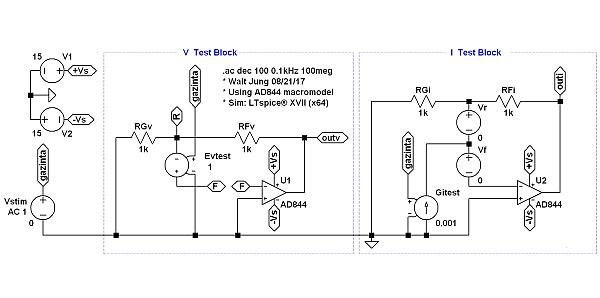

Post 1668 adds resistor R2 that is not in the circuit I posted. With R2 added, the impedance of the feedback network is a lot lower than that of the inverting input, so of course the circuit will have predominantly v.f.
You've built a nice .asc with the equation embedded in it to perform DIT. I could insert my own circuits into the file and perform DIT on them. Would you be so kind as to post it? Thanks in Advance.
Post 1668 is touching a different subject.
You are probably referring to the DIT test in #1704.
This is the DIT test as Middlebrook has designed, including R2.
One is Rf and the other one is Rg.
Tell me what you would like to do with R2, and I'll do it for you.

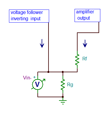

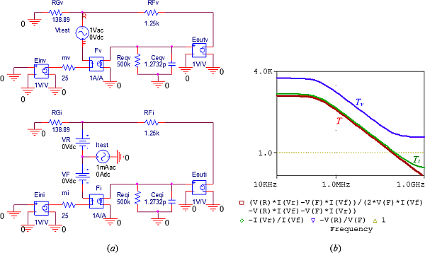

Hans, Middlebrook does not ask that any passive components be added. All he asks is to set the input signal to zero and insert a voltage source in one case, and a current source in another. Any components added beyond these change the circuit under test.
Chris,
look at the Middlebrook layouts below.
The certainly have an Rf and a Rg.
But send me what you want to see for Rf and Rg and I'll do a sim for you.
Hans
