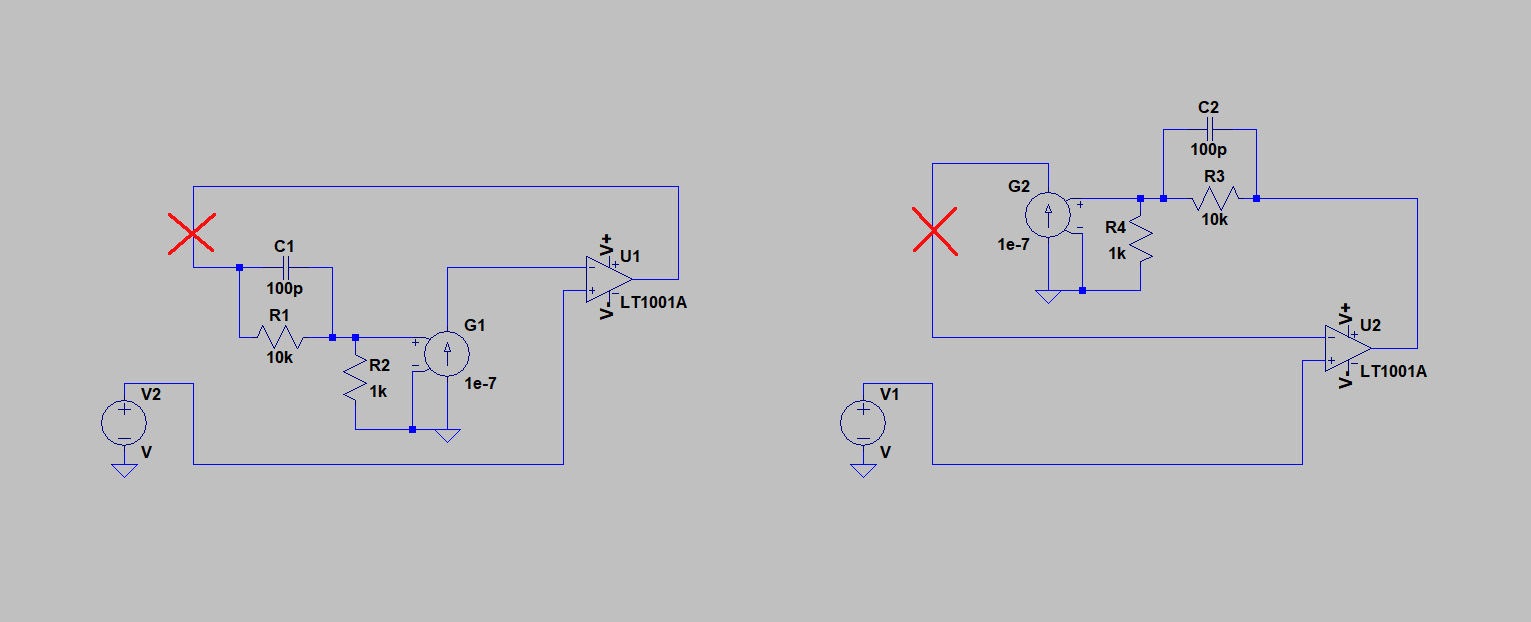

Hans, you are assuming that I was testing circuit forms that I never intended to test.
Please recall that I can choose to insert the DIT at any point I choose. I chose the points that I intended.
In the case of the first circuit, the circuit I was testing before applying Middlebrook never had any resistors connected to the inverting input - only the current source. To add resistors would have tested a circuit other than what I had intended.
In the case of the second circuit with the 100 ohm resistor, I purposely tested the resistor in combination with the inverting stage. Middlebrook places no restrictions on the point I choose to apply his test, and the location I chose was exactly what I intended.
So perhaps we have another miscommunication after all, which, while unfortunate, is more easily resolved than a disagreement! What do you think?

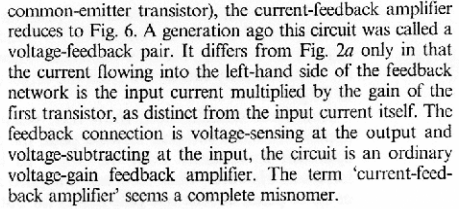

Excerpts from
E.M.Cherry, IEE Proc/-Circuits Devices Syst; Vol 147, No 6, December 2000
"Feedback amplifier configurations""Feedback amplifier configuration" :
IEEE-CDAS_Cherry_Feedback-amplifier-configurations_Dec-2000.pdf - Google Drive

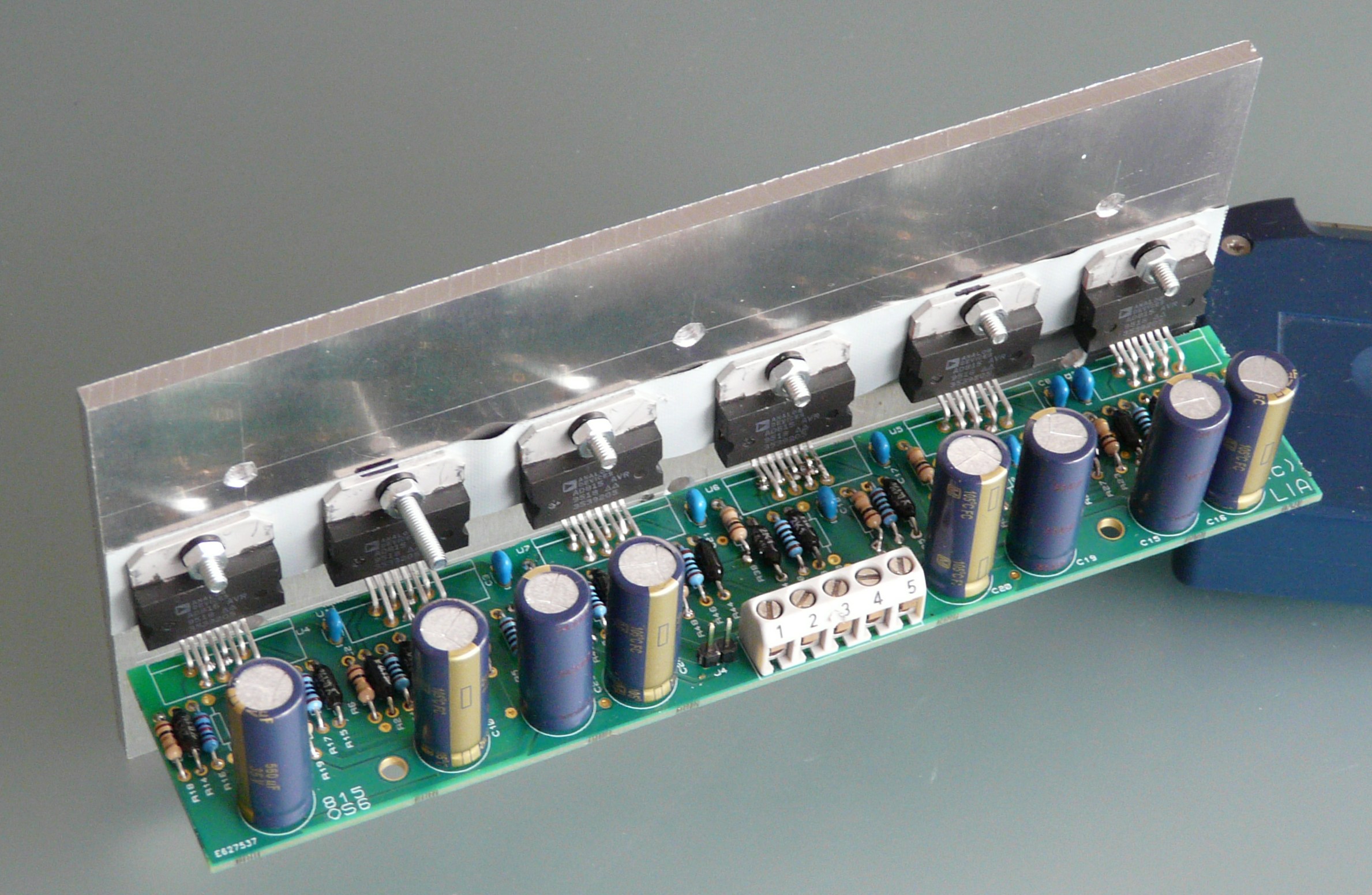

but I will be fully satisfied, on an intellectual point of view, when I will see an amp with a constant feedback ratio, a flat phase curve and a flat (low ) distortion curve all along the audio range (20-20 000).
These are all the same thing of course, so you're looking at an ol bw of beyond 20k.
I've met many opamps that satisfy this. I remember building a poweramp with 6 dual AD815's in balanced bridged for 30W/channel. That's an opamp with 20+kHz ol bw. The fact that it also can deliver almost half an amp per opamp is a bonus.
Ohh and BTW it's a CFA 🙂
Ohh and BTW2 I think Scott designed it. Or one of his buddies.
Jan
What I think is quit simply that Middlebrook attempts with his DIT test to discriminate VFA's from CFA's.
And for that you have to make the cut at the right point.
Of course you are free to make the cut wherever you like, but the outcome seems at least disputable whether it can still be used for separating VFA's from CFA's.
And when a LT1001 comes out as a CFA, it's enough reason to raise the eyebrows, unless you wanted by purpose see what happened when making such a strange connection as if the input impedance was only 100 Ohm.
But that doesn't turn a LT1001 into a CFA to my opinion.

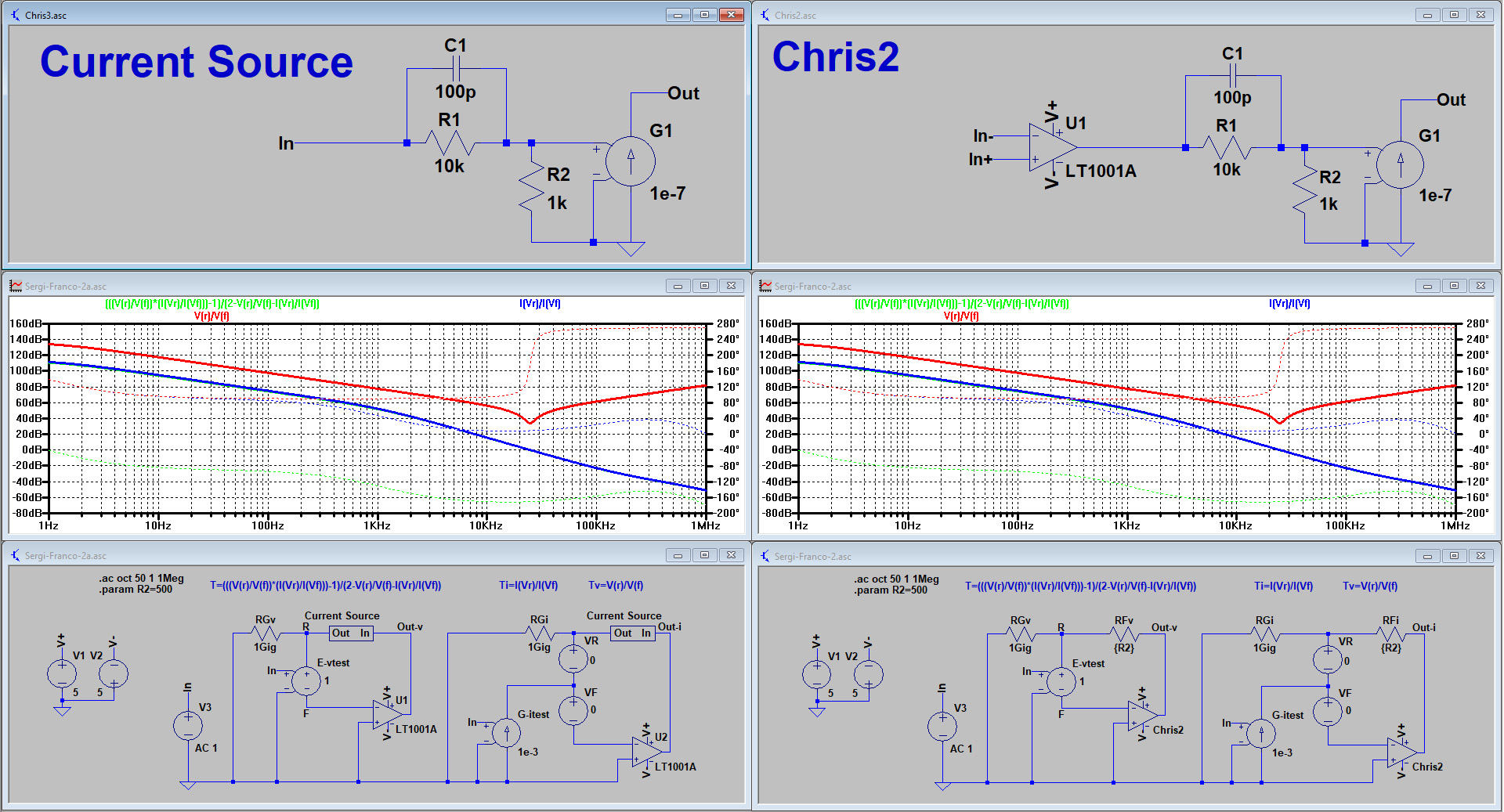

But now to the more complex circuit design that you made with the added current source.
You are right that a cut should always be made right before the minus input and that the voltage and current sources can be inserted at this spot for doing a DIT.
In this very case there are two ways to look at the circuit making a big difference where the cut is made.
One is seeing this current source construction as integral part of the input and the other as seeing the current source as a sort of Rf, where the cut should be made after the current source and thus before the minus input of the LT1001.
See image below.
In my first Sim, I made the cut directly after the LT1001 as in the left part of the image below. This is what I called "Chris".
By placing the cut after the current source and before the minus input of the LT1001, gave the one that you used. This is the part that I called "Chris2".
So we were doing the same thing, but just cutting at different places.
Now at the same spot, our results are of course identical.
Below at the left is what you did and at the right what I did with "Chris2".
And forget what I said about placing the label "Out" at he right spot, because in the calculation of Ti and Tv, there is no reference to V(out) at all.
Hans
P.S. This same Sim was made in #1733 as one of the two, so the remarks made over there are stil valid.

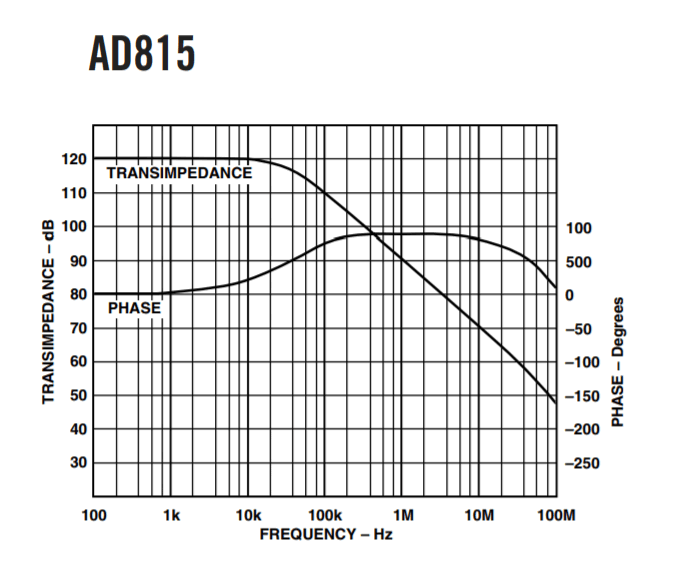

Of course 🙂.
A little acrobatic, no ? What about distortion and damping factor ?
Anyway, look at the attached: more or less what i said, ~10K , no ?
Of course ;-)
I'm an old AD/PMI addict ;-)
You are right that a cut should always be made right before the minus input...
I never said this. When offering an opinion on the topic, I have always said I can put the cut wherever I want.
...and that the voltage and current sources can be inserted at this spot for doing a DIT.
In this very case there are two ways to look at the circuit making a big difference where the cut is made...
Hans
Yes, good we get the same results. I think that the span of our disagreement is narrowing. Let's see if we can close it further.
