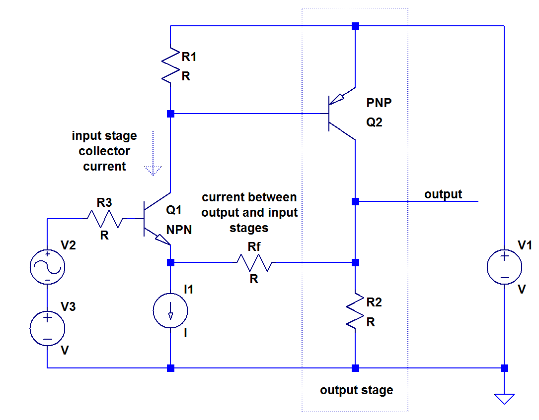

Please refer to my schematic. AC current flows through the input collector, correct? It must also flow through the associated emitter. It cannot flow through the (DC) current source, which will not pass AC signals. It must flow somewhere. If not through Rf to the output stage, then where does it go?
You sent your message just after mine, so you have not read it before writing yours. I think that my message will make my point of view clearer.
If you tell me it does not flow through the output stage, then I will bother you no more. It will have become apparent that there is too big a gap to bridge in our understandings of elementary electronics.

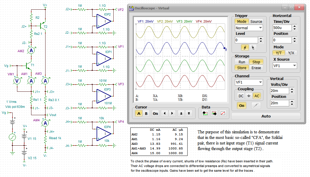

One step at a time. Start with the unity gain CFA - certainly a practical circuit - the schematic for which I have provided. It has an Rf, but no Rg. The input stage signal current flows through the output stage, correct?

Seeking the flow of this input signal current desesperately (I added a bouquet of phases) :

The purpose of the simulation I did has no relation with your comments.

Please consider the more general case of a CFA with an Rf, and (at least at first) with no Rg. Once that is addressed, you can always add an Rg, and even revisit the degenerate case of Rf = 0.

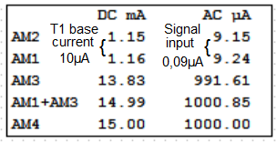

It seems clear that the signal current through the Rf is the same as the signal output collector current of the input stage, except for a small difference which of course is Ib (transistor appears to have hfe of 100). AM1 = AM2.
QED.

Please don't waste your time applying my comments to your circuit.
My comments and simulation are in contradiction with yours.
Instead, as I had requested, comment on their application to the more general case of the circuit I previously posted, and which I post again for your convenience.
Remember you request :
My answer is clear : I did not find anything which may show that.
There is no Rg in your circuit, is it the resistor connected to the output in the feedback voltage divider for voltage gains higher than 1 ?

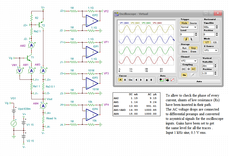

New schematics correcting the value metionned for the input signal, it was 1V RMS. I also added a short note on the purpose of the schematics.
You have proven my point. Remove R4 and you don't have an output stage - you don't even have a properly functioning circuit! Therefore, R4 is part of your output stage, which needs a return to V- of some kind to work. And the input stage current clearly flows through that output stage.
Will you please, please address your analysis of my comments to the circuit I sent you? In it, R2 is part of the output stage. Capacitively couple an additional load to ground if you feel the need. I asked you repeatedly to comment on the application of my comments to the circuit I provided. It is disingenuous to continue to apply them to a circuit they were not meant for.
Actually, your sim confirms my claim and contradicts yours. Please see my prior post.
The Rg I refer to would be connected to the input stage emitter.
