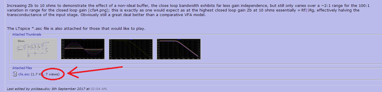

For another example of how to make use of the impedance controlling the OLG, if you have a low-Z divider, say, a 47R:47R gain-of-two network, you can short out the stability resistor (say, 1k) with an inductor and get increased OLG at low frequencies from the additional pole and zero (or zero and pole if you look at the impedance).
A picture is worth one thousand words.
