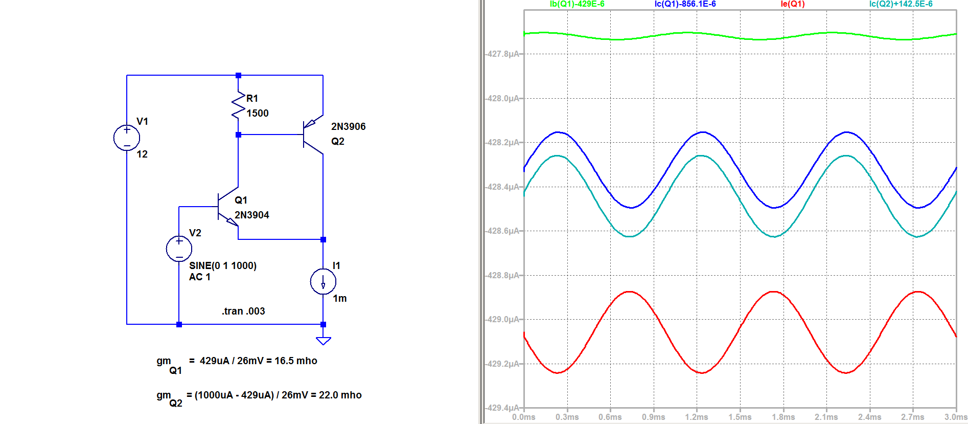

Sure. Add a CCS. Step by step, right? Start with no load, and the simplest possible CFA circuit yet, the first circuit attached. See that the output stage's AC collector current is the input stage's AC emitter current?
Now, if you wish to add a load (AC coupled), you will find that the difference of the load and output stage currents is the input stage current. A combination of the two is fed back into the input stage.
Often the load's and Rg's demands exceed what the input stage alone could possibly provide. But the output stage's current is always in the mix, even when at low signal levels, if Rf were disconnected, the input stage would be capable of supplying all that is necessary to Rg.

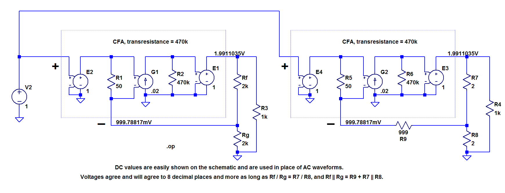

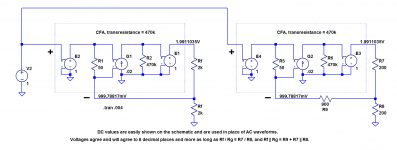

Finally, it is shown (second attachment) that two different non-unity gain feedback networks provide identical performance for two identical CFA's, one of which lacks an "Rg". The CFA works just fine without Rg, and explanations of CFA performance should not depend on its existence, nor of the use of extremely small values for R9.
In a CFA, input stage AC current is a portion of the difference between the load and the output stage AC currents. Whereas in a VFA, that current is in no way a part of that difference. Hence, historicity aside, the technical justification for a description of the operation of the device, and therefore, its name.
Yes. I didn't go very far tonight. The results with a CCS as the load for the output of the Sziklai pair was a bit deconcerting at first and then very interesting.

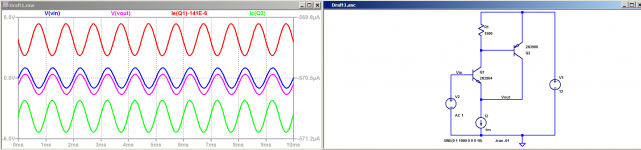

I modified my circuit in replaced resistor Rload - 1 kOhm which goes to the negative power supply by a 15 mA CCS. Here are the notes I took :
Currents in transistors
Input T1...............DC...........AC
base......ib1....11,53 µA.....17,01 nA
collector.ic1.....1,15 mA.... 19,83 nA
emitter...ie1.....1,16 mA.....36.84 nA
Output T2
collector.ic2....13.84 mA.....37.02 nA
Comments on the AC values
ic1 is very different from ie1
ic1 is fortuitously about the same value as ib1
ib1 + ic1 = ie, as intended
ic2 = ie1
The two currents converge on the infinite impedance of the CCS which delivers a constant current. If one of these currents increases, the other decreases of the same value, so they have to flow in opposite directions.
The only impedance seen by T1 emitter being the impedance of T2 collector, what is the transconductance of T1 ?
I couldn't quite make out the value of R2 in your circuit to simulate it, so I did the best I could with the first attachment. The sim gives AC currents more or less as I would have expected: ie1 = ic2, and (unlike your results) ie1 is approximately equal to ic1, both of which are a lot greater than ib1. Here, the input stage AC current is the output stage AC current (current feedback).
In the second attachment, two different feedback networks yield identical voltages at the CFA terminals. I have chosen absurd values for R7 and R8 in the circuit on the right to make the point that the inverting input current makes negligible contributions to driving R8. The input current is the difference between the output current and the R8 current. The circuit works just fine without a shunt to ground from the inverting input. (A general explanation of CFA operation must be able to explain this circuit.) Again, we have current feedback.

It seems there was something wrong in my yesterday's simulation with ib and ic of T1.For my comfort, I redraw my diagram, the behaviour is now as you say. I changed names of components and values. Power supply is now +/- 10 V. This current in T1 has been adjusted to 1 mA and the CCS current is now 10 mA.
I found ie1 = ic2 in opposite phase when there is no load at the output.
They are in phase when the load is low. So there a must be value of the load where the transition occurs. I found it was about of 382.5 kOhm with curious effects of the shape of the current, the frequency is doubled.
http://iodau.pagesperso-orange.fr/forr_CFA Sziklai CCS.png
I am happy to grant that with any significant load, the input and output stage currents are in phase. With no load, they are out of phase, and the CFA employs positive current feedback!
Looking at things from your point of view, two sources (input and output stages) feed a common, source-less network. There is a simple relationship between the currents from these sources: the input stage current is (is not simply equal to) the ground current from the feedback network and load minus the output stage current. The current feedback is now negative from the output, and includes a contribution from the network/load current (almost all of which comes from the output stage anyway.)
This simple statement applies to all three circuits of post 812. Do you have a similarly simple alternative that covers them all?
