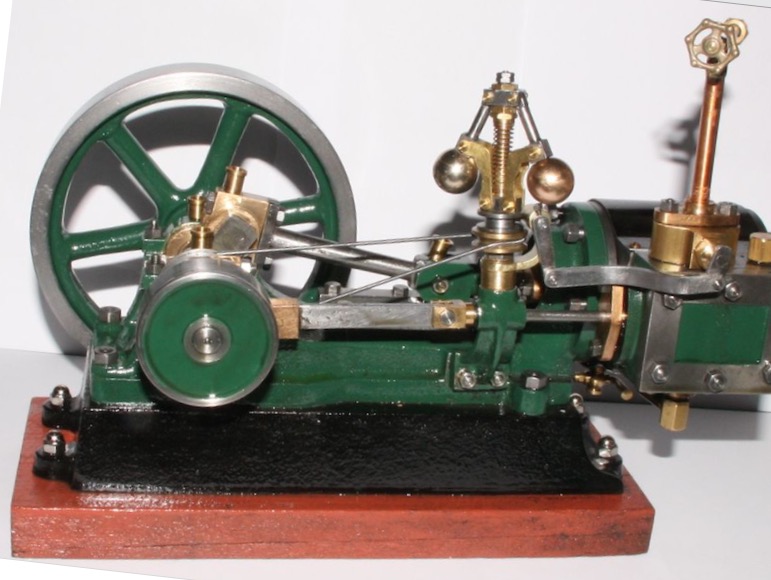

What would the negative feedback be called for this machine?
A centrifuge governor senses wheel speed and applies a force to a pressure release valve.

In the widest possible sense You could put up any machine and ask the same question I guess. How the output controlled variable is sampled and then transformed into a suitable signal for processing in the difference engine is very machine dependent. It obviously volts or amps in the audio amplifier context we are discussing here.

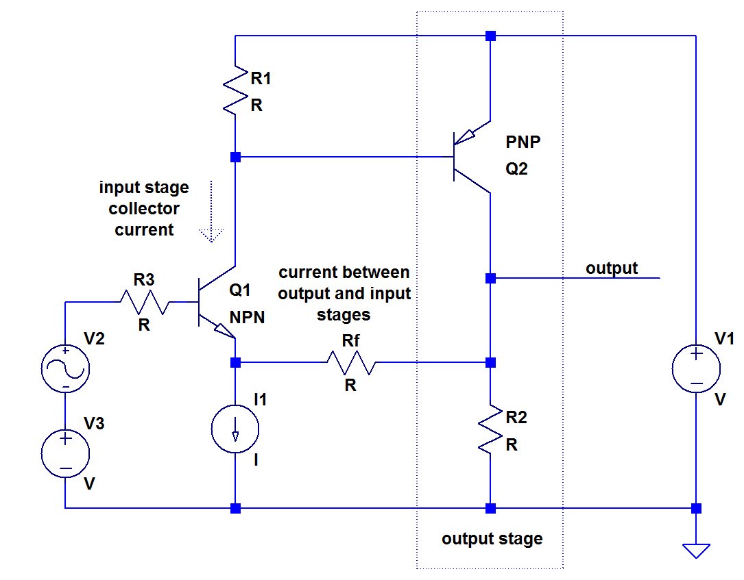

Can we agree that for a CFA configured for unity voltage gain (no Rg) that the input stage collector (non-bias) current is substantially the same current that flows (exclusive of any load) from (or into, if you prefer) the output stage?And if we add an Rg, that the collector current is the same current as some fraction of that which flows from/into the output stage?
This configuration is not clear to me as there is necessarily a load. I join a schematics of the simplest CFA and VFA unity gain circuits to help.

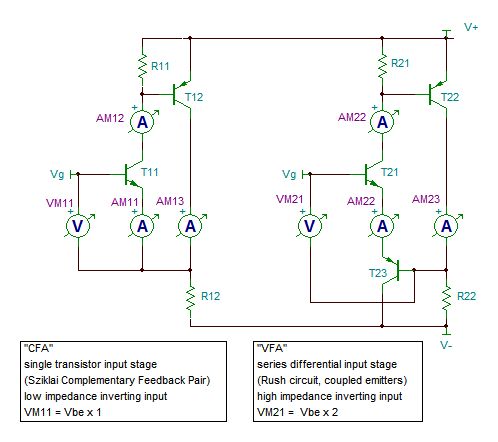

So there is no distinction between CFA and VFA if C and V which, if not suggesting the way the output is controlled (first old meaning) should suggest the way the feedback controls the internal values, it is clearly not the new meaning for CFA.

The output (collector) current from the input transistor is the current sourced from the emitter, which is the current sourced from the output stage through the feedback network.
If you are familiar with the superposition principle (I know you are), then seen from the inverting 'CFA' input, that input transistor works in common base, Ie = Ic, that Ic being amplified to form the output current.
The output current of Q1 is the current that comes in through Rf - there isn't any other way.
So it's currents all around, a strong argument that indeed it is current feedback; the output current of the input transistor is current fed back from the output through Rf.

In my machine example (post 741) I was trying to show what conventions are. It would be normal to speak of the machine having speed feedback because this is what is sensed and what is being controlled. It would be odd to call it, say, force feedback because that's not what is being controlled, even though force plays a key roll in the governor.
The input transistor works in common base in open loop.
In close loop, it works like an emitter follower (with a light load in its collector).
It imposes its emitter voltage to the emitter load (the feedback network).
The remaining part of the circuit adds current to the load and to the feedabck network, so it increases the impedance of the feedback network. The emitter current has less current to provide, the emitter voltage commands the whole.
Think of a Sziklai pair. Has anybody ever analyzed it as having an input transistor working in common base ?
I don't think we disagree with what we call the machine. In both the CFA and VFA topology case (assuming conventional audio amplifier usage) you would have a voltage output amplifier (low Zout, high current drive capability to drive the speaker).
The form that the feedback from the voltage output back to the error amplifier however does not have to be a voltage - and in a CFA it is not - its a current.
You have to distinguish between the output controlled quantity and form that the feedback representation takes.
In the case of your machine, its output is speed controlled, but the representative feedback signal might be in a different form - like force as you quote.
