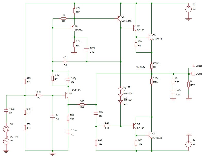

@wahab
If you implement the missing R and L for complete current dumping - what is then the final THD (or FFT)?
@MarcelvdG
Could you add your modifications to the 405 as a schematic to complete this thread?
greethings,
HBt.

in the last few hours I have taken the standard circuit of the late 1960s as an opportunity to feed MC12 as a precaution. I use BC546B, BD140 & BD139 as well as MJE802, a VBE multiplier with the BC547C recessed between the cooling plate of the end transistors of the same conductor type. R13 and R7 are considered trimmable. Iq exactly 30mAdc.
Now the THD_1k always remains below 0.01%, the famous bathtub has a depth of 0.001% ... why do I need the dumper mode now ???
A Revox A78 doesn't need a current dumper either - and (btw) I love this amplifier.
greetings,
HBt.

For such sims i dont bother with exact thermal stabilisation since that s not the point under scrutinity.
Four is indeed incorrect. There are six semiconductor junctions of five different types involved:
2 times 1N4004
BY229
BD139
MJ15022
BD140
The CFP Iq is set by the driver since the power device is enclosed in its local FB loop, so there s 2 devices whose
Vbe decrease by 2mV/°C but this is over compensated by the three diodes, wich happen to also compensate
the beta variation, believe it or not, Iq is exactly 16.92mA at 27°C and increase to 17.68mA at 60°C.
Other than this in the original 405 the upper device is -600mV reverse biaised, wich set it in a slight class C mode,
they added a diode in the 405-2 to get it 60mV forward biased and this logicaly decreased THD but also increased
the VAS current from 60 to 75mA.

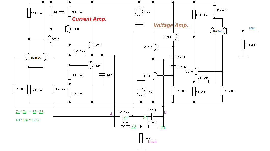

If you could, you could also design two completely discrete operational amplifiers. One (the one on the left) with plenty of crossover distortion and switching characteristics and another (the one on the right) with a class A PP output stage. This makes the dumper principle much easier to recognize.
That would be worth an investment?
... the above "dumper for dummies" can never really feedforward-correct a real class B power amplifier (almost currentless).
The current source of the Matsushita Class AA concept and the Voltage control Amp. do this with ease. That is the difference. An illustrative, I admit: mean example.

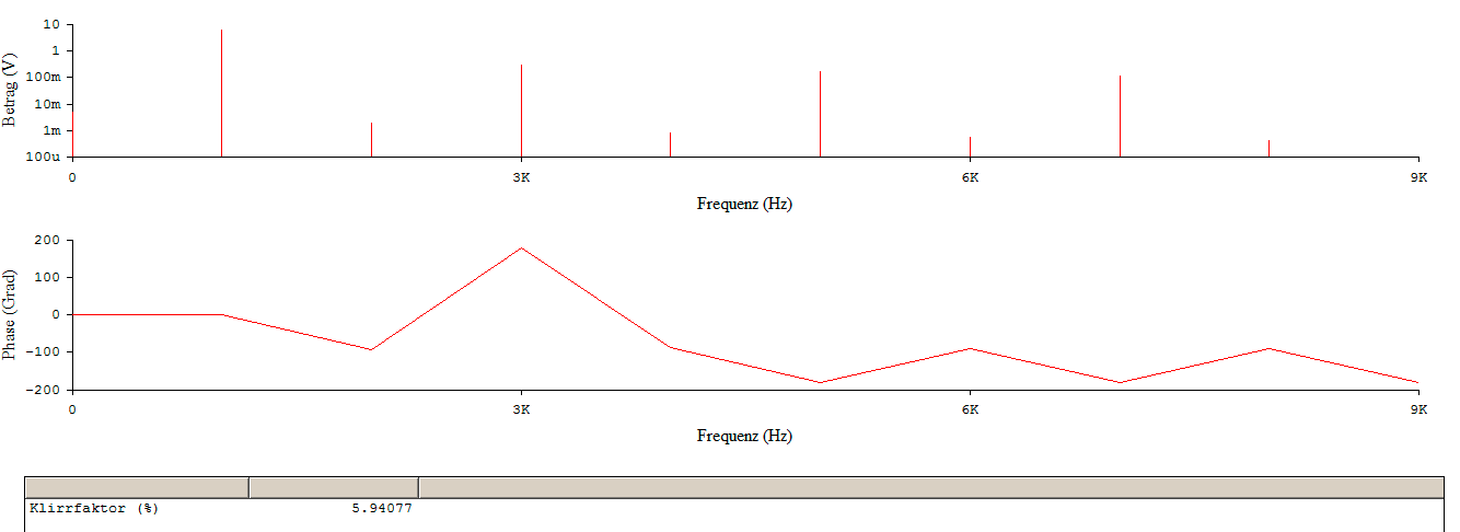

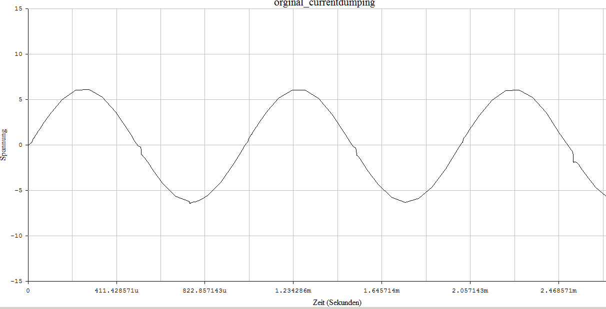

Let's just take a look at the spectrum of a 2.5Wrms output of a profane push-pull power amplifier in (real) B mode (no AB):
Our NFB is now supposed to reduce a very unpleasant distortion factor of 6% to perhaps 0.06%. And with the help of a magic air-core coil and a small bypass resistor working dynamically in parallel, we want 0.0006% ---> that doesn't work!
