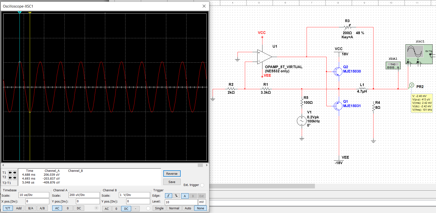

Very insightful explanation. Base on that, I come up a calibration method that you can tune the feedforward resistor until all the injected "distortion" is gone.
If you start with the circuit in the OP, to calibrate:
1. Ground the input. Disconnect the load(speaker).
2. Inject "Error" signal as below to the output of the dumper. A serial resistor is required. Make sure the peak voltage is less than the threshold voltage of the dumper.
3. Scope the output, while adjusting R3 until all the signal is gone.
[EDIT] New version circuit fixed some issue caused by opamp non-zero output impedance.

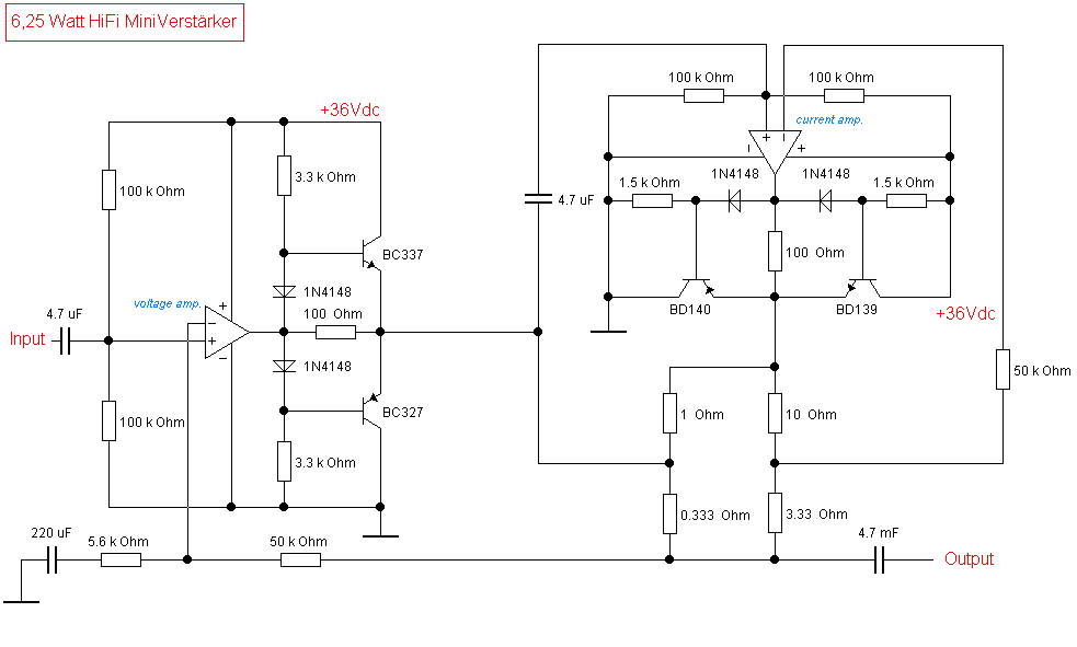

I've now spent a few hours in front of the stupid screen and my old SPICE - yes, current dumping (feedforward) works. But why are we playing? Probably the puzzle is tempting us ..!
In the end, I wasn't satisfied with the result either, but it was only supposed to prove that it works and it does.
I played a little further and the OP-Amp's as starting points of the exercise converged to another known concurrence concept, which can also correct even a currentless push-pull output stage almost completely.
Perhaps the last state, late at night (with no more thinking left), is also an incentive for you, with or without a dumper.

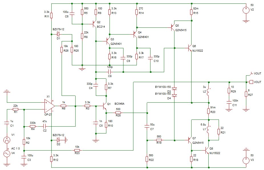

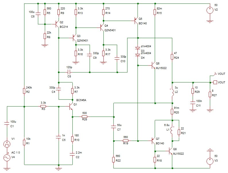

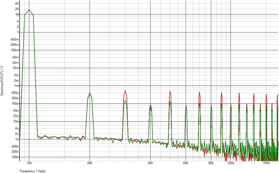

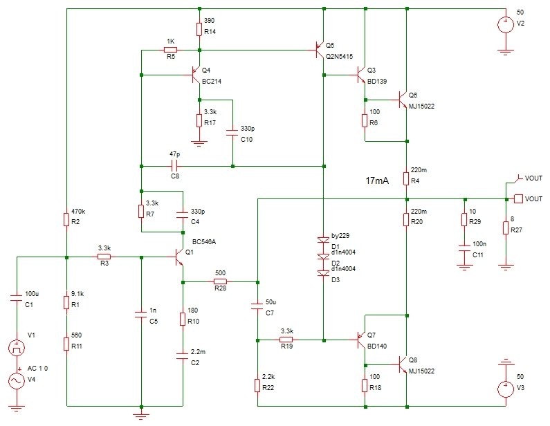

I repost the Quad 405 schematic as well as a slightly modded version, as you can see the amp and OS are strictly
the same with same VAS current, but no FFWD at all while two low drop diodes set the OS bias at 6.6mA,
only the upper device is on as on the negative side those 6.6mA are drained by the driver.

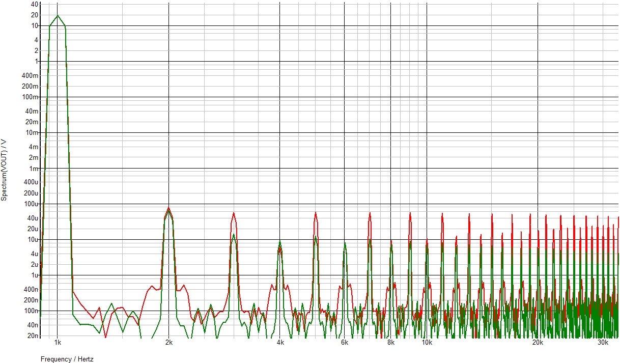

The FFT show the THD at 14V pk, in red the original amp and in green the modded and 6.6mA half biased one.
Also without L2 the amp is not perfectly stable in both cases, but anyway 5mA Iq is enough to get the same results
while using the same schematic.
As for using an opamp as driver that s the same if not worse, an EF1 biaised at 500uA bias is much better than this
half legged FFWD, and with an EF2 900uA are enough to vastly outperform the FFWD scheme also using an EF2.
Notice that those 900uA flow entirely in the drivers of the EF2, the power devices still being off.

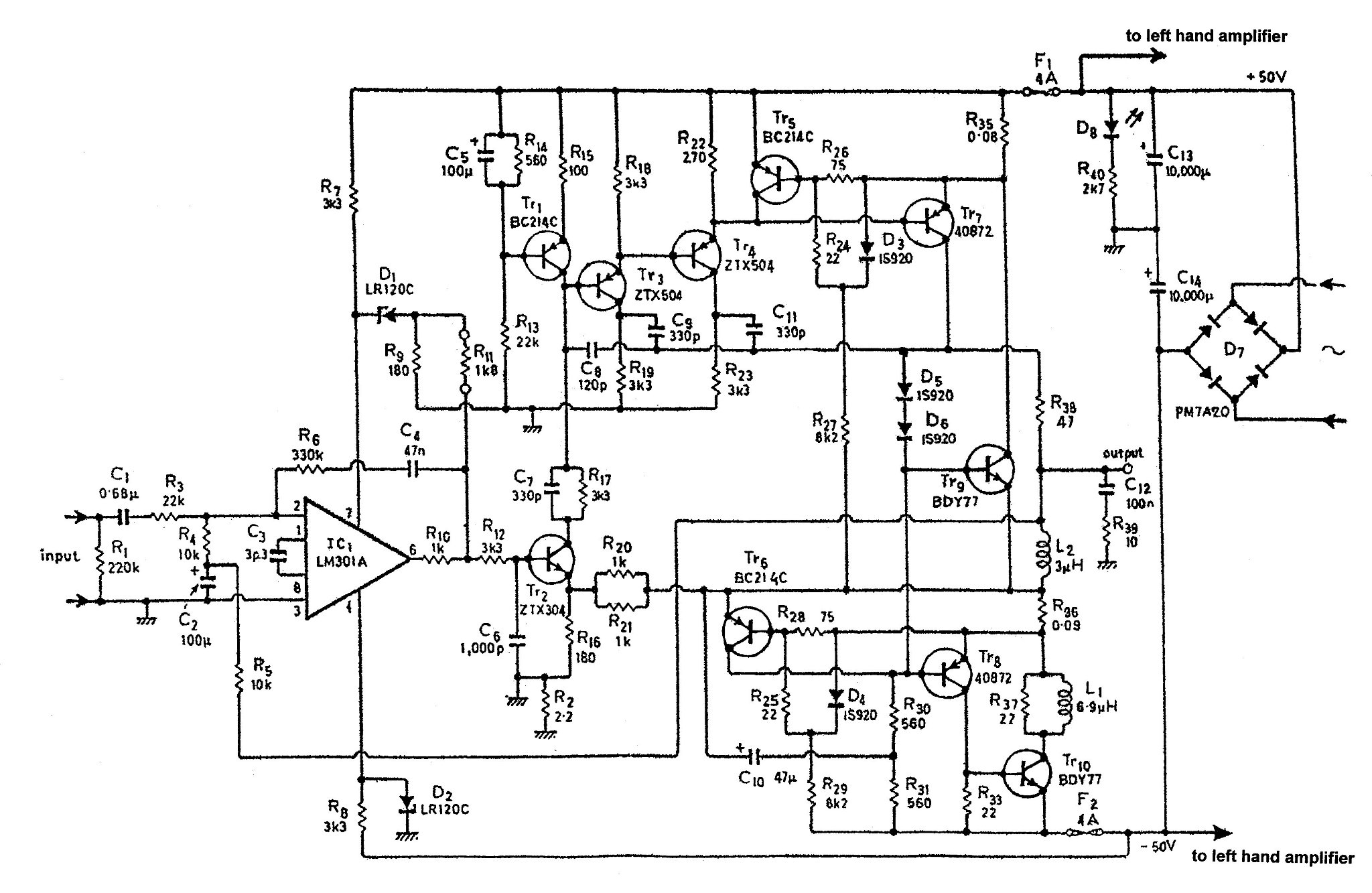

One thing has to be said honestly about the 405:
The circuit is pretty crazy, an integrator followed by a first-order low-pass filter with a cut-off frequency of less than 50kHz, Q1 closes seamlessly as a voltage-amplifying stage in an emitter circuit whose emitter electrode acts as an input for the gnfb. Its collector load is low, i.e. a quasi current source as a working resistor - the result is a very large single-ended open-loop gain. Q3 and Q4 cause a level shift and (load-free) decoupling, i.e. a cascaded EF (a classic impedance converter, a kind of Darlington). Q5 and Q6 now form a compound darlington (100% local negative feedback, i.e. very linear). The emitter of Q6 forms the actual output node of the power output stage. This output node now feeds the equivalent PNP transistor from Q7 and Q8 - resulting in a quasi-complementary output stage in B mode.
Q1 is somehow everything at the same time, it is a phase inversion stage as well as the main node for the important control difference formation. If you simplify the jumble of lines, you are left with a very familiar structure, namely the JLH-69 (also known as the output stage in the famous TTL logic circuits ...).
What is the task of the integrated OP-Amp as the upstream stage? It adds the input current with the current required for offset correction, but it also supplies the voltage-amplifying main part formed from Q1 and consorts, completely independently of the actual amplifier ..!
1 + R28/R10 = 3.8
To be honest, this setup is an extremely negative feedback amplifier. The first part inverts, amplifies up to the rail limit (of the op-amp) and ensures continuous offset correction of the second, also inverting part.
Totally crazy, and that's what makes this legend so appealing, no more and no less. The slogan “Current Dumping” is and was nothing more than a marketing gag.
I'm pretty sure the discrete stage from base of Q1 to output is non-inverting. Note that it provides non-inverting feedback bias to the opamp's inverting input. Overall gain from C1 to speaker output is inverting.

Quad 405 is very well designed. Here is my analysis.
Based on the original circuit posted in #83, 47 Ohm feedforward resistor with 3 uH inductor, the corner frequency is about 2.5MHz. That is very aggressive considering the fT of the original output transistors is only about 5MHz.
At 20KHz, the impedance of the inductor is about 0.38 Ohm. With 100W into 8 Ohm, 5A peak, the current passing through the 47 Ohm is about 0.38/47*5 = 40ma peak. That is -40ma to +40ma before we consider any offset. During the positive swing, the offset is about 3 pn junctions (2 diodes plus 1 output transistor), so the max current on the resistor during the positive swing is 40ma + 3x0.7/0.047 = 85 ma. During the negative swing, the offset is 1 positive pn junction, so the max current on the resistor during the negative swing is -40ma + 0.7/0.047 = -25 ma.
The VAS is single ended. It can feed almost unlimited current, but it can only sink about 50ma provided by the bootstrap. The offset on the 47 resistor is very smart. It essentially offset the current requirement of the 47 Ohm feed forward resistor.

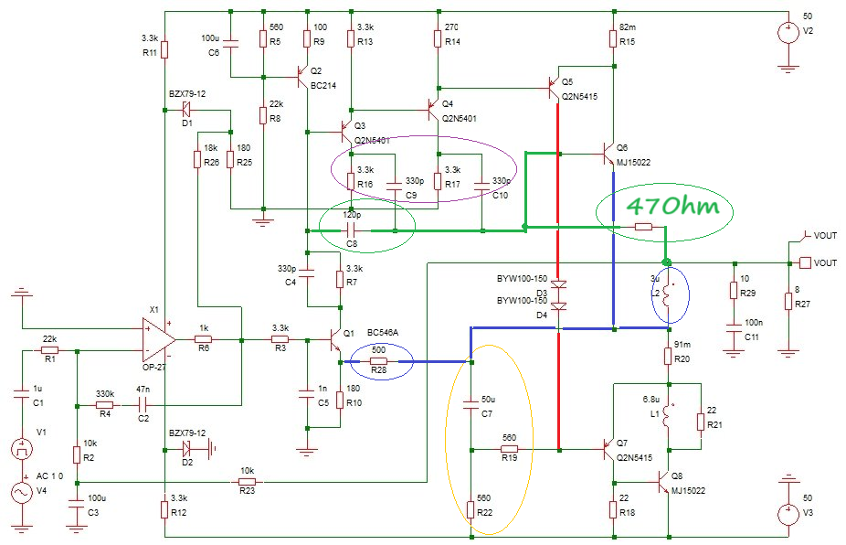

Perhaps it would help to mark the individual paths and also the standard bootstrap.
  • red shows us the equivalent single-ended class A voltage amplifier component
  • blue shows the low-impedance (because of strong negative feedback) section with transfer problems
  • green, blue and red indicate the path of the dumper, the classic bridge structure (if you like to put it that way)
47Ohm indicates the feedforward branch!
A pretty jumble ...

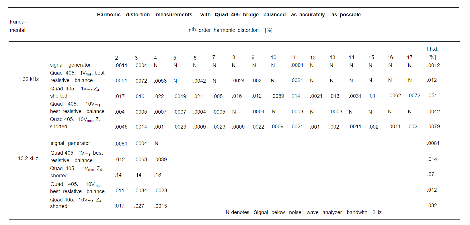

Once i have some time i ll do some comparisons between the original and the same driver using a regular QC and an EF2
as well as checking a TMC implementation, in the waiting here a paper from Wireless World with a mathematical analysis
and measurements on the first 405 version at various powers and frequencies.
Reactions: hbtaudio

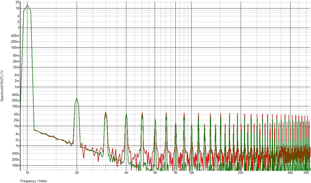

Some sims of the Quad inner amp, since that s the actual amp, and a simplified version using a regular QC
with no FFWD, original is the red traces, the numbers talk by themselves.
