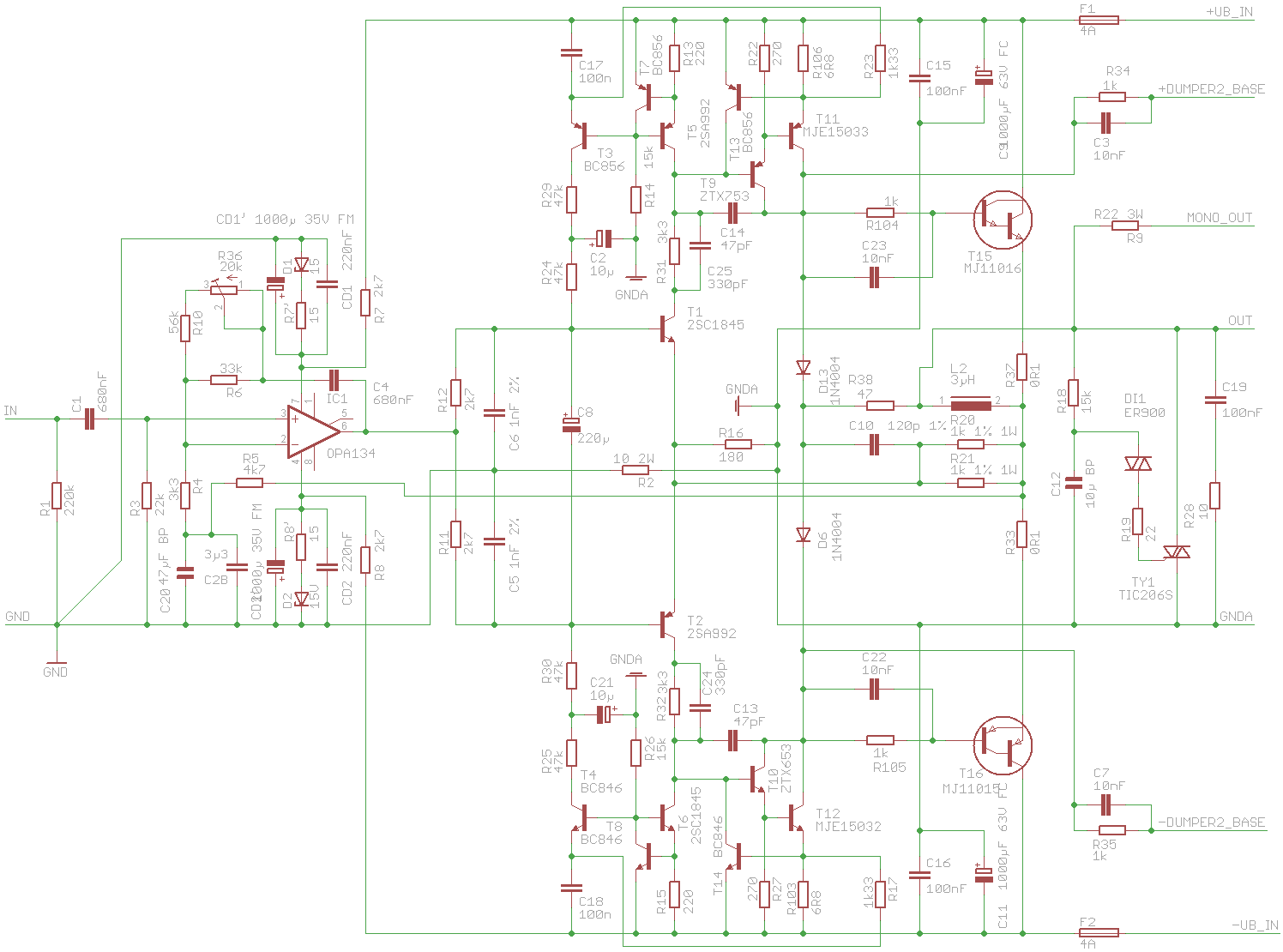

14V pk for the Quad 405, with the exact schematic.
What’s the signal you used to test? 20K, full power?
1kHz.

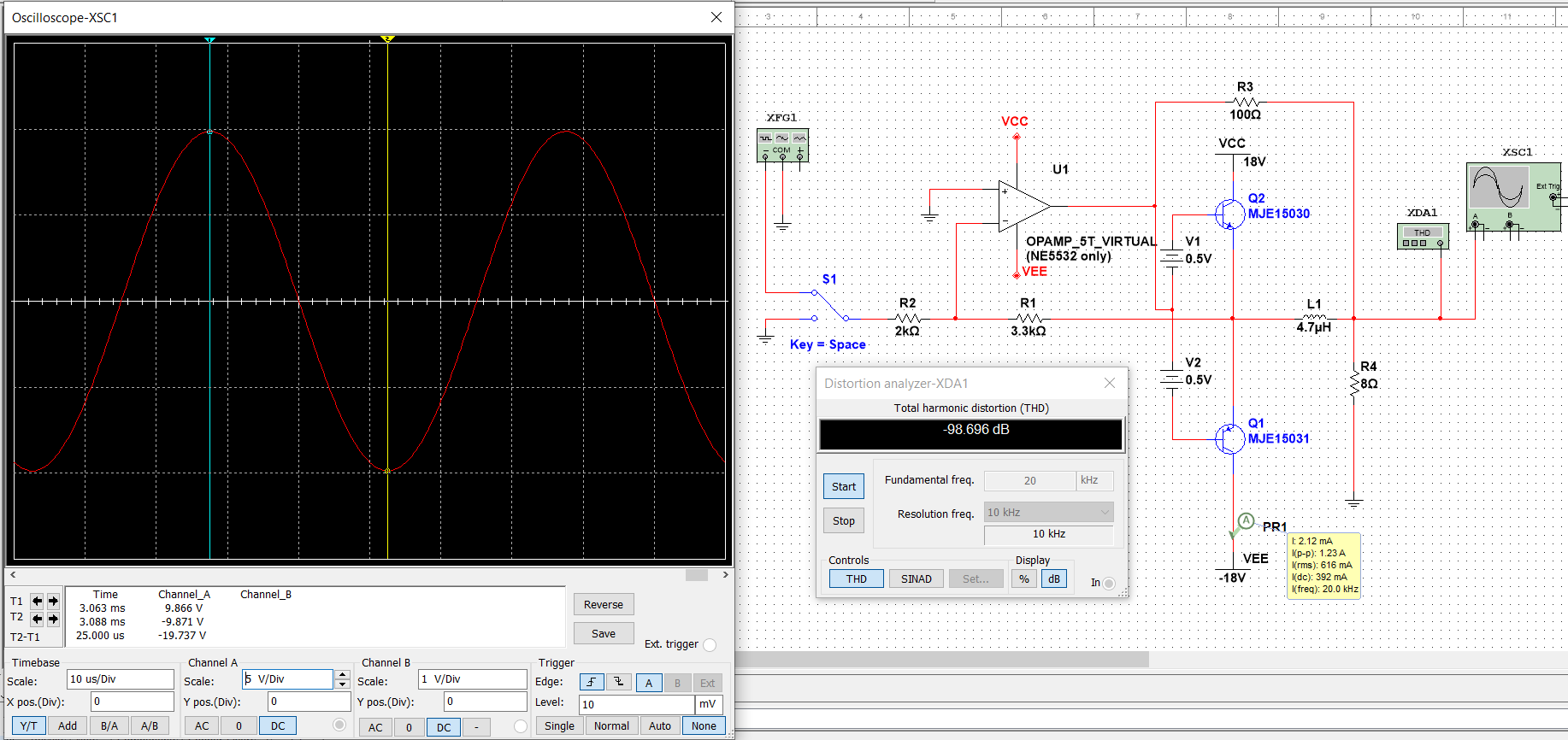

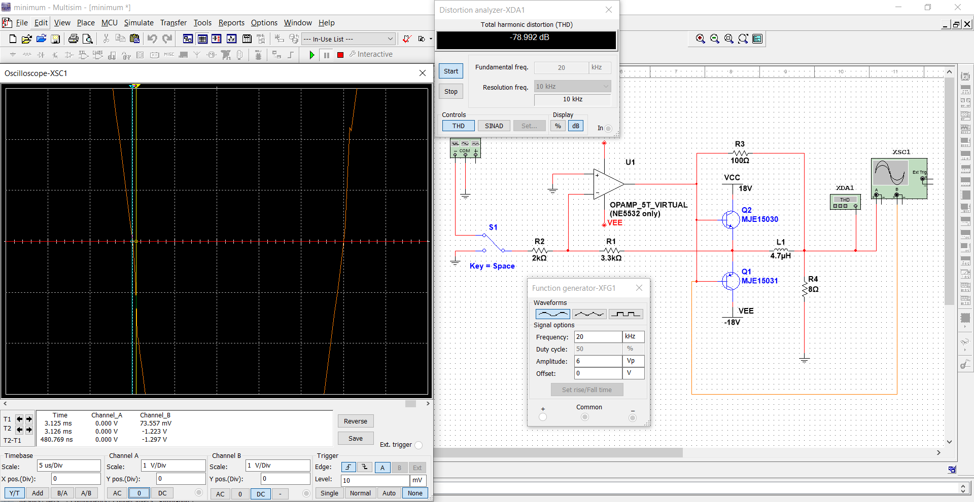

#59, is with 6Vp input, 10Vp output. I run simulation with the same signal so that you can have thd comparison.
16ma bias, without feedforward resistor. Not bad.
With the feedforward resistor. We have to admit it does something.

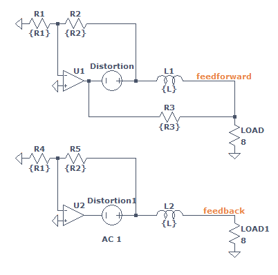

The big promise of feedforward error correction is a complete cancellation of any distortion introduced by the output stage, while feedback only reduces it by the amount of loop gain, never eliminating it fully.
It is fairly simple to model that big promise in SPICE. Below, the two amplifiers are identical. The opamps are ideal single pole (AOL=100k, GBW=10Meg, zero output impedance), the inductors have DC resistance, everything else is visible on the schematic:. (Values can be calculated e.g. from @MarcelvdG 's formulae above). The only difference between the two amps is that the upper one includes one additional resistor, R3:
That one resistor fully eliminates any distortion introduced by the output stage from the amplifier's output:
However, making this kind of cancellation happen, or even approaching it, in real life is much harder if possible at all.

Here is some investigation about the current that required to drive the feedforward resistor.
Assuming the feedforward resistor is 100 Ohm, the inductor is 4.7 uH.
4.7 uH is about 0.6 Ohm impedance at 20KHz. That means the 100 Ohm feedforward resistor has to provide 0.59/100 = 0.59% of the total AC current. For 8 Ohm load driven to 16Vp, you need 2A peak. 0.59% of 2A is 12ma. There is also 0.7v DC offset on the resistor. Thus total is about 19mA passing through the resistor.
If the dumper is just a single pair of transistors with beta 100. The opamp has to provide 2A/100 = 20ma for the dumper. Thus the total current required is 19ma + 20ma = 39ma.
NE5532 is internally limited to 38ma max. Thus, with 1EF dumper, it barely can drive 8 Ohm speaker to 16Vp.
One of the enhancement is to use CFP as the dumper that I posted in #16, so that you ignore the current feeding to the dumper. In this case, you can actually have the capability to drive 4 Ohm load. 16Vp with 4 Ohm, would be 4A peak, 0.59% of 4A is 24ma. Plus 7ma DC offest, 31ma in total.

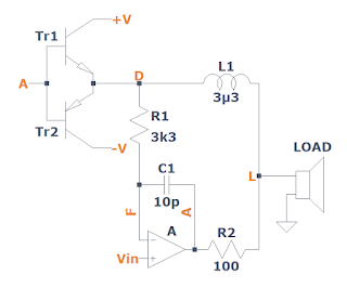

Regardless of what people say, full cancellation is possible in principle, even though it is hard to get in practice. If you rearrange the schematic like this:
it becomes clear that in a current dumping amplifier, any residual distortion appearing (after applying negative feedback) at the output of the current dumper Tr1 Tr2 (point D in the schematic above) is fed to the load via two parallel branches: (1) via L1; and (2) via the integrator A R1 C1, followed by R2.
If these two branches feed the load with the distortion of equal amplitude and opposite in phase, the load will see zero distortion.
Intuitively, since L1's impedance increases with frequency at 20dB/decade, the distortion it feeds to the load falls with frequency at the same rate and lags in phase by 90°. The same distortion coming via the integrator also falls with frequency at 20dB/decade, has a 90° phase lag, and is inverted. Since the levels are proportional and phases are opposite, with the right choice of R2, the residual distortion from the current dumper can be nulled.
The circuit is particularly easy to analyze if the gain of A is assumed to be infinite. In this case, the inverting input of A (labeled F) sees zero distortion due to the feedback via C1. If the distortion is nulled perfectly, the load (labeled L) also sees zero distortion. The distortion current via L1 then is equal to that via R2, and the distortion current via R1 is equal to that via C1. A little algebra quickly shows that this happens when the DC resistance of L1 is zero, and its inductance is L1=R1×R2×C1. In the language of Walker's AES paper, "For the linearity of Tr1 and Tr2 to be immaterial then L must equal RRC".
A non-zero DC resistance of L1 limits the current through the upper branch at low frequencies. A finite DC gain of A has a similar effect on the bottom branch. You can, in principle, match the two effects and achieve full cancellation with non-ideal inductor and integrator. That's what @MarcelvdG is talking about, and what my simulation in the post above shows.
If A is a usual single-pole compensated opamp, you may get away without R1 and C1, as the opamp already behaves more or less like an integrator. That's what @jxdking is simulating.
