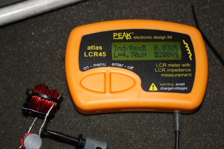

Not the prettiest coil but spot on.

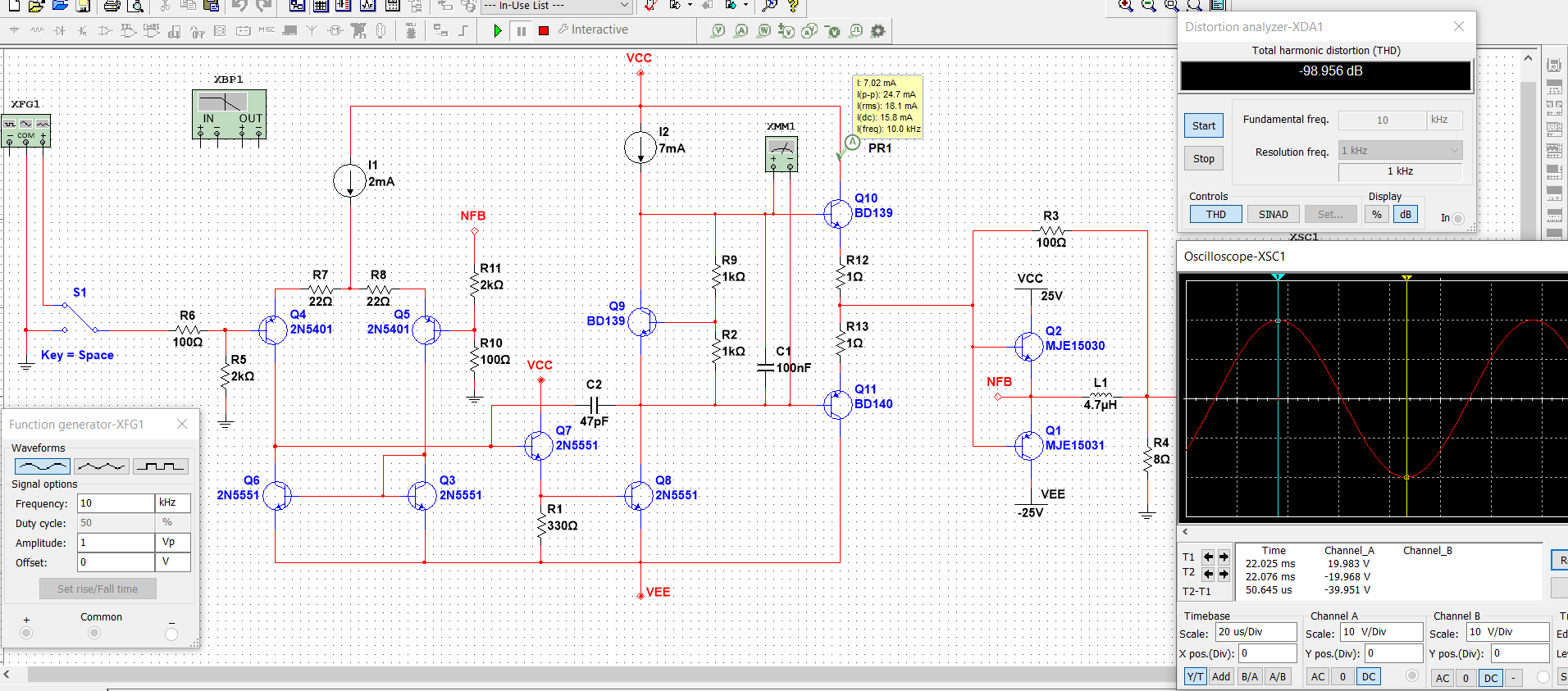

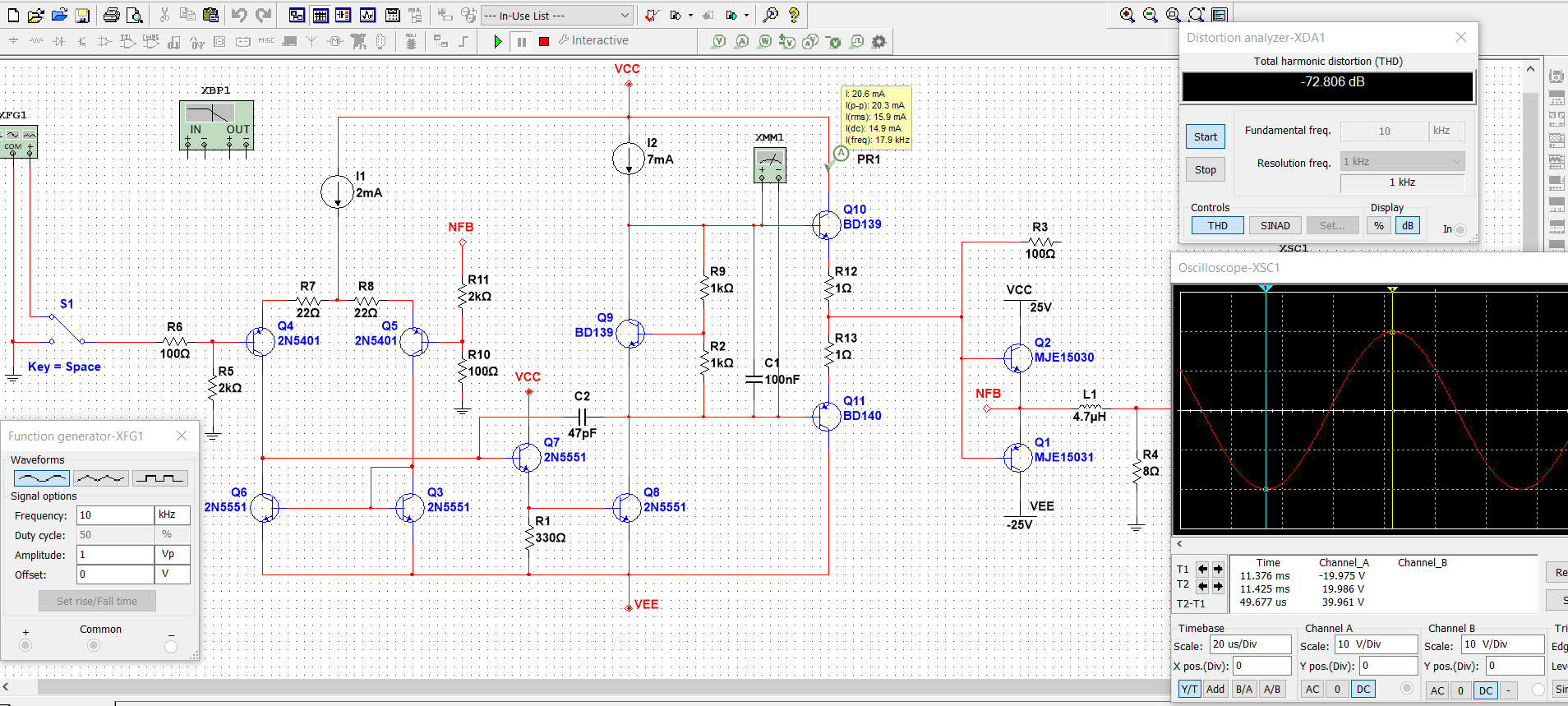

The schematic in post 18 doesnt work, or rather any distorsion reduction doesnt come from the alleged
current dumping but from the huge GNFB provided by the 5532 wich is set at very low CLG, that s roughly
80dB NFB at 1kHz enclosing the OS, hence the +-0.6V OS threshold will produce no more than 60uV
switching distorsion by the virtue of those 80dB GNFB.
The 100R "current dumping" resistance only influence here is to force the NE5532 to output +-6mA
to reach the OS input threshold, beside any current dumping circuitry is supposed to make the work within
this +-0.6V dead zone, and this require 0.6/8 = 75mA pk wich the 5532 is perfectly unable to supply,
let alone with a 4R load and a 150mA pk requirement.

If you say so, so be it, i stand my case that in this schematic the only thing that is at work to correct the OS
non linearity is the 5532 providing 80dB GFNB, this amount is a fact and the 100R resistance change nothing.
Edit : As you reduce the 5532 gain from 20dB to 6dB the crossover distorsion is reduced accordingly by 14dB,
thing is that i did some sims before stating so, while you are just talking out of random estimations.

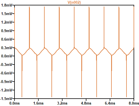

The model is for the Quad 909 OPS, which runs open loop here. Although the model includes the above mentioned resistor, it cannot show any distortion cancellation - you need to close the feedback loop and carefully balance the resistor and the inductor's series resistance for that.
The circuit with opamp is very simple to build
Yes - but the distortion doesn't change appreciably, whether you connect the feed-forward resistor or not. I did not build it, or course, just simulated with your values:
Yes - but the distortion doesn't change appreciably, whether you connect the feed-forward resistor or not. I did not build it, or course, just simulated with your values.

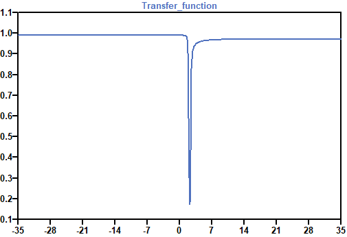

In theory, it won't. (Trust me, I know how it should work). But for that to happen, that distortion must show up at the opamp input:
The amplitude and the bandwidth of the distortion signal far exceed those of the signal being amplified, and it doesn't help the opamp's linearity. A full cancellation of the crossover distortion is tricky to achieve, but before you get there, the linearity of the opamp becomes a problem - in particular, the linearity of its input stage. Because of that, current dumping works much better wrapped in another, outer feedback loop. It also helps to have a more linear output stage than a "current dumper".

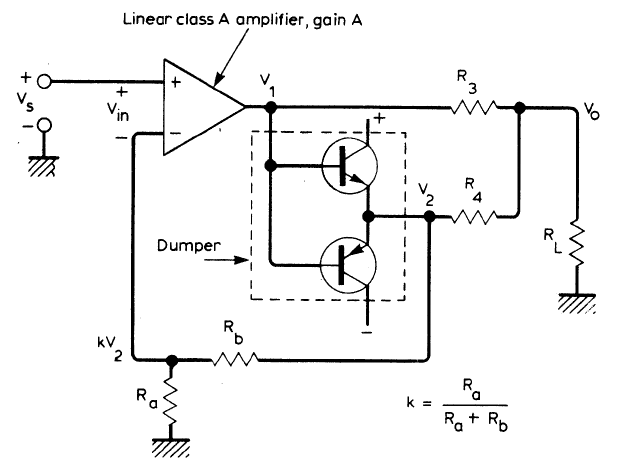

Here is a good paper about current dumping. It explains current dumping without visualize the "Bridge". I like this approach, because in this approach, there is no need to add the capacitor to complete the bridge. For most opamps, you don't have the access to the internal Cdom. Please check the file attached to read the full paper.
Here is the most important part in the paper.
The balance condition "6" mentioned in the the paper attached.
Note, the k is the feedback ratio: k = Ra / (Rb + Ra)
"A" is the finite voltage gain of the amplifier.
For a single-pole-compensated opamp, the voltage gain rolls off proportionally with the frequency. Fortunately, the "Gain Bandwidth Product" stays same(**See note). You can find Gain Bandwidth Product (GBP) from the datasheet.
Thus:
A = (GBP) / freq
Then the condition "6" above becomes.
R3 / R4 = k * (GBP) / freq
R4 is an inductor. R4 = 2 * pi * freq * L
Then you can caculate R3:
R3 = k * (GBP) / freq * 2 * pi * freq * L
The "freq" is cancelled out. Thus the condition can be balanced regardless the frequency.
R3 = 2 * pi * k * (GBP) * L
By given L, you can calculate R3. Conventionally, the output inductor ranges from 1uH to 5uH. To maximize R3 (to minimize the current), I'll pick 4.7uH for the inductor.
