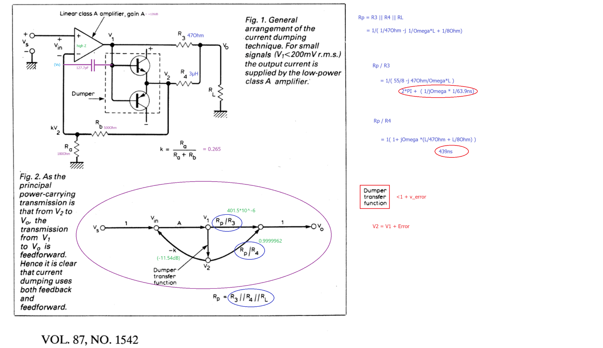

As to whether the technique works or not, the correct test of this is to drive the load with the unbiased output transistors and no FFWD resistor. The distortion will be spectacularly high. Insert the FFWD resistor and it will drop to 0.01% or better - a very respectable figure for a mid 1970s amplifier!
I also agree with you here, with one decisive exception: If there were two independent circuit parts, i.e. two amplifiers that were also fully functional as standalone units, then this (simple and very quick) test would be appropriate.
With the Quad 405, however, this is not possible because the 47 Ohm resistor is not simply a feedforward branch, but an integral part of the last stage of the VAS. I had hoped to have worked this out in my long monologues. Obviously, I failed on this (all-explaining) point.
I'll try to put it in simple, clear terms:
With the 47Ohm resistor pulled out, one permanently change the last stage, “the class A amplifier” (portion), it no longer works as it should, its output resistance is no longer relatively low impedance, but high impedance, its idle current setting is also destroyed, its idle gain "Leerlaufverstärkung" drops ..!
At the very beginning of this discussion thread, jxdking already indirectly described this stage correctly, but in my opinion not concisely enough due to the perspective taken.
The idea of testing the quad in this way and thus proving the superior power of the CD is absurd, because this procedure is comparable to chopping off one leg of a sprinter's two legs in order to now feel confirmed that the sprinter with two legs simply runs the 100m faster ..!

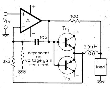

The problem with current dumping is that the linear amplifier has to slew extremely quickly to traverse the crossover notch in the class B amplifier. The less feedforward is applied, the faster the slew rate needs to be. This is an inherent flaw.
Ed
Sorry, with a 100 ohm feedforward resistor and a 4 ohm load, the class A amplifier needs to slew 25 times faster than normal while the signal is in the class B amplifier's crossover notch. That is too much to ask.
Ed
