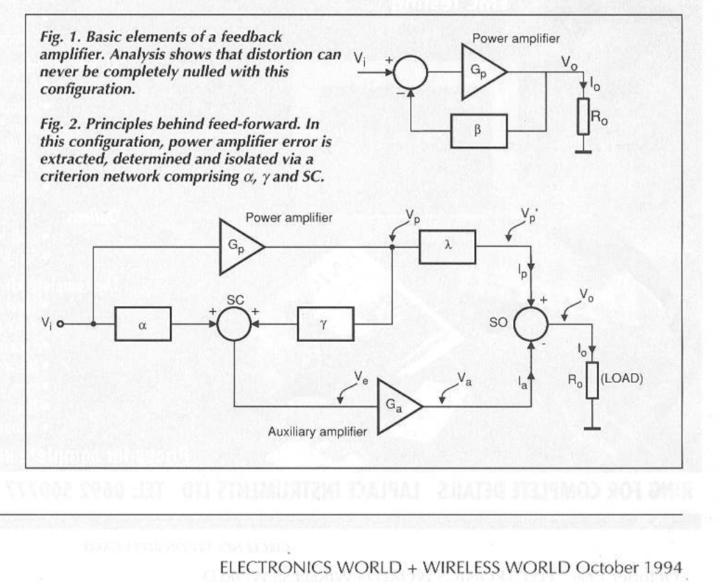

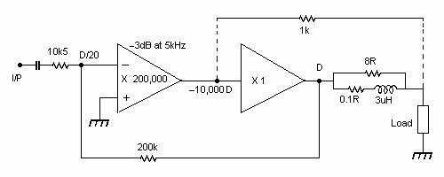

I always liked Mr. Renardson's explanation of the feedforward technique, in his MJR9 amplifier:

The vectorial addition of the string currents at the summation point (| Iload |) should result in the I_Load * Z_Load being spectrally pure, i.e. cleaned of all errors.
I hereby ask you to publicly describe this process in detail.

Reading through some of the linked to papers and posts, it seems CD had a lot of detractors over the years and ultimately, the system loop gain would be the limiting factor on just how close to a 'piece of wire with gain' (Walker's famous aphorism) could be achieved with the technique.
But, the most important contribution of Walker's design was that all the fiddling around with setting the OPS bias and DC offsets could be dispensed with at a stroke, and distortion reduced to below audibility threshold levels. This allowed Quad to churn out amplifiers in production that required no adjustment and/or trimming. They just worked well straight off the production line and continued to do so over the life of the product.
As they say, 'Perfect is the enemy of the good' and the Quad 405 got the balance just right.

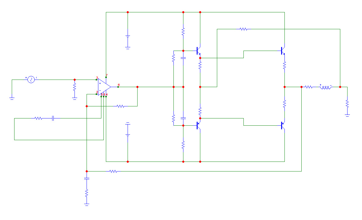

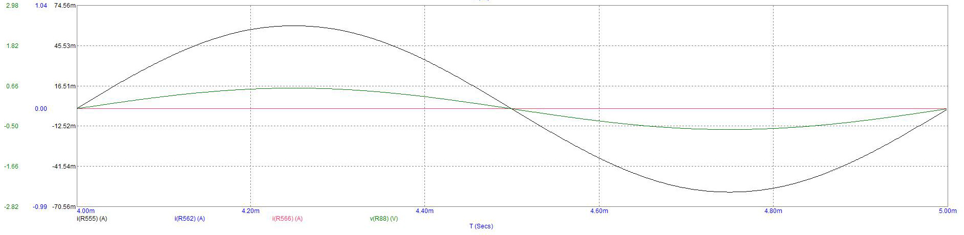

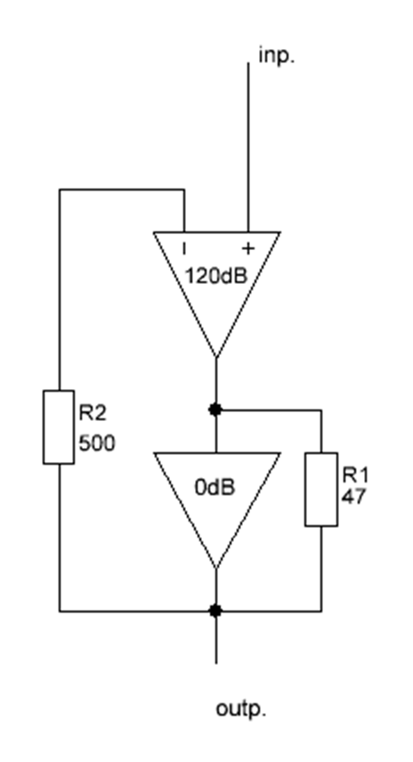

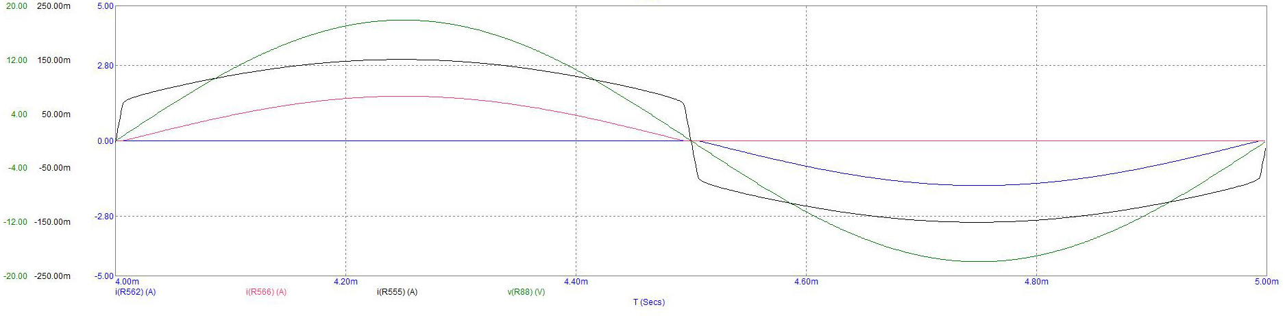

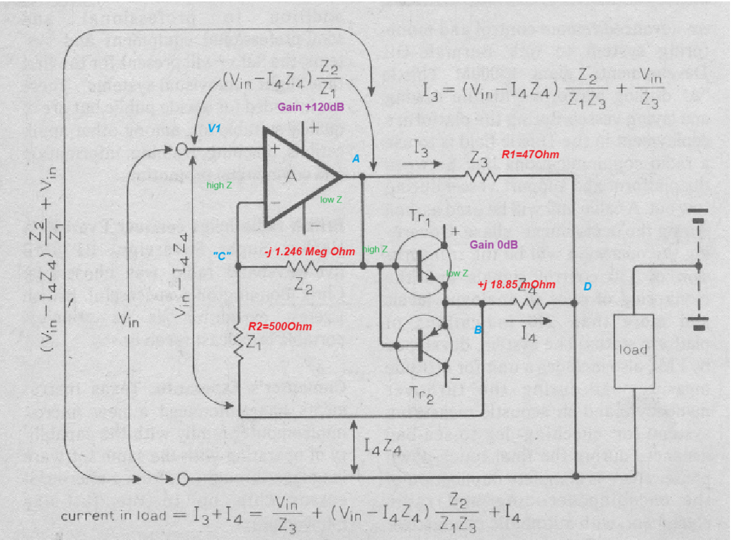

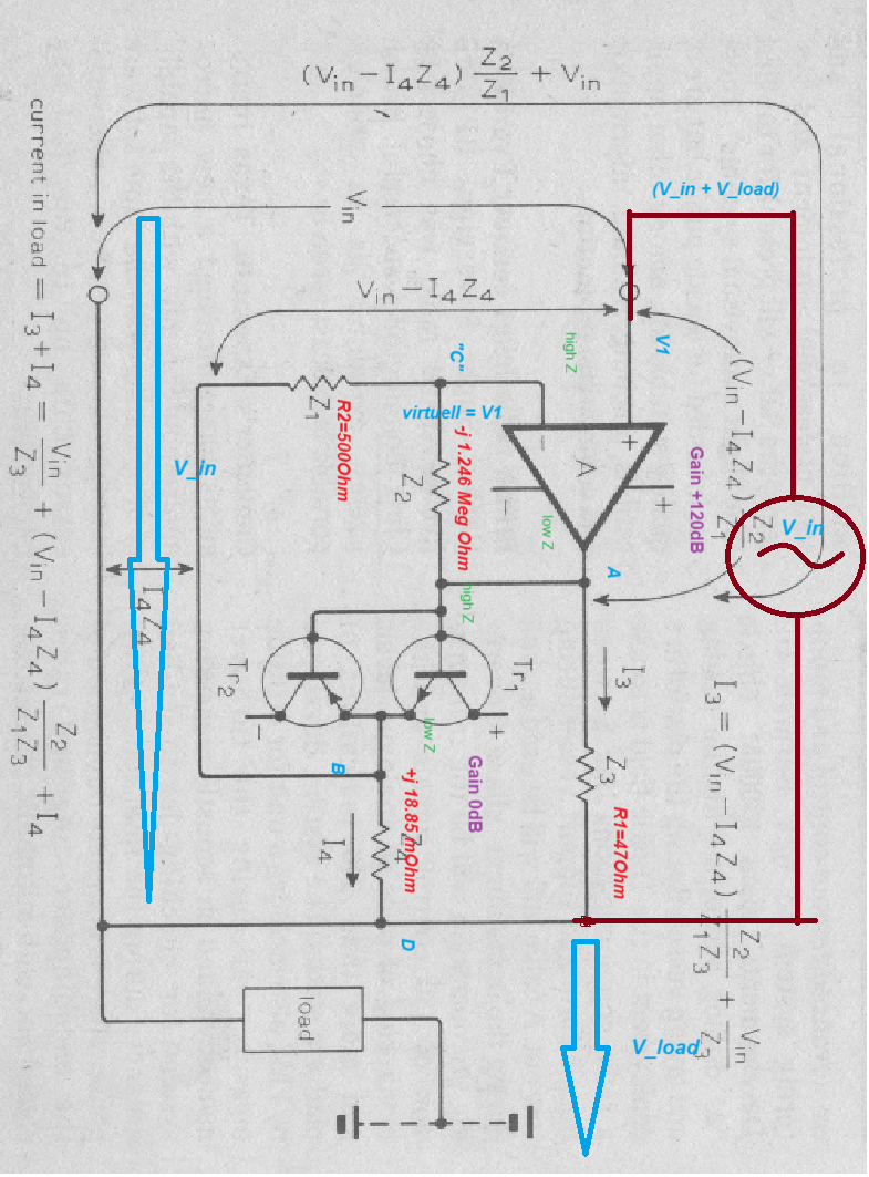

After staring at the schematic for 1 minute, this is my understanding:
Reduced to the most basic principle, bridge aside:
Starting from very small output levels, the classA amp works alone via the resistor, as the unbiased output transistors are there only for decoration.
When the output level increases and said transistors start conducting, they alternatingly take over most of the part of the current, due to the low impedance connection to the load, controlled by the classA amp.
Still, from there on the classA amp continues to deliver a constant "last maximum" current because of the Vbe drop of the output stage.
In other words, until the classB stage starts conducting, the classA current increases to a maximum of Vbe_classB / R_classA_out and remains constant from there on.
Documented in post #373
