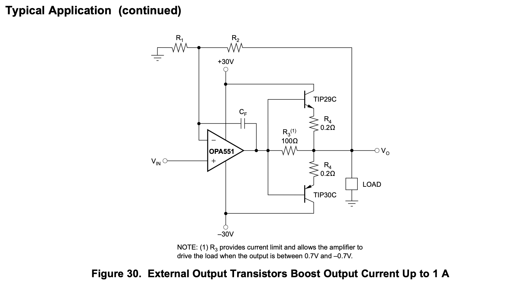

Current Dumping with OPAMP

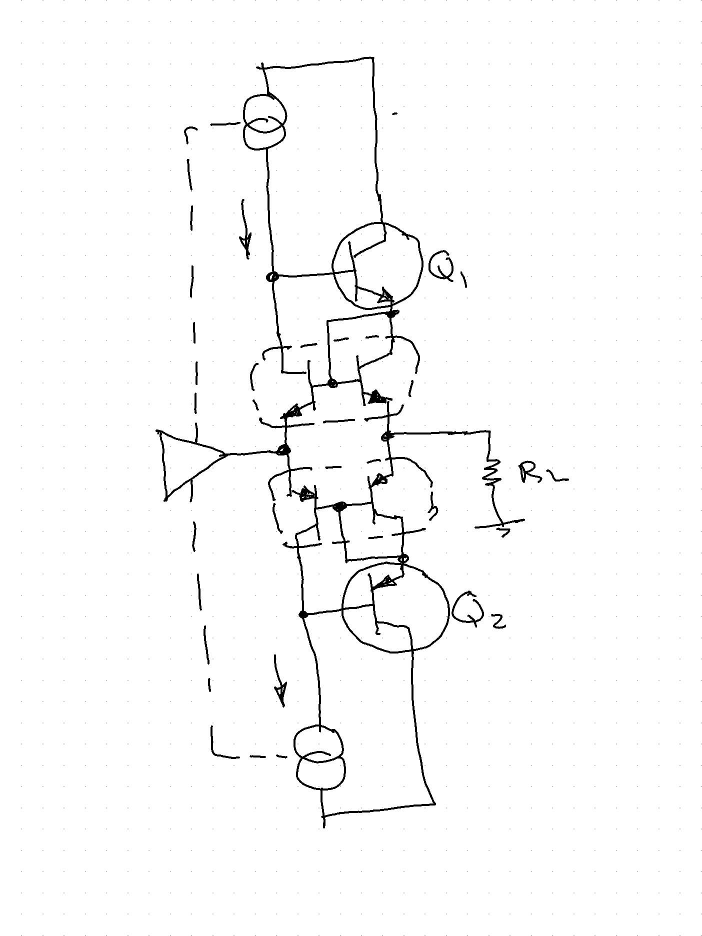

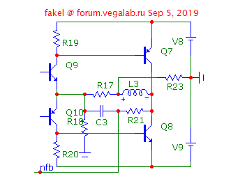

Yay. An interesting take on that idea was published by @fakel on the (Russian-speaking) forum.vegalab.ru:
The main difference is that output voltage errors below left feed directly to the emitters of the current mirror. This forms a high current "CFA" form of output buffer loop. An alternative shown on the right doesn't have the additional class B network. This network was built as part of a multiple feedback loop network that is not shown here, including feedback from the op-amp output back to its input.
Although there are a myriad of variants network that can be configured around the floating current mirrors made up of Q3 through Q6, these provide thermal tracking in preventing thermal runaway, that at the same time eliminates the need for emitter degeneration resistors. High current fluctuations on the output side feeding the load limits the turn off of the opposing transistors, in that the increase in turning on of either device is logarithmic in absence of series degeneration resistances. This speeds up response and minimizes the degradation caused by complete turn off of either device and the miller feedback capacitances by the minimization of voltage variation between the emitter pairs and consequently collectors.
In a network that uses non-darlington bipolars as Q1 and Q2 the current mirrors must be capable of full load current and also have sufficient quiescent current to provide the base current variance for full output current. For fun this network was built on a breadboard using a +/- 15 volt supply using some 2SB649's and 2SD669's for the mirrors, being bolted together with A1943/C5200 transistors for Q1/Q2.

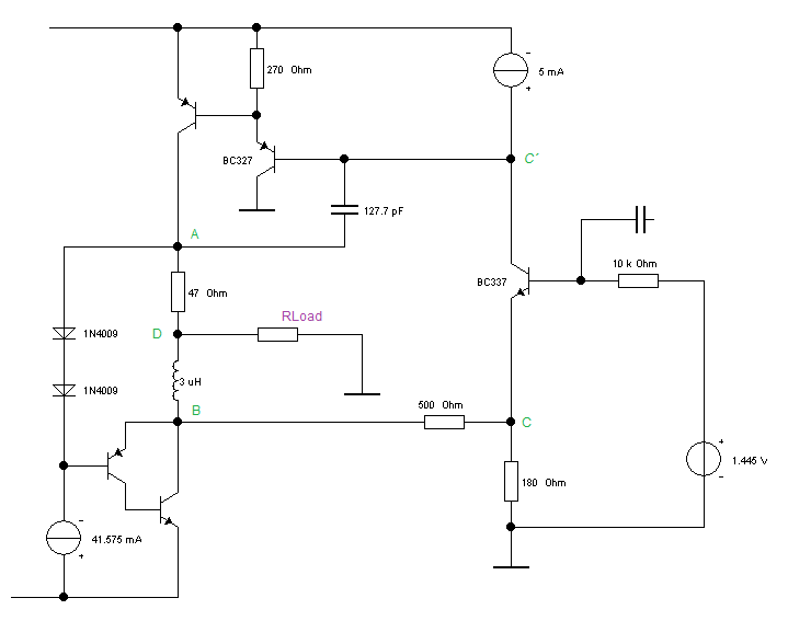

tpc
The thesis is:
The frequency-dependent inner loop (a voltage-current feedback) is now completely enclosed globally at node C, the emitter of the first stage, with the R2=500Ohm current-voltage feedback, and the final bandwidth of this amplifier is thus determined independently of the resulting CLG.
RN=180Ohm at the current summation node C now determines the final voltage gain without further consideration of the internal signal-source resistance at the base electrode of the input transistor TR2 (negative feedback also takes place at this point or node, which is usually neglected). The dynamic description of the second (composit) stage is elementary, but the only important thing for the thesis is the bootstrap effect present here, which is responsible for the fact that node B follows node A ---> therefore these two points are virtually identical and the OPS (the complete composit) is thus a member of the Miller loop. At the same time, the inductance L=3µH is now dynamically parallel to R1=47Ohm. Theoretically, this consideration now also determines the impedance of node D of maximum 0.38Ohm at 20kHz.
Since we consider the present amplifier as a whole and set up a complete equivalent network, it must be noted that the node impedances (we look into the node of the small signal model from all sides) C and C' are not identical, nor should R1 simply be regarded as a so-called feedforward resistor, because it is elementary for the function of inner bootstrap at the second stage - a little bit SRPP like, at the same time is also the complete composit, with included dumper-outputstage, a follower, a bootstrap.

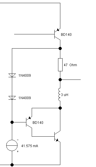

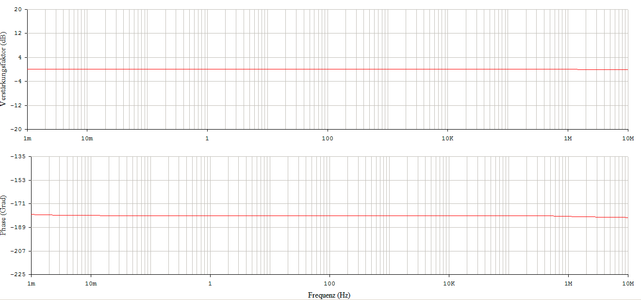

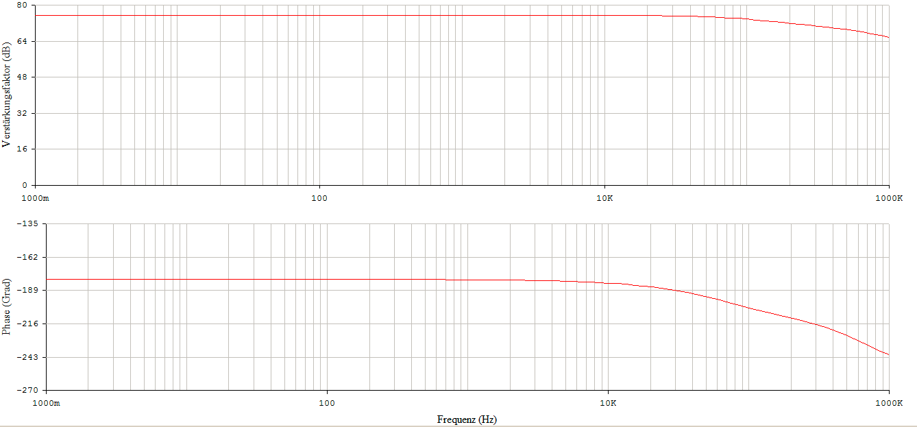

Quad 405
Gain -----> 75.5dB
r_out -----> 53Ohm
One should really (and this can only be emphasized urgently) consider TR8 & TR10 as a whole, as a replacement Darlington, because that's all it is. Output node D is relatively low impedance! And all this (still) without any global current-controlled voltage feedback.
HBt.audio
Node B
Gain -----> 75.5dB
r_out -----> 52.5 Ohm
The replacement Darlington (TR8&TR10) is always in play - and the entire construction is called SRPP in RF, RF tube technology. To consider the 47Ohm resistor as FFWR in a magic bridge structure is absolutely not helpful, even if one could diplomatically say that everything could depend on the place of observation, the substitute perspective. One could take it really far, from eyewash to self-deception.

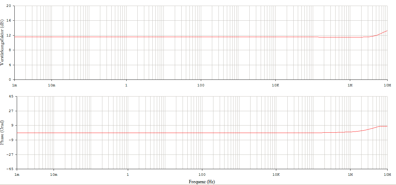

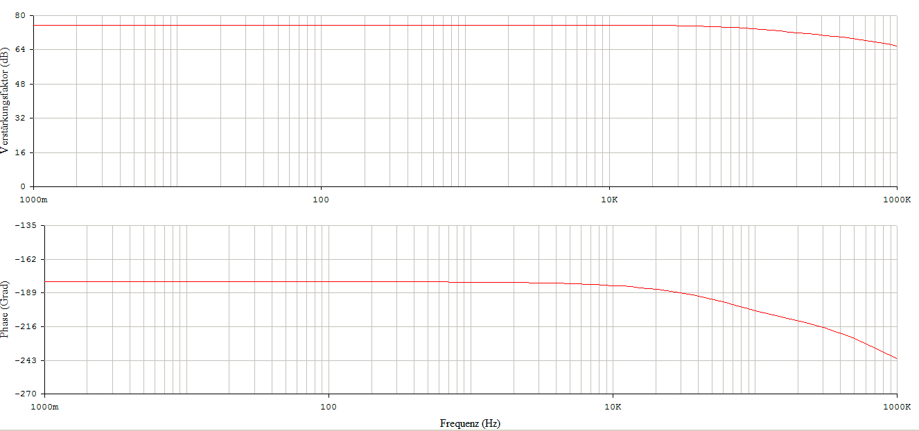

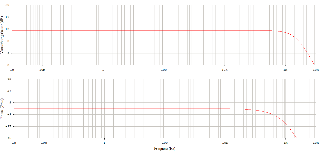

Now the Quad 405 replacement model is two-stage and globally current-controlled voltage-feedback coupled.
R2=500Ohm
Gain is now 11.54dB
r_out at
  • Node D is 10m5 Ohm
  • Node B is also 10m5 Ohm
  • Node A is 131m5 Ohm
all data without C=127p7 and TR9 (the dumper).
A sacred cow slaughtered
QUAD 405
with C=127p7 F - and dumb Dumper TR9 always off!
The internal resistances of the nodes under consideration are of course unchanged ... I will be happy to add 'C' later.
A mysterious bridge does not exist, nor does an FFWR. The 47Ohm resistor is an integral part of the second stage, the entire composite.
HBt.audio
As the TR9 dumper does not switch on abruptly, but intervenes gently in the action, it can be completely ignored in the slightly simplified representation of the situation.
  • The 100% current imprint of the "ring" leads to the conclusion that C' is the same as C, but they are not the same, but their node impedance is dynamically the same
  • The phase rotation between these points must be |180°|, otherwise it would not be possible to globally counter-couple the ring at node C at this point
  • For the non-existent AC bridge, this point (the different phase shifts, angles of the vectors) could be the decisive sticking point of the CD principle!

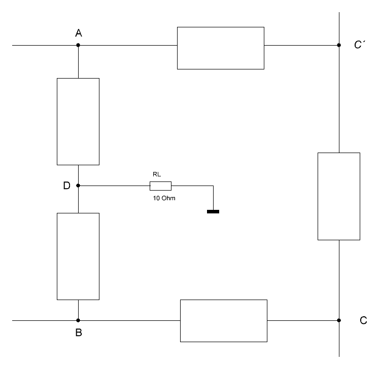

The Ring - "eine Masche"
Now that we have finally mentioned and identified the ring, the secret of the ring master can be revealed.
To do this, we need to know what the nodes are and what is between them in the boxes. Later, we walk along the ring, once clockwise and once counterclockwise, and set up a simple mesh equation for each.
The simulation showed that the node impedances of nodes C and C' are low impedance (I hadn't revealed this yet), it also showed that u(t)C'C / u_inp(t) = 1 and that there is a phase difference between the nodes in terms of voltage. In plain language, this means that we can replace the corresponding box with an AC voltage source. This voltage source (ideally with an internal resistance of zero ohms between the terminals) is, or corresponds to our signal source, what we want to amplify!
tbc
We should keep in mind that B follows A virtually (through the inner bootstrap, which always remains unmentioned!), so we can dynamically claim that R1 & L are parallel to each other. P. Walker even writes this in the above-mentioned article, but the simplified principle circuit with operational amplifier and separate push-pull B output stage distracts from the actual facts. But Mr. Walker mentions this correct fact. While a completely different one is somewhat obscured, namely the descriptive perspective. If you look at the picture of the ring based on network theory, you can also see that C & R2 must inevitably lie parallel to each other dynamically.
