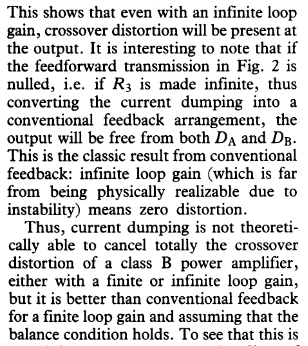

Here are two more papers on the subject:This was already posted here :
https://www.google.com/url?sa=t&sou...4QFnoECBUQAQ&usg=AOvVaw2TE1JT7j-rMcpW-_II9Atg
The second one is only partial:
Yes, Jan, I know all that - this term is clear.BTW A change of feedback factor is what you get when in a 'normal' amplifier where the feedback factor is determined by the ususal 2-resistor divider, you change one of the resistor values.
Just to have the term clear 😎
Jan
Nevertheless, it is good that you have worked out this simple connection. If I pull one of my old Leitz folders from the shelf and open it, I'll find a lot of rectangular framed boxes there. In these boxes I will probably make out a small "k" through the totally yellowed sheet of paper.
This is one of the many letters to the editor that I mentioned previously.The second one is only partial:
A manufacturer would welcome a circuit which does not need an employee tweaking a bias pot during production.
A manufacturer would prioritise this, over any theoretical promise of zero distortion, providing that performance was not compromised, of course.
They exist, they have low distortion, there is no pot to tweak.
TR9 should have been identified as TR#2.... after all it is a dumper...Of course, a change will come about when TR9 is fully operational.
Thanks for the paper, this is explanatory but this doesnt change things, notice that they get higher THD when increasingHere are two more papers on the subject:
https://www.google.com/url?sa=t&source=web&rct=j&opi=89978449&url=https://schematicsforfree.com/files/Audio/Circuits/Power%20Amplifiers/Theory/Current%20dumping%20-%20does%20it%20really%20work%20-%20Theory%20and%20Practice.pdf&ved=2ahUKEwj4z7v-sLaKAxV_TaQEHZyFBu4QFnoECBUQAQ&usg=AOvVaw2TE1JT7j-rMcpW-_II9Atg
the NFB over a given point, wich is not logical at all, how can this be explained.?.

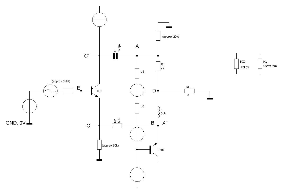

Let's give up. The second PDF, the one-page letter, contains a much bigger hammer. I stumbled across it immediately.

Since I have just lost all enthusiasm and Santa Claus is at the door, I will dispense with the final explanation, the transformations and conversions... the proof of the thesis has long been provided, all that is missing is the formulation of the thesis itself.
Oh, what the heck:
Dear reader,
simply consider the (virtual) node A' as roughly equal to node A, now node B is tied to node A because it corresponds to A'. The serious significance of this dynamic fact has blatant consequences and completely collapses the formulated CD thesis.
I'm so sorry, but if you pour the current point of consideration into an equivalent circuit diagram of control engineers or communications engineers, even the mathematical proof can be easily provided.
But now I have a headache. Where has Haudegen gone when you need this guy..?
Tschüß,
HBt.

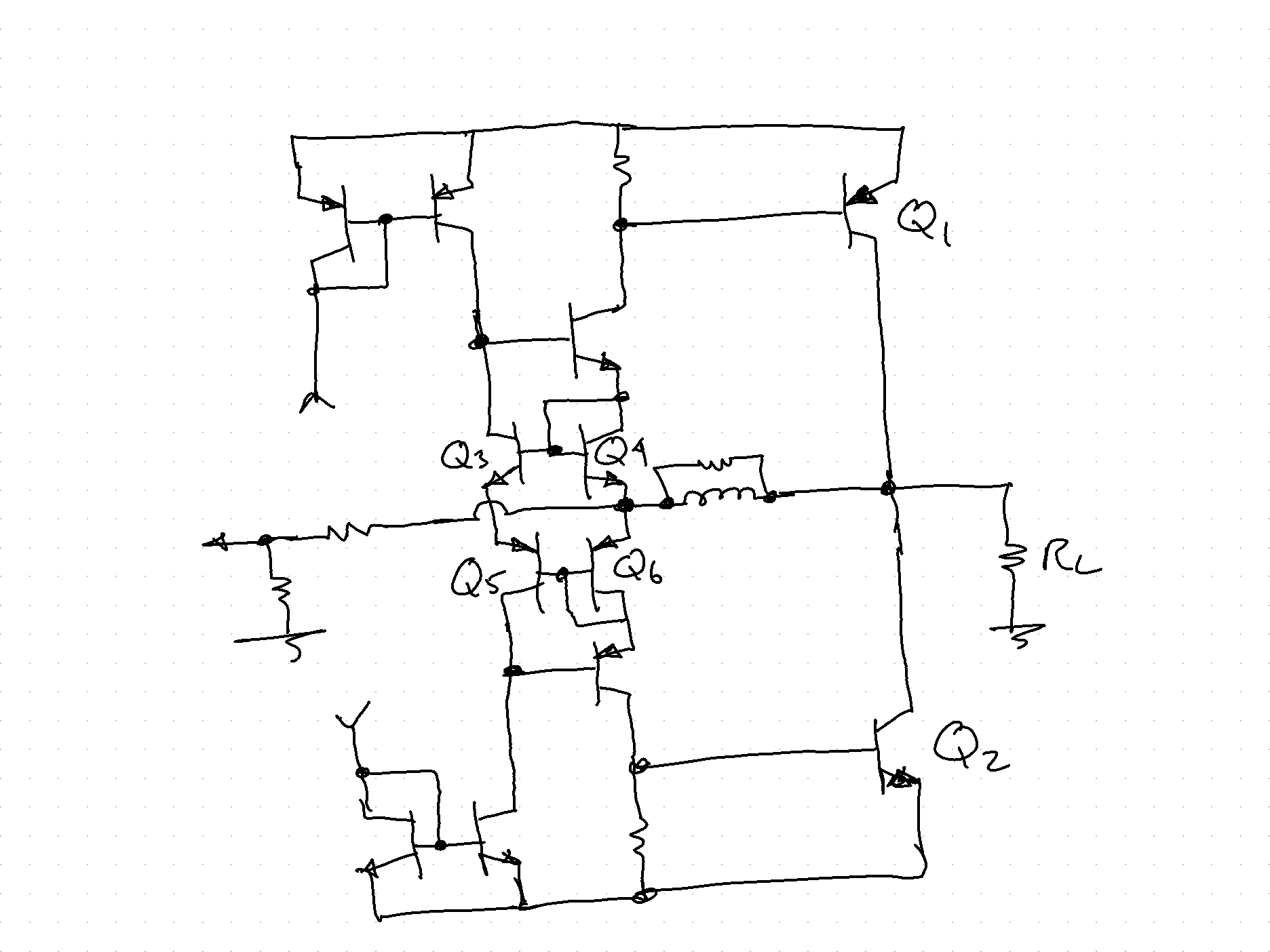

It is true that I don't care much personally to understand the 405 completely, oftentimes most things just enough to do my own thing. Perhaps you can provide some thoughts on the following HBt.
What is being referred to as current dumping with an op-amp can be loosely considered in a network built for personal use some time ago. The basic configuration is shown below. The transistors Q3/Q4/Q5/Q6 (with the other transistors on top and bottom) forms floating current mirror clusters. The output side forms a basic unity gain CFA type device whereupon the inductor and the R across it forms a low impedance path for DC as supporting stability. Because Q3/4/5/6 all operate at low voltage this makes thermal tracking fairly easy to control. Note that Q1 and Q2 doesn't show any biasing and could be replaced with darlingtons, Mosfets or some other devices.
I would have a headache too, if I was trying to analyse a circuit by using a different circuit, which was nothing like the circuit I was trying to analyse.But now I have a headache.
This statement is absolute nonsense.I would have a headache too, if I was trying to analyse a circuit by using a different circuit, which was nothing like the circuit I was trying to analyse.
Furthermore, there is no need to defend the English quad xxx.
also complete nonsense, and of course a quiescent current (will) flows through your Q1 and Q2.Note that Q1 and Q2 doesn't show any biasing and (...)
