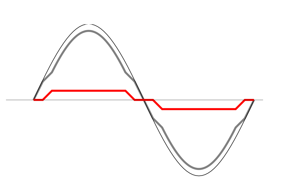

Thin gray is the ideal non-distorted signal, thick gray is Class D amp output, red is the (open loop) distortion due to the dead time. But we diverge.

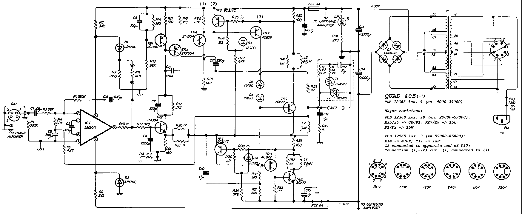

I understand the shift of the scene towards"digitale Modulationsverfahren" as a distraction from the core topic, namely the functional description of the progenitor Quad405.
So, what is current dumping?
"CD" is nothing more than a nickname for the different nature of the 405 compared to its competitors at the time. At the same time, Q9 is referred to as a dumper (an NPN transistor that only has to be switched on in the course of the time function to be amplified). This so-called dumper is an emitter follower that apparently works in operating class C.
TR9 = BDY77
is the main-DUMPER!
But, the real secret is hidden behind the SI diodes D5 & D6 (their differential resistance plays an important role in further understanding).
Q8 is also not uninteresting, perhaps more on this later - we want to distract (us) with the "Class D Amp" construction site.

The complexity of the full circuit diagram obscures the simplicity of the current-dumping principle of operation.
John Linsley Hood in his "The Art of Linear Electronics" provides a good explanation, and a comparison with Technics Class AA, and Sandman's Class S designs.

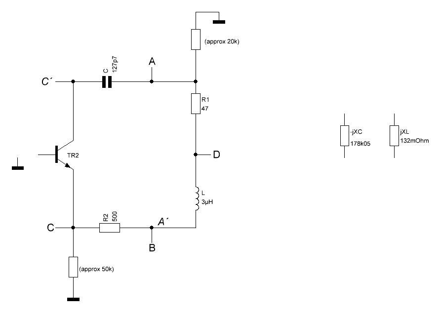

Preliminary information:
We make extensive use of transformations and also use the positive coupling called bootstrap in many different ways. There are C-CCS, but also V-CCS, etc.
But no bridge.

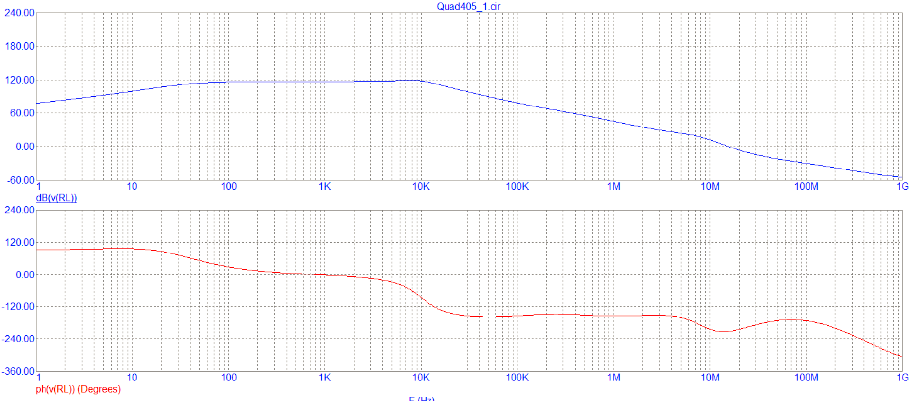

The crucial point is that the entire output stage is a virtual member of the so-called Miller loop /Ribbon. And via R2 (R(fb)), as I already expressed with my phrase (everything is in the loop), everything is in the gnfb.
The key is precisely this apparent connection or the equivalent, we call this "virtual". The proof is very easy to provide in the simulation, just by looking at (for example) the THD, as the difference to the physical (real) contact with the node D and /or B. Since the difference is insignificant, the proclaimed miracle principle CD (as a bridge) cannot be responsible for the good THD. So no feedforward-take away error correction.
