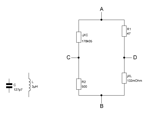

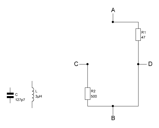

Simple sketches say more than 1000 words. For several reasons, we are initially only interested in the frequency range from 0Hz to 7kHz.

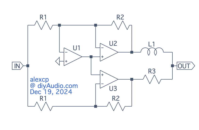

But hey, it's almost Christmas. Let me offer a variation on the theme:
It is a concept of a composite amplifier similar to what John D. Yewen published in the Feb 1987 issue of Electronics & Wireless World, with Walker's feedforward correction added. The reasoning is that if U2 is slow, you can get maybe 60dB of loop gain at 20kHz. That may not be enough for a fantastic sound if U2 is not super linear, so it makes sense to add U3 to provide feedforward correction and cancel U2's distortion. I have not tried it in hardware, but in simulation it works well with some reasonably realistic models (and some important extra details, omitted here for clarity).
Sorry, @hbtaudio, handwaving instead of a clear proof of that Miller feedback loop won't work 🙂
I was already expecting you to throw in --->but the so-called Miller loop works perfectly, especially in the Quad405. And that's what it's all about, this loop.
I'm looking forward to your Christmas present, namely the correct (and complete) automatic-control modeling of the Quad405.
With this model (you know the extensive drawings of a classical control engineer) we will then prove that the Quad405 does not derive any benefit from the theoretical thought experiment (of faith) CD.

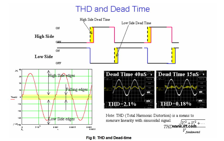

The principle is the same, notice that the compared dead times are 40 and 15ns, you can extract the progression
of the distorsion in function of the dead time, here that s a 2.5 exponent power, so 0.01% should require barely 5ns dead time.
