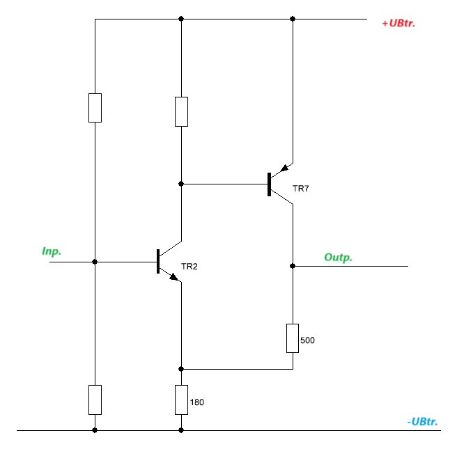

The preamp (IPS) in disguise (the op-amp) must therefore boost the input signal to 7.5Vp so that 100W can come out at the rear - the Quad405 and its successor is a two-stage cramp /fighter.

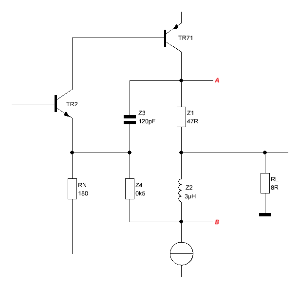

Which partial reinforcement division would make the most sense? 1 to 1 or 10 to 1 ...! What is the permitted tolerance of the elements Z1, Z2, Z3 and Z4?

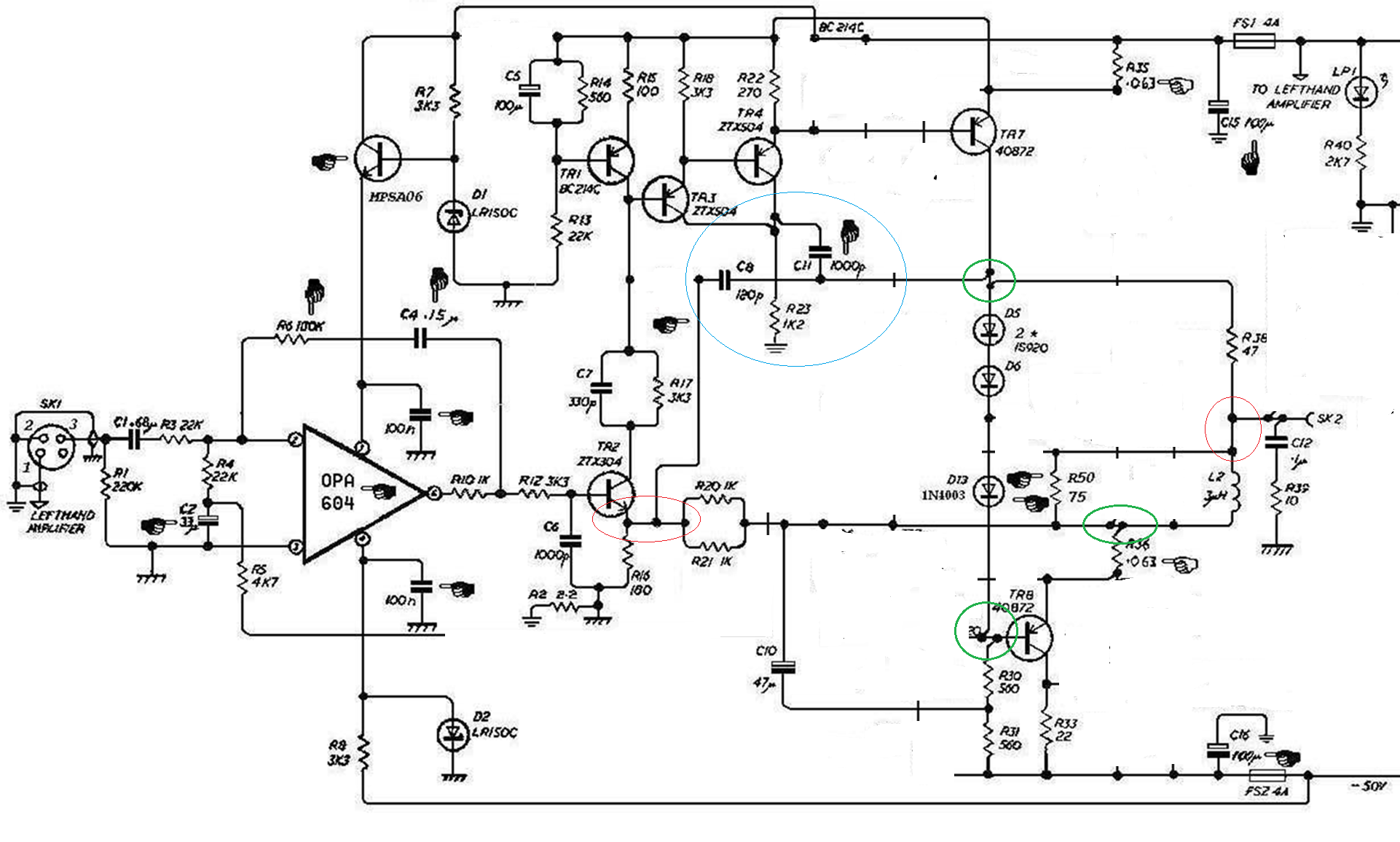

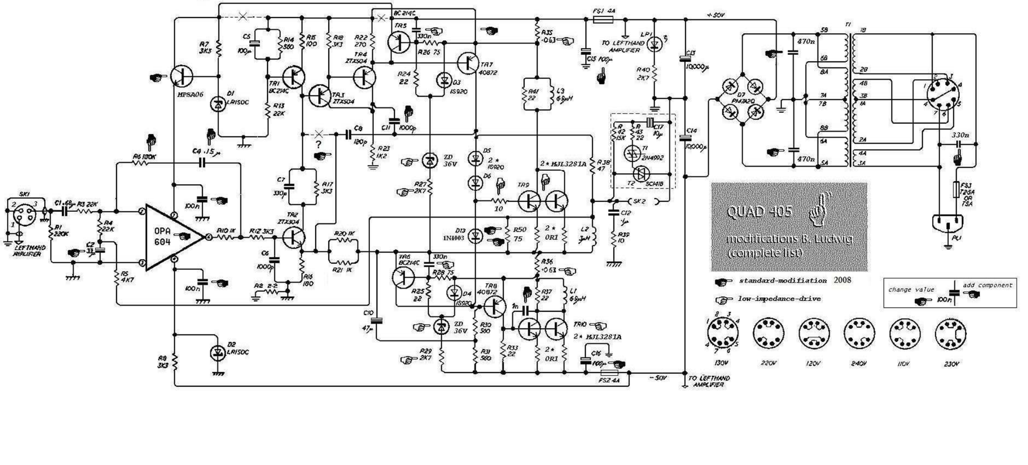

@wahab
I've been thinking about your last post for a few hours now and trying to follow your train of thought, but I'm finding it a bit difficult at the moment. I'm wavering between agreeing and disagreeing.
Perhaps we should concentrate on the “Ludwig circuit” for analysis.

I've got it 🙂
VAS only:
I have erased everything that could cloud or distract our view.
Let's just simulate the part (and time) when the push-pull output stage (the dumper), which is still forming, cannot be in play at all (or only in a rudimentary and very limited, distorting way).
It's a damn clever circuit after all.
HBt.
That's all about! Without the resulting frequency compensation scheme ..!
The only interesting point now is when and how does the dumper come into play ---> how does the dynamic output resistance of the entire circuit behave, how does the entire power amp react to naughty speaker impedances?

At the moment of zero crossing +/- a few millivolts, practically speaking, only the two-stage VAS (and the upstream OP amp, as well as the associated DC correction of the output) is working.
And
  • in this combined characteristic range, we can also consider the same ac potentials, nodes A and B, to be virtually connected to each other.
  • now the so-called feedforward resistor, namely Z1, is virtually in parallel with Z2 and in series with the load resistor demanding current, the loudspeaker.
I can still see neither a two-pole compensation nor a TMC.
As soon as the dumper, the connected push-pull output stage, comes into play, only then does the “take away error correction” get its chance to completely change the situation. But no one should now believe that this simplified description even comes close to a correct engineering picture.
HBt.

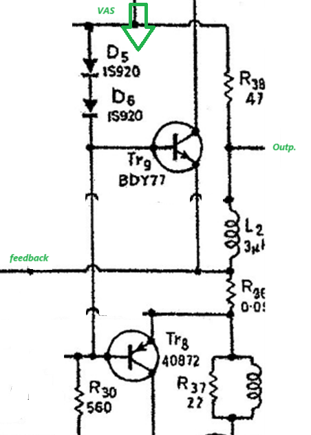

AC wise the 47R short the VAS output to the OS output, (...)
Without you probably having realized it, the two nodes to the right and left of the 47Ohm resistor (maybe this is your term "short") are of course virtually equal (within frequency-dependent limits) - but also not, because the phase-shifted error voltage lies between two relevant nodes of our many equivalent circuit representation options ..!
The Currentdumper number is no longer trivial as soon as we go into depth. But that's going way too far here in the forum, isn't it? Let's take a practical and simplified approach to the matter.

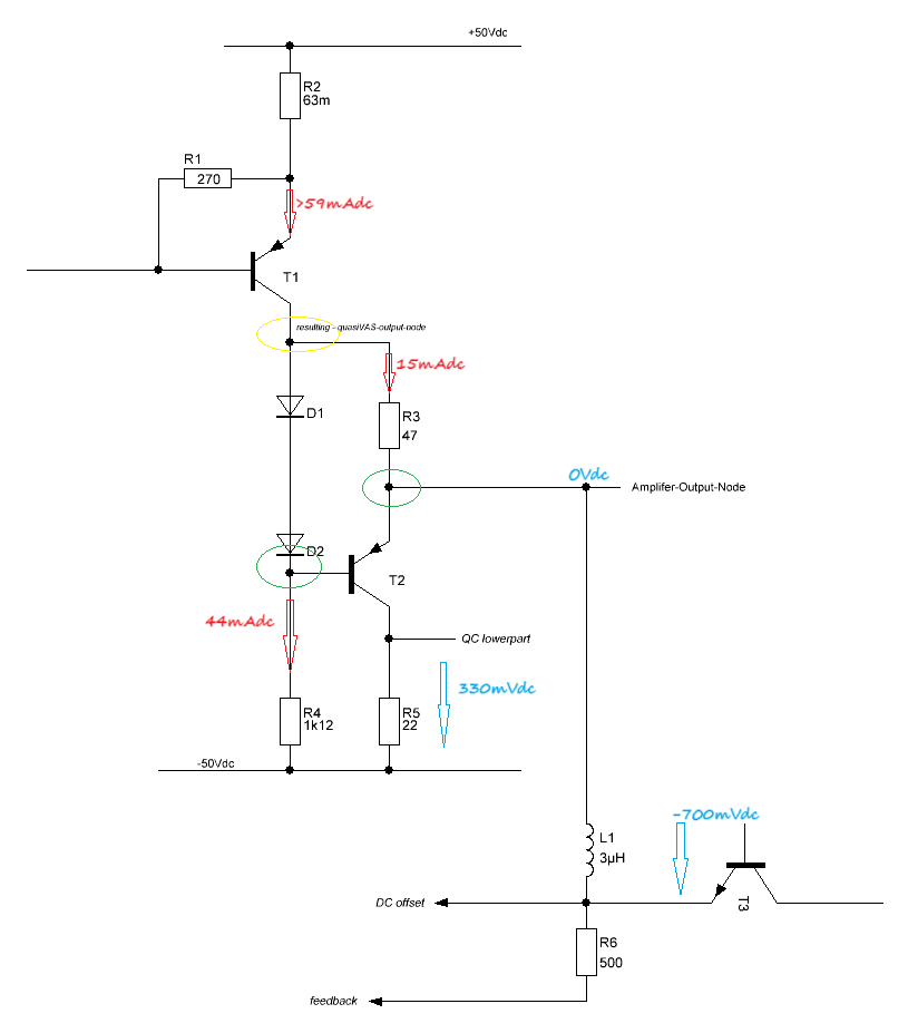

A first glance at the sketch below reveals the functions of the 47 Ohm feedforward resistor. Among other things, it ensures that an almost constant quiescent current flows through our lower play partner, which ensures a relatively constant bias voltage of 330mV (VBE of the NPN power transistor on the lower rail, not shown here). As a result of an ac current flowing through our load (sucking or squeezing in) ... - No, we don't have to go that far in our considerations, we can also simply modulate the base potential of the upper (final VAS PNP) BJT ac moderately. We move back and forth on the time function, the simplest is the sine. Let us consider the output node and bear in mind that it also follows the modulated base potential of the lower node (base electrode) in phase - it is an emitter follower and at the same time a dynamic current source for the upper VAS node. This results in a fairly large open-circuit amplification factor of this (now isolated) stage. At the same time, however, there is also an SRPP component, i.e. the output resistance is reduced compared to other variants - relatively (relatively) small. The 47 ohm resistor also has another task, namely that of a sensor function, as soon as the modulated potential, i.e. with our signal AC voltage, exceeds a defined point, the upper (an emitter follower) dumper slowly comes into play ..!
And only now does the number become interesting - all without any external load playing on the output node of the amplifier (namely pulling and pushing, pressing or sucking).
HBt.

DF is tied to the available NFB, if the OLG output Z is 1R and NFB at 1kHz is 100db then the CLG output Z
will be 10uR at 1kHz.
The path through the 47R will have 0.47mR output Z/1kHz, wich is much lower than the 20mR/1kHz through
the 3.3uH inductance.
So the inductance insulate the VAS + 47R output Z (= 0.47mR) from the OS lower output Z all while allowing the latter
to be enclosed in the miller loop since the inductance s 20mR is negligible compared to 47R when it comes to a NFB return path.

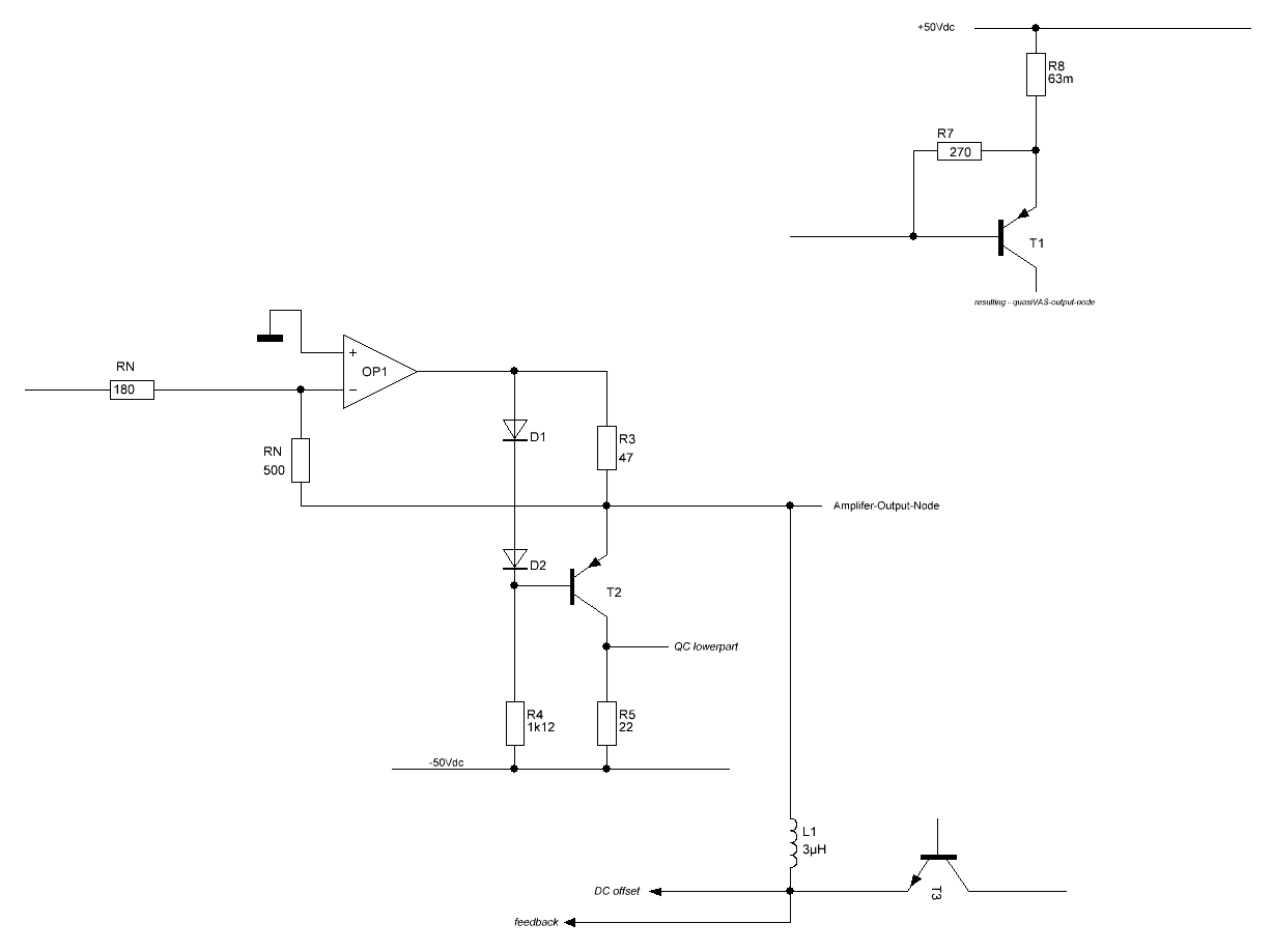

with OP-Amplifier as the name of the thread ...
