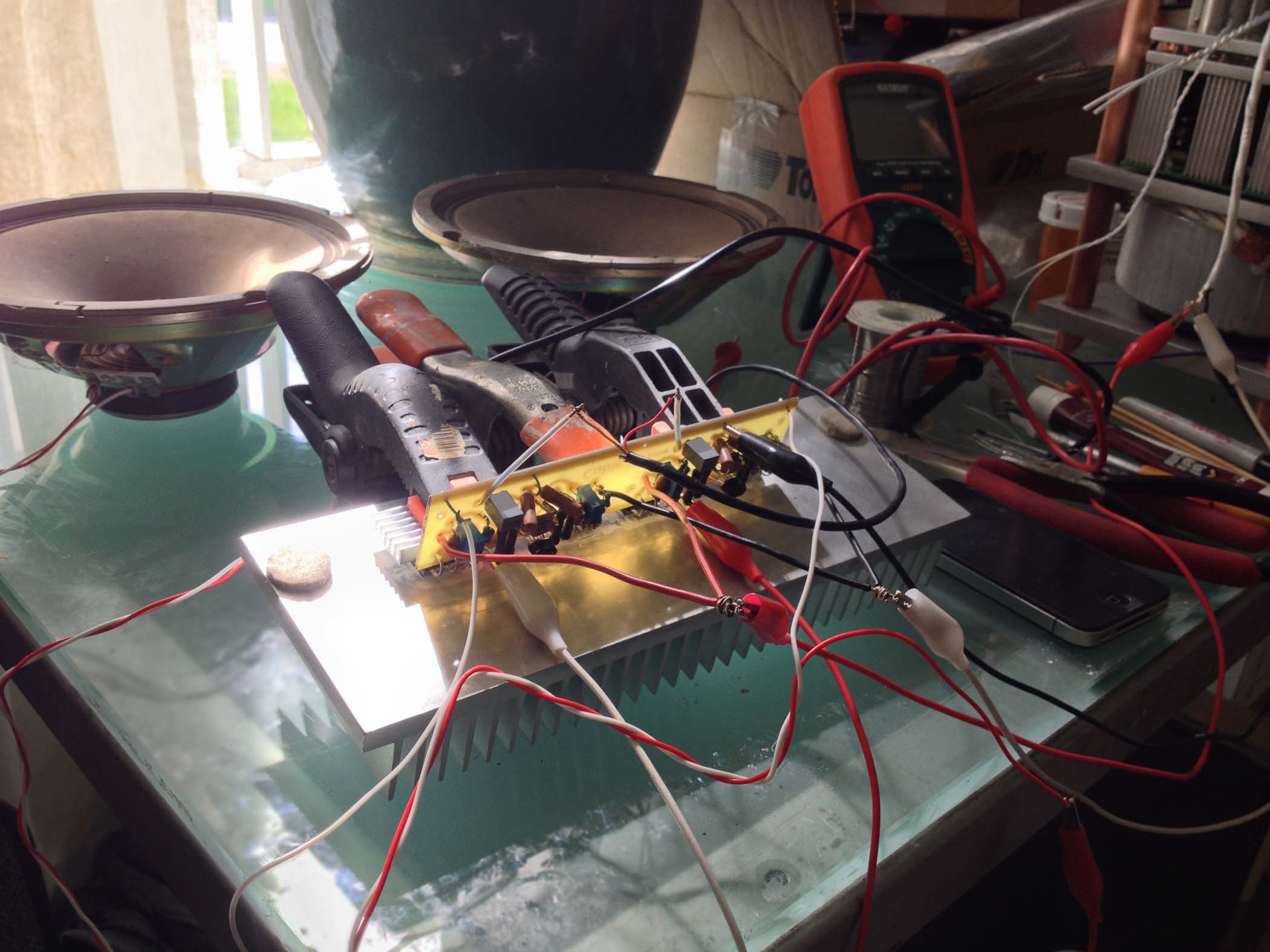

OKEY DOKIE, In fear of exposing further ignorance, I installed the jfets I had and powered it up with +-15v. One side has (near as I can rekon') 9idss jfets and the other 13idss jfets. I initially changed the trim pots to 1K trimmers. (Not leaving it on for more than a second or two), I initially had ~3 amps on the positive power connection. I can dial one channel down to 2-2.5 amps, the other to 1.5 amps.
I tested the jfets with the actual power supply (15v) and read across a 10 ohm resistor. That got me 130mV and 90mv on each jfet in the respective pairs.
Do I bail on these jfets, or do I change the resistor that is in series with the trimmers. Do I change the trimmer to the original 500 ohm when I do this. Please answer as if I'm a graphic designer playing an EE on a soap opera. Thanks so much. The amp looks awesome, and as soon as I get it running, I'll post some pics!- marsupialx

Cubie was designed for GR grade JFETs (Idss of 3-4mA or so) so obviously, when you installed BL grade JFETs you got too high Vgs and consequently too high Id in the output stage.
The remedy is simple:
Put back the original trimmers (500 R or even 200 R) and change R16/R17 (originally 390R) to 47 R or 100-150 R if you decide to use 200 R trimmers (for easier bias setting).

Change you Vds to 10Vds as specified in the datasheet.
Your 13mA Idss @ 15Vds is dissipating ~195mW. That is far too hot. The specification for Idss is Tj=25°C
If you only have a 15Vdc supply, then you can change your resistor to 390r. That will drop ~5V getting Vds down to 15-5= ~10V
The resistor dissipation will be 64mW, it will run cold to slightly warm.
Now your jFET is dissipating 130mW, still hot, but much better than 195mW.
You will probably discover than it is not a 13mA Idss device !
You can use a 100r for measuring current and add on an adjustable VR in series so that you can adjust the Vds to become 10Vds to match the datasheet specification.

It seems like shorting the resistor and just letting the trimmer get to the necessary drop in bias resistance would work to let me find out the actual total resistance needed, before unsoldering stuff. Sounds like it should work. Thanks for your help!
Cubie is biased at .7 amps per channel with 0 offset. It fluctuates a little. I will let it warm up tomorrow and tweak the bias. I had myself fabulously confused with top and bottom, copper side and part side. It dawned on me right before I posted the previous post. Thanks, juma!!! Thanks, Andrew!!! Will hook it up to some junk speakers tomorrow morning. Yeeeeeeeehaaaaaaaaaaw!😀
I ended up replacing the 390 ohm with 90 ohm and used the trimmer to get to the 119 ohm to 225 ohm range it required. Freakin' Awesome!!!!!

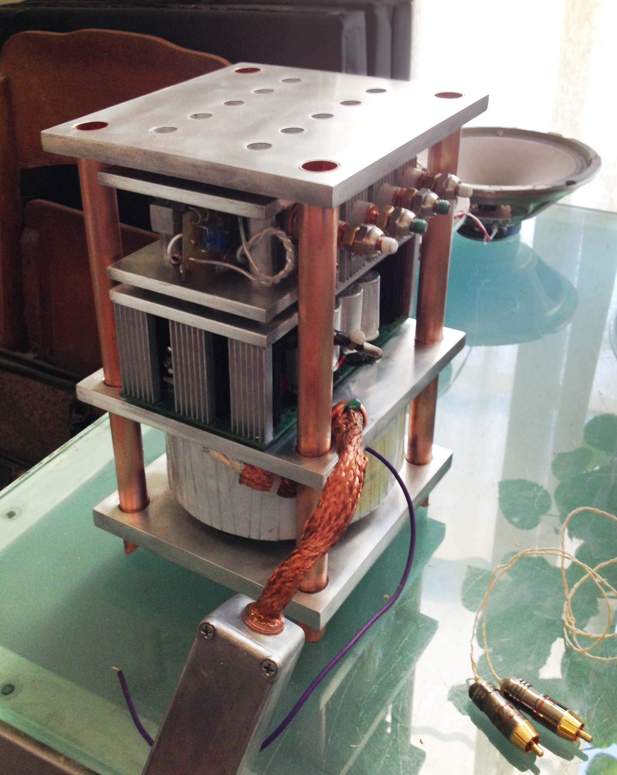

It's not "terrible twisting", it's a neat semi-circle bent around a cylindrical former. The board will hang from a heatsink above it. It's an easier (less terrible) bend than doing a right angle (which is common). The board is small and relatively light, and can move slightly with expansion and contraction. It is out of its own way for mounting screws. But that's cool. It at least was not done without forethought, right or wrong. My amp may be quite non-conformist, but that is the fun. We shall see... I'm the only one that's got money(time) riding on it... I certainly don't encourage others to build amps like I do!!! Thanks for the cool amp circuit!!!

Cubie. Built to be small and unconventional. Very fun. Ten aluminum chimneys, four copper chimneys also acting as structural pillars. More detailed photos to follow. Little persnickety details left to do. Haven't listened to it yet except on unmounted junk drivers. Three layers, transformer, power supply, and amplifier. Design, saw, file, drill, fit, sand, repeat... Thanks, juma!
