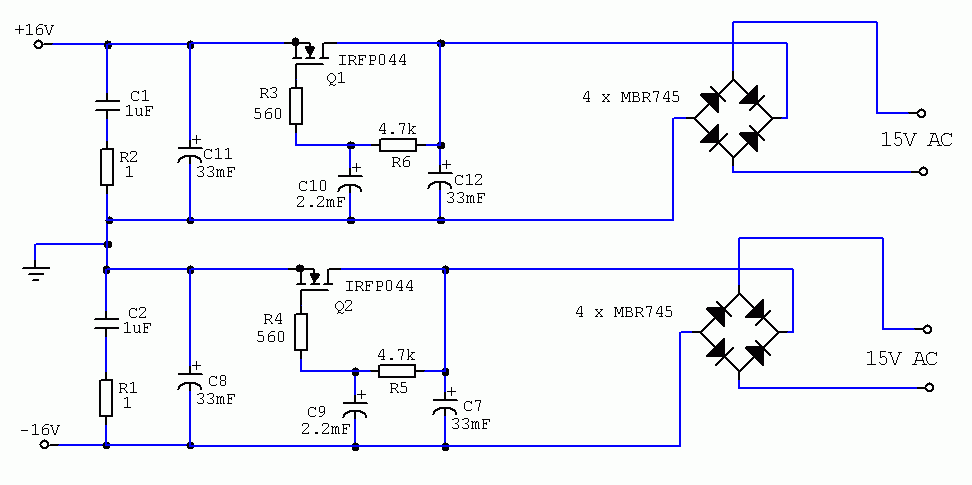

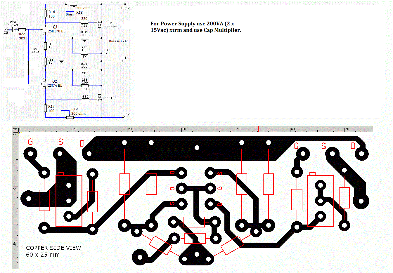

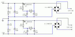

Updated schematic for using Jfet (BL)
Just in case someone wants to use the BL type Jfet I have modified Juma's schematics based on his recommendations given to Marsupialx. There was also some minor modifications along this thread so I modified the schematic a little more. I have also gather here the 200VA power supply schematic for the Cap Multiplier provided by Juma in this thread.
Hope this helps someone.
Maybe Juma should bless the mods before anyone goes ahead..
p.s. Very nice and cool amp Mursupialx, congrats !!
BR,
Eric

Looks OK...in case someone wants to use the BL type Jfet I have modified Juma's schematics ...
Input cap is not strictly needed, I put it as a precaution against DC leaking source components.
