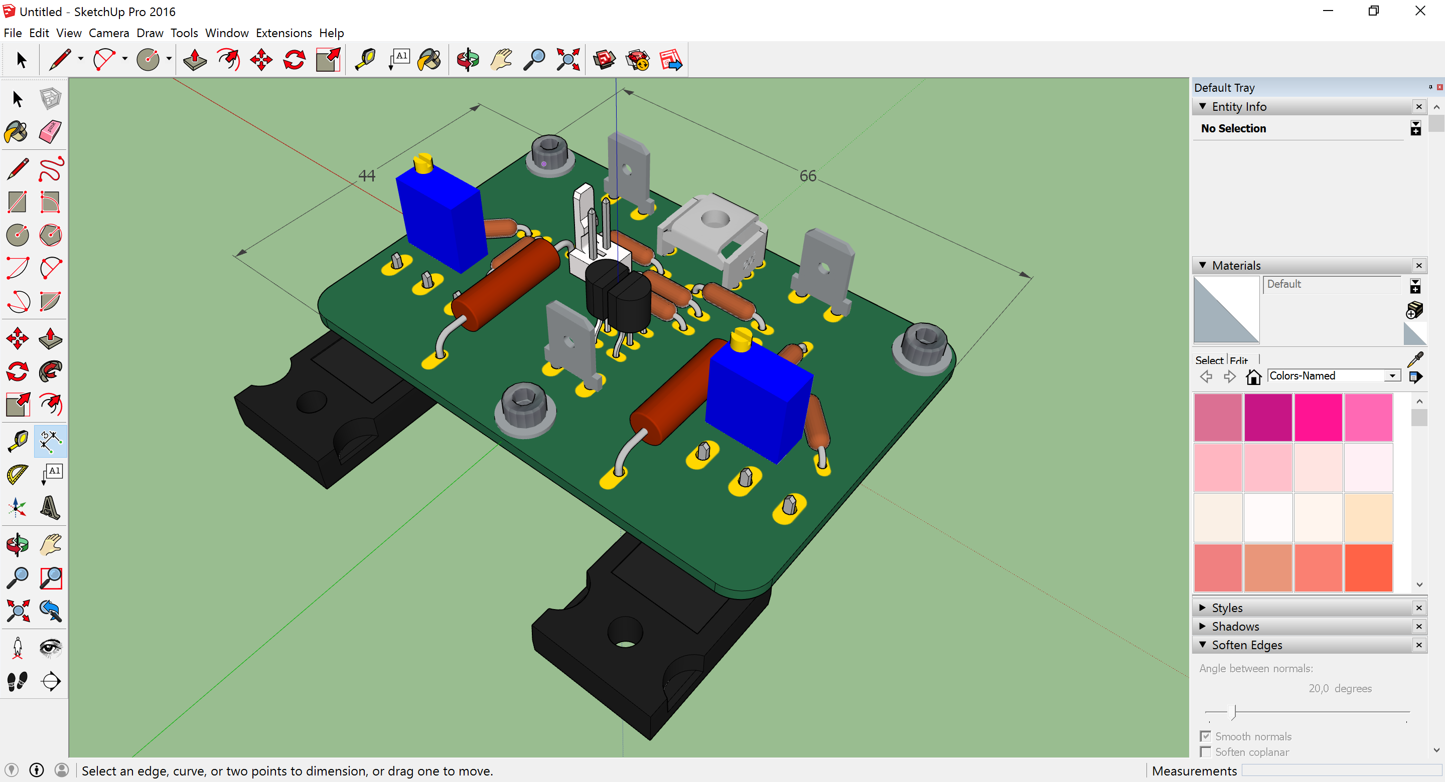

Really good documented thread, danke juma.
Rapidely designed, EAGLE, SketchUP...
JP
