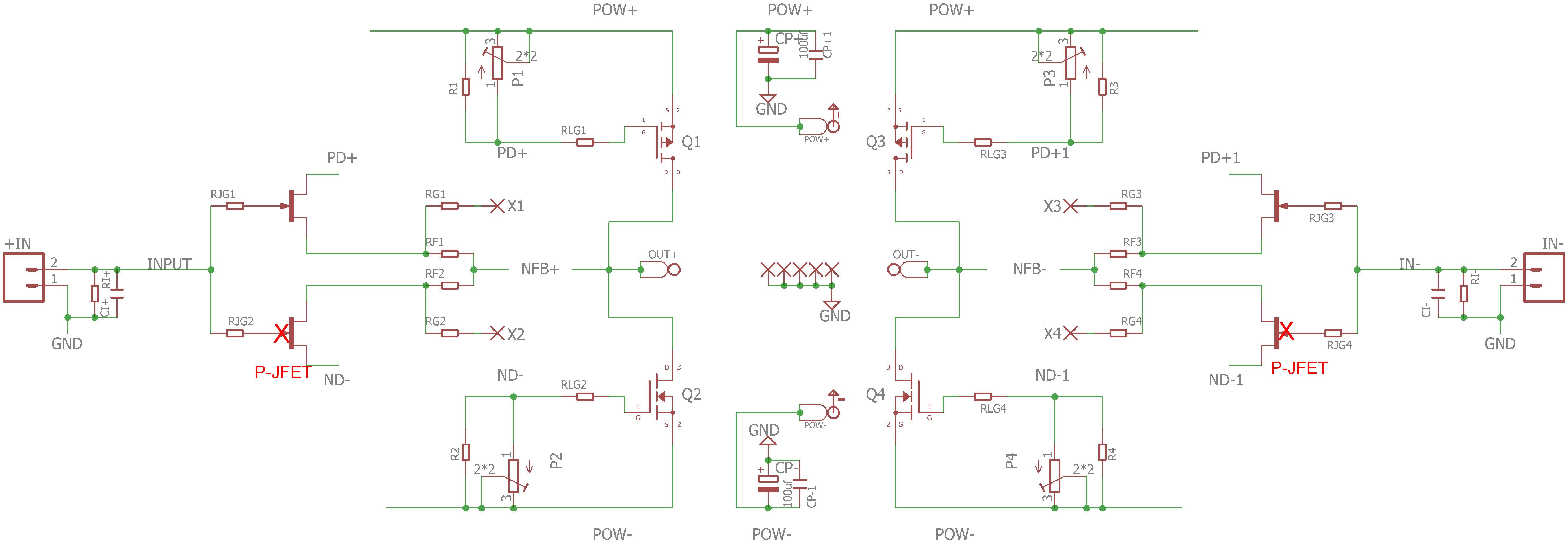

Just in case someone wants to use the BL type Jfet I have modified Juma's schematics based on his recommendations given to Marsupialx. There was also some minor modifications along this thread so I modified the schematic a little more. I have also gather here the 200VA power supply schematic for the Cap Multiplier provided by Juma in this thread.
Hope this helps someone.

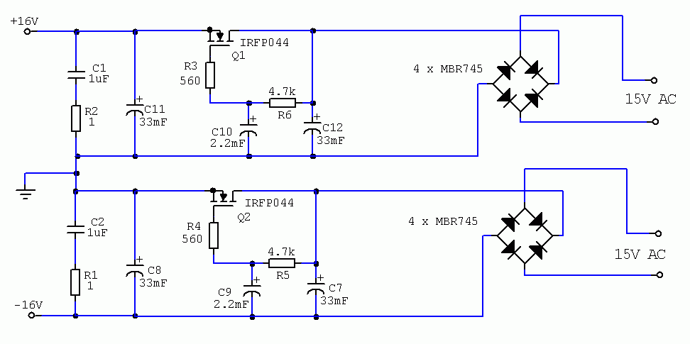

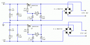

Since it's been decided that a small LU1014 based circlotron will be built and I need a 4 secondary transformer for that project, Cubie got a whole new PSU - a Sedlbauer 200VA potted toroid (2 x 15V secondaries) followed by a IRFP044N based cap. multiplier. It's on since yesterday and the change is not big, although noticeable - the presentations is a bit more cleaner and more defined (noticeable in big orchestral recordings) with a same gentle overall signature. So, it can be considered as an upgrade.
Here is the sch. and a couple of pics (big 0R1 ceramic resistors in the negative power rails are there just to check the bias current - they were removed after the measurement):

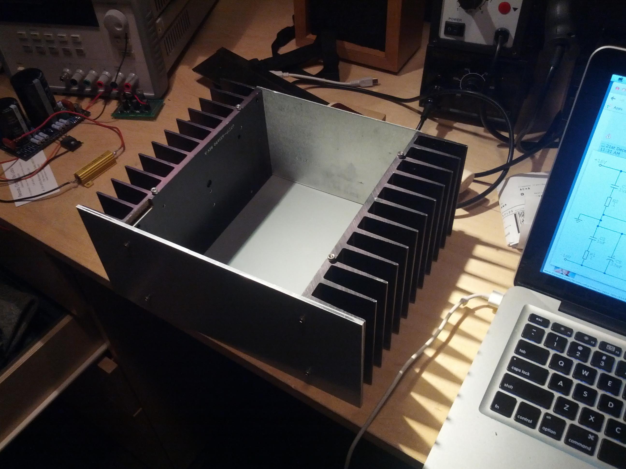

I'm going to build a cubie low power amp for a near field monitoring setup.
I have only "BL" types and will adjust resistors as mentioned previously in this thread. (Post #156) I am planning to use 12VAC without the cap multipliers as I have a smaller case than yours, and don't' want extra heat from the multiplier circuit.
Each heatsink is (21cm x 12cm and 5cm fins (8"x 4.75" and 2" fins).
What are your thoughts on the sound quality if I used the "BL" types and no cap multiplier. Do you think that having the cap multiplier will sound better?

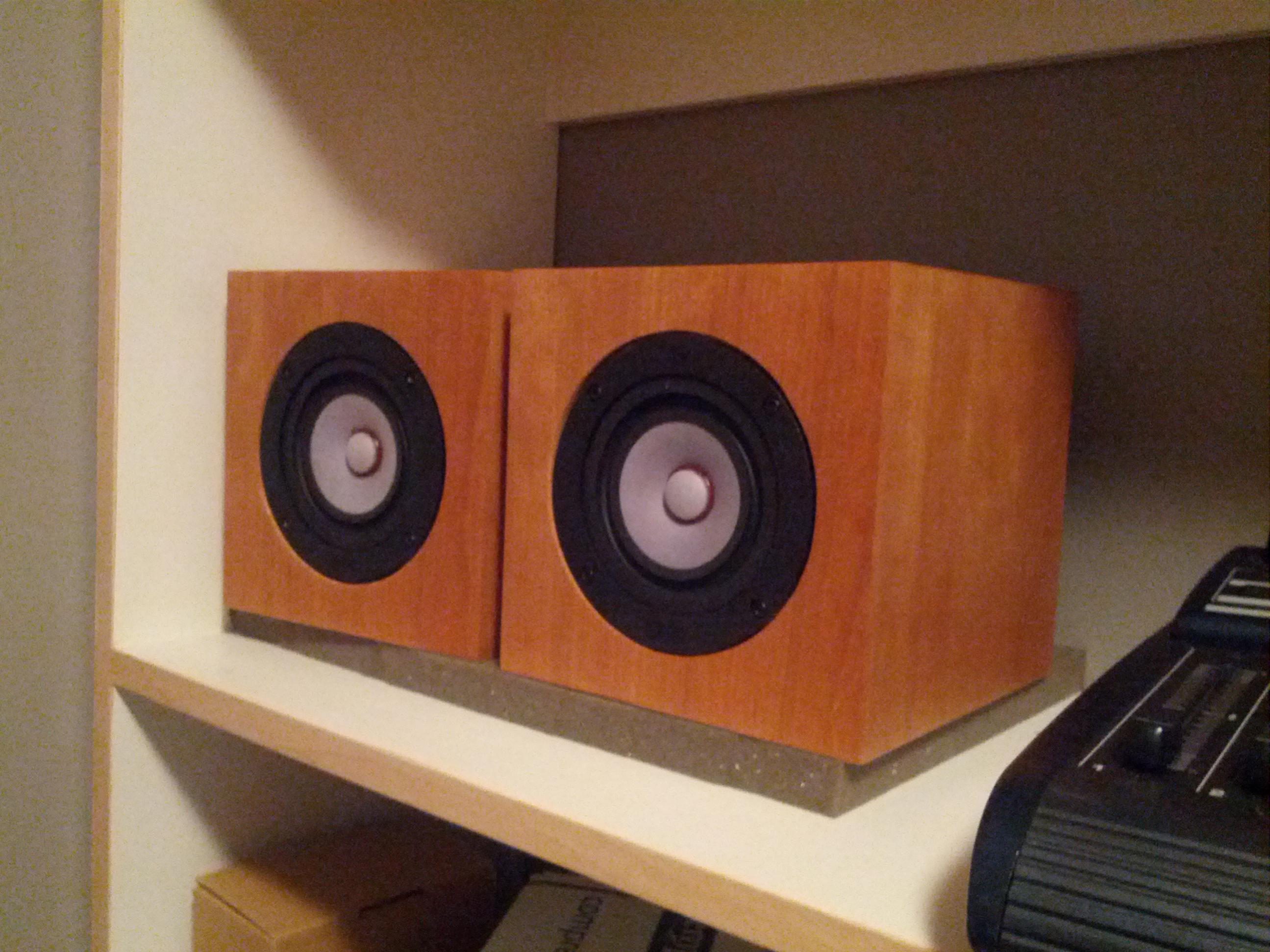

My speakers will be Mark Audio Alpair 6p used as small mixcubes.

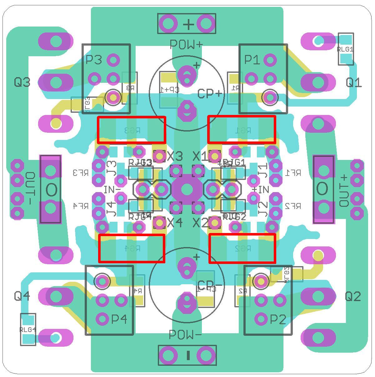

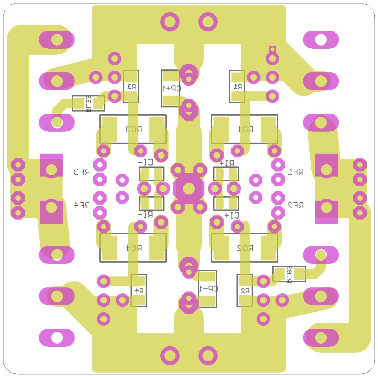

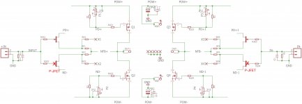

Balanced Cubie with CFNI
(New buzzword :D - Configurable Feedback Network Interconnection)
Intended use - phones.
PS
Is it possible to use Fairchild 2N54**/MMBF54** as JFETs?
Enough for phones only, speakers not necessary.

Hi Juma.
This PSU, is it capable of delivering ~1,4A ? (mono psu for one channel miniAlephJ)
I am asking because it's looks very interessting for my Mini AlephJ build
Regards; Jesper.
Hi lykkedk,
that PSU will deliver about 6A (with 200VA transformer) and yes, mosfets in cap. multipler will need some heatsinking - Pd of each of them equals to Vgs x Id.
You can use it for Mini A, no problem.
Regards
Cool...

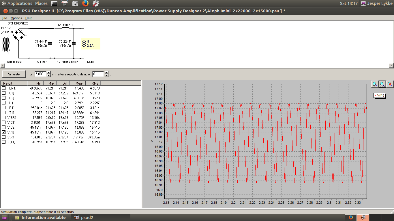

What about the MBR745 diodes? Do they need sinking?
Also Juma, do you know how much ripple it will give me with load of, say 2,8A? -You can see i have attached a sim. of an normal bigdumb psu :)
And last quistion, the 1R resistors, are they 1w, 0,25w ?
Jesper.
Repeat your PSUD analysis using the values you have in the sch.
You will find that the 4k7 & 2m2F have a time constant that gives a very slow charge to the second 33mF.
The FET will start to get warm while charging up that capacitor and feeding current to the amplifier.
If you draw 2.8A through a diode bridge dropping 1.4V then the bridge needs to dissipate almost 4W. That will be hot. And it will get hot fairly quickly due to the high start up currents into those 33mF caps.
At high currents the bridge will drop more voltage and thus more heat.
At pulsing currents the rms heating effect is higher than for constant currents.
