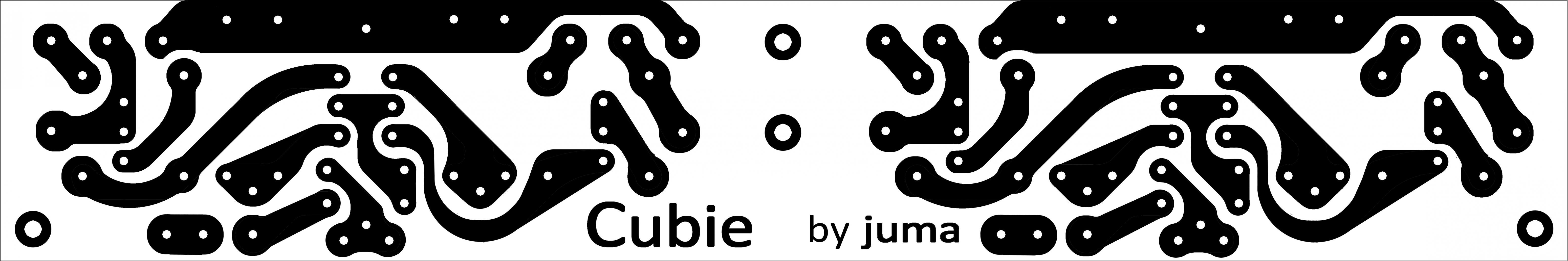

It is one board for two channels. I will be doing one board with some form of resist, I will try laser toner transfer first, followed by a hand cut stencil and some spray on resist when the toner transfer fails. I have a high resolution .tif that I'm sure no board house would touch, and no silk. I have only done an etched pc board once. I have enough board to screw up three times. Thanks for the well wish, this flu is mild. I can send you the high res file, but I'm not equipt to offer any sort of tech support.
The tone transfer actually works. Use glossy paper like the ones from publicity flyer and make sure to use a laser printer. A deskjet won't work, it must be laser. I just finished one a few months ago (another Juma's design), PCB came out pretty good considering it's toner transfer.

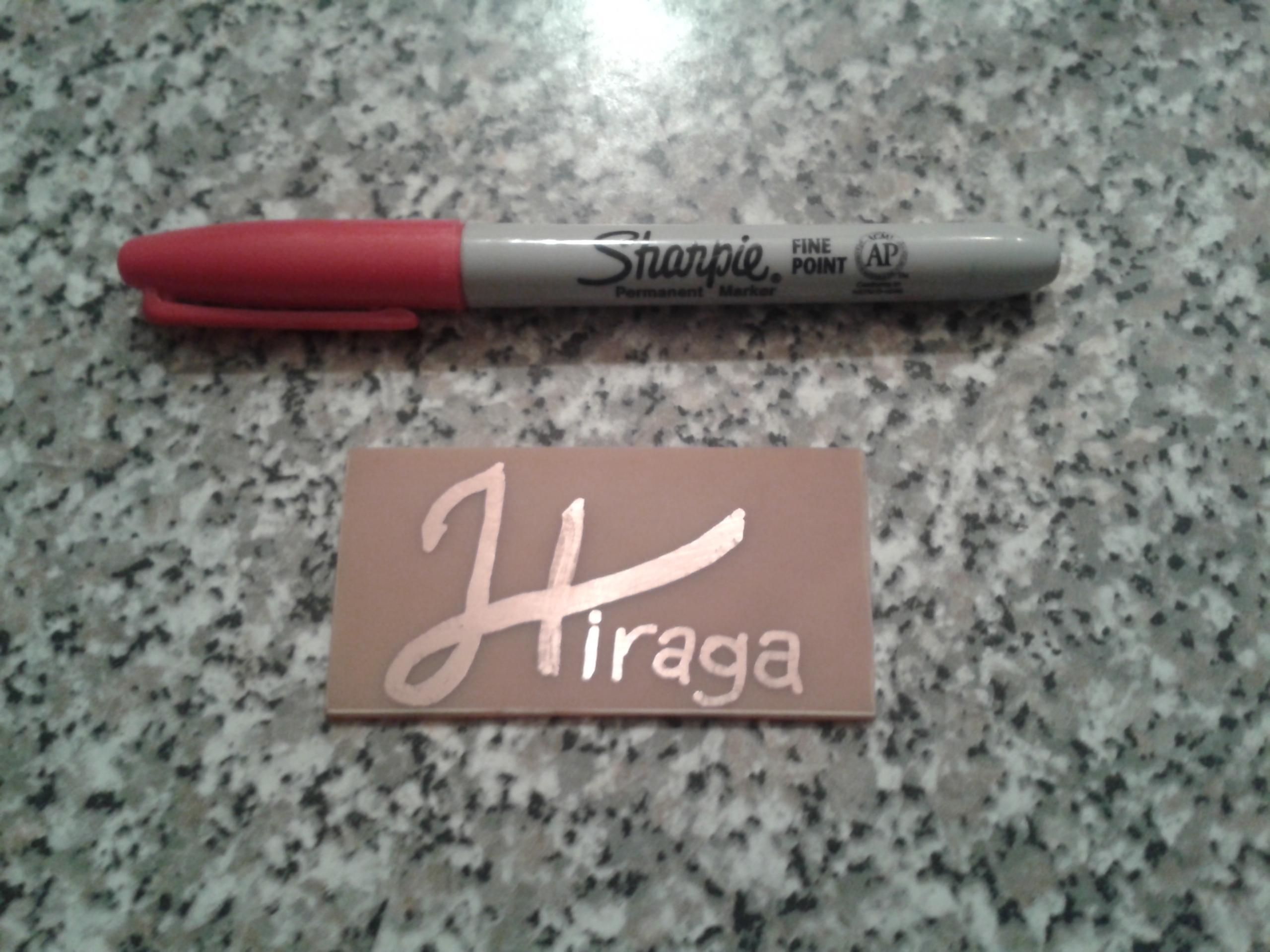

If you are patient enough just draw the circuit by hand (reversed dwg) with a Sharpie. The permanent ink of these Sharpie is not going to be attacked by the etching solution. For fun tonight I wrote Hiraga by hand on a small PCB then I etched it. What you see is actually in copper. Using a black PCB would give it a nice look as a nameplate for exemple.

What price vanity? I like the precision of the tweaked graphic file, and I know I couldn't pull off the typography with a sharpie. I have read that a sharpie works, and it's nice to see proof. If it were something that I was tossing off, that would be fine. Unfortunately, I was schooled as a graphic designer. Originally thinking about using a sharpie, but some posts back I freaked out when I realized how tiny the board actually is. I was working on it greater than full screen, then I printed it out. Thanks again!!!!

Yes, Sharpie works great and that is how i make my prototype audio PCBs for the last 30 years.
But best results are achieved with oil-based permanent marker pen (google OHP marker pen) - I use Edding and Pilot. With them i routinely get good PCB tracks thinner than 10 mils (about 0.2mm).
The key to a good pcb made this way is to make the copper perfectly clean before drawing the lines and avoid touching the copper with fingers.

Boards etched. Took me 9 tries to get the laser transfer correct
, but finally figured out that I needed to heat it with the iron until the glossy laser paper significantly yellowed, and then press it with a weighted platen, (a piece of picture frame glass and a weight, while the toner cooled. I don't know if the glass was necessary, but it worked. I retained all of the detail, down to itty bitty dots. Holes are drilled, some resistors are soldered. We are on the way!
