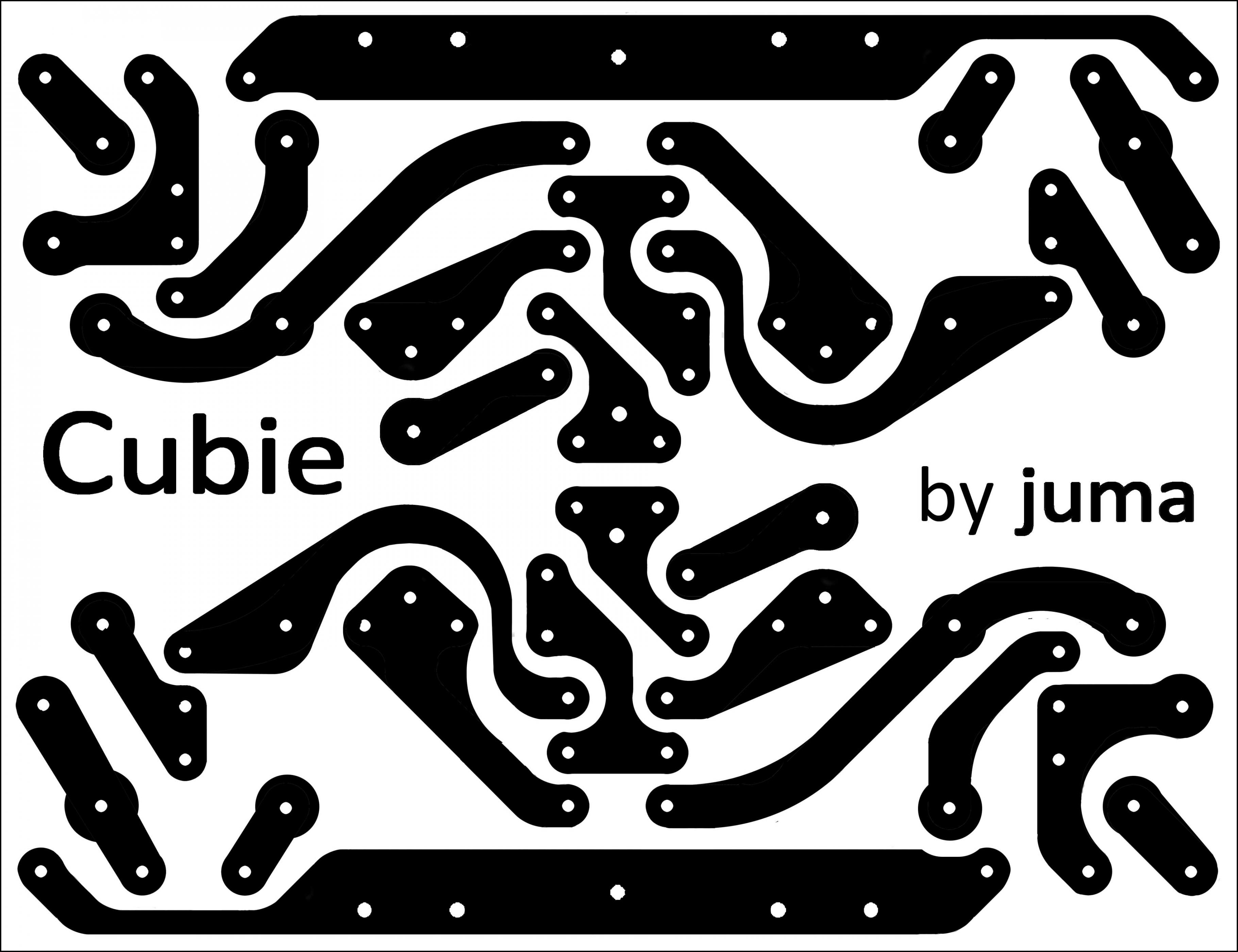

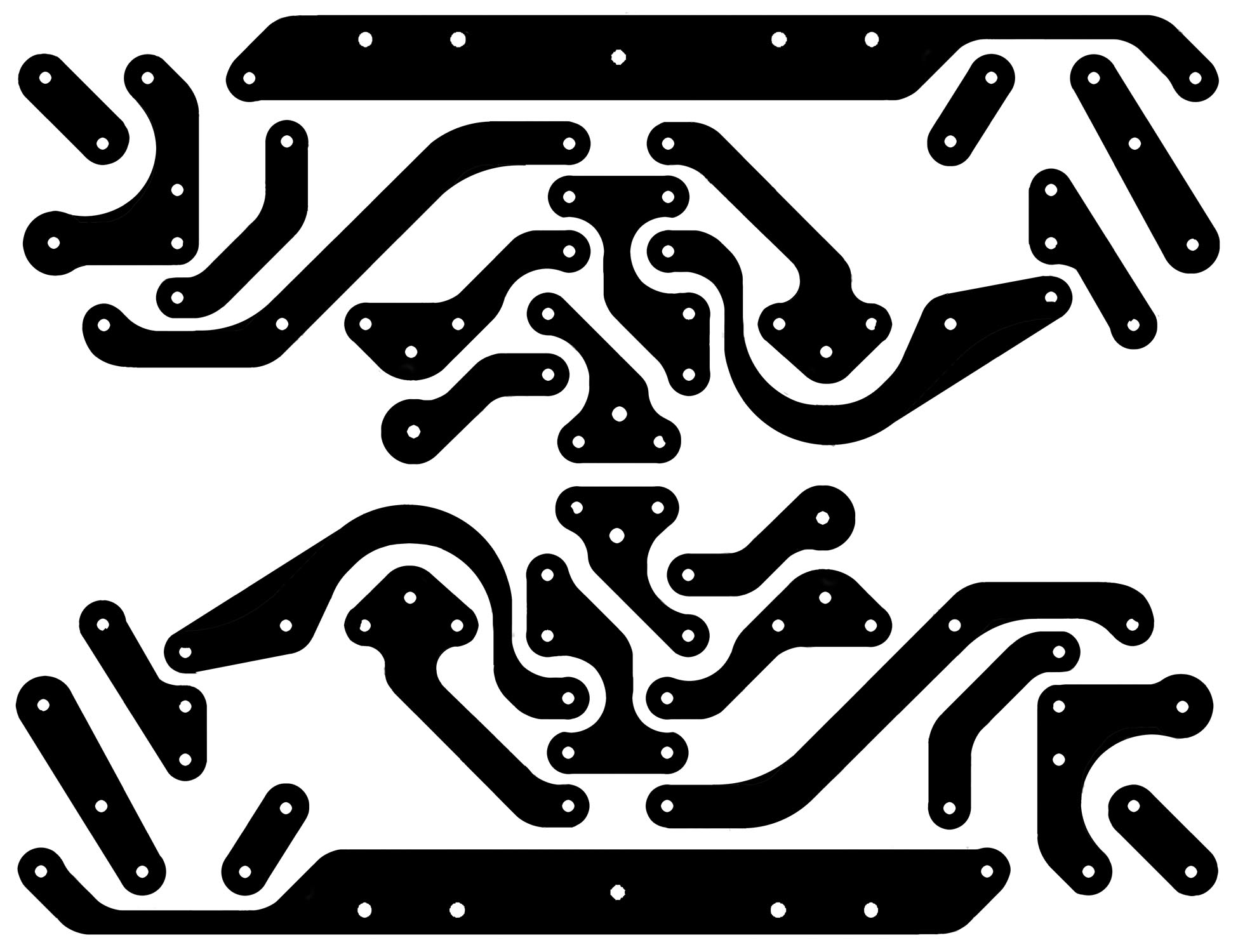

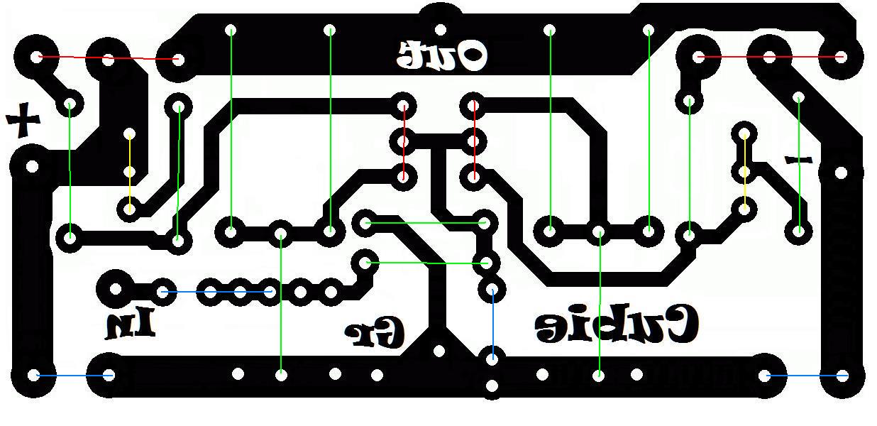

Thank you!!! I have an even smoother version now. I had not printed it out actual size. If 25mmX65mm is correct, this thing is tiny!!!!! Man, drilling it will be some precision work. Bought a 4x6" piece of fr4 on Ebay. I can screw this up repeatedly and not run out of board. Lats are on order. I have the jfets. WhooHoo!!! This is fun. Thanks, Juma!
Be careful you have 2PC of Pc board together!
You have to dived into two piece so you writing in wrong place also you have to mirror imaged.

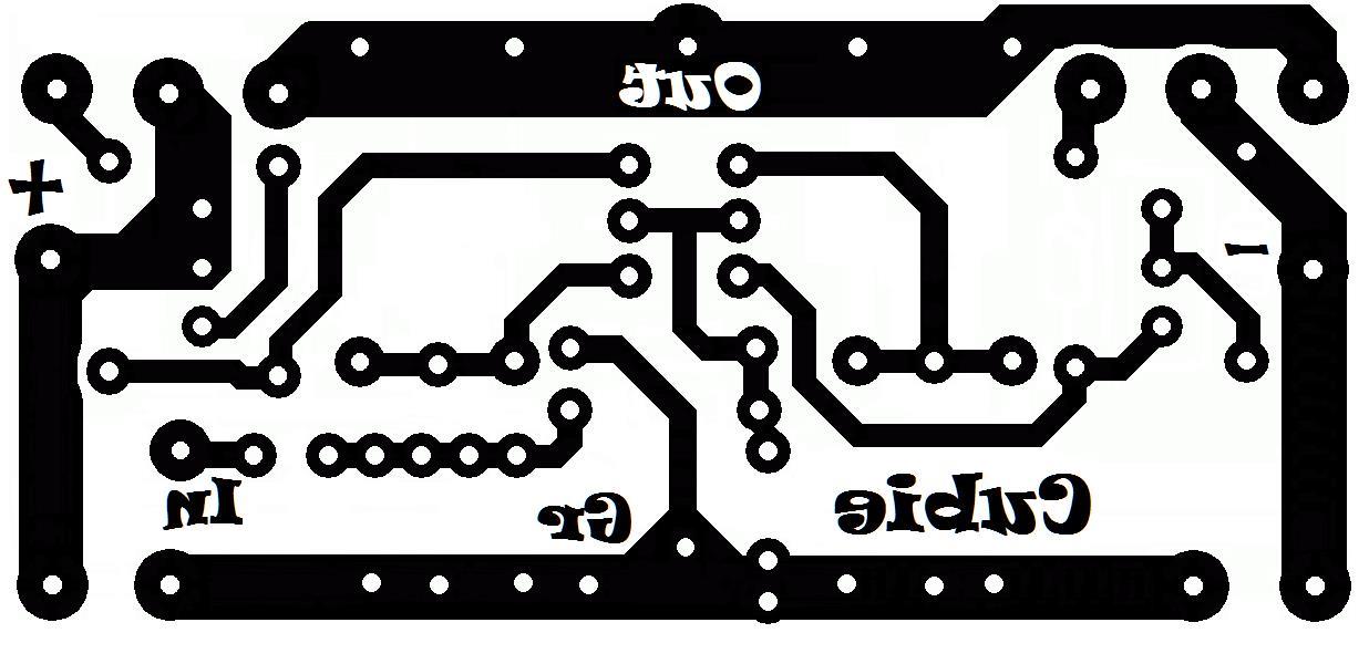

My lay out for these fantastic little amp!
Only post that so you can see
It need to be resized at print out.
Greetings
Greetings

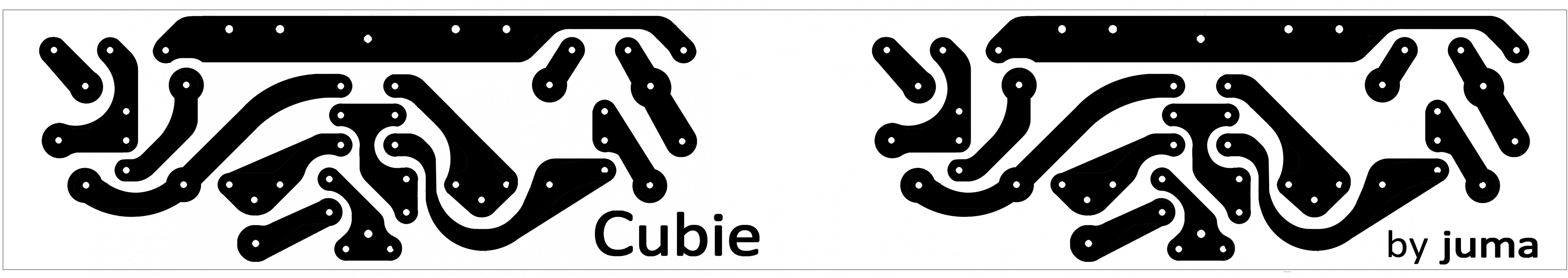

Both channels are identical, one is rotated 180degrees from the other. I plan to build it so the lats stick out from each side. As I posted, I am not intending to divide the board. The layout is per juma's post, which says it is copper side view. So no mirroring should be necessary, unless I do a laser print transfer. I could easily arrange them side by side, so the lats would be in a row. Now that I realize how small this is, I may decide to do that. Nice layout!
And maschines was created by who, Martians..Lovely.
Starts to look like a human was involved in the design/layout process, instead of being ruled by machines
- Cubie - small F5 variant with GR grade JFETs and LatFETs
