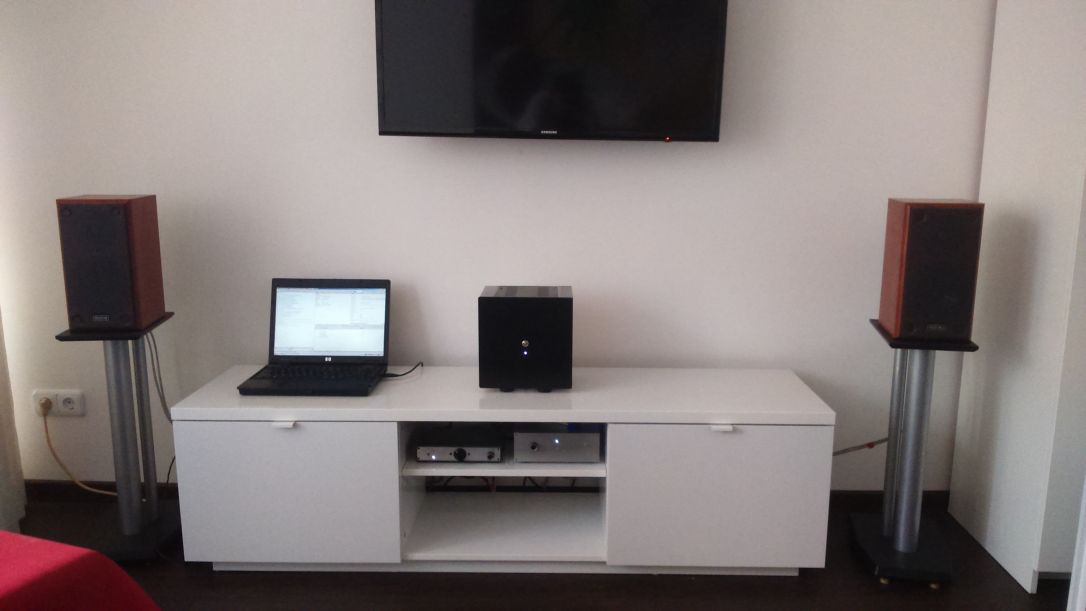

Finally, the Cubie and the friends settled down and they are playing the music again. :)
Searching for an apartment in Berlin was a tough experience, but it's over, life and music can go on... Oh wait, it's still 6-8 weeks till you get a broadband connection - until then, this 32 kbit/s link will serve you fine... :rolleyes:
Oh Juma :confused: I had a girl friend back when I was younger ('85) who just had to be a Berliner. She finally found an apartment by chasing down residences from the Obituaries in the paper. I spent several 4-5 week vacations there. I guess to me that would be Manhattan or San Francisco, but, around Christmas the sun barely is up at 9:00A and it's dark by 4:00P!!! I totally enjoyed my time with her there. I lived in Arizona USA then. Very South, nice temps... Thanks for bringing that up
Suggest you move that cabinet between the speakers so you have a bare wall and add a simple Schroeder diffuser (QRD) there instead - despite the unequal speaker wire lengths that some people say is deleterious, the benefits are quite clear - amp(s) on a low bass on the floor between is okay if the system will tolerate a longer IC without requiring a balanced line.
