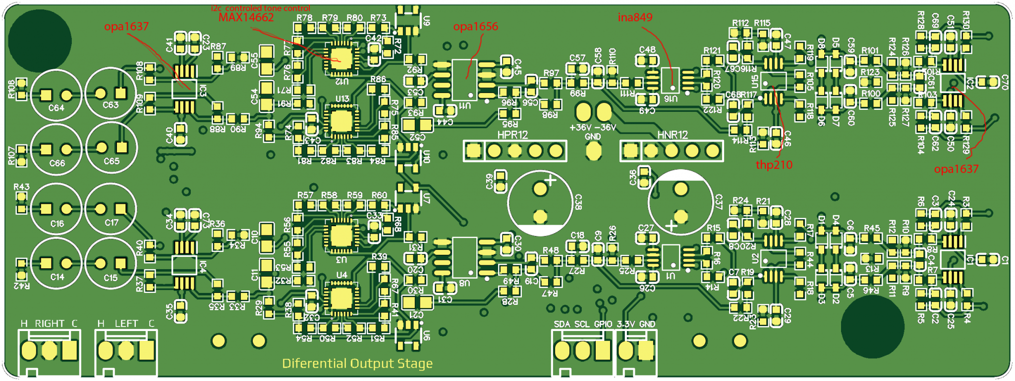

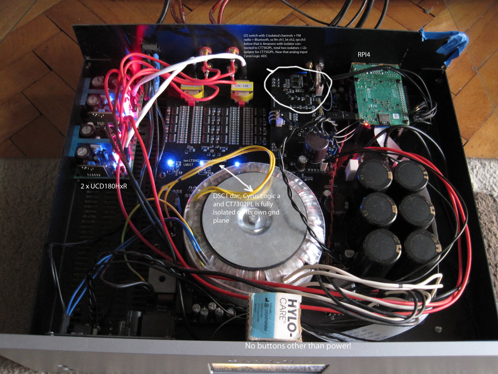

I can only say that CT is at the very top! This is what I sucesfully done. It have four optic inputs, one analog input, one usb input, fm radio, bluetooth, rpi as a media server or whatever, Hypex power modules. Transformers will be replaced soon with opamp based i/v, ina849 to convert diff to single ended, than multi feedback lpf, than resistor lader based i2c tone control, than single ended to diff at the end. Some vids how it sound

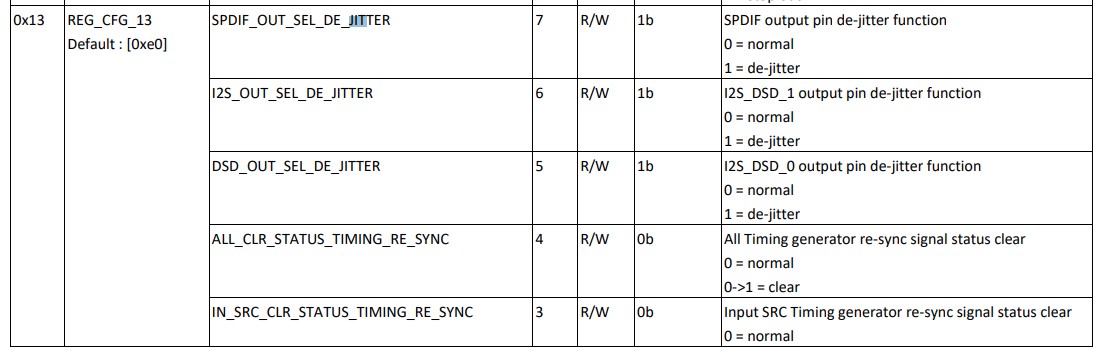

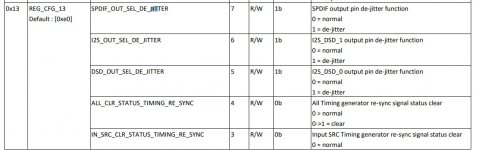

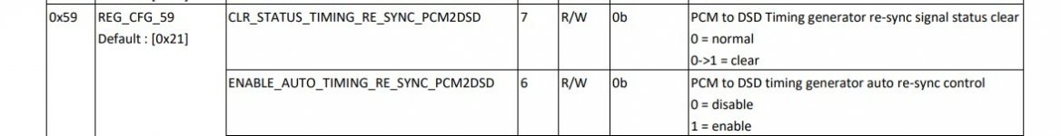

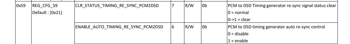

CT have dejiter and resync functions, and a lot of fine tunning for master clock output, you should take a look at einchoria pdf file. Here is some of the functions, see picture. Few diferent src mode, synchornous or asynchronous with a lot of tunning parameters. Also it have sample rate detection and in the same time interupt pin which you can use for example to switch between two diferent clocks domains, many more other things with a lot of possibility and combinations. Three i2s inputs, 5 spdif inputs, 1 spdif out, two or three if I'm not wrong i2s outs, so in comparation to AK it have a much more functions. Also take a look at THD and SNR! The price-features ratio against the competition, you can agree that it is quite decent and ic is not bad at all. The only bad against CT is that CT do not have strong marketing as AK and competition.

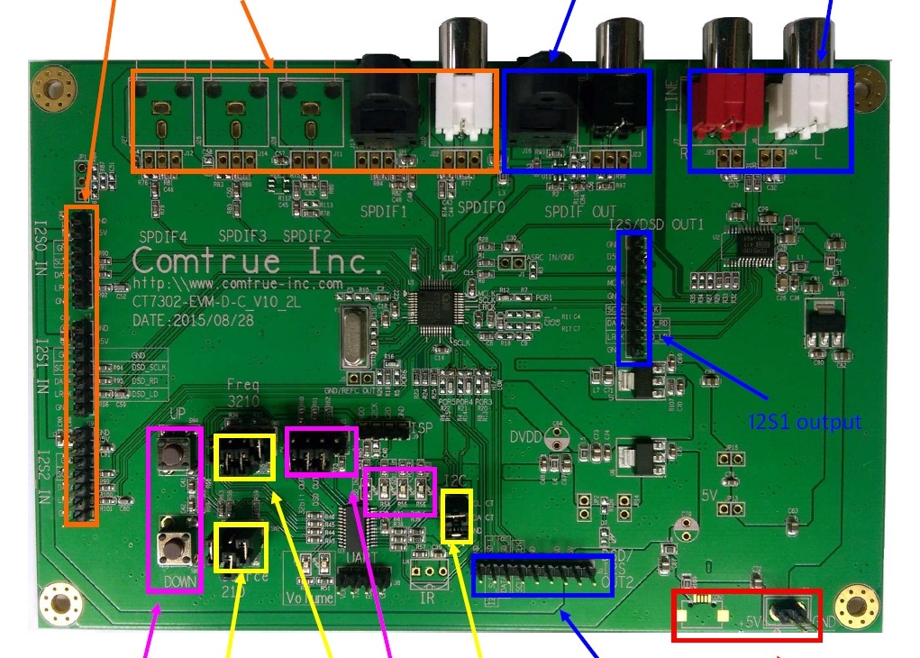

Pic attached below of CT7302 eval board I have. Surface routing of I2S inputs is not that different from external AK4137 and SRC4392 boards. Have seen a problem before where tin pin header surface corrosion increased jitter. Using gold pin headers solves the problem. Pin headers on my CT7302PL board are tin. Have also seen power supply quality to ASRC chip have some influence, which Comtrue denied could be an issue for their product.
