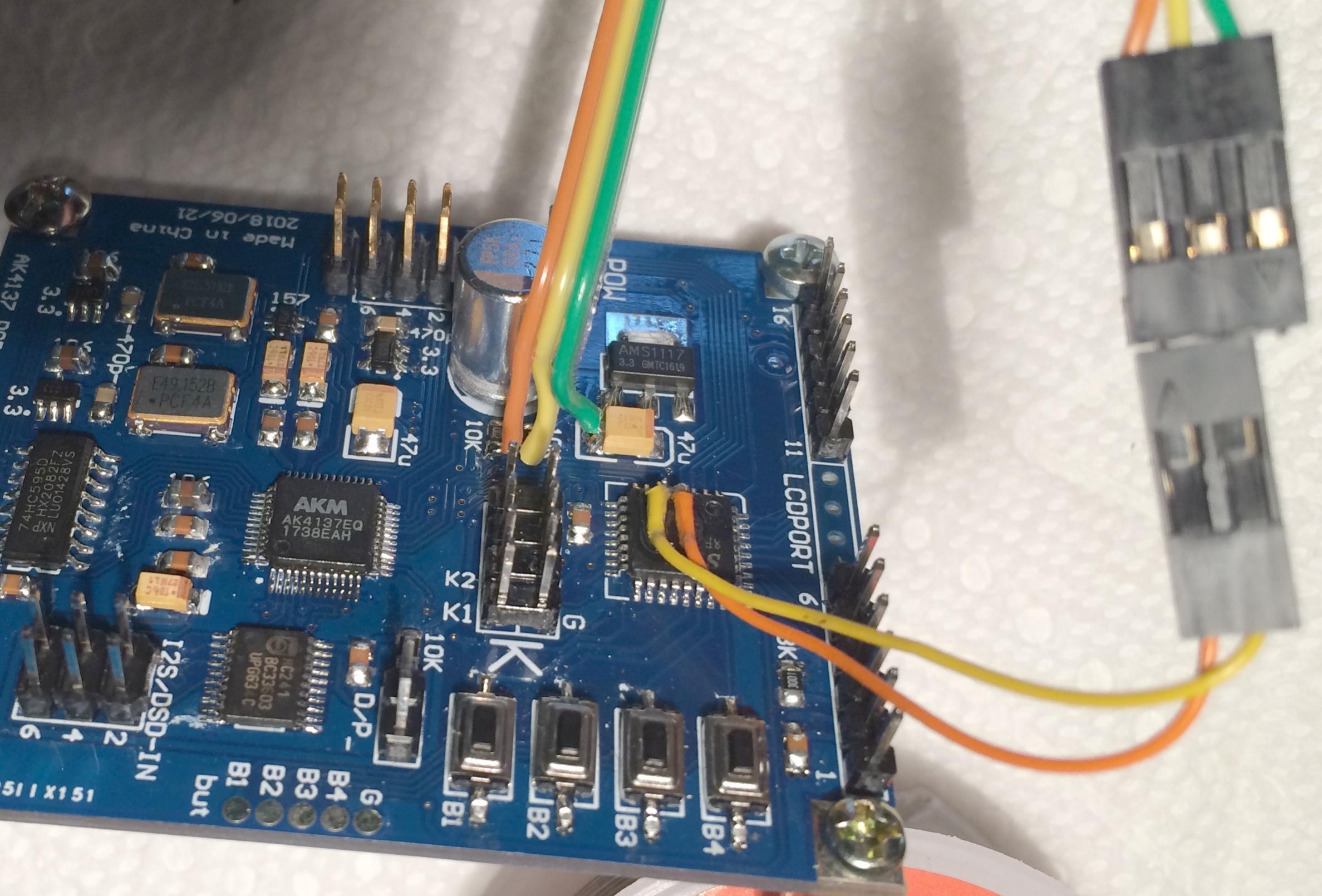

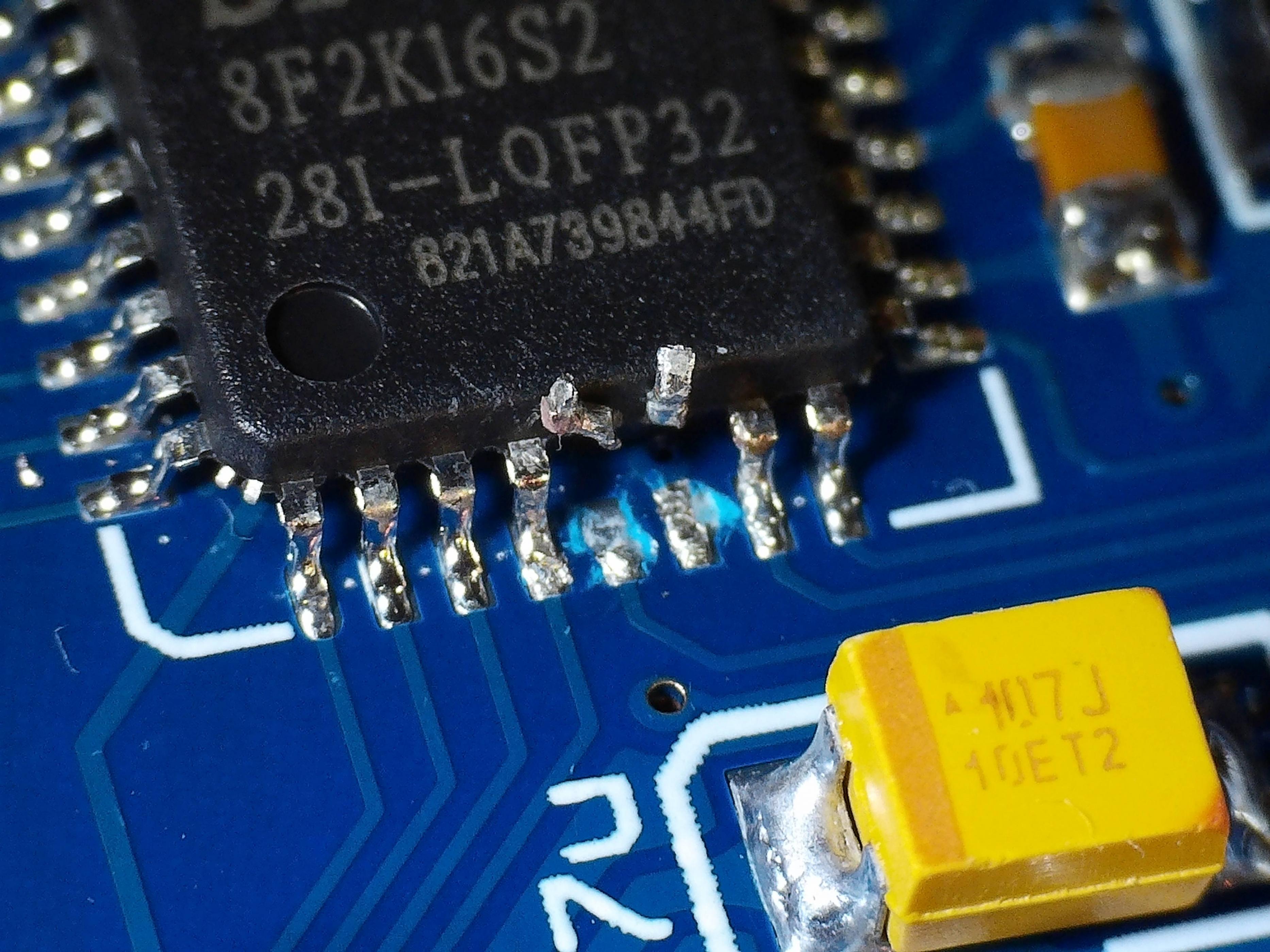

You could do that. I would choose Amanero over Mini DSP. Not sure if Mini DSP will resample your audio or not, but sure that Amanero won't. Modding one of the better Chinese AK4137 is possible, although it would be some work and involve some tiny soldering. For example, a couple of pics below of freeing up the I2C bus on an AK4137 board like the one you linked to previously.
