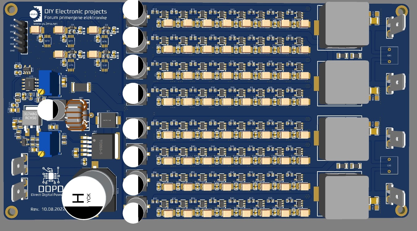

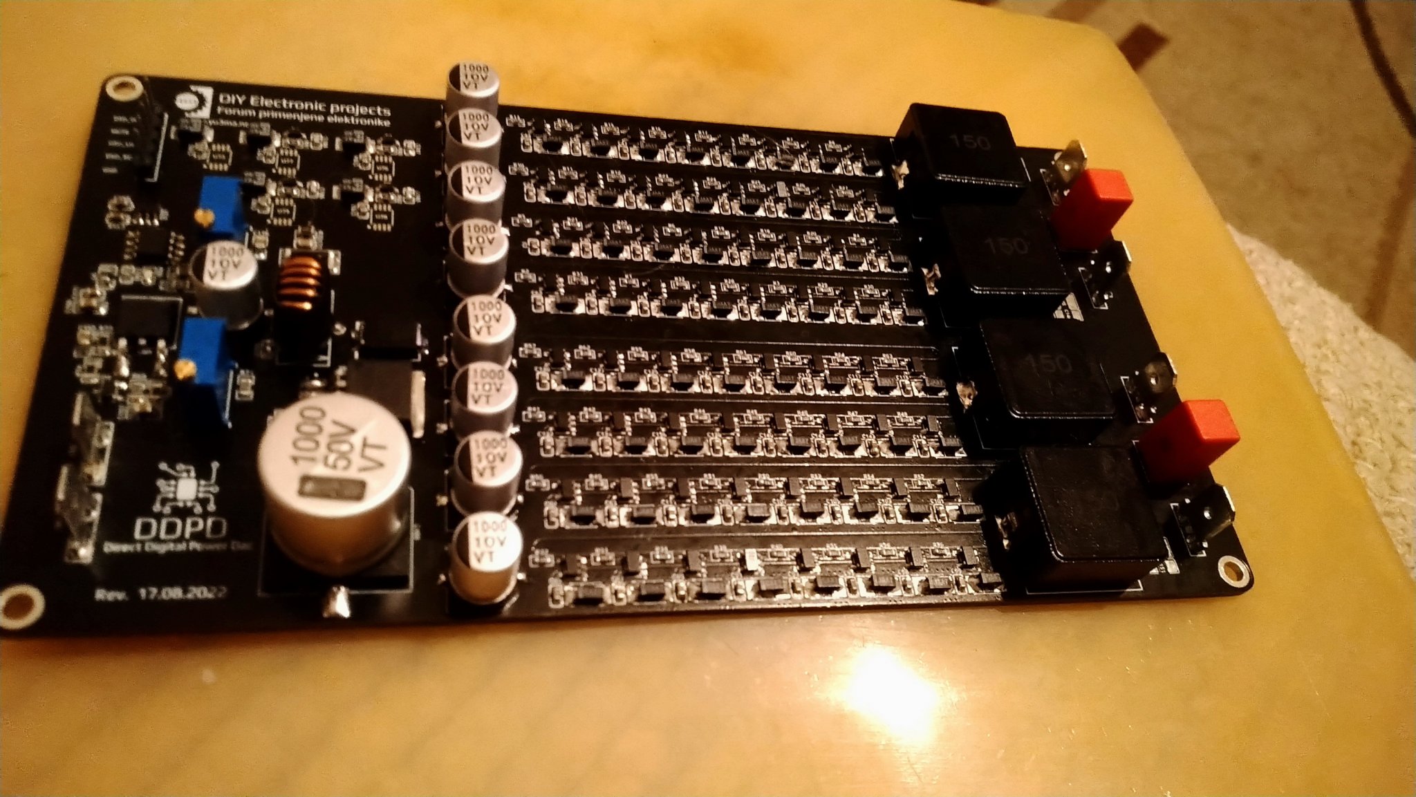

We have made first pdm modulated (dsd64) direct digital power dac (DDPD), H bridge, test board will be ready next week, it will be combined with CT7302PL as a converter to dsd64, project is 2x3W on 8 ohm load, volume control is done by variable power supply on H bridge, next plan is gan fet H bridge.

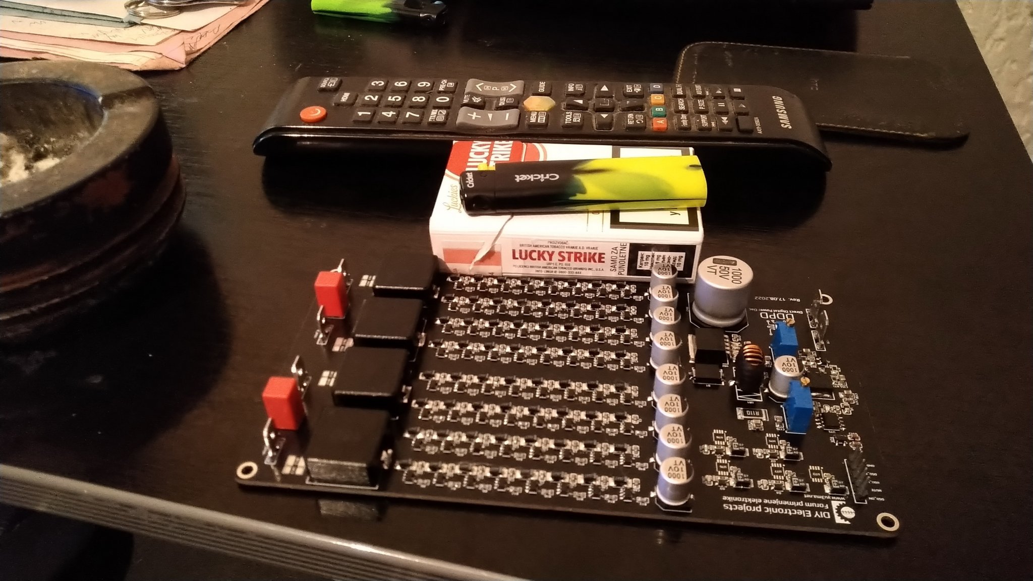

Success in DDPD concept! Next what I want to do is to use two ct7302pl, first one for handling optic, usb and every other input and convert it to PCM, than those PCM goes to ADAU1462, than seccond CT as a converter to DSD64 for output to DDPD. I'm tested DDPD with DSD256 with success, have no way to test DSD512 using Amanero as a current test signal but I'm believing DDPD have no problem too with DSD512. Comparation between DDPD and flow water heater is that DDPD have bits flow and water heater have water flow 🙂 Also I have in plan to try raspberry pi 4 barebone os and use gpios for suplying DDPD with DSD trought gpio, also to implement camilladsp... Please hear

Yes mic on my xperia 10 is probably not a good source to record audio realy, there is a rustling sound, probably the phone is not recording the sound properly, probably have some automatic recording corections. What deliver this amp is unbelievable, the huge dynamic and huge mids! Hf is somehow not ideal, need to be changeg, and replaced with 4th order filters and it will be ok. Generaly this amp sound better than anything I heard recently, mean to mids and lows, huge sound stage. And H bridge have no problem even on dsd256 as a pdm modulation to H bridge which is around 2.8 up to 11MHz tested without any problem! By default minimum is 2.8MHz! 🙂

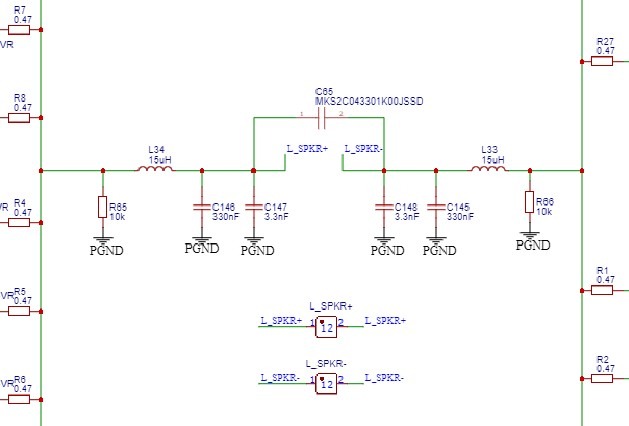

There is 32 ultra fast half bridges in paralel per channel, it forms full bridge, 16/16. More half bridges more amps. No FB at all, but plan is designing 1bit adc at the speaker vires which will be feed to smething at the input to make auto digital input signal corection, curenly we are out of idea how to make something like that, it need to be ultra fast, but my hope we will figure that out. Even without fb things is very promising! I will probaly open new thread, in my hope more brains in paralel will make something new in relation to concept. First in the World direct digitaly driven pdm modulated full bridge with a variable supply as a volume control! 5V fully CMOS class D 🙂

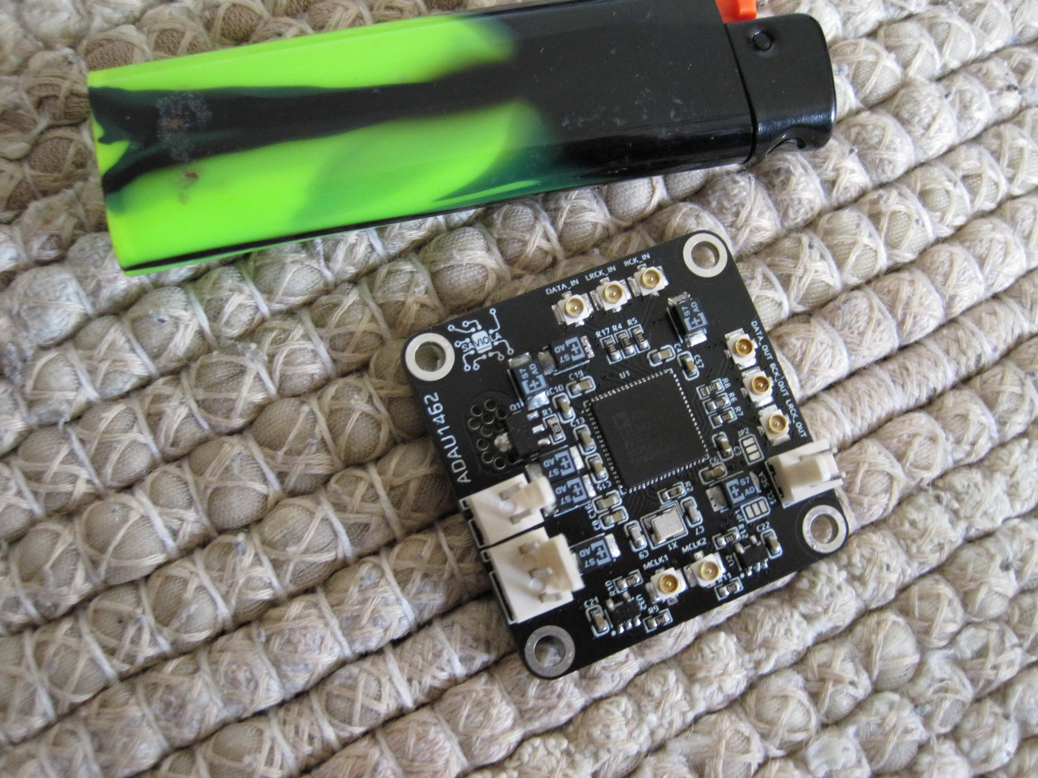

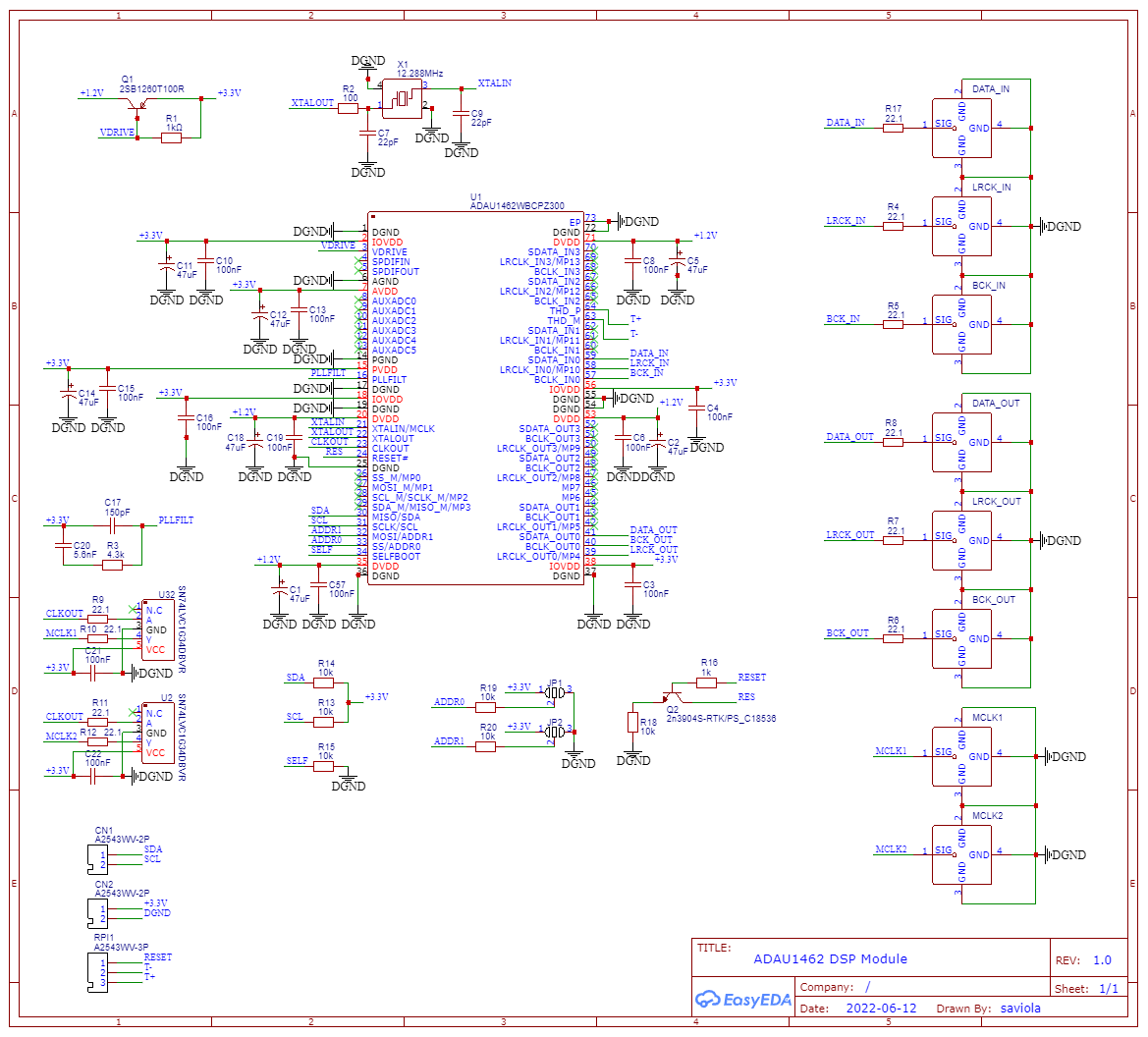

Yes me too! I'm allready made my own ADAU1462, and I will connect two CT7302PL, first one to convert everything to PCM, than PCM goes to ADAU, than to another CT7302PL for conversion to DSD than to DDPD. If everything is working plan is to make DDPD concept with Gan.
Here is DSP material, note that I'm not tested it! Do not have free time for that right now. If something is wrong on schematic please let me know. Which DSP you have using?
