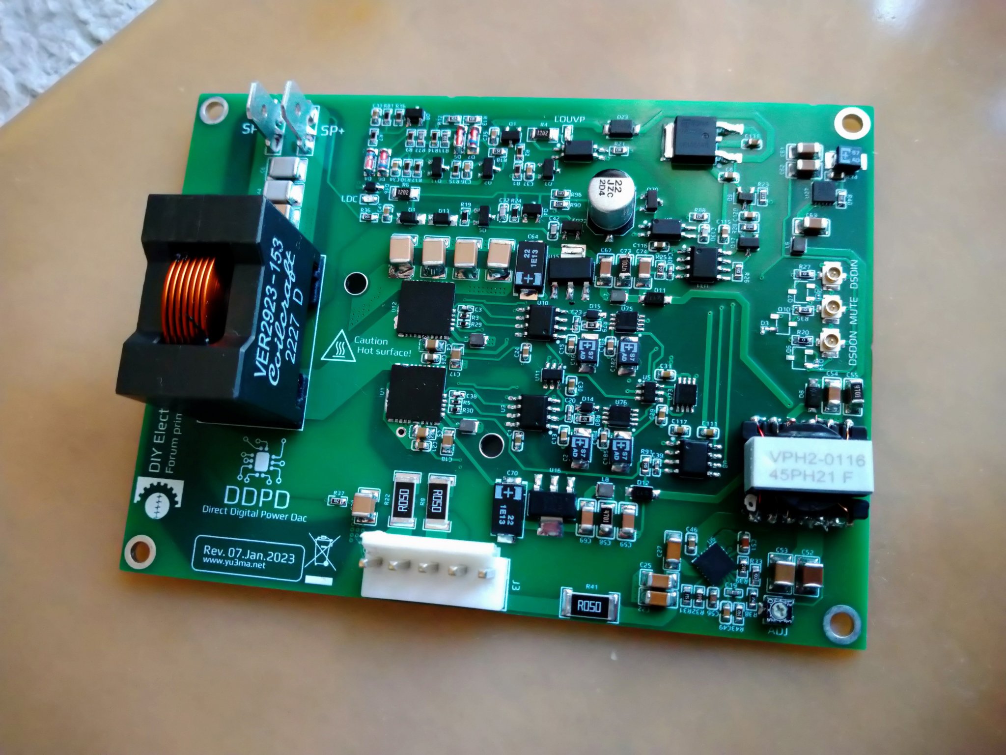

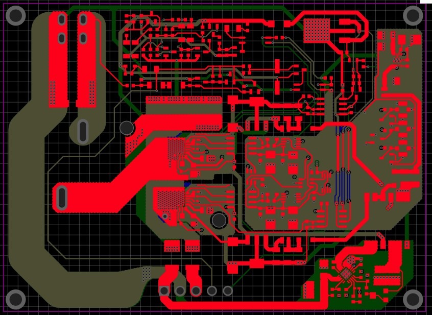

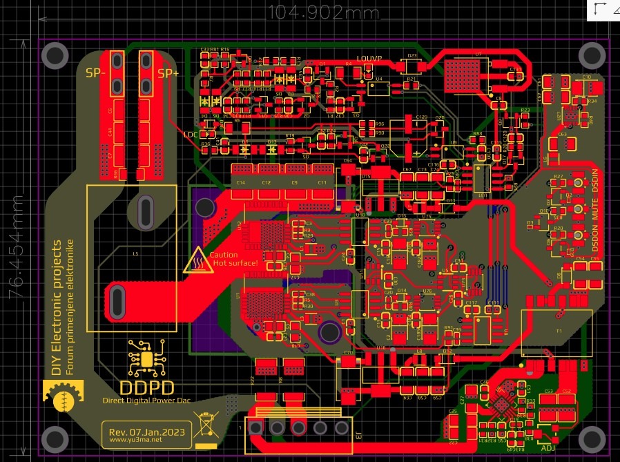

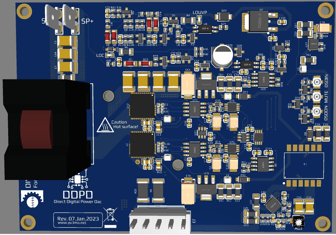

In relation to post 82, first ganFet prototype, UVP, OVP, cycle by cycle OCP, temp, DC, LPM, autostart, standabay... etc a lot of protections and features. Working on Hypex SMPS400-180 x 2 mono. CNC machined heatsink 105x76 at a bottom. No opamps... etc

Finito! If it sound good as 5V concept I will open new thread and give you schematic of the 5V concept including boom and gerber

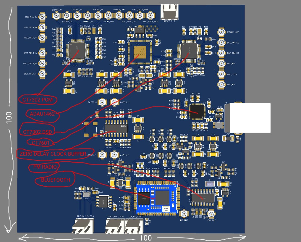

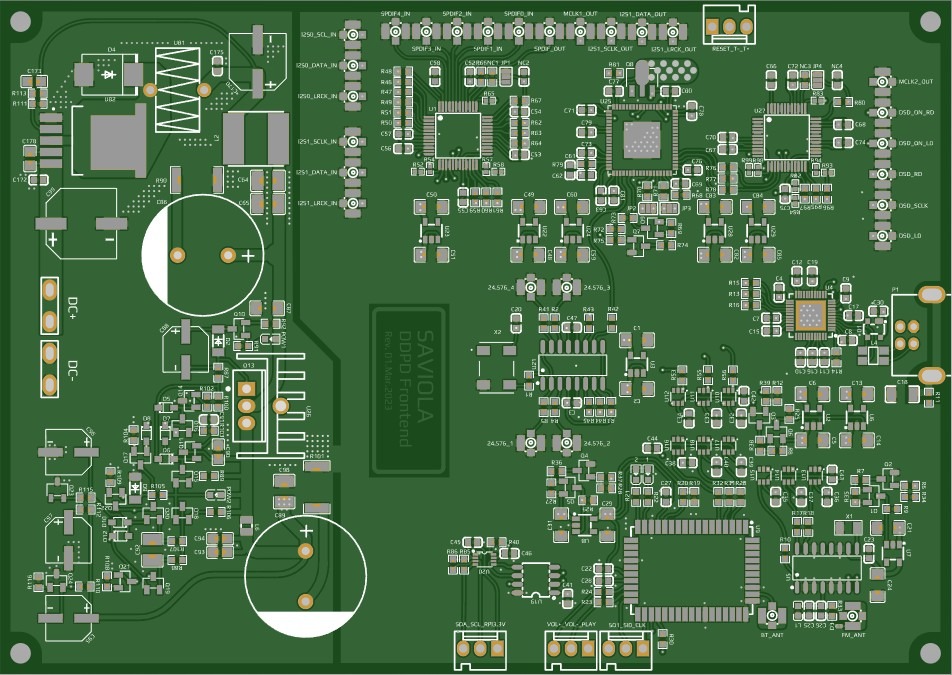

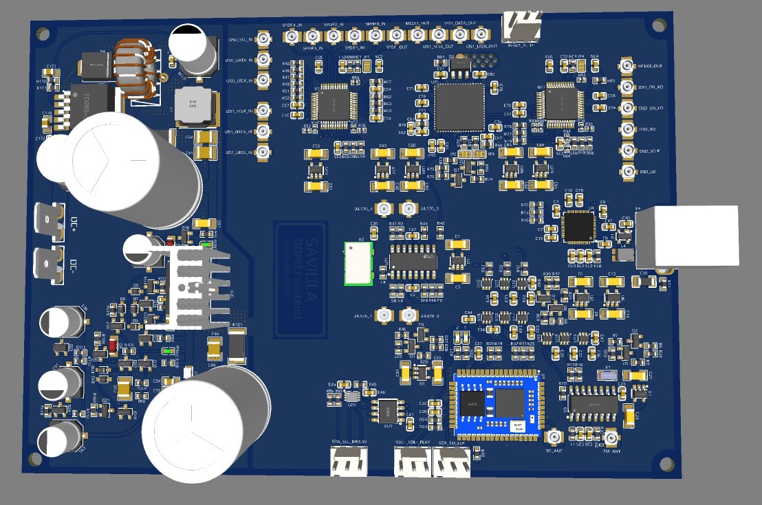

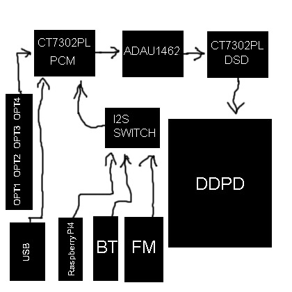

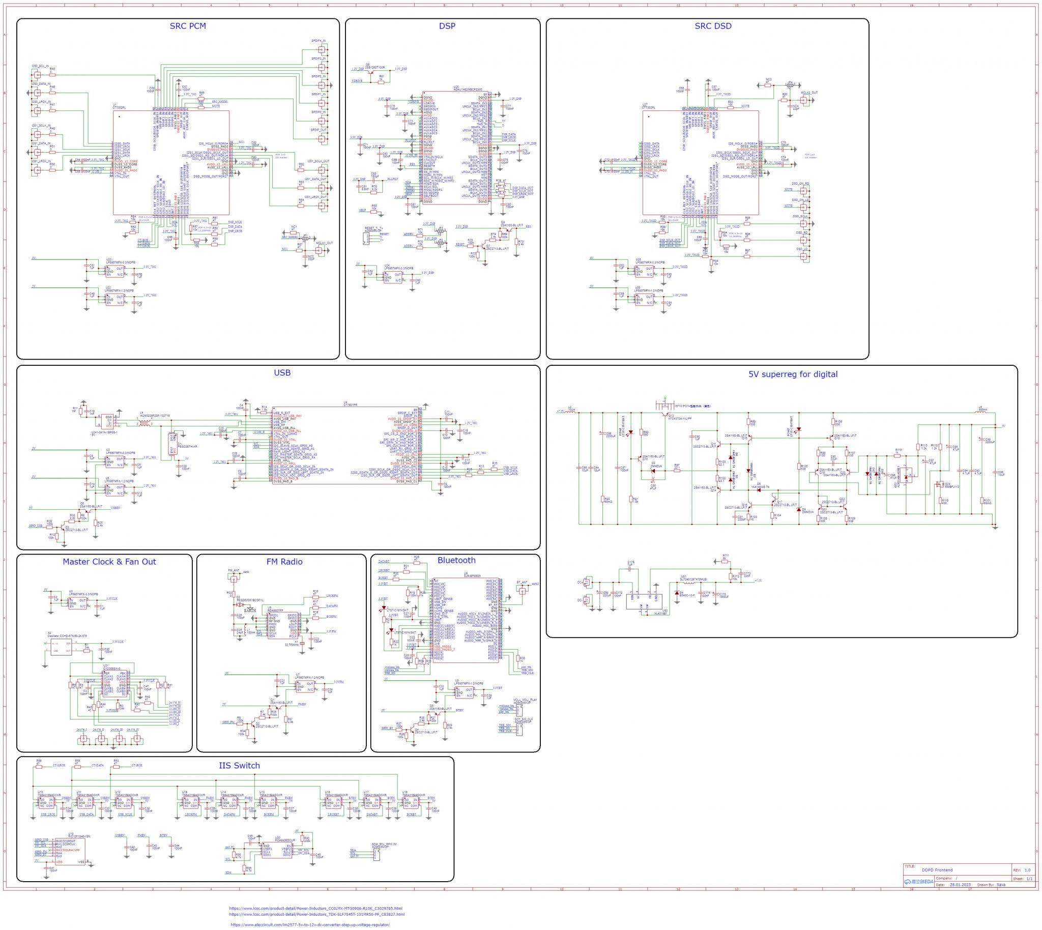

Frontend for new ganFet DDPD based on two ct7302pl, ct7601, dsp, bletooth, fm radio

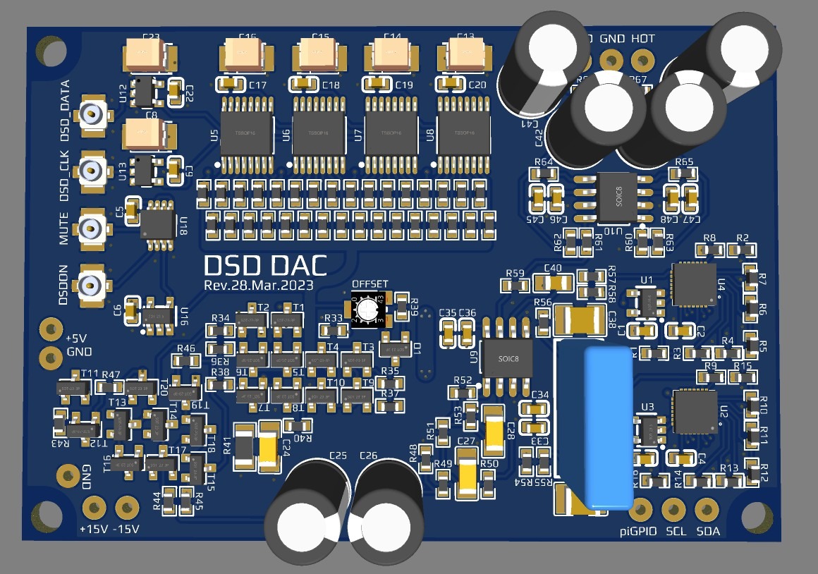

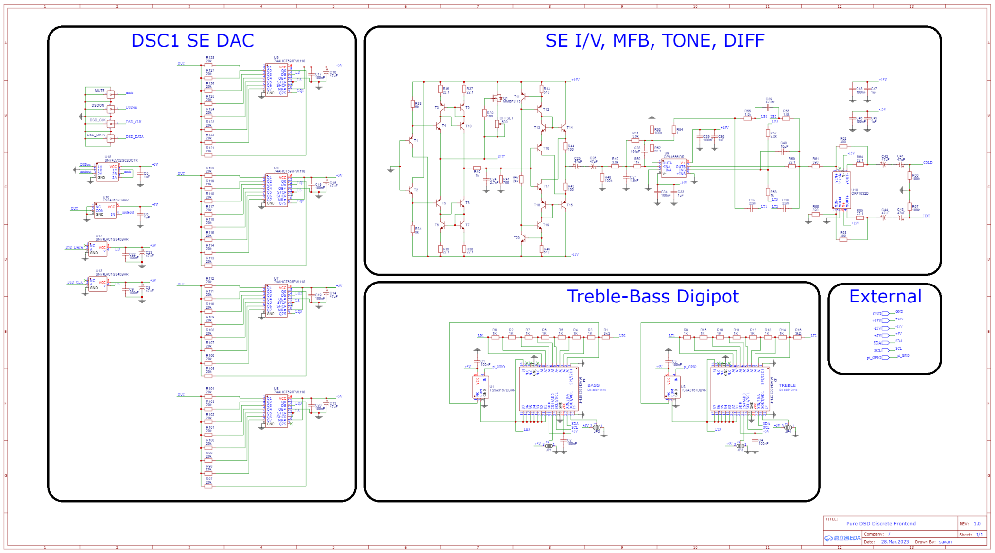

Jet another DSC with discrete i/v, mfb, tone control and se to diff, will combine them with ucd180 and digital frontend based on ct7302pl. This one is mono, single ended. Pcb 75x50mm

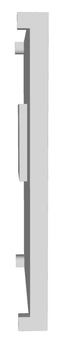

Mono pair, I want dual mono, so need another ddpd+smps. Box layout will be mono left, than metal partition as rfi shield, in the center DDPD frontend, than again metal partition, than mono right. Box will be CCA ~300 x ~200 mm

Pcb finished, waiting heatsink from manufacture. The next step is soldering frontend which contain two ct7302, ct7601 usb, dsp, fm radio, bluetooth, 4 optical inputs, two i2s inputs, after that need to finish atenuator+dummy load+diy aux0025 filter and only than I will be ready to connct things together to power supply and test it, a lot of work : )

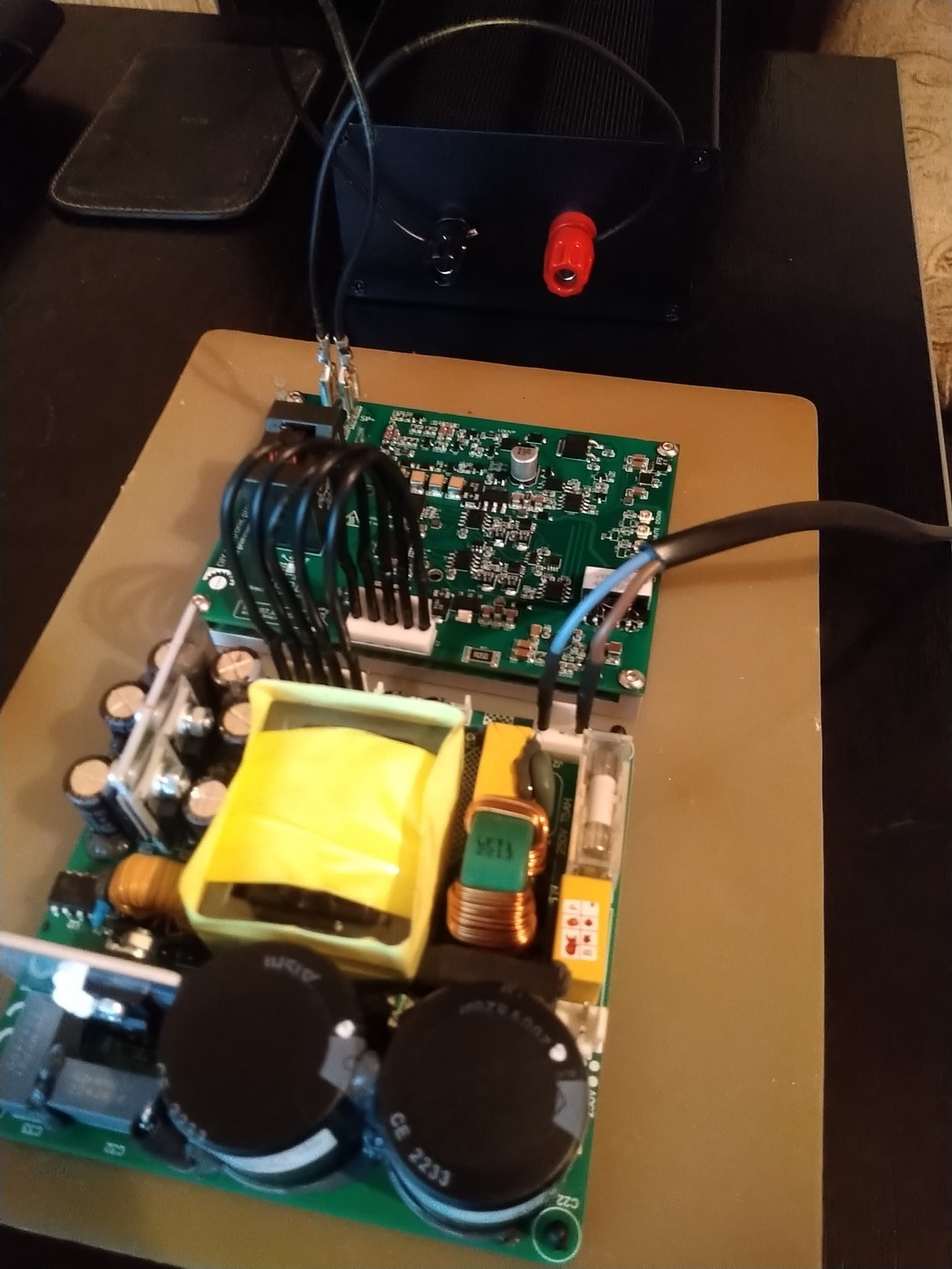

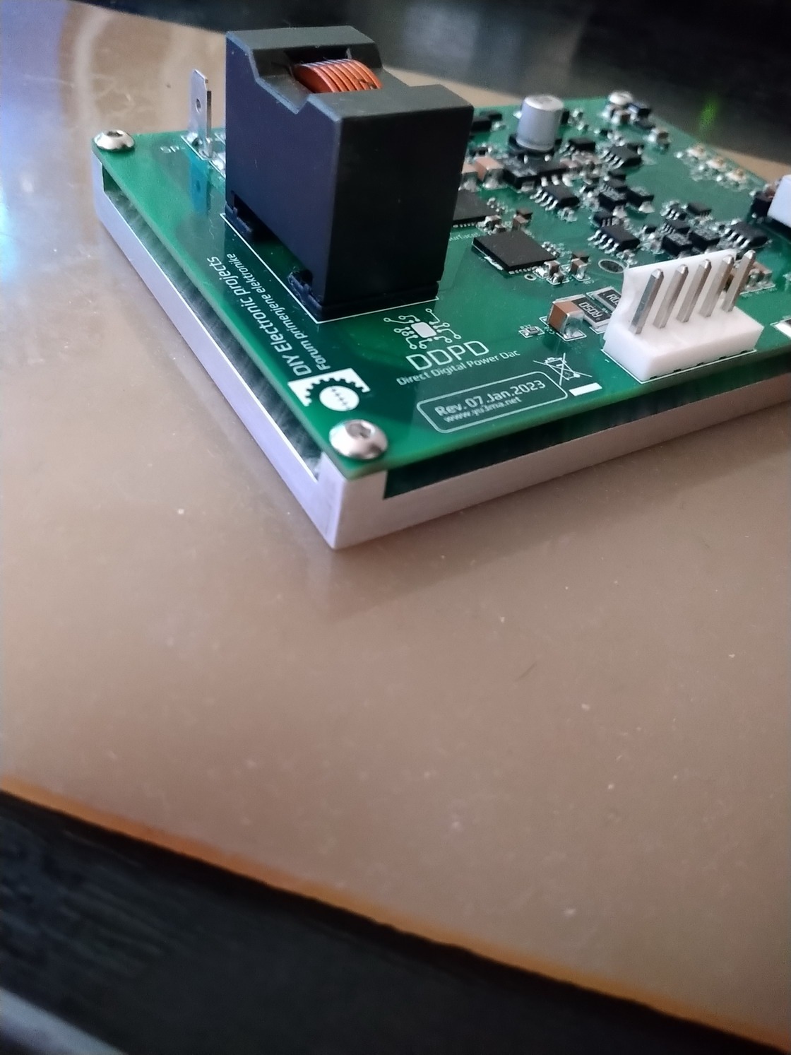

Today I have finished ddpd by installing his bottom heatsink, and connected with smps, on my surprise everything ok, it promising! : ) Audio test will be after frontend get finished

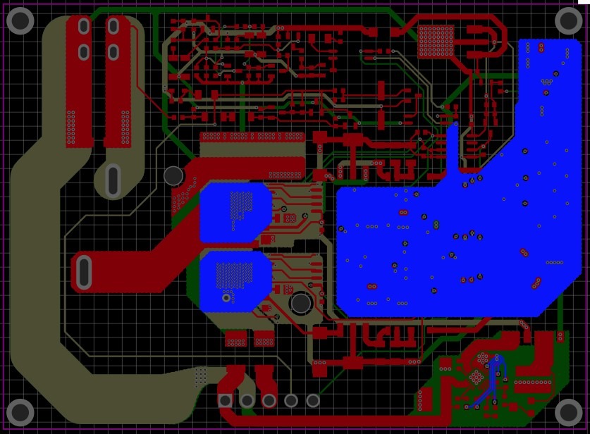

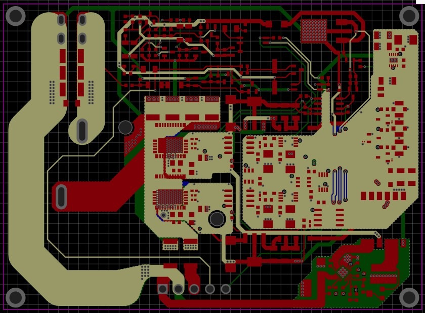

Project is unsucesfull! Problem to stabilise MAX17687 iso buck regulator, bottom-right at the picture and all the things like linear regulators have problem with huge ripple, even LT3045 is unable to completelly remove noise from iso buck. I'm tried everything to stabilise iso buck but unsucesfull, so gan ddpd project going from beggining : (
Is Hypex SMPS400A180 too bad? There is some small noise I can see on smps pos and neg and going to think that all that noise is copied to iso buck and isolated linear regulators, is that possible? Have no idea right now whats going on with MAX, didn't identified isue. I will probably use small torus transformer for the isolated things and linear regulators, half bridge will be probably left on SMPS but hmm don't know right now
Your problem may be caused by "polluted" ground as there does not seem to be any isolation between grounds. Is this the layout you are using? Have you posted the schematic?
Have you checked this: https://www.analog.com/media/en/technical-documentation/data-sheets/MAX17687EVKITA.pdf
