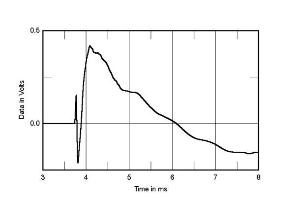

Assuming it's following the usual Dynaudio pattern it'll be a 1st order acoustic; likely 1st order electrical with a delay on the tweeter & whatever will give the desired slope for the midbass.
I don't even remember when I saw a 1st order Dynaudio speaker measurement. There were many of the old ones, but nowadays, almost every model is a high-order solution.
Here is the Special 40 step response from the Stereophile measurement. Typical 4th order acoustic crossover with the midwoofer one cycle behind the tweeter.

The Website lists the cross over as first order tho?
Of course, a manufacturer can claim anything about his product if he can explain it somehow (or not). However, the measurements do not lie and in the case of Special 40 it is certainly not an acoustical 1st order solution.
